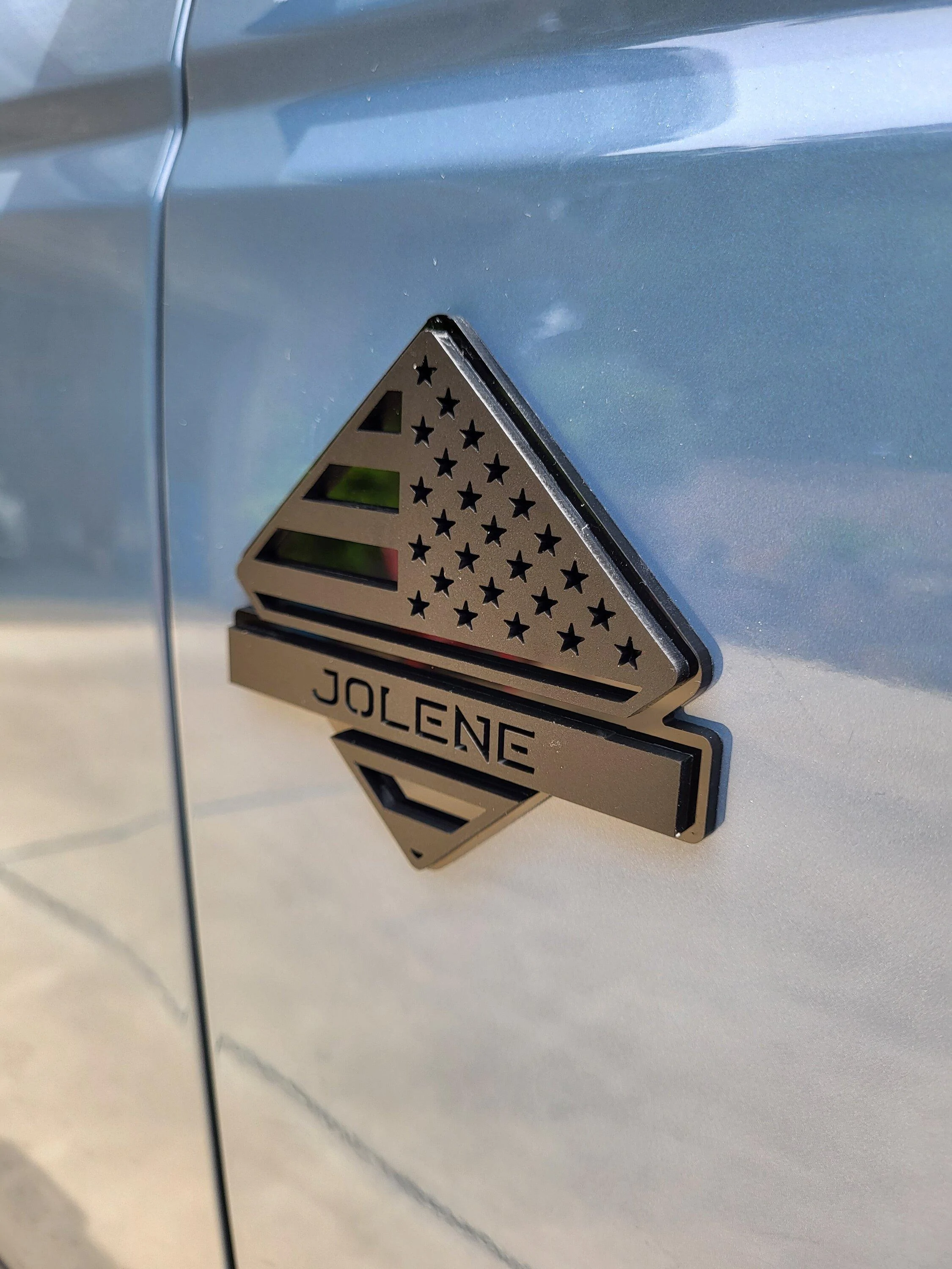

Wow, OP that looks great, agree the stock OBX step hangs down too low. Will be looking into this when mine arrives. What fender badge is that? couldn't quite make it out, thanks...
Nevermind saw from your avatar it's a FE, looks great!
Thanks! Not an FE, it's a 2023 OBX. The avatar badge was the factory badge but in these pics I've already switched to custom ones by Ikonic Badges. My wife named her Bronco Jolene so I had these made for her.
