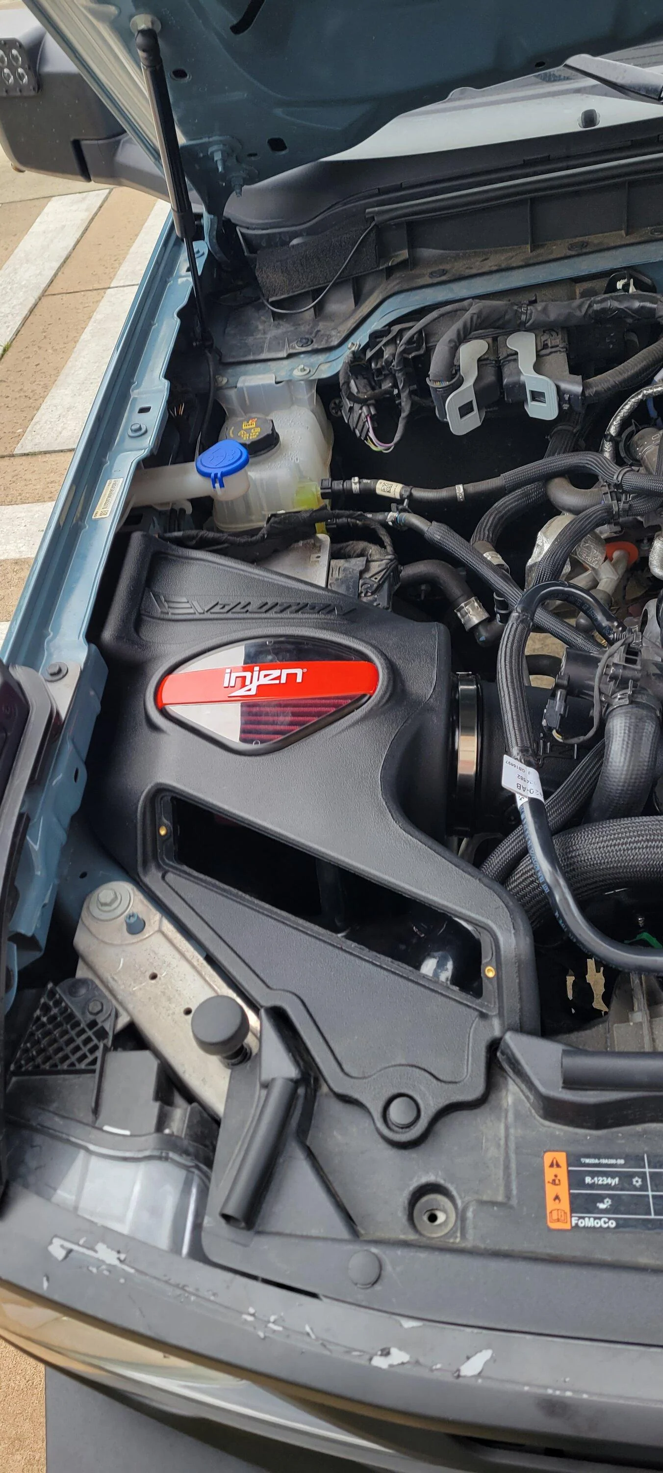

Received my Injen Intake yesterday after preordering it back when they released it. After a couple delays it finally showed up and I went ahead and installed it. Ford definitely didn't make it easy to swap out the inlet pipe but thankfully Injen supplied a tool to pop off one of the breather hoses that doesnt just pop off.
The reason why i went with this intake is they are also making a snorkel and this intake is made to work with it. First impressions is its not overly loud in the cabin but you definitely get to hear that induction noise which sounds great. I have a manual transmission and in between shifts it definitely is audible. As far as HP gains its probably minimal if at all but I definitely feel it in the Butt dyno.
Overall i would definitely recommend this intake but don't expect a quick install lol.

Do you have any pics of this from the side, either driver or passenger? Curious if it'll clear my ARB compressor. Also, any info on the snorkel?

156
231
Ordered this setup from @LethalPerformance hoping mine comes in soon. Pretty cool injen includes a tool to remove that one hose. Never had an injen intake that didn’t deliver air temps close to ambient vs other hot air intakes. Good stuff
Seems like it's still getting its air from the same place as OEM, so wouldn't they both have a similar IAT?
Right, sorry if that seemed accusing. The stock Intake is a cold air intake, other intakes sometimes neglect cold air flow for larger filters etc.
Gotcha, just making sure I didn't miss something important LOL
I bet the snorkel for this would push that IAT even closer to ambient.
Yup plus the reduction in bends etc, plus the sweet turbo noises!!
