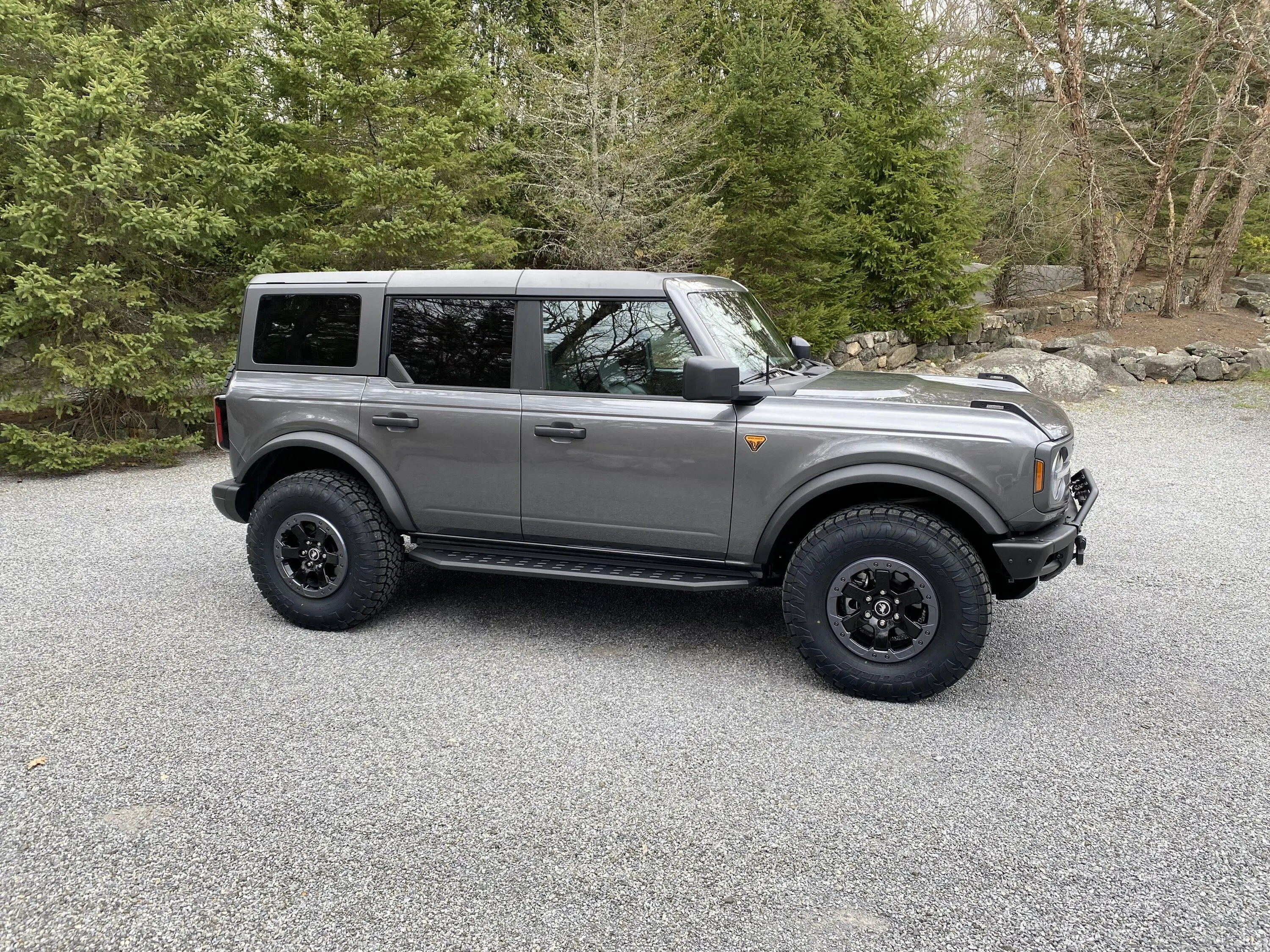

I put 35x11.5 Toyo Open Country AT3 (Load Range C) Tires on my stock Badlands yesterday, and happy to say they fit just fine with plenty of room left for Upper control arm clearance and vertical travel (maybe not rock crawling). No Lift. I did at 6MM KSP Disc Spacers just for a little more clearance on the control arms for low pressure sand driving. Happy with the change so far, there are some differences in ride, acceleration and braking, just feels like a heavier tire ( they are only 12 lbs heavier than stock K02's.) Debating installing Method 703 bronze 35mm offset wheels next, mostly for the appearance. I will say, despite having nearly identical tread width, the Toyos look skinner than the K02s at full lock because they are taller.
(NOTE: TOOK THE SPACERS OFF! Wheels felt terribly unbalanced on highway. Clearance without them is fine. )
Ford Bronco 35X11.5 TOYO OC AT3 on Stock Badlands w/ No Lift IMG-4656
Ford Bronco 35X11.5 TOYO OC AT3 on Stock Badlands w/ No Lift IMG-4658
Ford Bronco 35X11.5 TOYO OC AT3 on Stock Badlands w/ No Lift IMG-4661

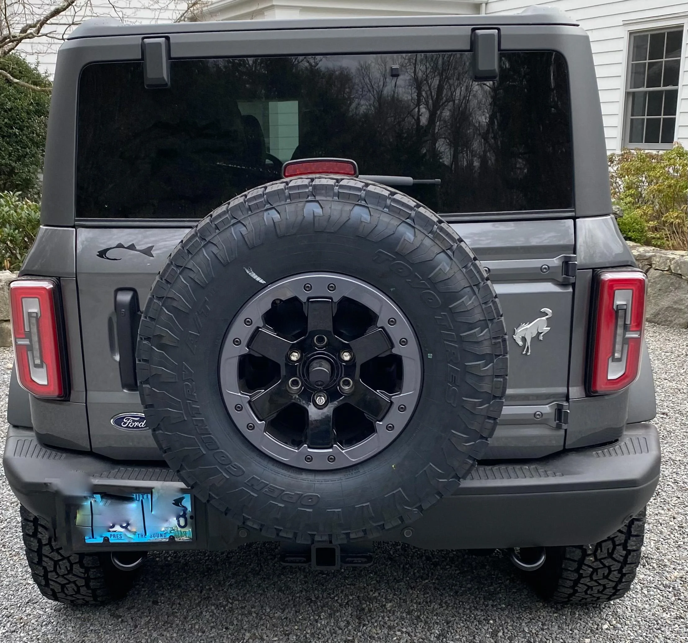

stock 3rd brake light just fit......
Ford Bronco 35X11.5 TOYO OC AT3 on Stock Badlands w/ No Lift IMG-4638 (2)_edited

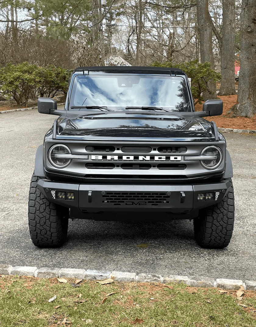

I was too concerned such a set up wouldn’t work. Same tires but put on Everglades rims.
Ford Bronco 35X11.5 TOYO OC AT3 on Stock Badlands w/ No Lift 4658F737-04D5-49B5-A7D8-AFCE74EFBB7B
Looks great with those rims! I probably could have skipped the spacers but dont mind them.

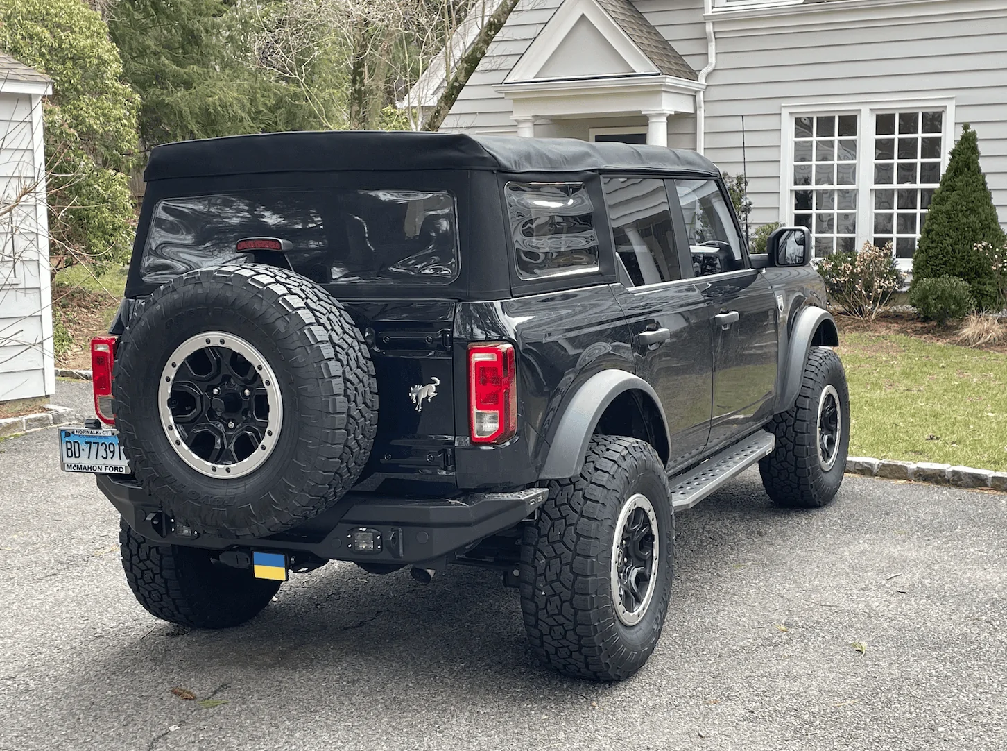

I have Toyo AT III's on my Big Bend along with aftermarket Sasquatch rims and a Zone 2" lift. At full articulation the crash bars were rubbing so I swapped the OEM's for 4WheelPart tapered crash bars. I have about 13,000 miles on the tires and love them.
Ford Bronco 35X11.5 TOYO OC AT3 on Stock Badlands w/ No Lift Screen Shot 2023-04-08 at 11.36.42 PM
Ford Bronco 35X11.5 TOYO OC AT3 on Stock Badlands w/ No Lift Screen Shot 2023-04-08 at 11.32.21 PM

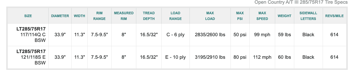

So are the Toyos 285/75/17?
They have both sizes ... 285/75-17 AND 35x11.5-17
The 35x 11.5 is .6" taller and weighs 4 lbs more than the C rated 285/75-17
The 285/75-17 is 33.9" tall by 11.3 wide.
It can be had in Load Range C or E and weigh 59 and 60 lbs respectively.

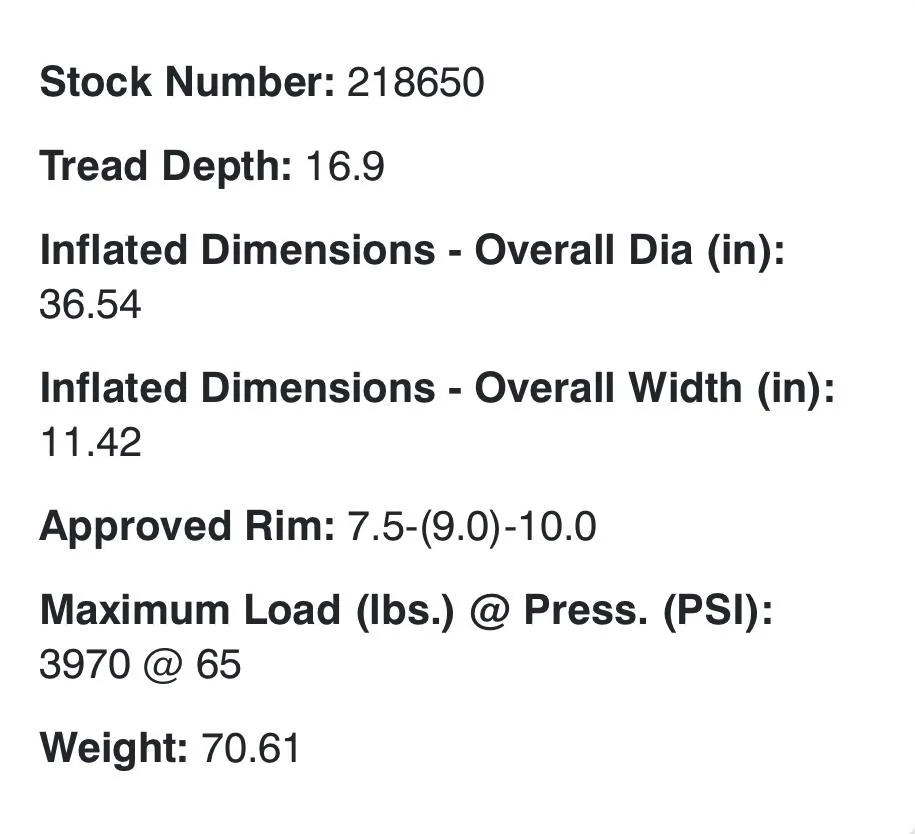

I always wonder why some manufacturers make so many size options for such an insignificant difference. 0.6” for 4 lbs increase?
Stock Badlands has the 4.43 or 4.7? I forget.
The comparable Nitto Recon Grappler is the only one that I’ve found that makes a 37x11.5 to fit the stock steelies - rated for 7.5-10 - but, 70.61 lbs.

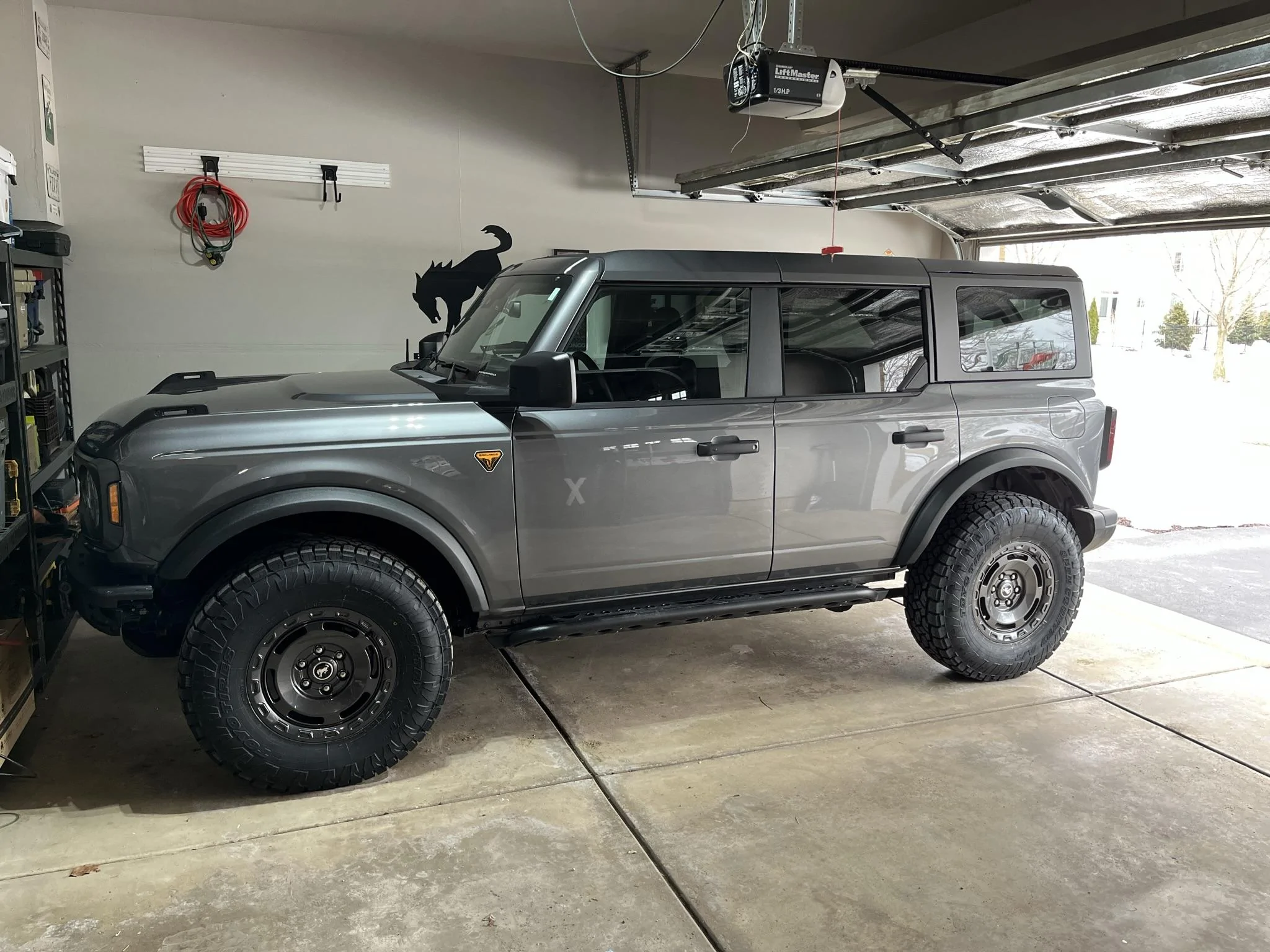

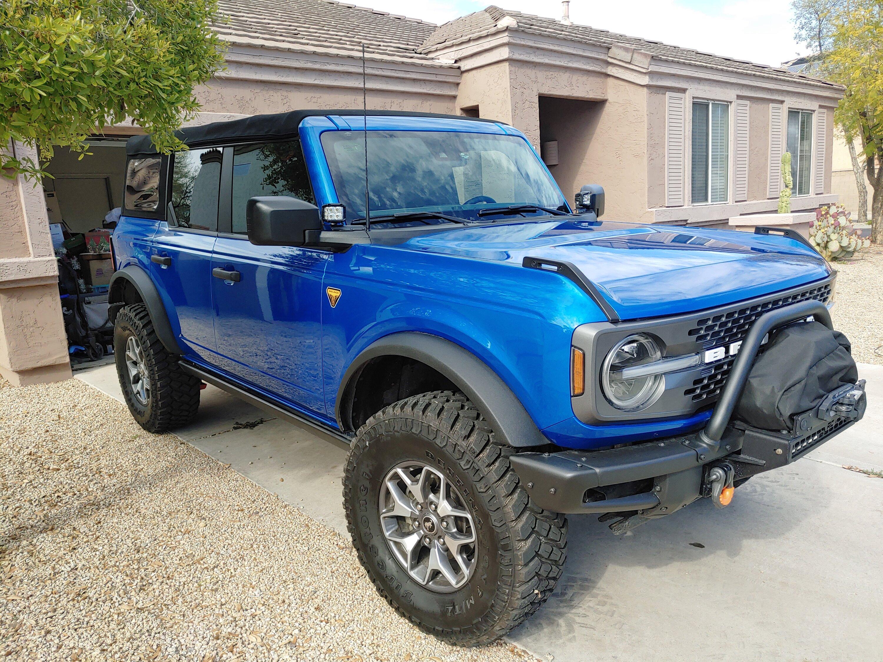

There ya go! 315's will fit as well, though not as much clearance as those 11.5" tires. I'm pushing the limits on mine. Lol.
Ford Bronco 35X11.5 TOYO OC AT3 on Stock Badlands w/ No Lift 20230327_154701
