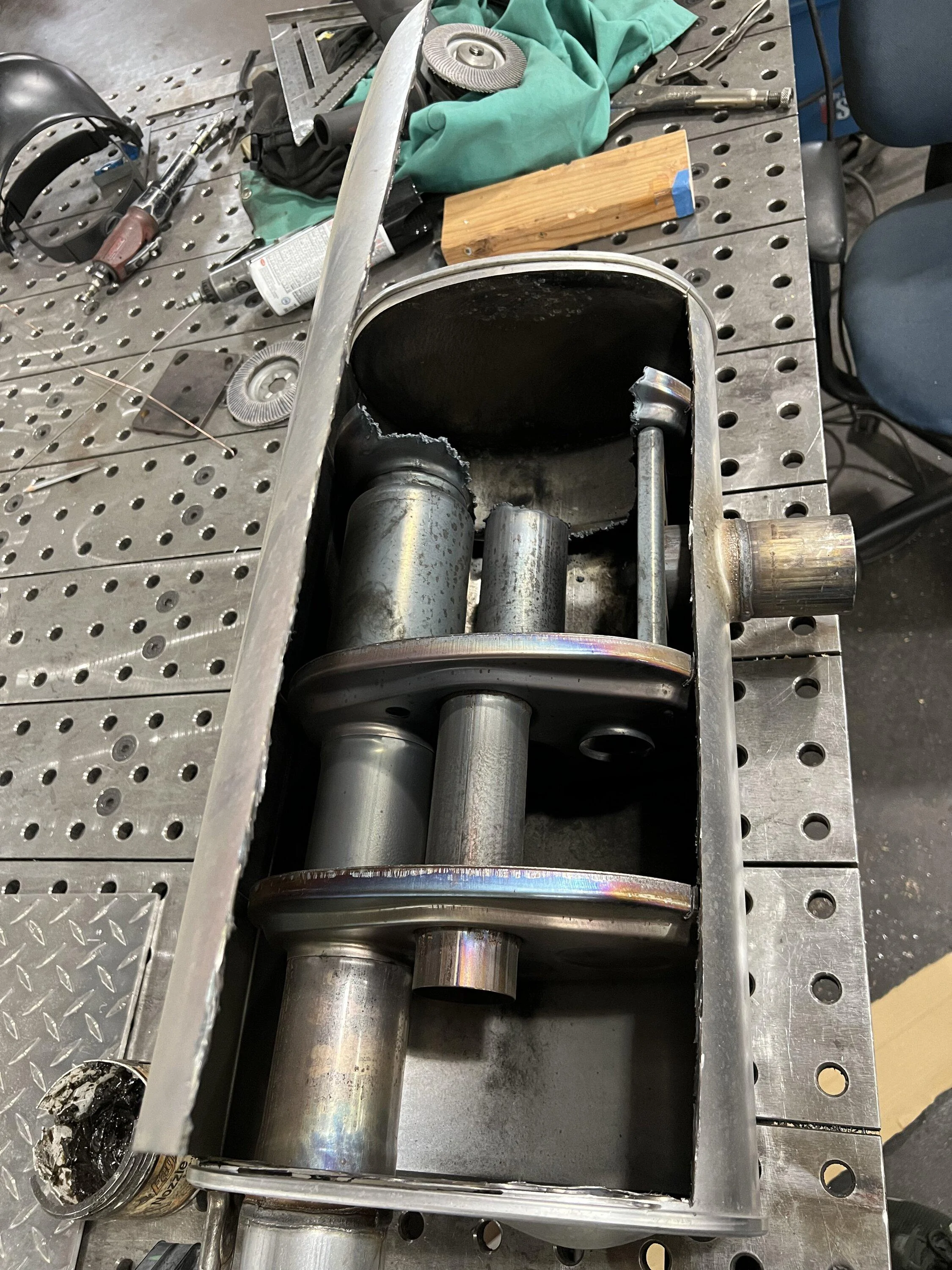

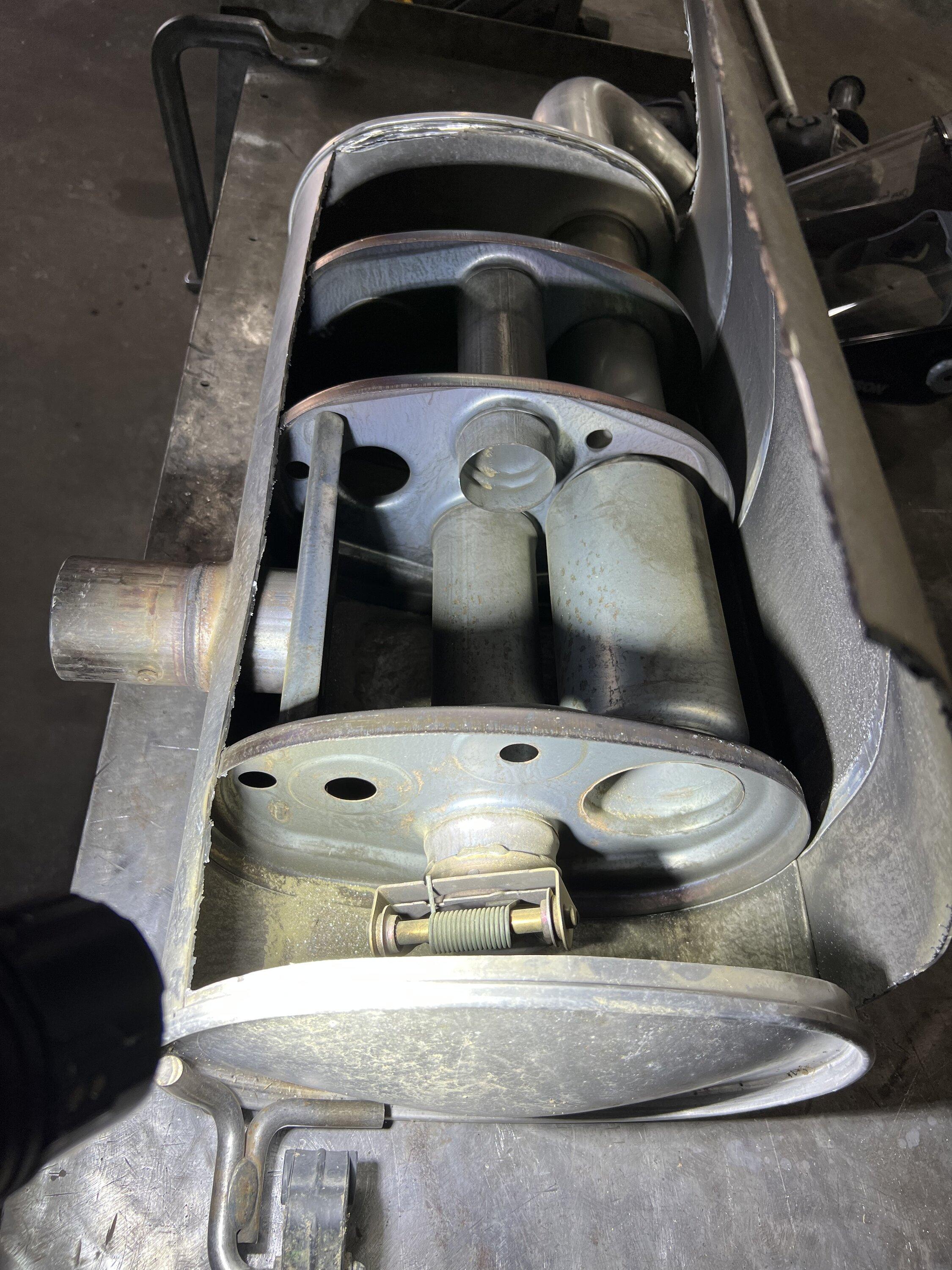

7 speed on windy days is sometimes less than easy to tell when to shift because you can’t hear the stock exhaust. So I found another stock muffler on FB marketplace for free to cut open and see what could be done. Here is the stock muffler cut open:
Ford Bronco Modded stock 2.3 muffler for more sound! (video sound clips added) 6A27DCE5-2BD9-4311-A748-C2E4C5B30913
Ford Bronco Modded stock 2.3 muffler for more sound! (video sound clips added) 36D48326-7D2E-4080-A074-27635AF49F40

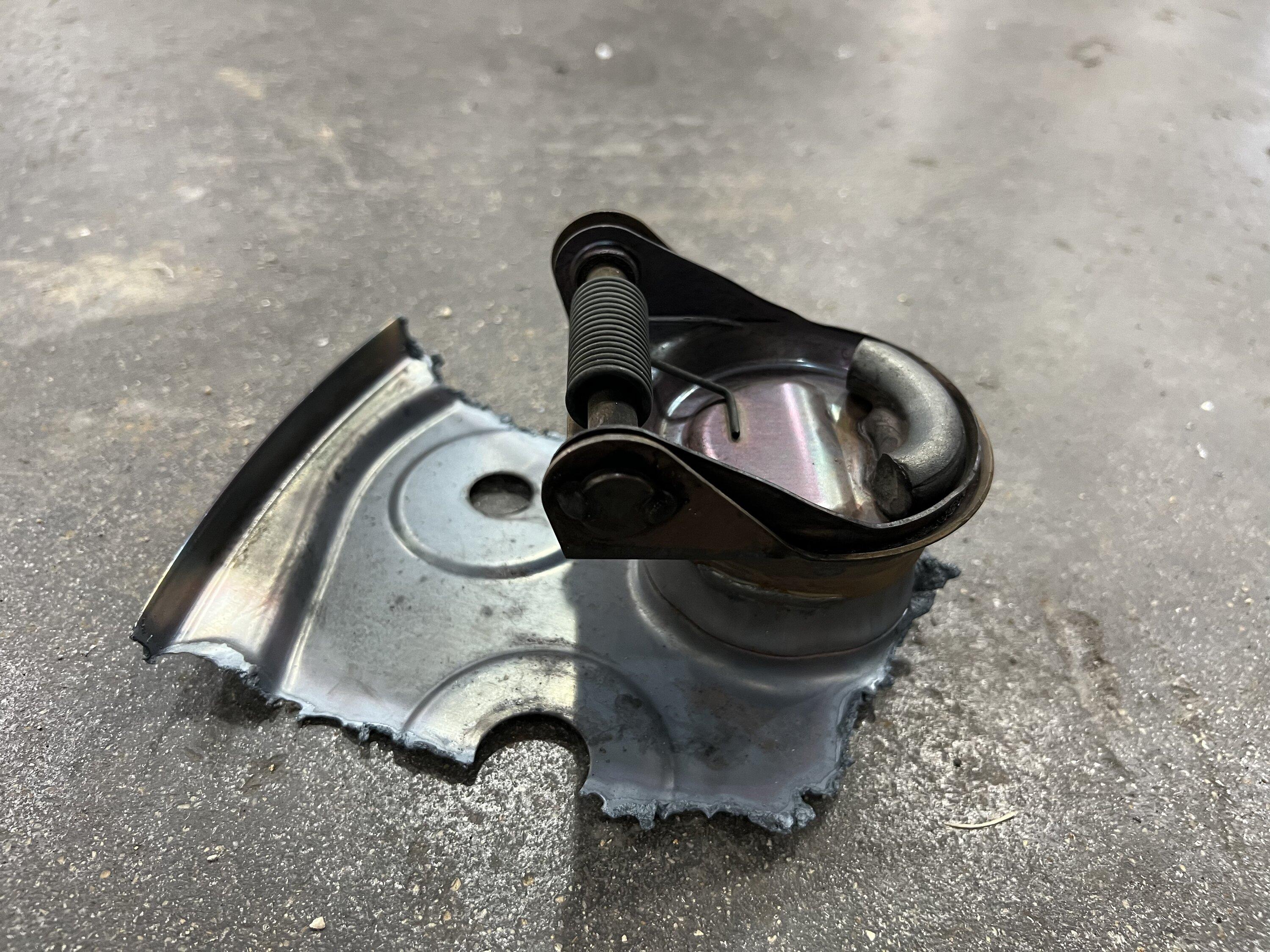

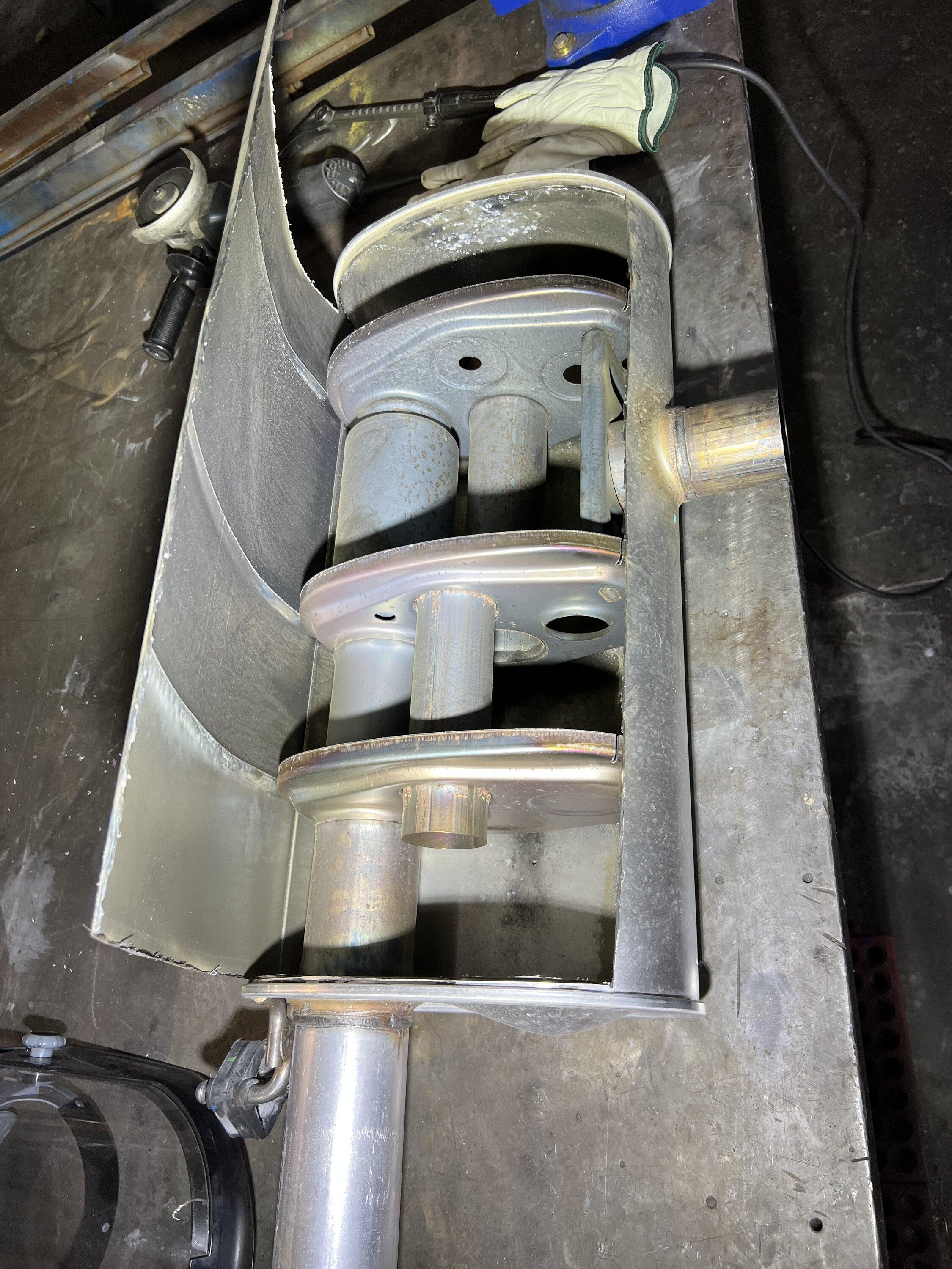

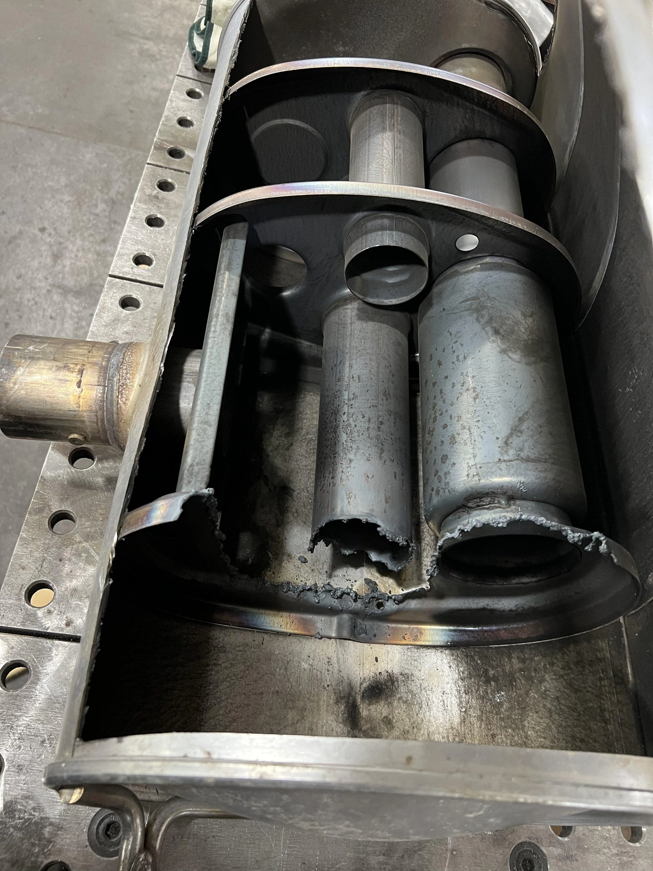

As you can see, exhaust is forced through 3 very restrictive holes and also through a labyrinth of approx 2” tubes that lead to a normally closed spring loaded valve. 2 holes are roughly 1/2” and one 3/4”. The exhaust exits through a big roughly 3” inside diameter straight through glass pack bullet after all this. So what I decided to do was this: Torched out the valve area so the exhaust has a free path to the glasspack and closed the top and welded it all back together.
Ford Bronco Modded stock 2.3 muffler for more sound! (video sound clips added) 8E4085D5-5358-4994-B480-201467AE0C9F
Ford Bronco Modded stock 2.3 muffler for more sound! (video sound clips added) 1DA35D0B-AF2A-4497-B362-3022BD97786E
Ford Bronco Modded stock 2.3 muffler for more sound! (video sound clips added) 6A9DAA5A-6358-499E-A660-C0763395CC7A
It sounds PERFECT it’s just baaaarely louder than stock. When cold it makes a little bit of decel noise and free revs sound like a stock focus rs or mustang ecoboost basically. Taking a video in a minute and reserving first comment for the video. This is quieter than any aftermarket exhaust but still louder than stock with just a touch of a deeper tone that makes it easier to drive with a stick over the wind sound on windy days! Wife says she can’t tell a difference lol
