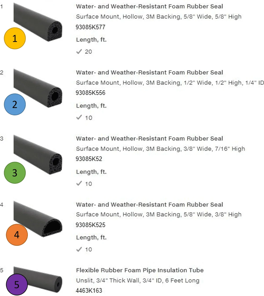

Part Numbers from McMaster-Carr
  1. 93085K577 (5/8"w x 5/8"h 20ft)
  2. 93085K556 (1/2"w x 1/2"h 10ft)
  3. 93085K52 (3/8"w x 7/16"h 10ft)
  4. 93085K525 (5/8"w x 3/8"h 10ft)
  5. 4463K163 (3/4" ID x 3/4" wall 6ft, Qty 2)
Approx. cost --> $130 in materials + $50 in shipping and taxes --> Total $180

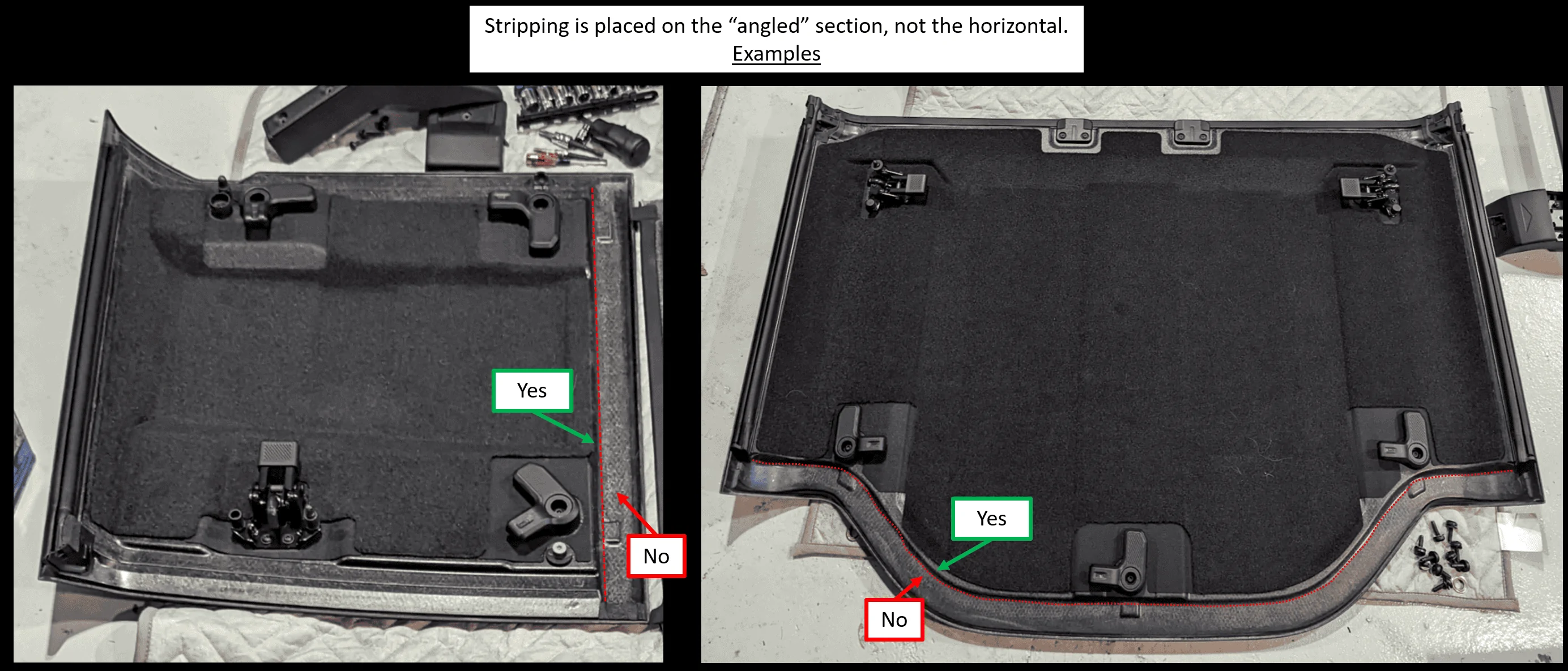

All weather stripping should be applied to the "angled" section of the top, not the horizontal section. The previous write-up has additional images of this. I haven't tried, but many appeared to struggle with adhesion to the horizontal section.
And remember to clean all your adhesion spots before pressing the strips on!

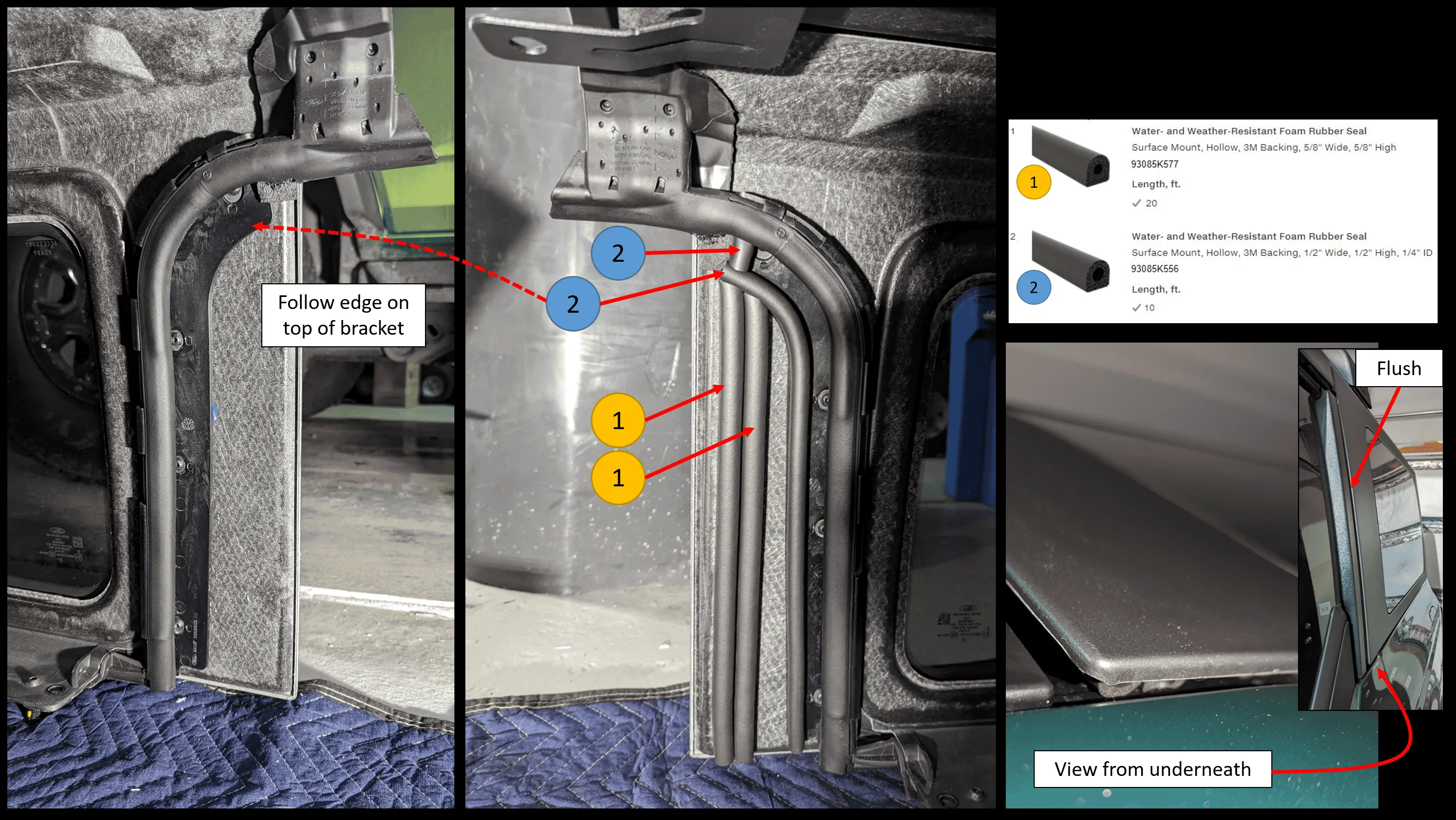

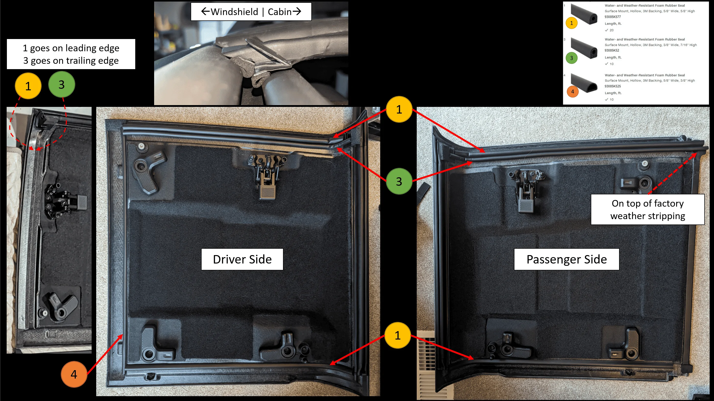

Front Panel
3 different types of stripping.
I wanted to cover as much length as possible so I went over rubber already laid down.
However, I didn't cover or move the soft fabric or the drain filter material. I gave my best judgement to keep channels clear.
The rear stripping is visible inside the cabin, but unless you have a flashlight looking up, you tend not to see anything. Looks good regardless.

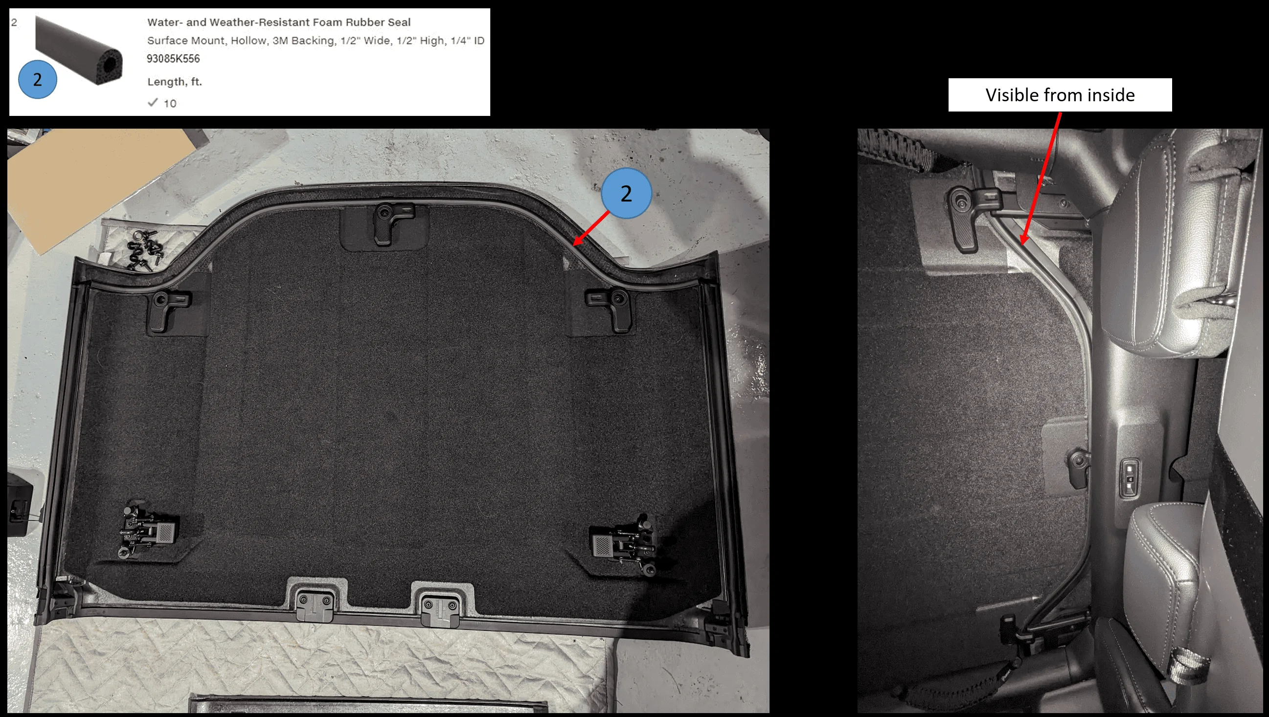

Mid Panel
Just one strip along the rear curved section.
As before, only visible if you're looking for it. Spend an extra couple minutes laying it down and it will look nice.
I'm biased, but I think it actually looks nicer with the seal ;)

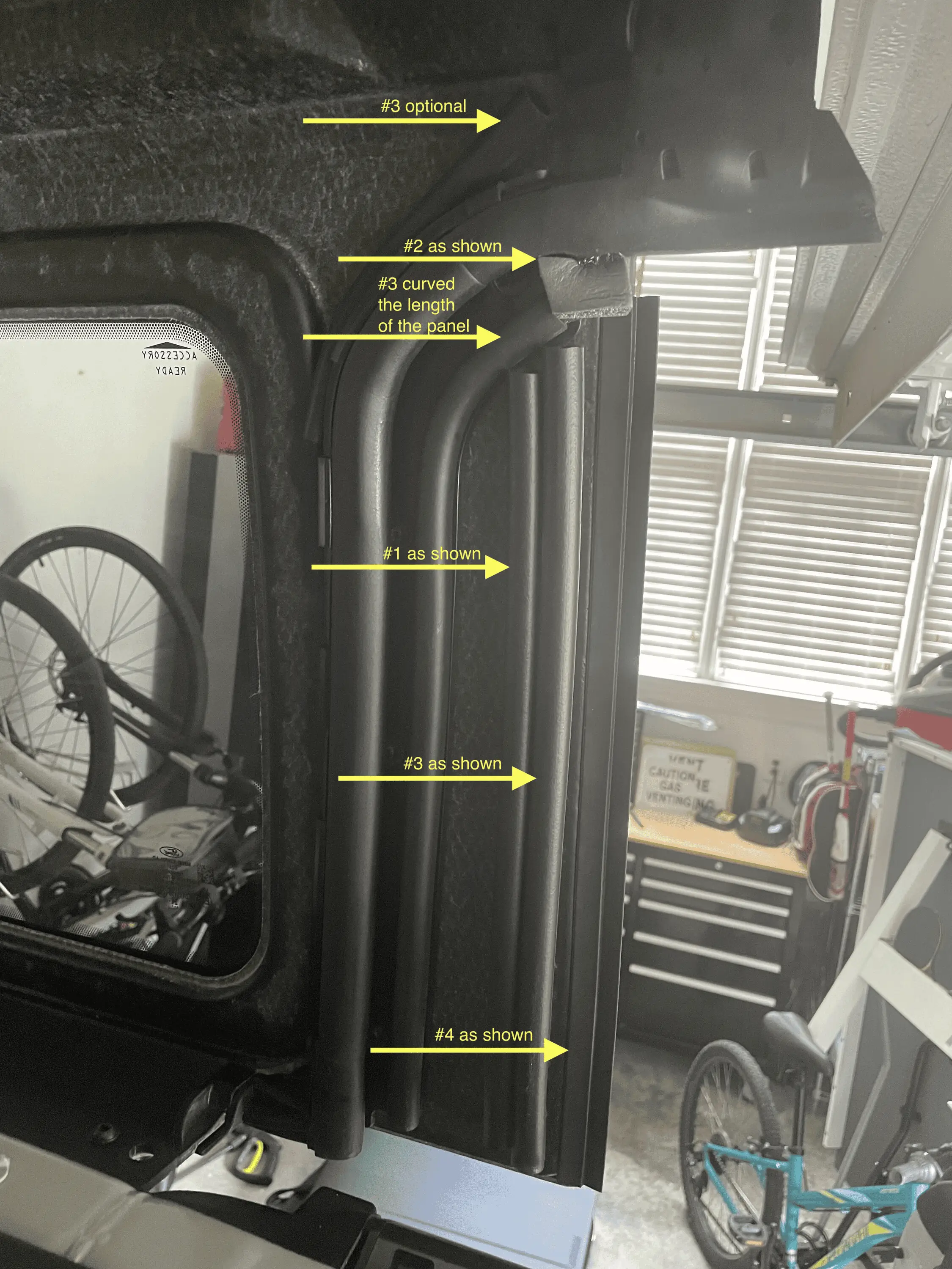

The "Gutter"
This insulation is 1/4" larger OD, thicker wall, and unslit when compared to a typical home improvement store version. This should hold its shape better and form a better seal over time.
Even though it's larger, it's still easily pushed through the gap between the chassis and installed rear panel.
No fitment issues putting on roof panels or sitting flush.
Can leave it at the full 6' but you might see it in the upper corners when the trunk is open. Cut a bit off and it will tuck behind the cage out-of-sight.

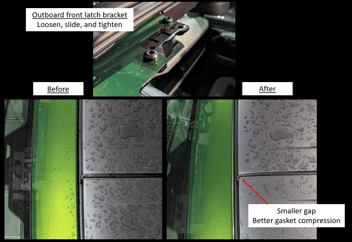

Front Outboard Latch Bracket
(Edit) Thanks to @SROC3 for mentioning this in the comments.
With the front panels removed, the outboard latch bracket bolts are accessible.
These have small but reasonable adjustment inboard and outboard. My driver side one was slammed outboard and I moved them inboard.
Before-and-after show that the front T-joint gets some better compression with the bracket shifted inboard.

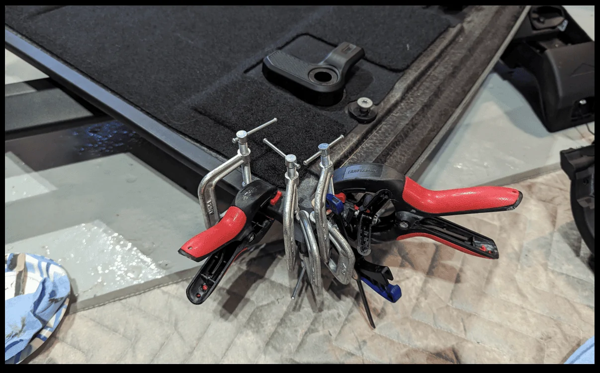

Front Weather Stripping Adhesion
This was an issue when I received my Bronco.
The front leading edge of the weather stripping was misaligned causing wind noise near the T-joint. Upon inspection I found out the stripping wasn't placed or bonded correctly.
I don't know if the "sticky gunk" is per-spec, but the other adhesive strips were clearly not right.
Pealed off what was left of the sticker adhesives, cleaned it off (acetone does NOT work on the gunk, but rubbing alcohol did), lightly scuffed with sandpaper, cleaned again, and bonded it back together with a minimal layer of JB-Weld.

Get your clamps ready...

I've bookmarked this thread and will try it in the spring. I tried using the OP post with all the weather stripping that was recommended from Amazon and its crap. The adhesive wouldn't at all and I tried using both acetone and 99% isopropyl alcohol to thoroughly clean all surfaces. I was able to have minimal success using a heat gun to heat the adhesive, but overall it was a waste of money.
I have much greater confidence with the part numbers and vendor provided in this post because it is all spec'ed with 3m adhesive.
Thanks to BroncoWhisperer for locating McMaster Carr and this post.
