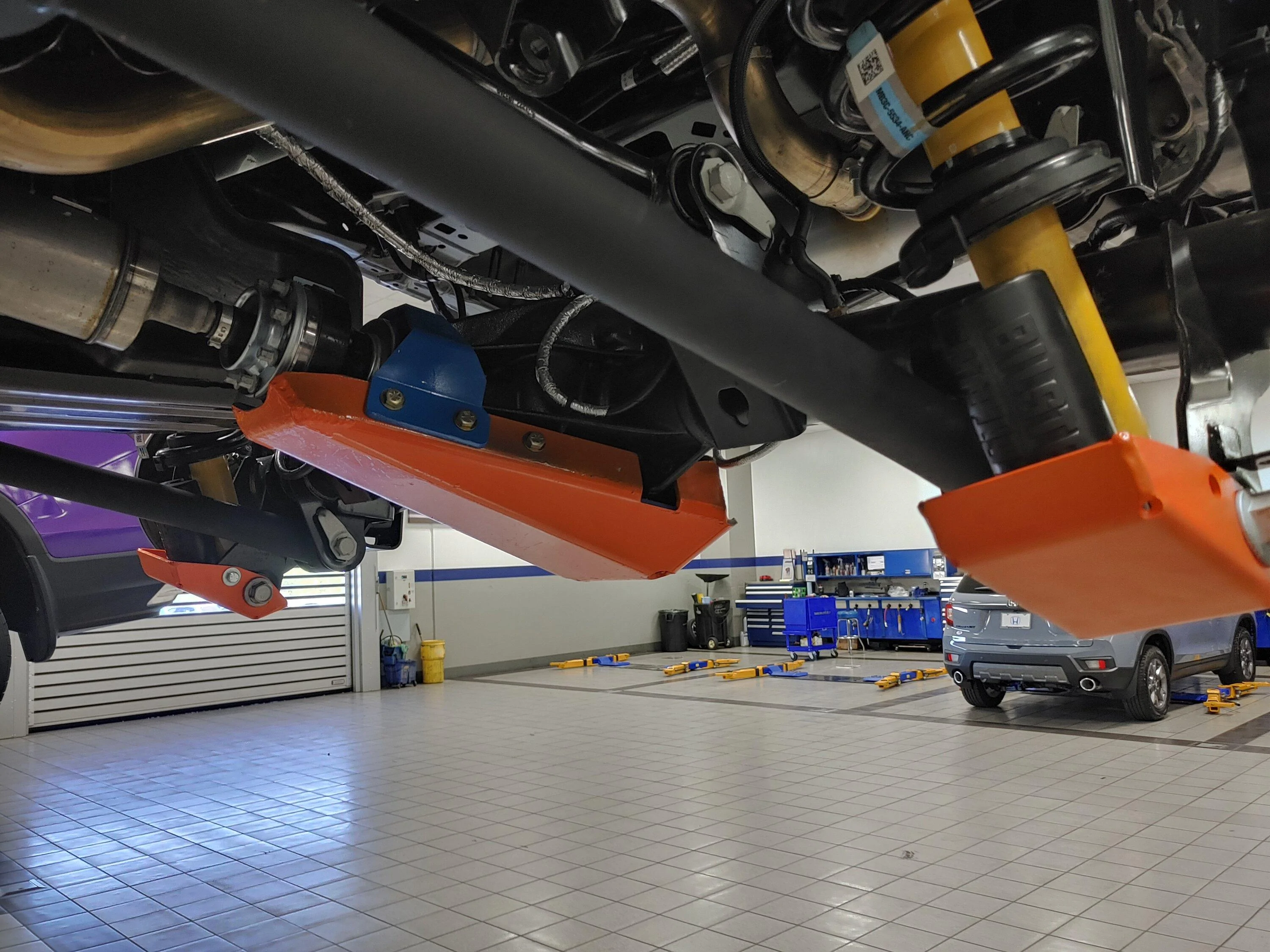

Since the Badlands has all the skid plates, why not add more. Installed the Next Venture diff skid and Broncbuster Shock skids.

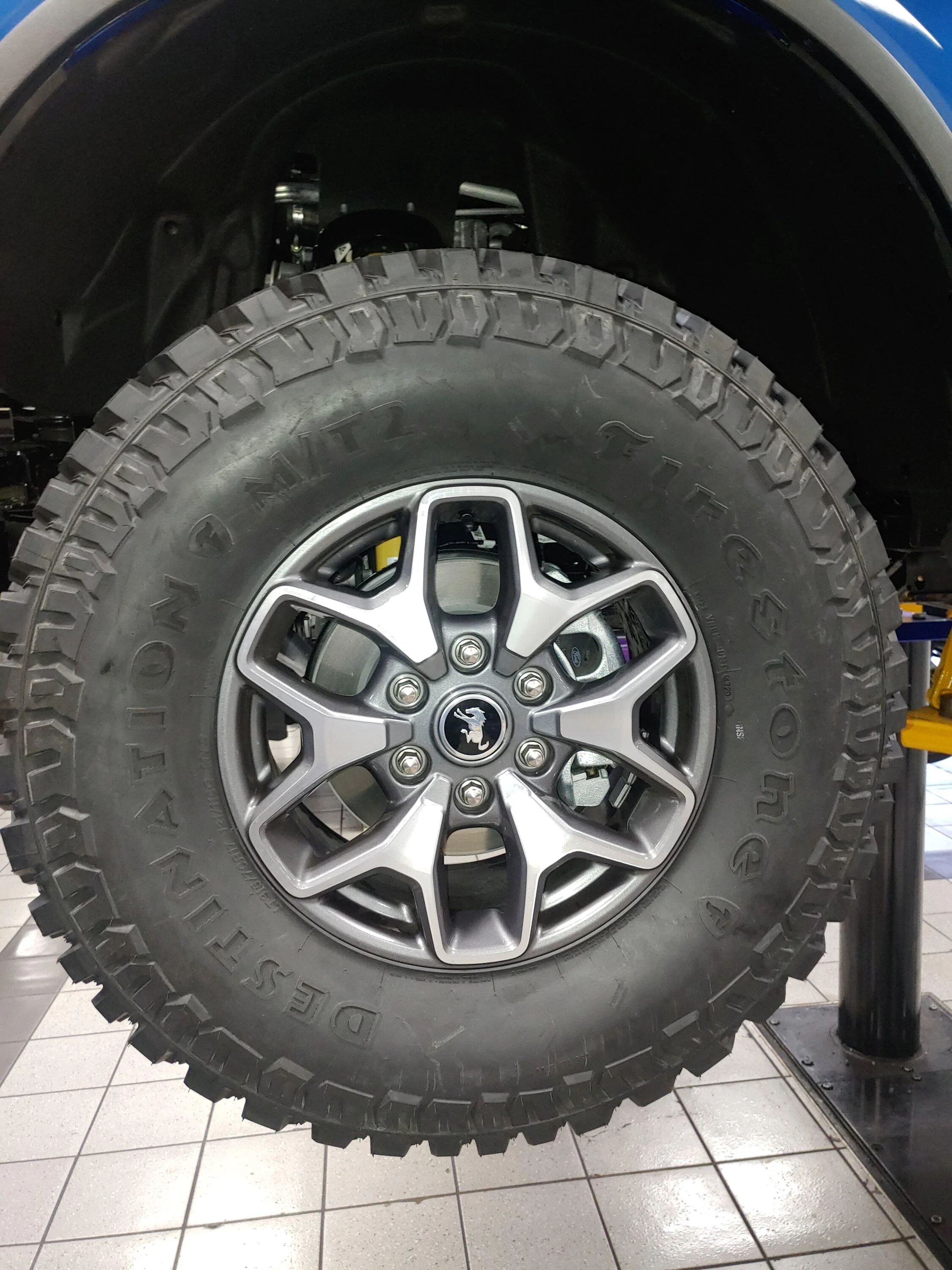

Couldn't find any solid answers regarding fitment issues with stock Badlands and 35's, so I tried myself. 315.70.r17 Firestone Destination MT2's, or, tractor tires.

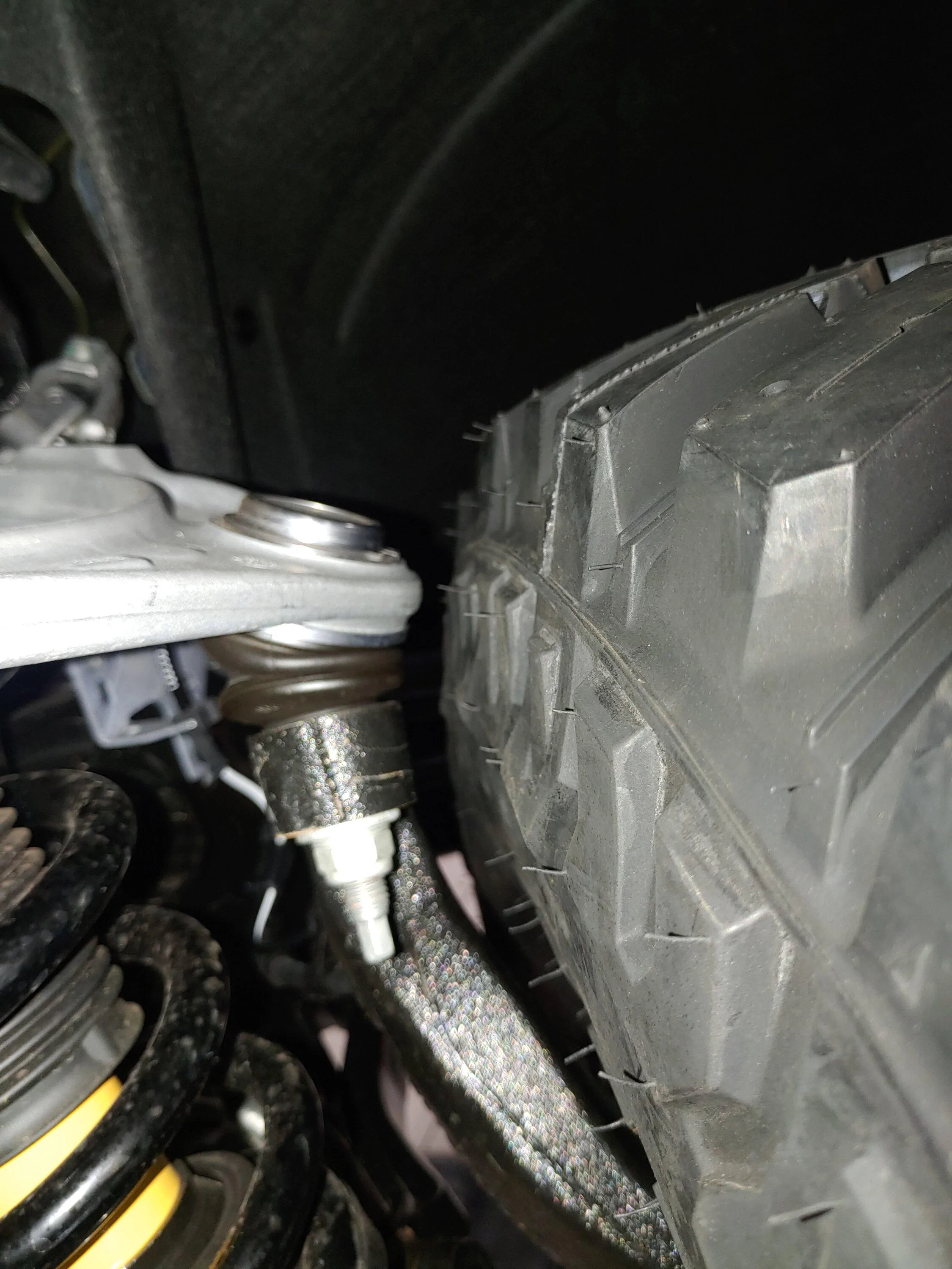

Getting pretty close to the control arm and knuckle. No rubs at full lock. Airing down might yield different results.

How she sits with 315's.

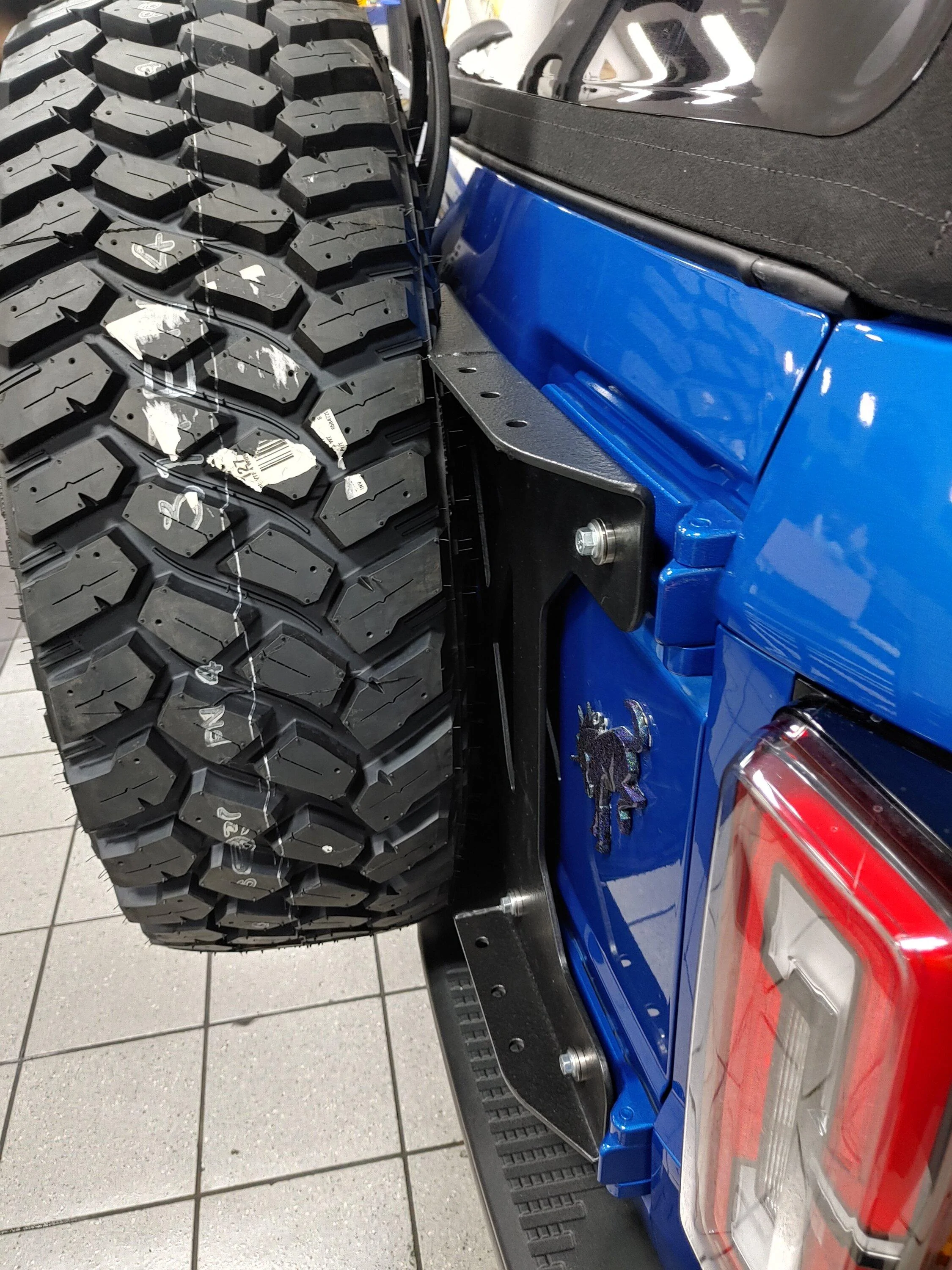

Added the BAMF tailgate reinforcement.
Had to space out my spare about 3-4mm to clear the flanges.
Ford Bronco My Badlands capable daily driver (Heretic) build 20221108_120909_HDR

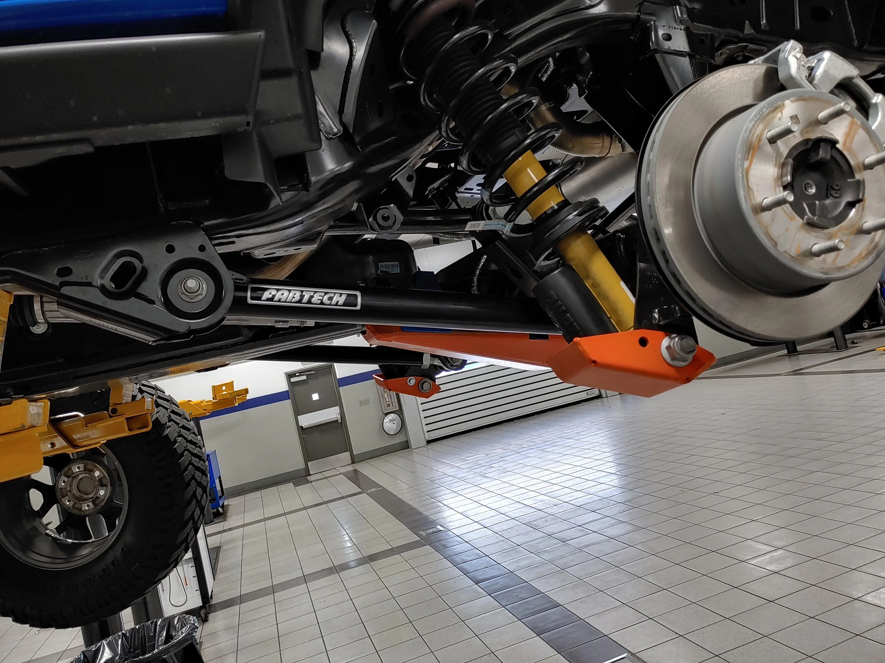

Next up! Fabtech trailing arms. Hoping to help with some articulation. Can't hurt!

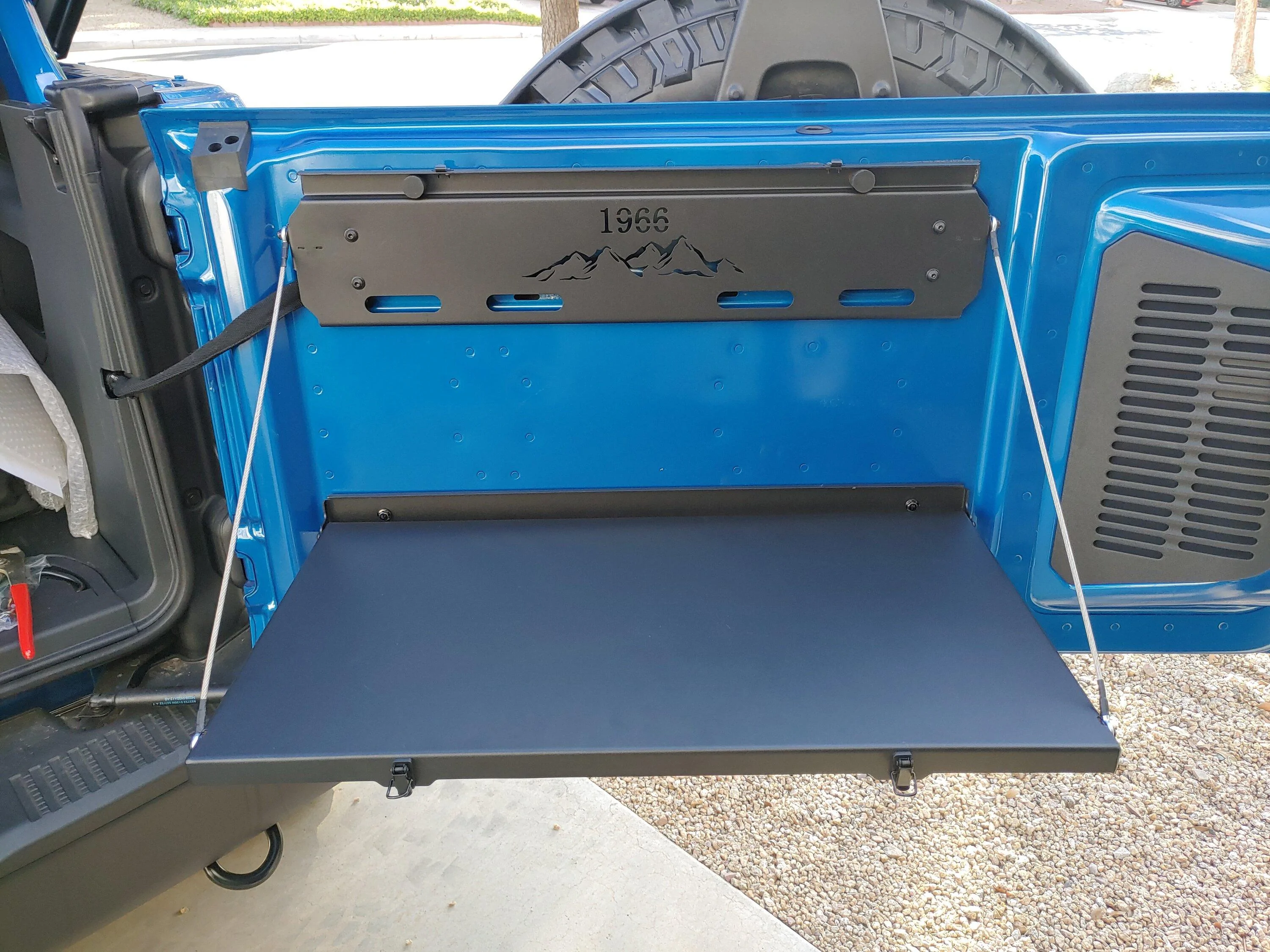

Installed a tailgate table from Amazon. No drill install.
Ford Bronco My Badlands capable daily driver (Heretic) build 20221023_161357

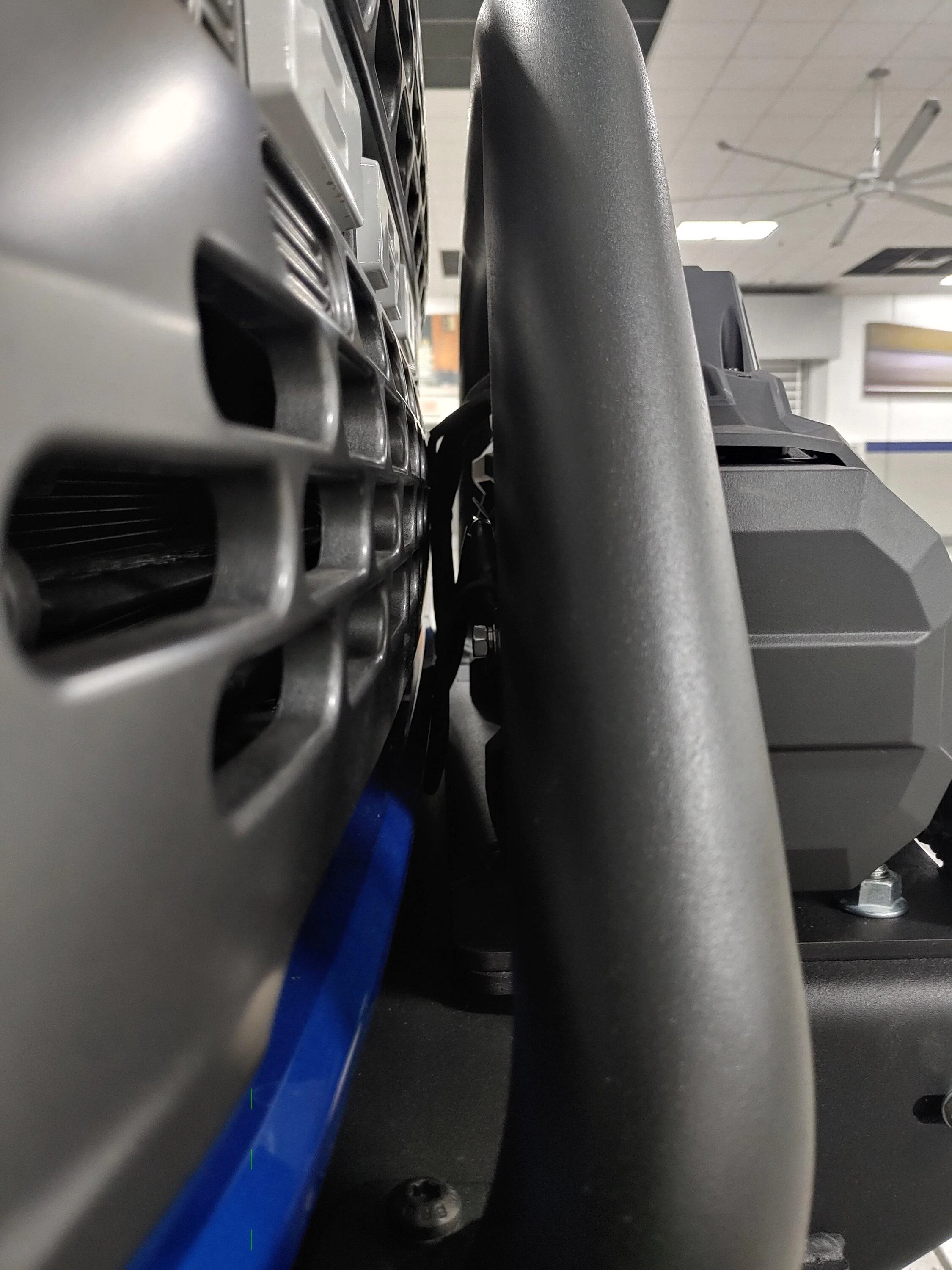

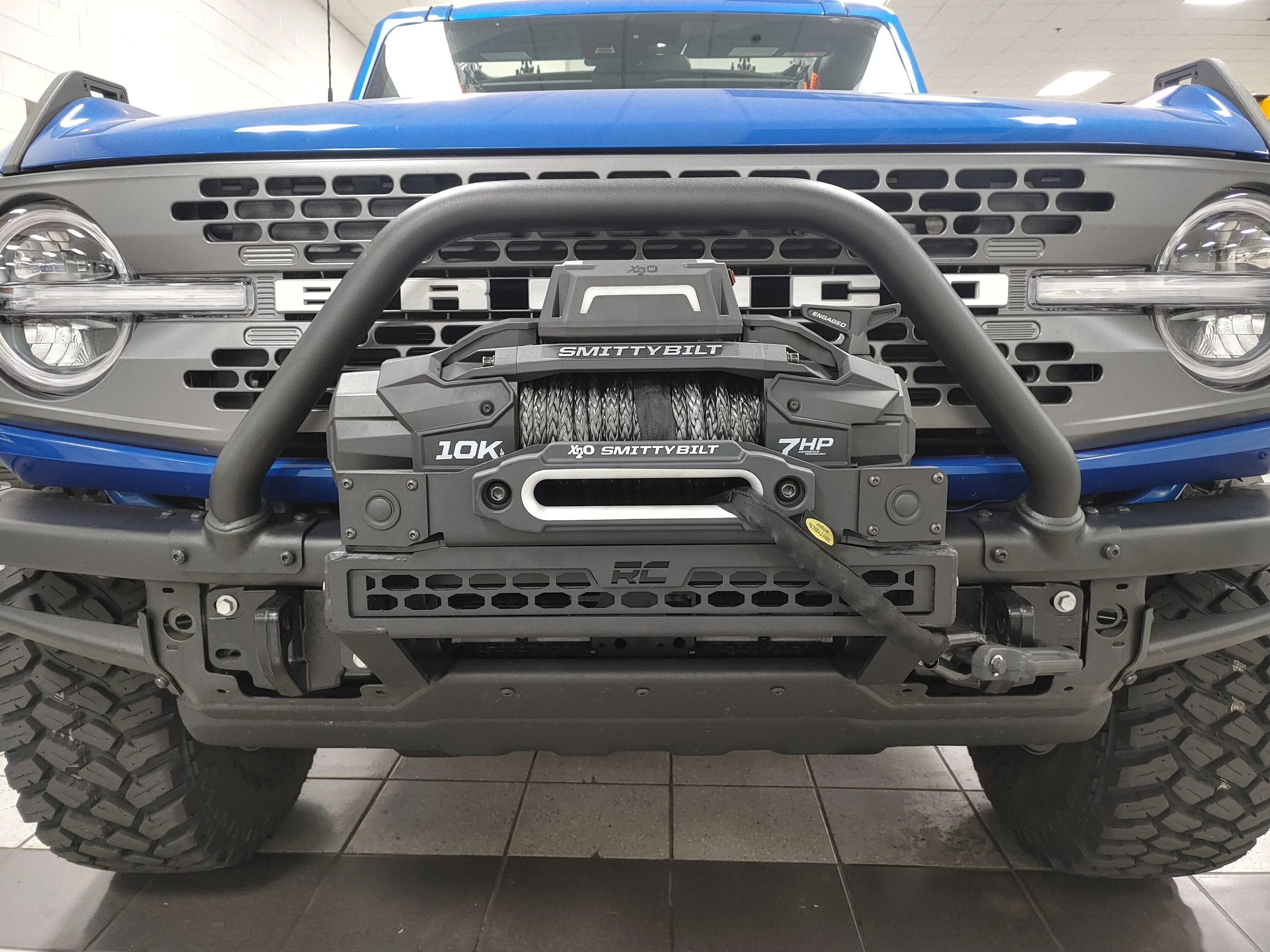

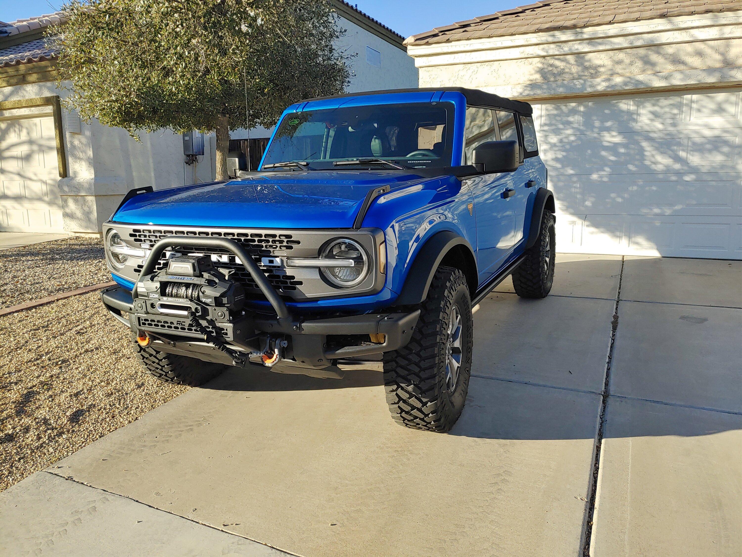

It wasnt on my list, but a buddy of mine is a bad influence, plus it was on sale. Winch time! Smittybilt x20 Gen3 10k with synthetic rope, and the Rough Country high winch mount. Pretty easy install. Ford made it stupid easy to wire up the winch.
Ford Bronco My Badlands capable daily driver (Heretic) build 20221114_172427_HDR
Ford Bronco My Badlands capable daily driver (Heretic) build 20221114_172446_HDR

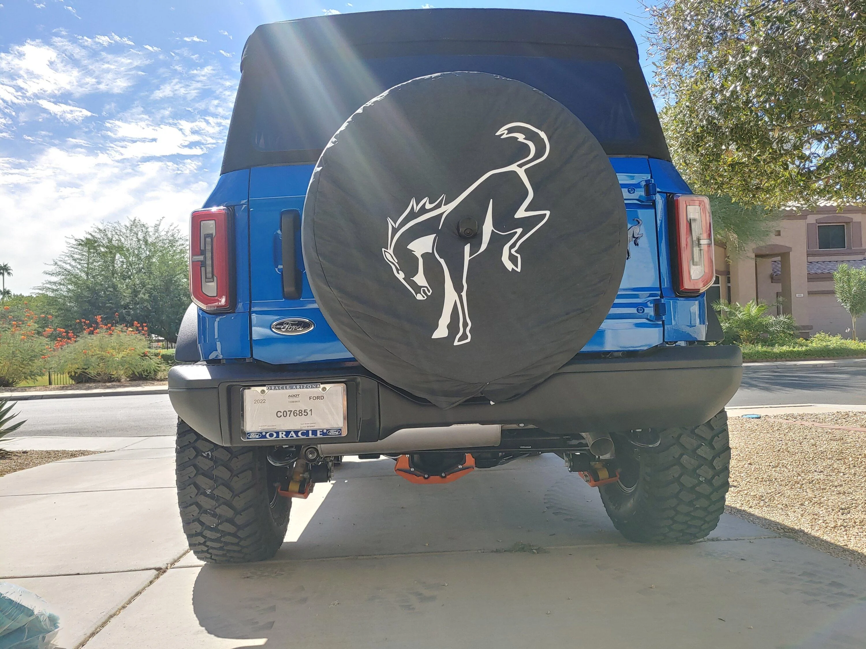

Oh, the Ford 32" spare tire cover does fit a 35. Mostly.
Ford Bronco My Badlands capable daily driver (Heretic) build 20221014_110530_HDR

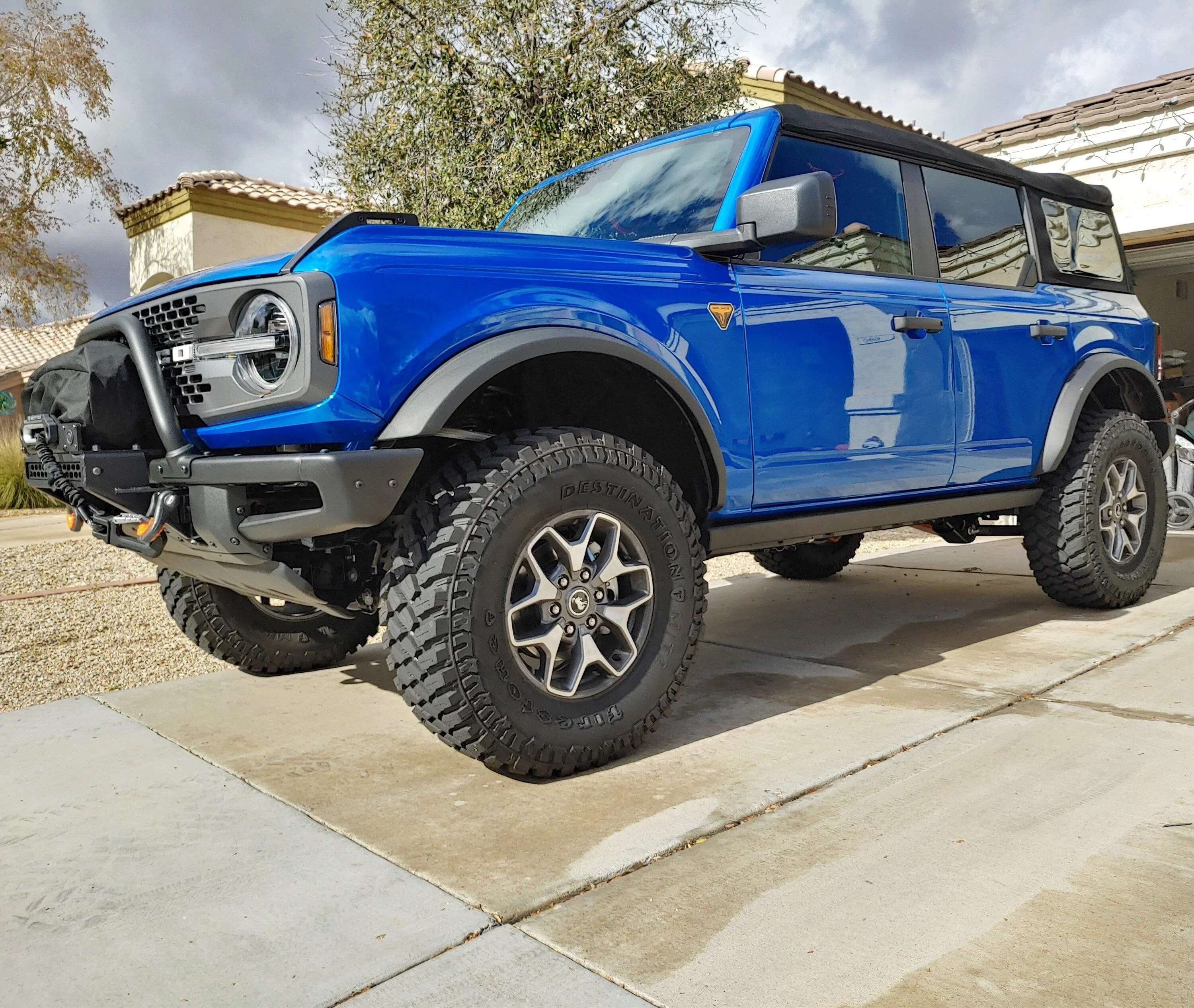

Installed the Broncbuster 1.5" suspension lift on December. A subtle boost. Still a tad higher in the back. Perfect.

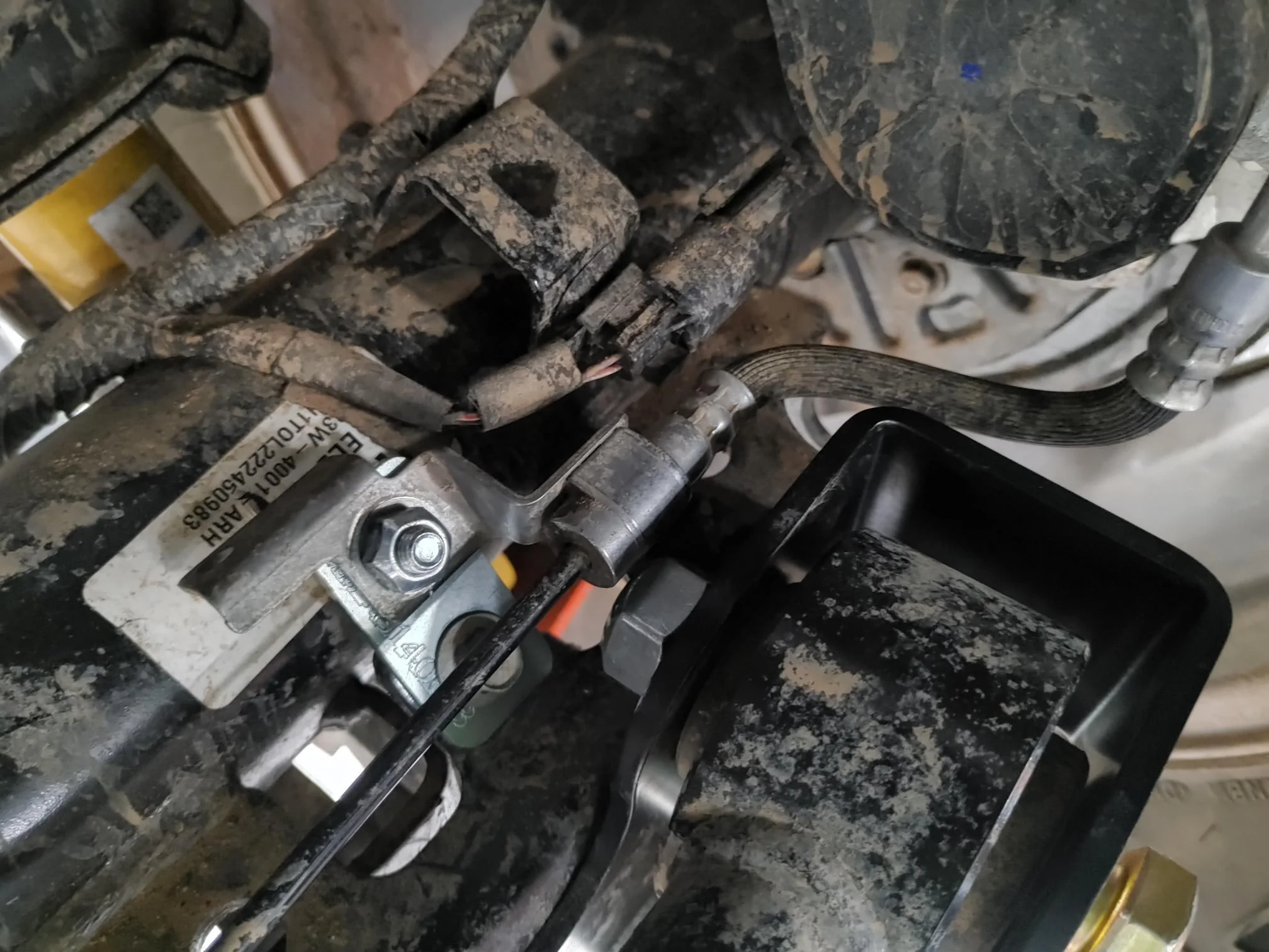

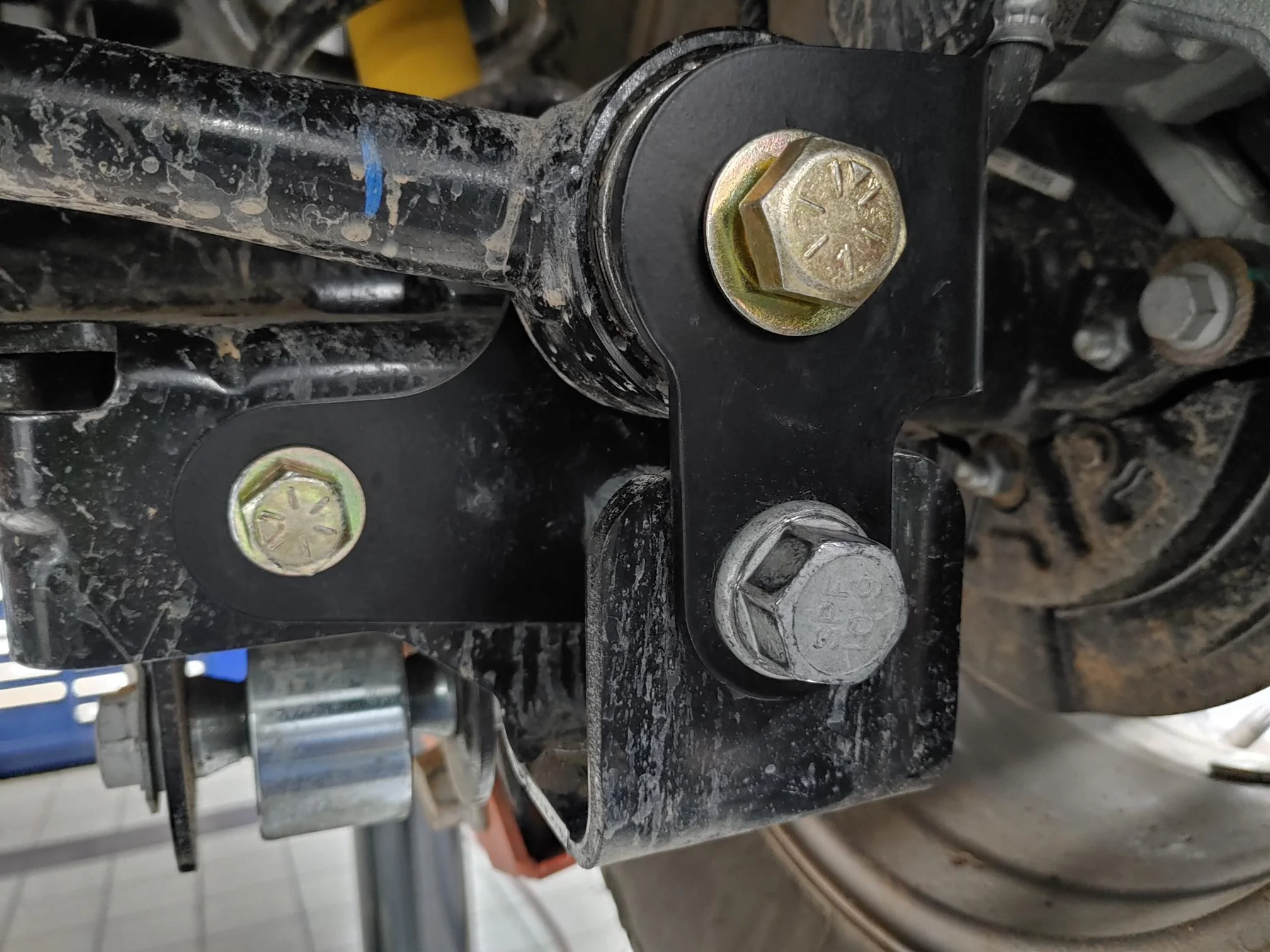

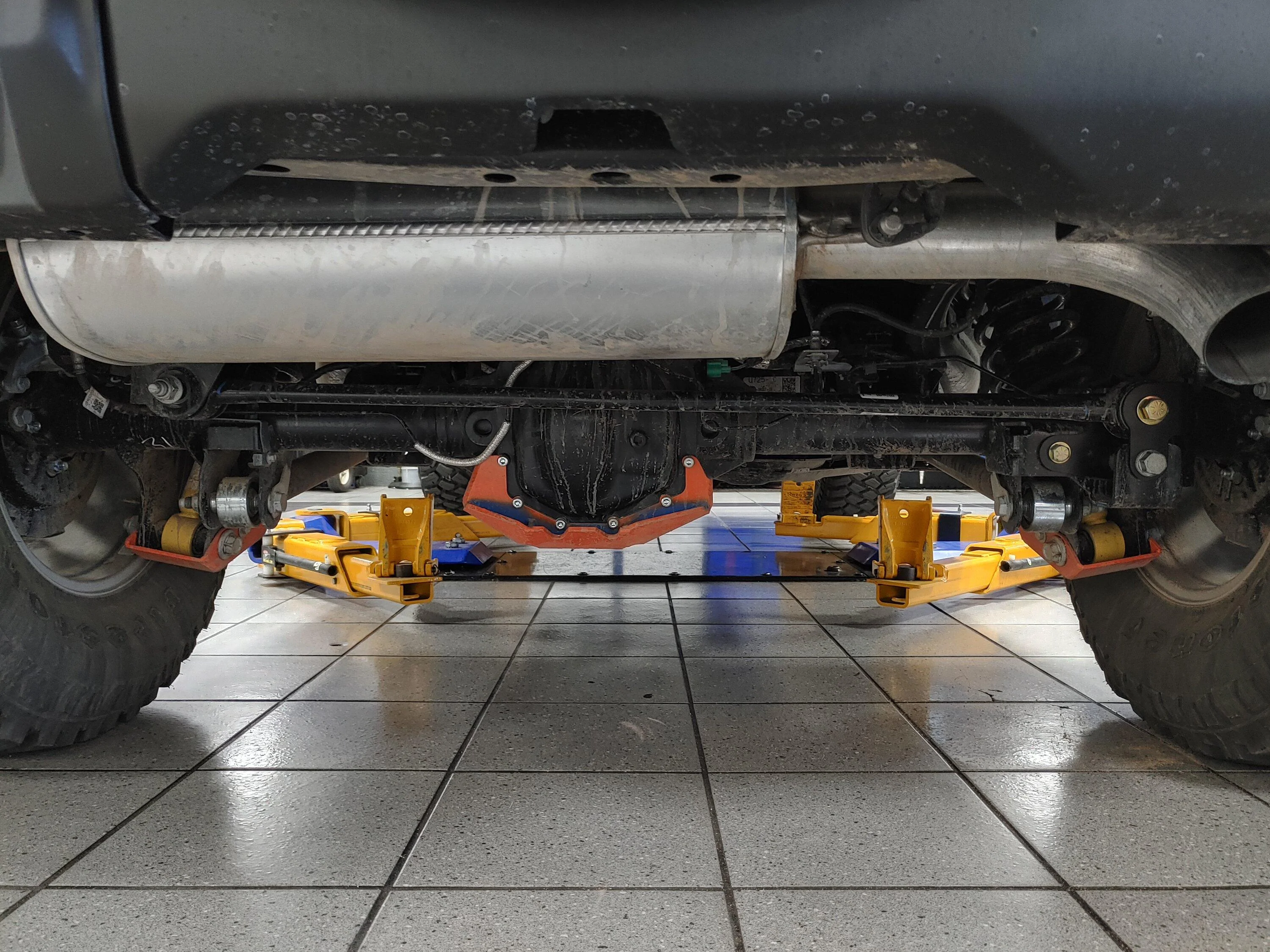

Winter time means Bronco time. Added the Rock Jock rear track bar relocation bracket. I noticed my axle was shifted slightly to the left at ride height, due to the lift, and after some random web surfing and window shopping, stumbled on the Rock Jock track bar kit. Install was easy enough, tight fit, but with some pry bars and heel bars it can be persuaded into place. Didn't get any before shots, but the axle, according to my eyeballs, is centered now.
After driving with the bracket installed, it made an incredible difference in handling. I had some body roll in the back, assumed because I have no sway bar, and lift, but the track bar bracket corrected the roller center geometry. I cant believe how much it changed the handling characteristics.

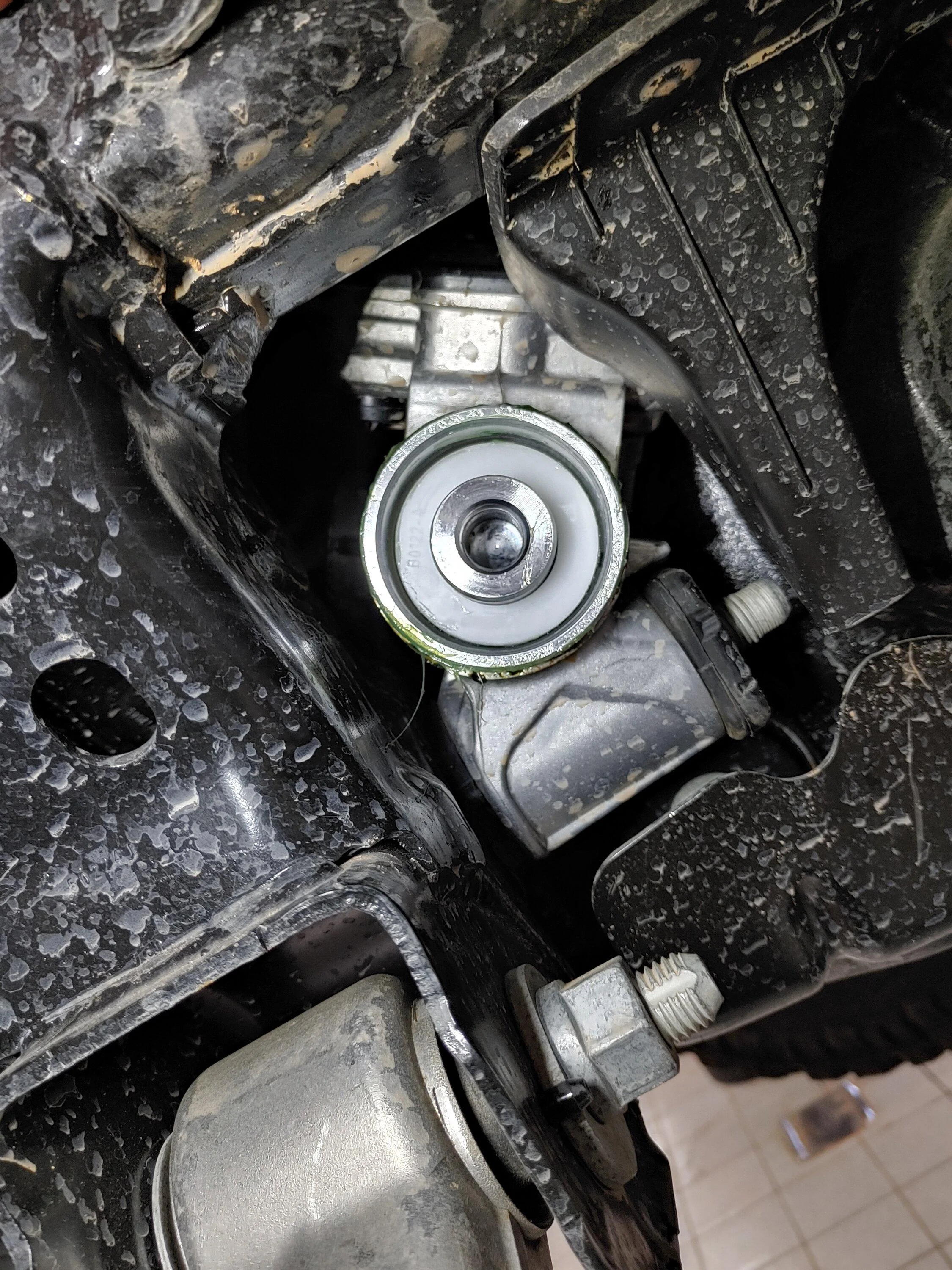

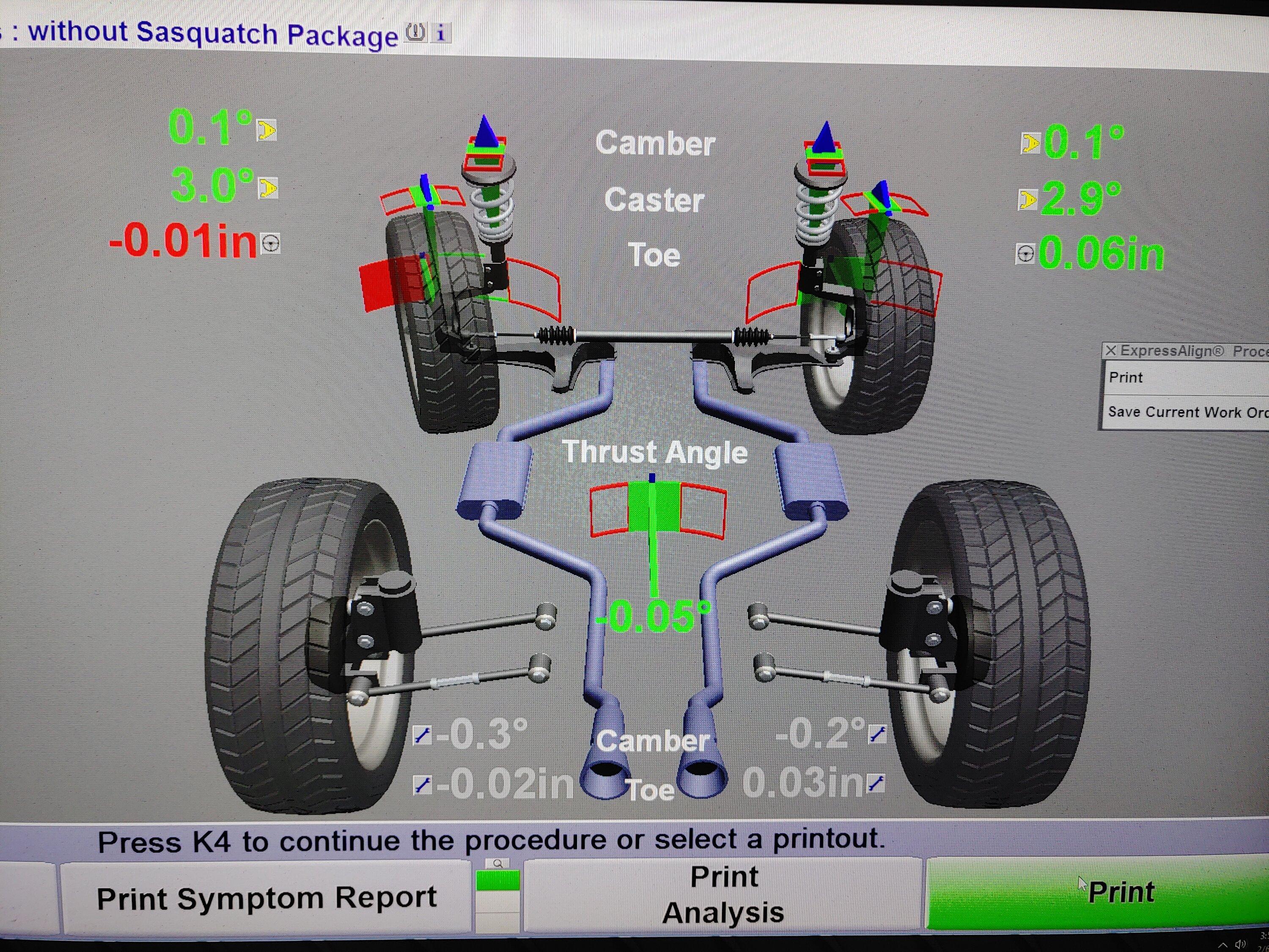

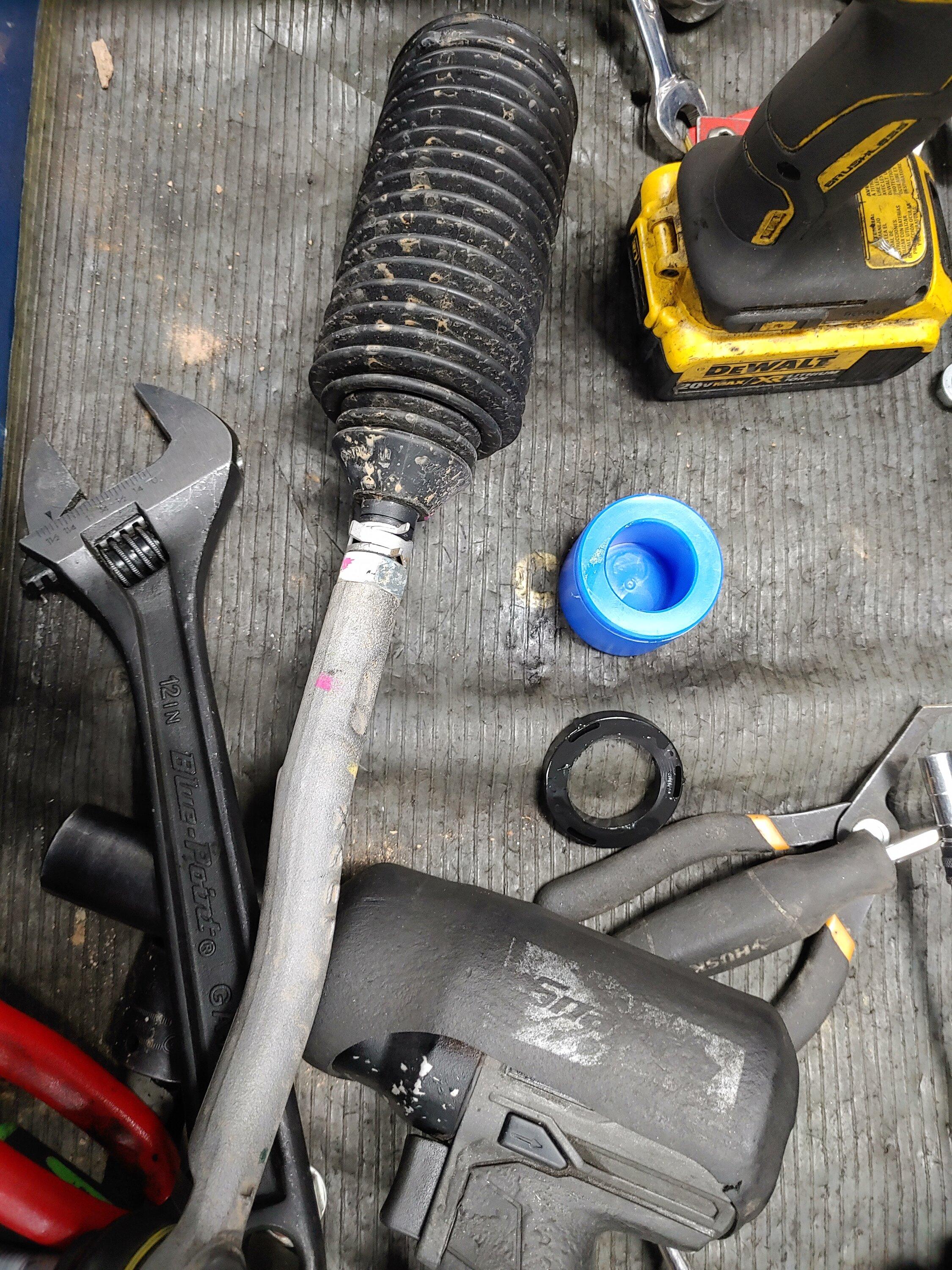

Finally, finally installed the Broncbuster steering rack bushing. It was a pretty easy install. Alignment measurements for reference/information, before correcting the toe.

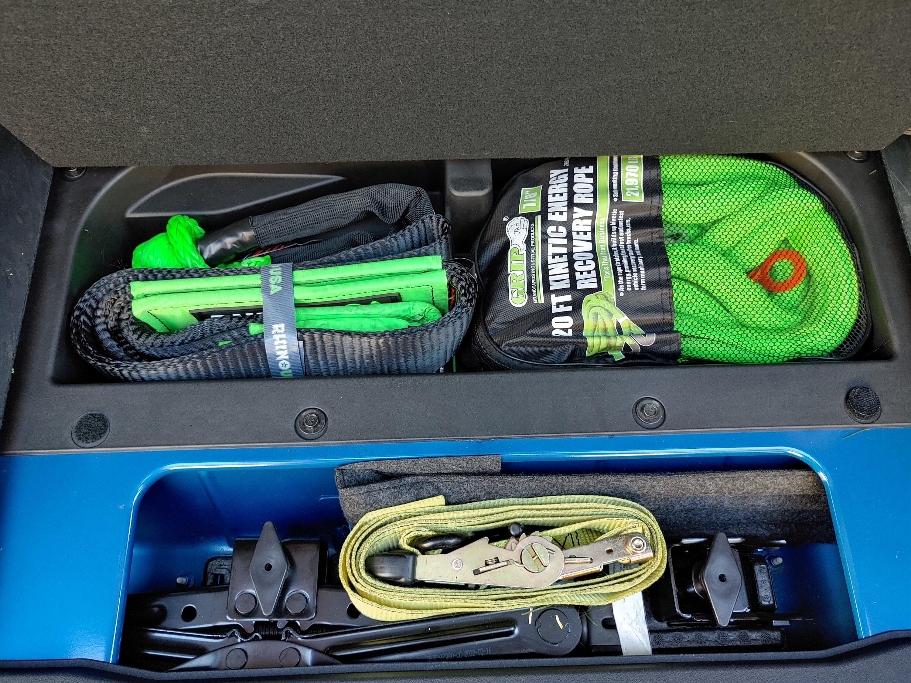

Can't forget all the straps and shackles and more straps. Aaaand that's it for storage.😆

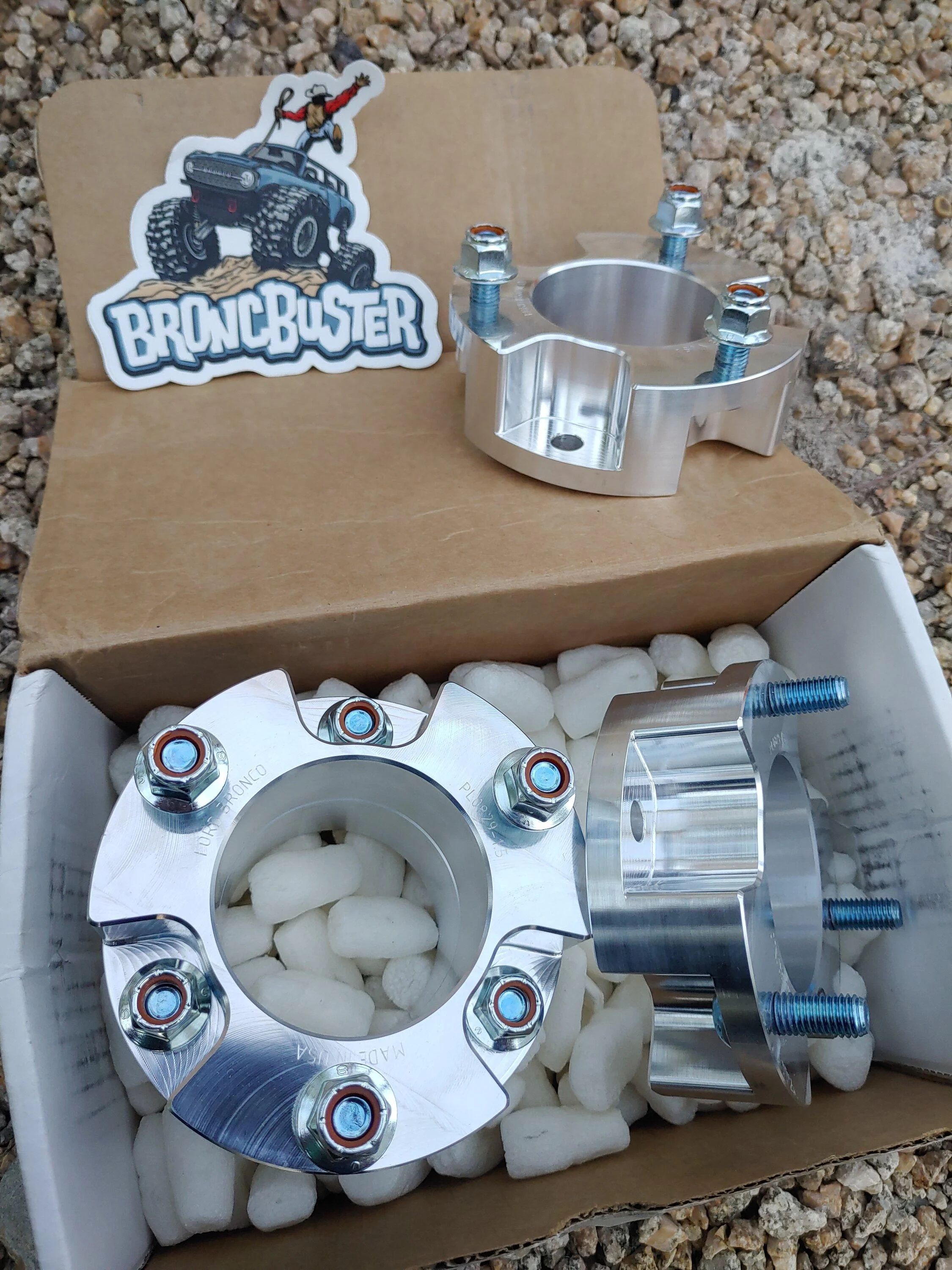

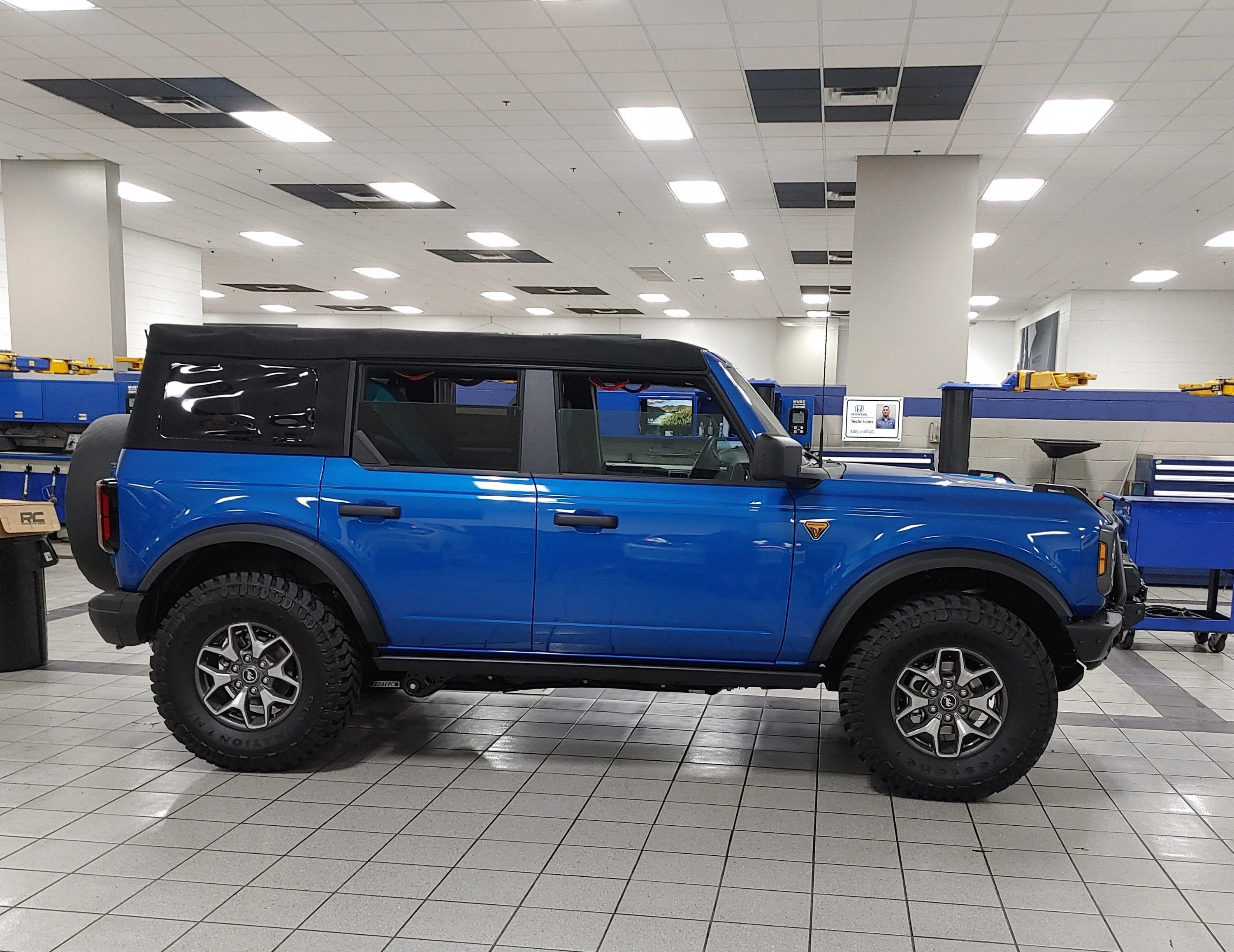

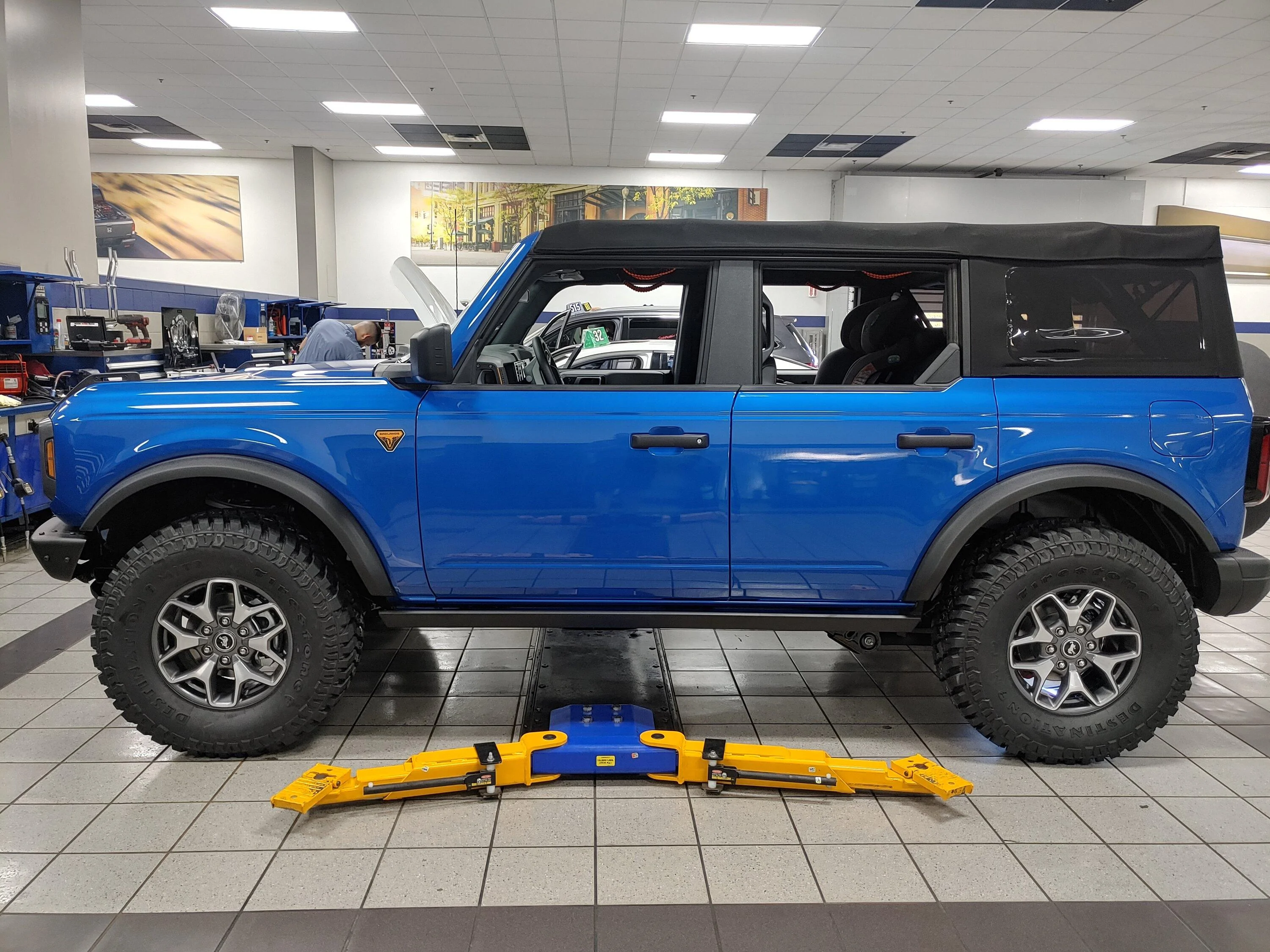

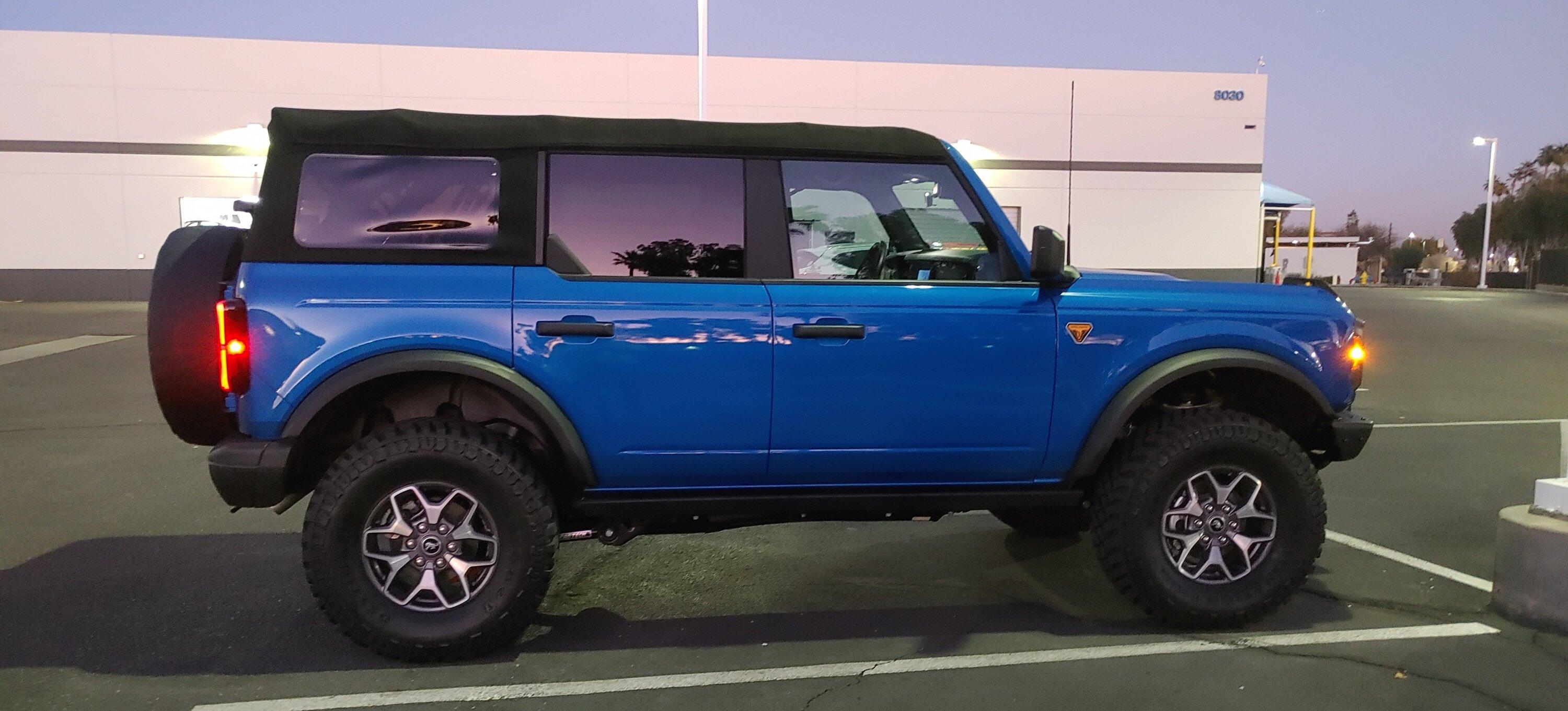

Got the Broncbuster 1.5" suspension (strut spacer) lift installed. Aligned it. Drives the same, just a bit taller.
Ford Bronco My Badlands capable daily driver (Heretic) build 20221121_165440
Ford Bronco My Badlands capable daily driver (Heretic) build 20221202_171321_HDR
I'll get some better shots. It is almost level. A hair taller in back. Perfect.

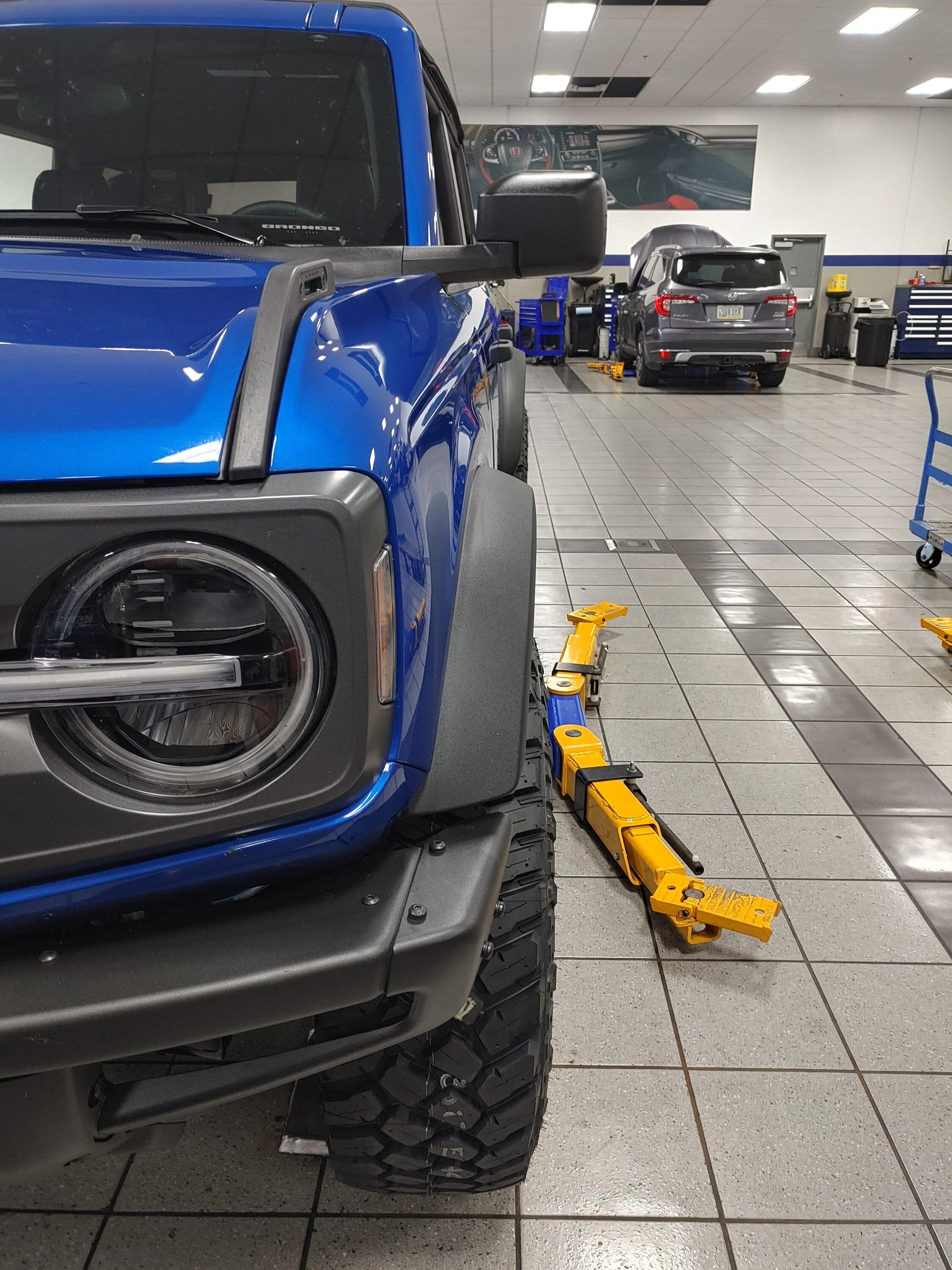

Front tire/fender clearance is about 7.5", and the rear clearance is 7.75".
According to my tape measure at work, I gained a couple inches at the gas tank skid plate.

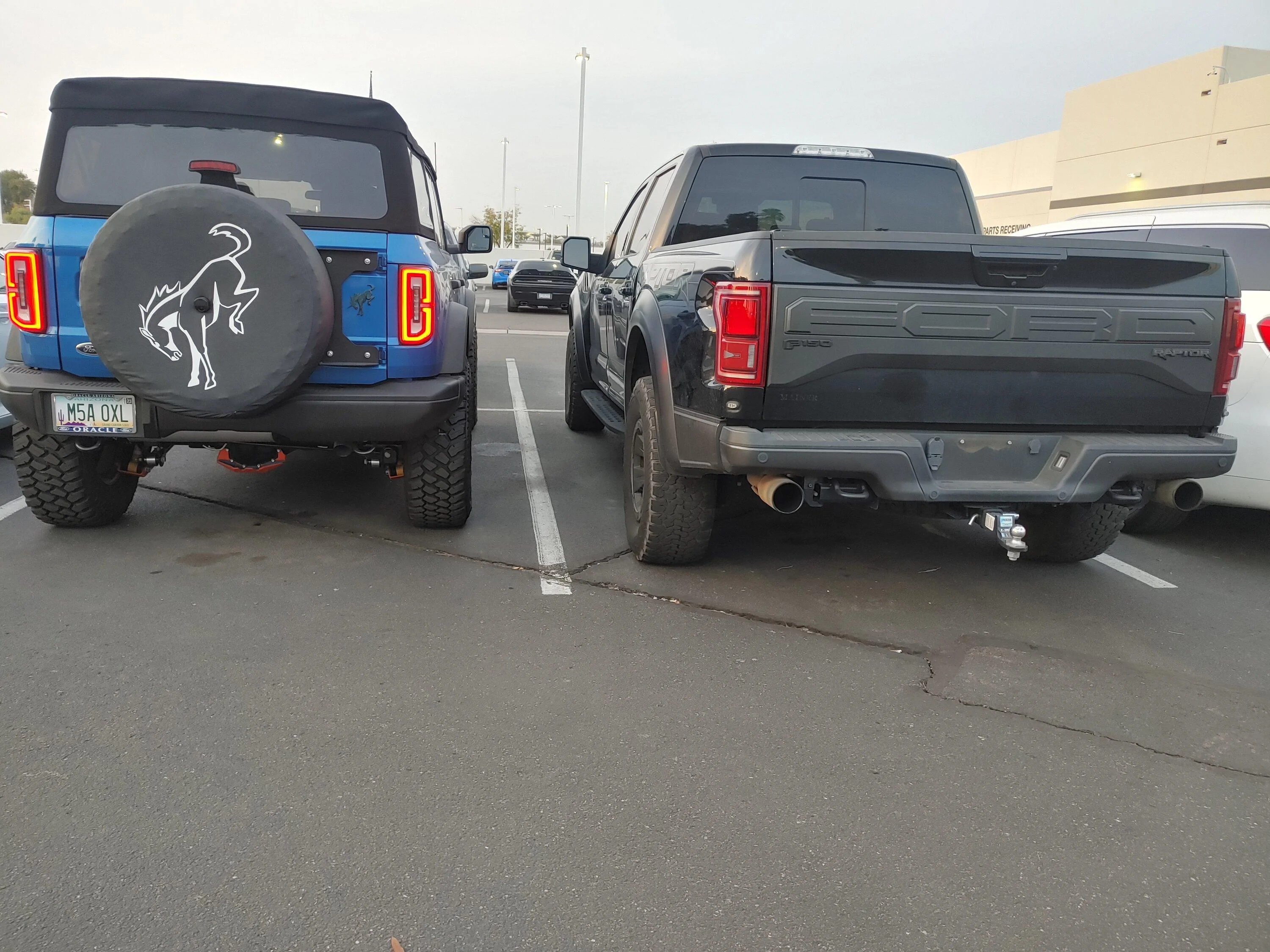

Here it is next to a Raptor.

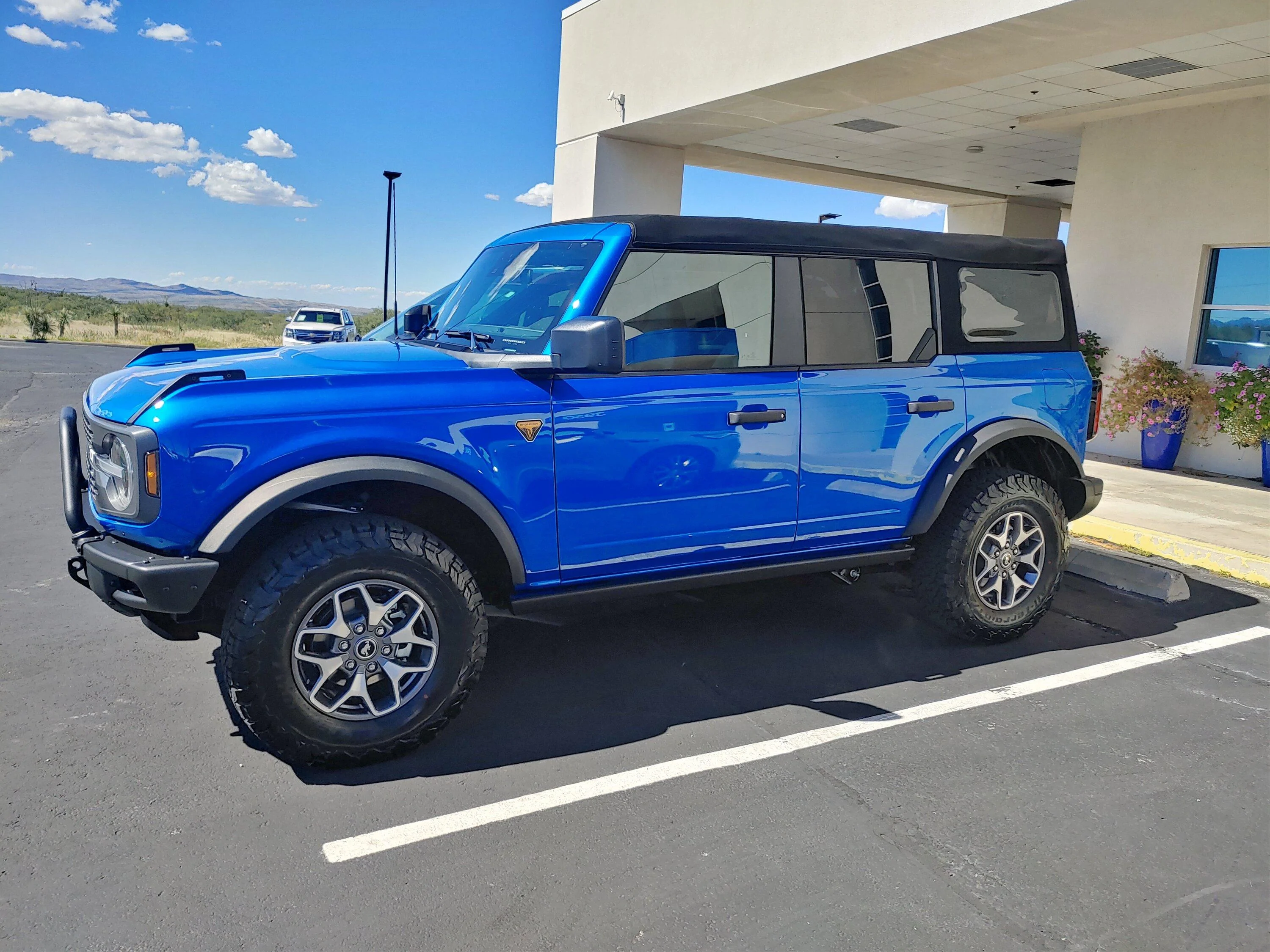

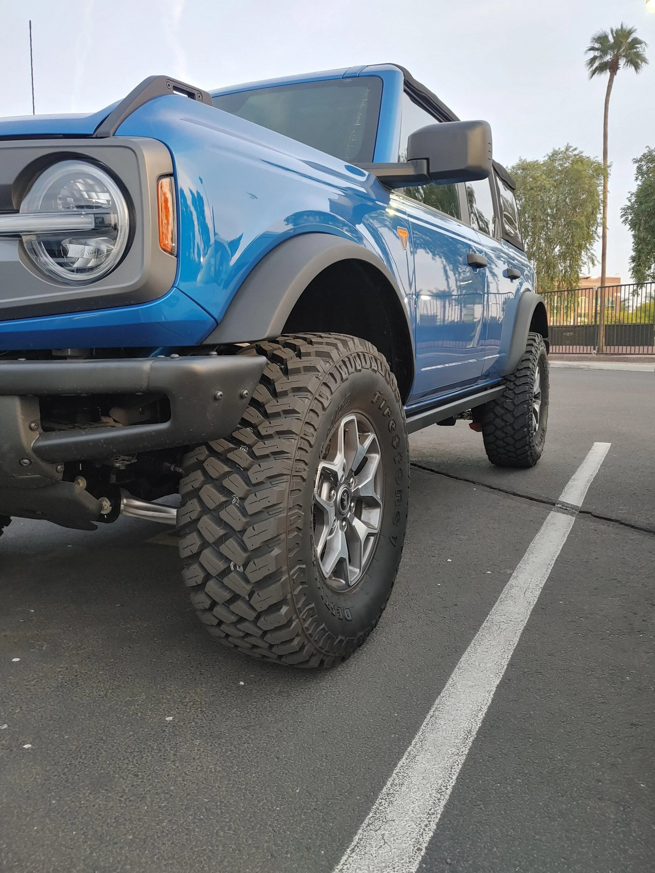

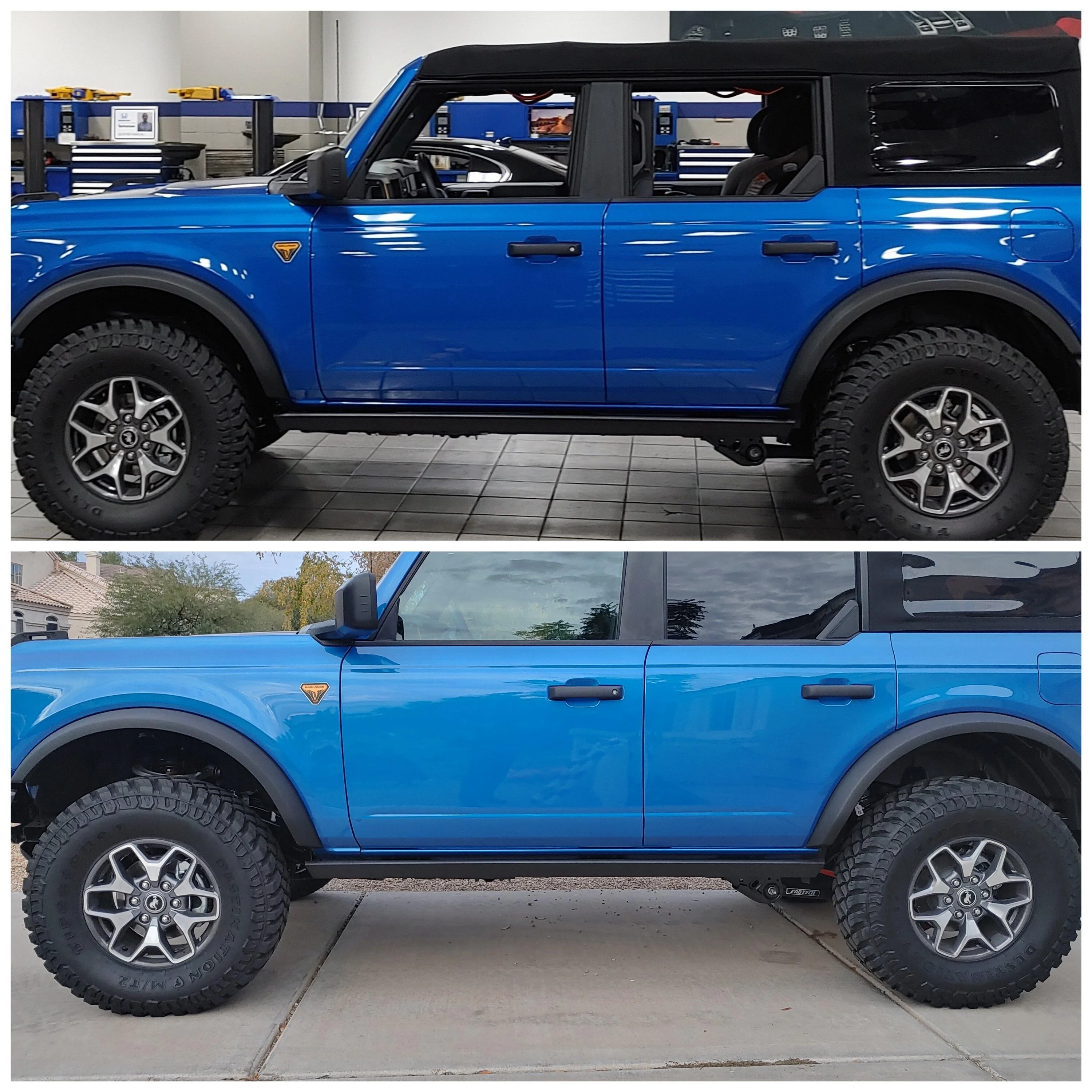

Before and after photos.
Top-before
Bottom-after lift
Subtle. 👍👍
