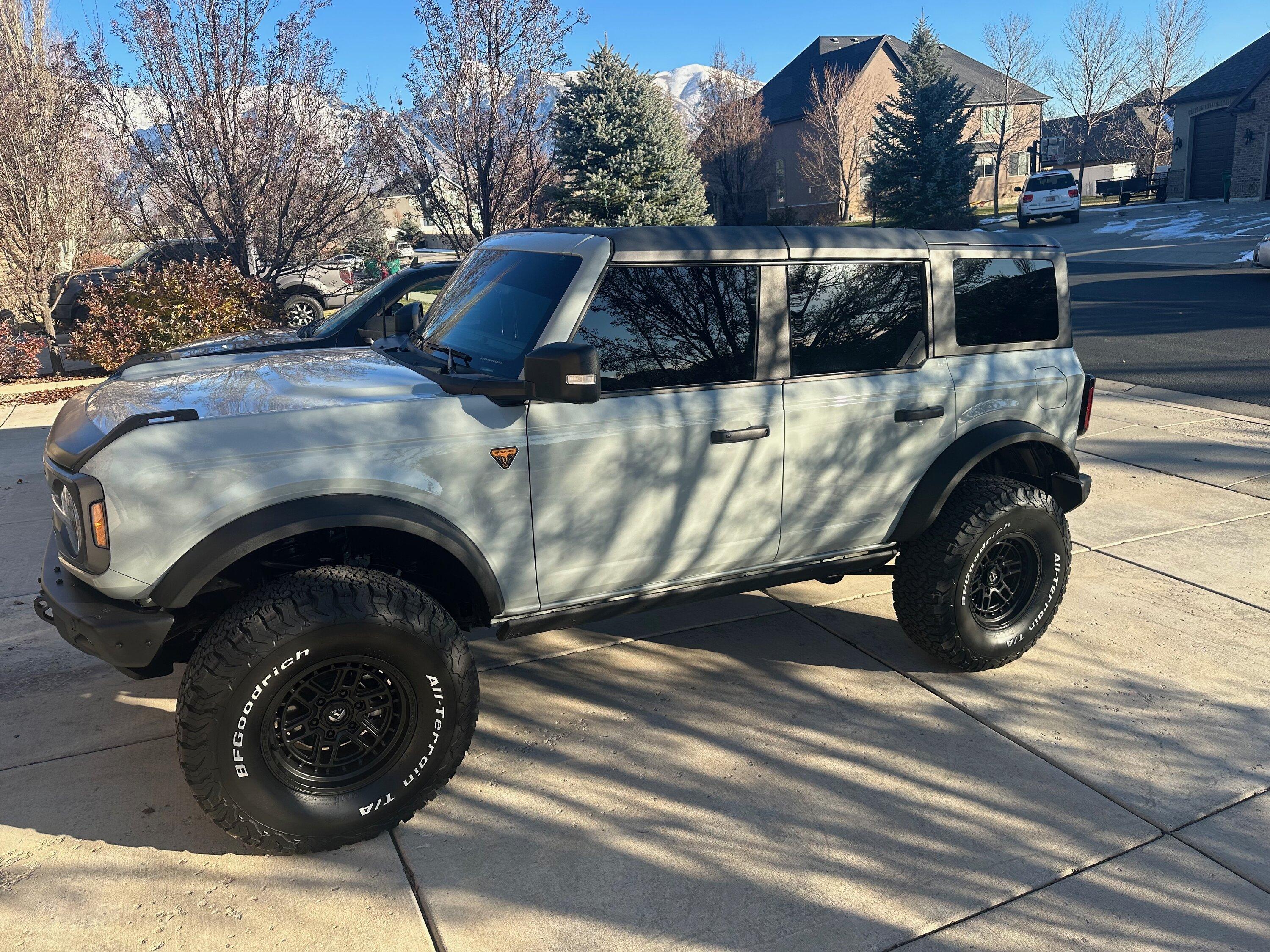

That looks really great. I would be curious to see what your CV angle is at full droop? Adding an inch of length from the top spacer will be close to CV joint bind I believe. Will the front CV joints hold up at this angle? I am no expert just asking.
its an aggressive angle but you shouldnt be rock crawling etc with a spacer lift. Of course it will lessen the overall life of the cv axles. You pay to play. Someone needs to come out with a bracket to drop the front diff lower to lessen the angle. Dropping the diff is relatively easy to do.

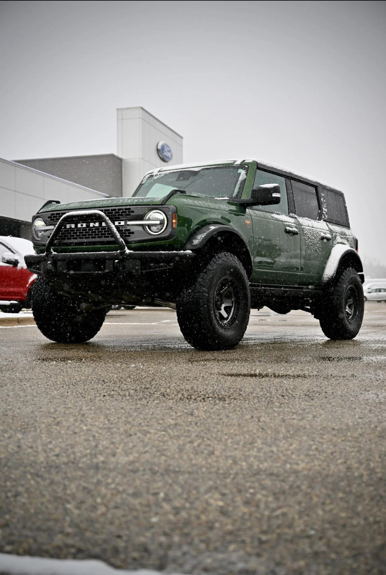

Anyone else purchase or install this kit?
My local dealer recommended it, and it looks pretty good.
I don't want to mess with the geometry too much and cause issues with those wonderful little tie rods.
I have this same kit from ReadyLift, with 37" BFG KO2's. I think it looks amazing. I've only had it for a month, and have not been off-road yet (but I can say I love these tires in the snow!). I too am concerned about the tie rods...It's this exact setup (spacer lift w/ 37's) that seems to be vulnerable. I've been debating adding the tie rod reinforcement sleeves (I think I'll end up doing that), and also carrying some spare inner tie rods in case they need replacing on the trail.
Any steering upgrades? hows the tie rods? upgraded?
