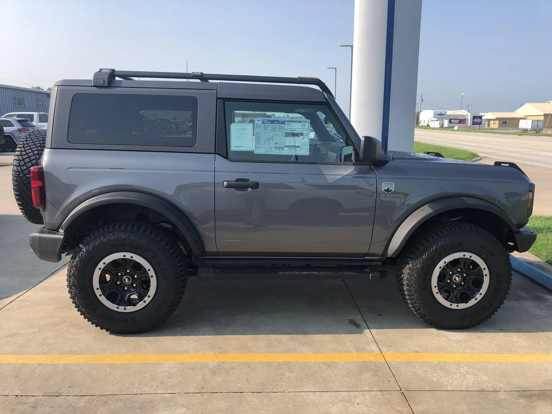

I read Jay's post as 2.5" in the front with all pieces, and 1.5" in the rear. Front has 1" more lift to achieve "level".
Peter
I’m completely ignorant on this stuff....does this mean it comes from the factory “not level”....the rear is higher than the front?
Yes, many vehicles from the factory have different height front and back. You will hear the term "rake" or "reverse rake", describing this state.
Rake is almost necessary on trucks, because of the designed carrying capacity of the truck bed. If the vehicle is "level" when unloaded, the headlights would be pointing up when the bed is loaded.
On other vehicles, it's less obvious and less of an issue, but everyone have their preferences on looks.

I see.
Thanks for that. Does the bronco have “much of” a rake? If I leveled it and then had a bunch of gear in back it was towing....would my headlights “point up”?
I don't think there is a very clear cut answer on this. So many different variables affect this, such as the weight you're carrying in the hatch, the tongue weight of your trailer, the combined weight of your driver and front row passenger, etc etc.
Here's my take, the Bronco's suspension is on the softer side, so the rear will likely "squat" more given the same weight being carried. As far as how much more or how much total, that's going to be different in every situation. I think the answer is largely subjective in this situation.

So, might be a stupid question(s), but...
  1. Is the Sasquatch package also raked, or already leveled?
  2. If it can/should be leveled, what are our options, if any?
All of the Bronco series have a factory rake. Because the Bronco suspension is soft and designed for off-road use, any significant amount of payload in the cargo bay or on the tow tongue is going to cause the rear end to sag. I personally would leave it alone, but I know many people disagree. It's more of a personal preference.
