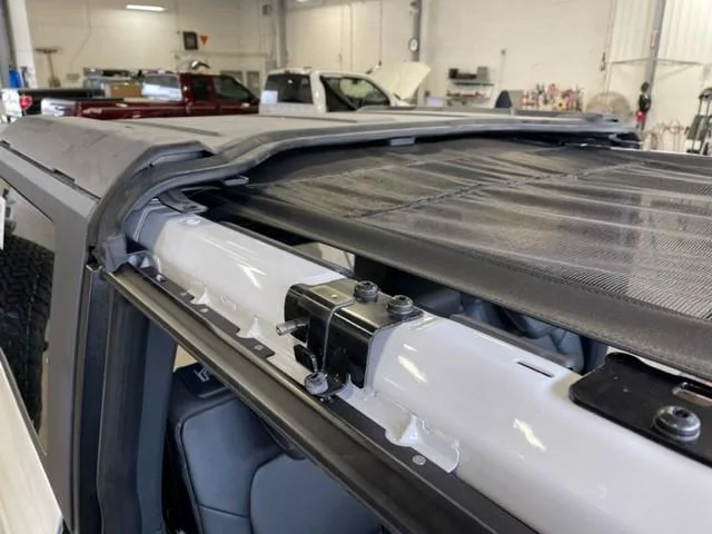

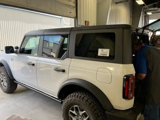

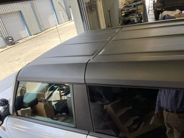

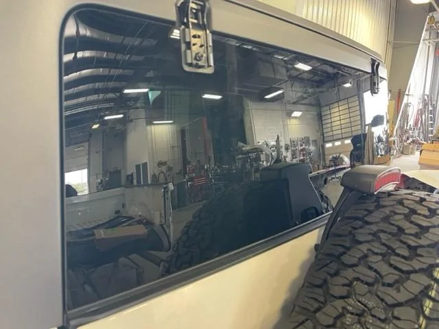

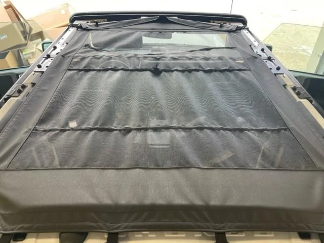

Finally installed the hard top today. After figuring out the bimini was a PITA to try and do installed, it went bye bye. It's highly probable I'll not take the it off any further than the front two panels anyway. Brackets, remove soft top side window front attachment panels, a few bolts and done. Since I was built pre-prep package we're just going to plug the wiper hole in the glass once we find the right size. The next one will take about 45 minutes after the glass is glued in the cap.
Ford Bronco Top swap done > factory soft top to MIC hardtop htswap4
Ford Bronco Top swap done > factory soft top to MIC hardtop htswap5
Ford Bronco Top swap done > factory soft top to MIC hardtop htswap6
Ford Bronco Top swap done > factory soft top to MIC hardtop htswap2
Ford Bronco Top swap done > factory soft top to MIC hardtop htswap1
