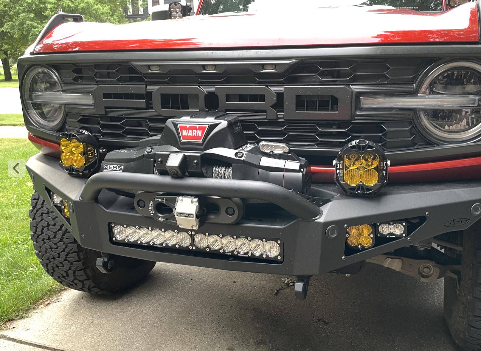

I recently relocated my camera forward and lower in my bumper to accommodate replacing my OEM bumper with a winch capable bumper. Today I noticed when pulling into a parking spot, that the parking space lines don't line up in the 360 view - which I'm attributed to the cameras new location (at least I haven't noticed it prior to today).
Is there an option to calibrate this so that the system adjusts for the new camera location?
view from the 360 -
Ford Bronco 360 camera calibration option after relocating? Screenshot 2025-07-02 at 8.44.25 PM
Relocated camera location -
Ford Bronco 360 camera calibration option after relocating? Screenshot 2025-07-02 at 8.45.38 PM

There is a camera alignment procedure, but it likely either won’t work, or won’t fix the image. It’s not meant for the camera to be moved.
