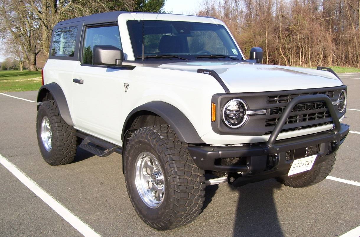

I ran them for a year and a half before moving up to 37" KO2's. I thought they drove fine and handled fine. They are heavy and do make more noise because of the mud tread but nothing that bothered me at all. I was getting almost 18 mpg with them on a 2.7 Sas truck so no complaints.

Did you have any rubbing issues or did you need to do any suspension mods to fit? I see you have different wheels, did they require a different offset to the stock sasquatch tires?
Thx again, your rig looks amazing btw

The wheels are 17x9 with -6 offset so they stick out almost 1-1/2" more than stock Sas. They did rub on the mudflaps so I trimmed them but no rubbing anywhere else. They should be fine with stock Sas wheels since they are just a little bit larger (stock Sas tires are actually closer to 34" where most 35's are around 34.5"). I was surprised they felt as good as they did since everyone complains about mud tires. You'll spin if you try to pull out too fast in the rain, but that's true with most tires anyway. I drive without the radio or any music on and I didn't think they sounded too bad, but I could see people turning their heads so I know they made some noise.
