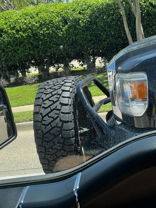

Roof it is then. I don't imagine you could pull off mounting one on the hood like those old pizza cutters on the 60s models.
I imagine not, my phone in the center dash accessory mount blocks 20% of the windshield...
