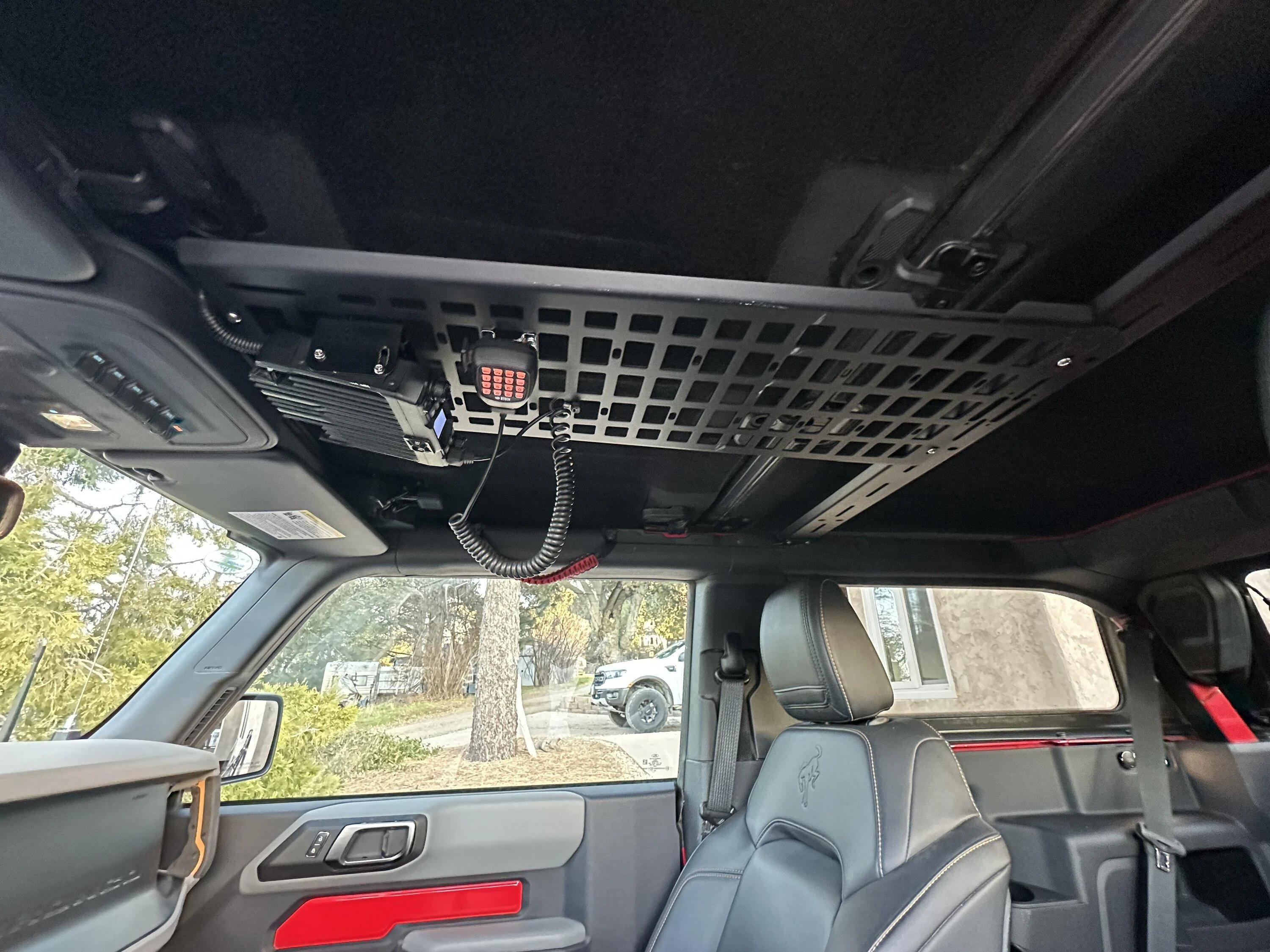

I used a Molle plate overhead to mount my BTech radio. Ran the power from switch #6 and the antenna cable up the A pillar. Molle from JCR Off Road and the antennas mount from Mountians 2 Metal. The problem mounting the radio under the steering wheel is the damage to your knees in a head-on or tree/pole crash. I know, in another type vehicle I hit a tree and the knees hit the under panel hard. Broke both kneecaps. Seatbelt on, good energy absorption by the front end and I lived...and walked again. BAD place to locate the radio.

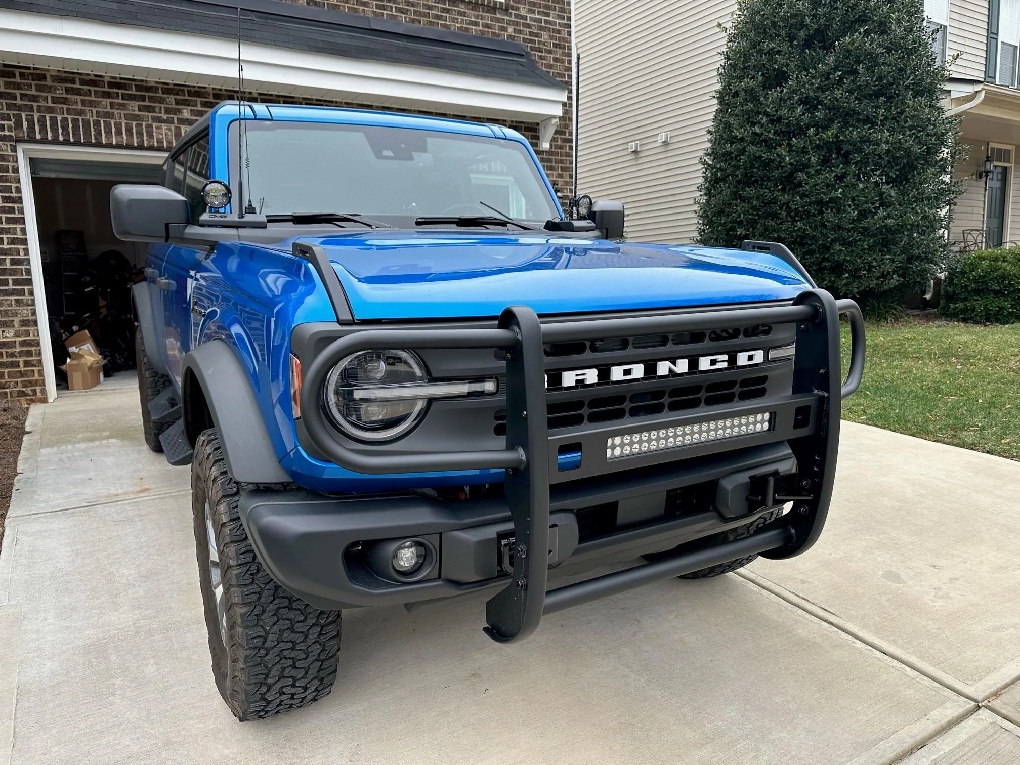

As for antennas, I had them installed on two DV8 mounts at the A-pillars (in the photo), but ground plane was/is a bear so I'll likely move to fender brackets. I'll post pics of radio and antenna installs if interested (planning to do a write up and post at some point). Also, I saw lots of good general info in Mammal's link.
