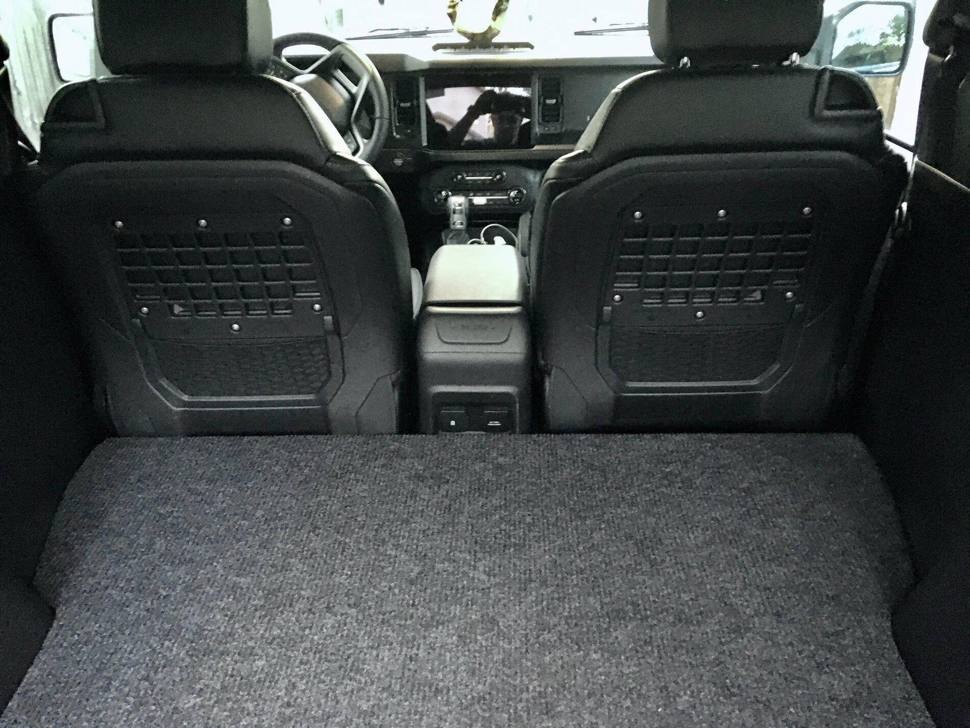

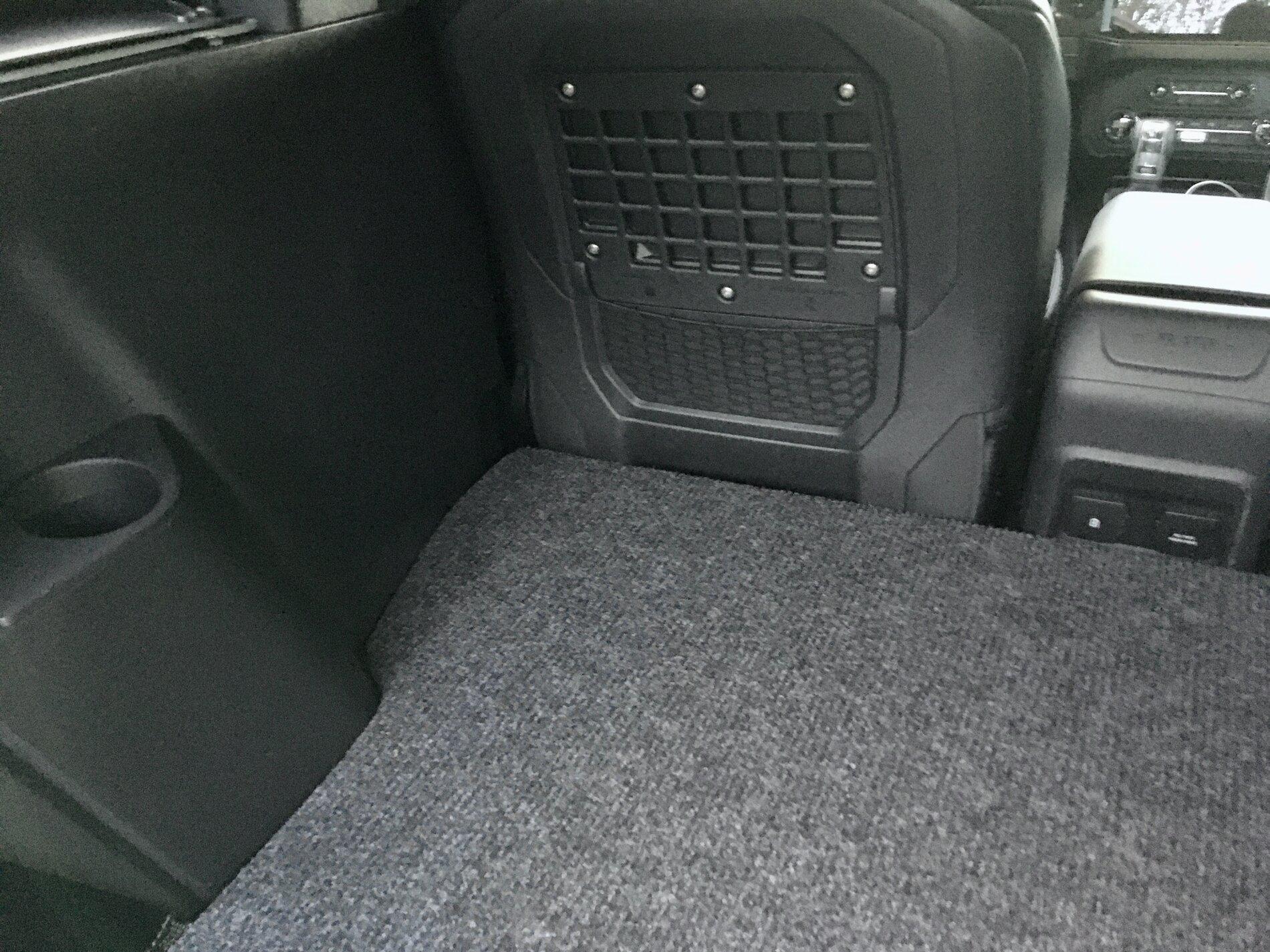

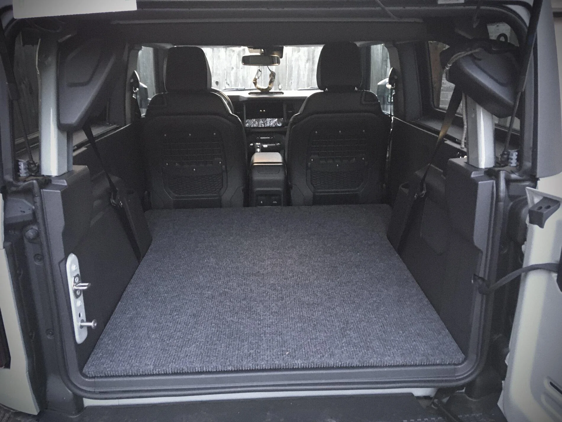

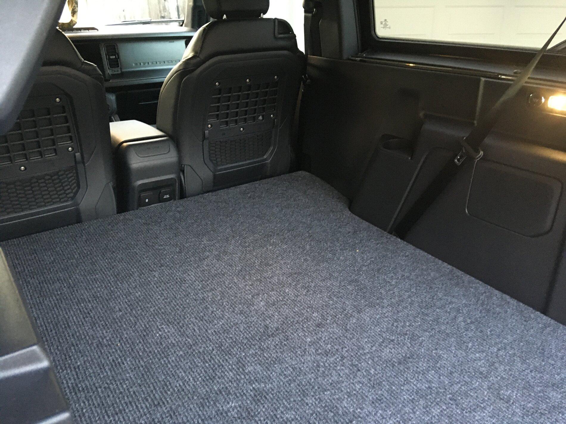

Nuked my back seats on my 2-Door and made a deck from wood to fit the contour. The deck fit just fine from the front to the back with out bolting down. Between the bolt tops, side seatbelt brackets and the rear tailgate lip it just fit level. Covered in a Lowes outdoor 5x7 rug cut down to fit. I have a working trapdoor that just needs just cut out that the carpet is still covering. Simple KISS design. Had to unbolt the speaker to get it through the back door.

When I pull it out tomorrow, I'll take some measurement on the size, but roughly it is 42.125 x 53 inches, then the side wings at the front by the doors. Get some other pics of the trap door. I like the clean look and since it is not bolted down I can lift it just enough to get to the jack and the under storage.

Not sure if it is risk to the bolt posts. They seem to be built like a tank and would take a ton of force to distort from downward pressure. I put the nuts back on them and it makes even more surface area for the board to contact. The deck form fits with about a 1/4 inch slack around the edges and the carpet fills in that for almost a pressed in fit, so it does not shift. I will add some support boards that will tie in with the front to support over the back seat feet area.
