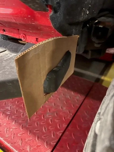

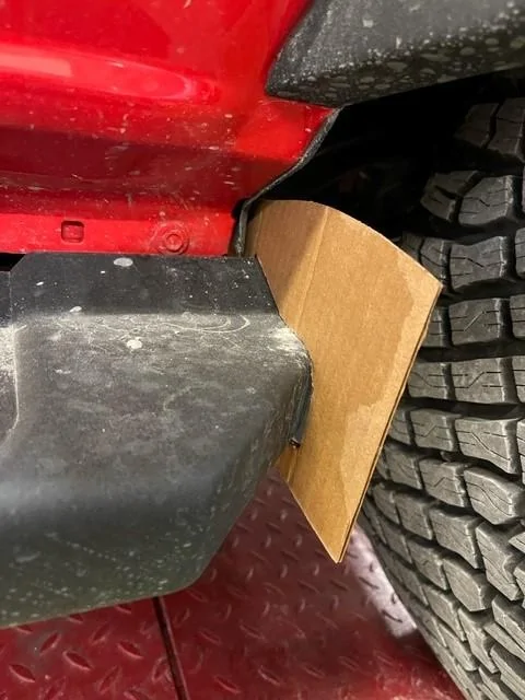

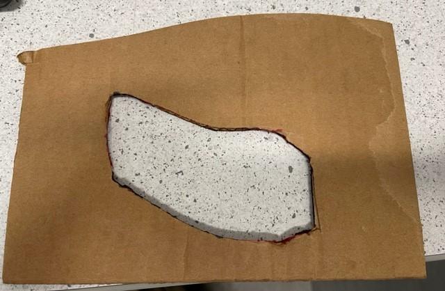

OK, here's the secret template. The way he's doing these is simple and accounts for mounting variation between vehicles.
The template is pushed over the end of the board, mud flap installed on vehicle then the template is taped to the flap, flap removed and can then be cut. It's slightly undersize to the finished hole but has worked well for the two we've done.

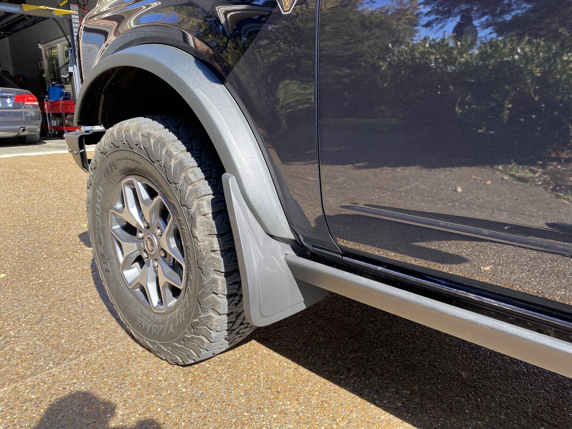

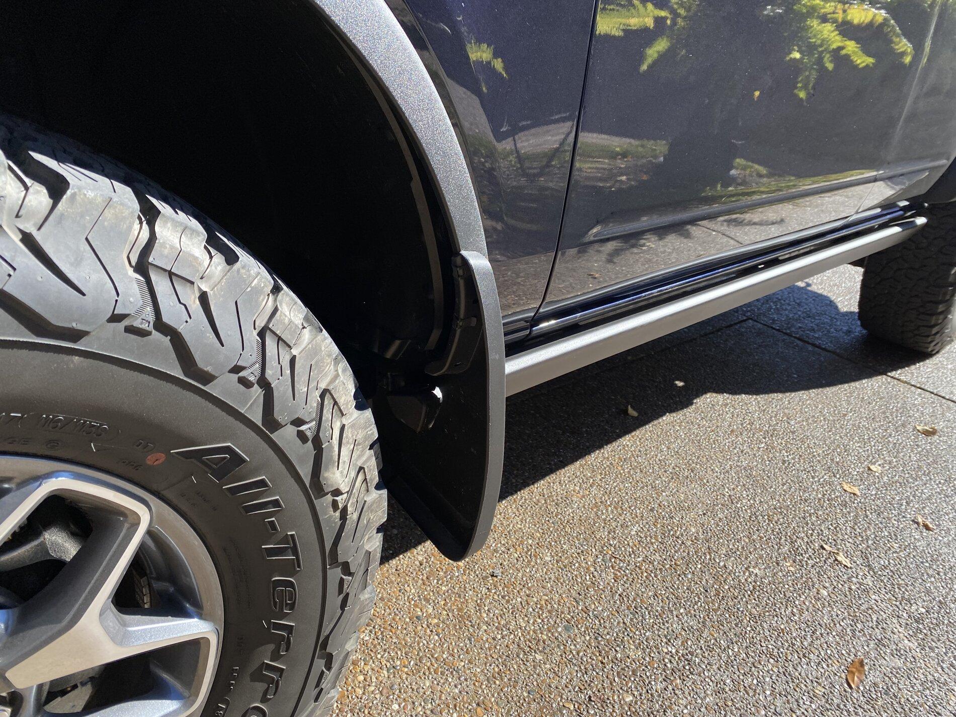

This may have already been covered elsewhere, but I cut holes in the OEM splash guards, and that allowed them to be installed, even with rock rails in place. I’ll probably order a second set and do it again, this time with a little more finesse on the cutting.
If you could make a printable template on where to cut, that would be awesome.

That would have helped a lot. If I do it again, I will. I also need to do some YouTube searching for the cleanest way to cut through thick plastic. I found it difficult to do without it looking like shit.

I like how they stick out just further than the fender flares? It that how they normally look if you weren't running the rock rails?

As far as I know, yes. Really easy to install. The instructions actually called for holes to be drilled in the fender flares, but I skipped that step.
