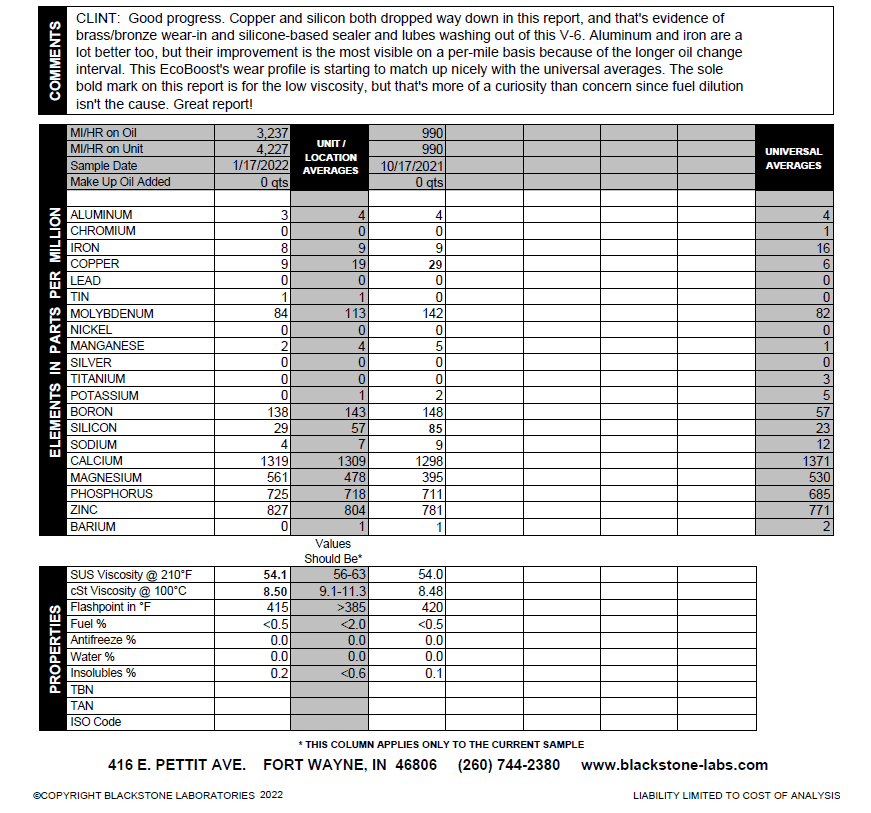

Updated on 1/26/2022 to show results from second analysis.
In short, everything looked good. I've attached my report as a reference.
I work at a natural gas transmission company, and we run oil analysis on ~350 reciprocating and turbine engines on a monthly basis. It's allowed us to address a lot of issues over the years, before they could result in catastrophic failure. I'm a big believer in doing it at least once a year on my cars. At $30/analysis, it's cheap insurance.
Ford Bronco Update: 2nd Blackstone Oil Analysis Results (2.7 Bronco) @ 4,000 miles (3000 on Oil) 1643221597075

I sent a sample to Blackstone for analysis after my first 1,000 mile oil change. In short, everything looked good. I've attached my report as a reference.

Getting a report is one thing, but what of us that have no idea how to interpret it?
Yeah, what do you learn from the oil report that is "actionable"? Change oil brands? Change filter brands?
Depending on the condition of the oil itself, they could tell you to shorten or lengthen time between oil changes.
Antifreeze in the oil could indicate a head gasket or intake manifold gasket leak. Fuel in the oil could indicate a fuel injector issue. Heavy metals could indicate excessive bearing wear.
I think they’d give you a heads up in the Comments section.
