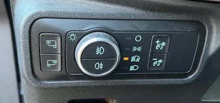

No turn signal. Ford calls it a spot light. You will need the correct switch panel to operate them. Intended for off road, they only work up to 5mph. There are aftermarket units that have turn indicators.

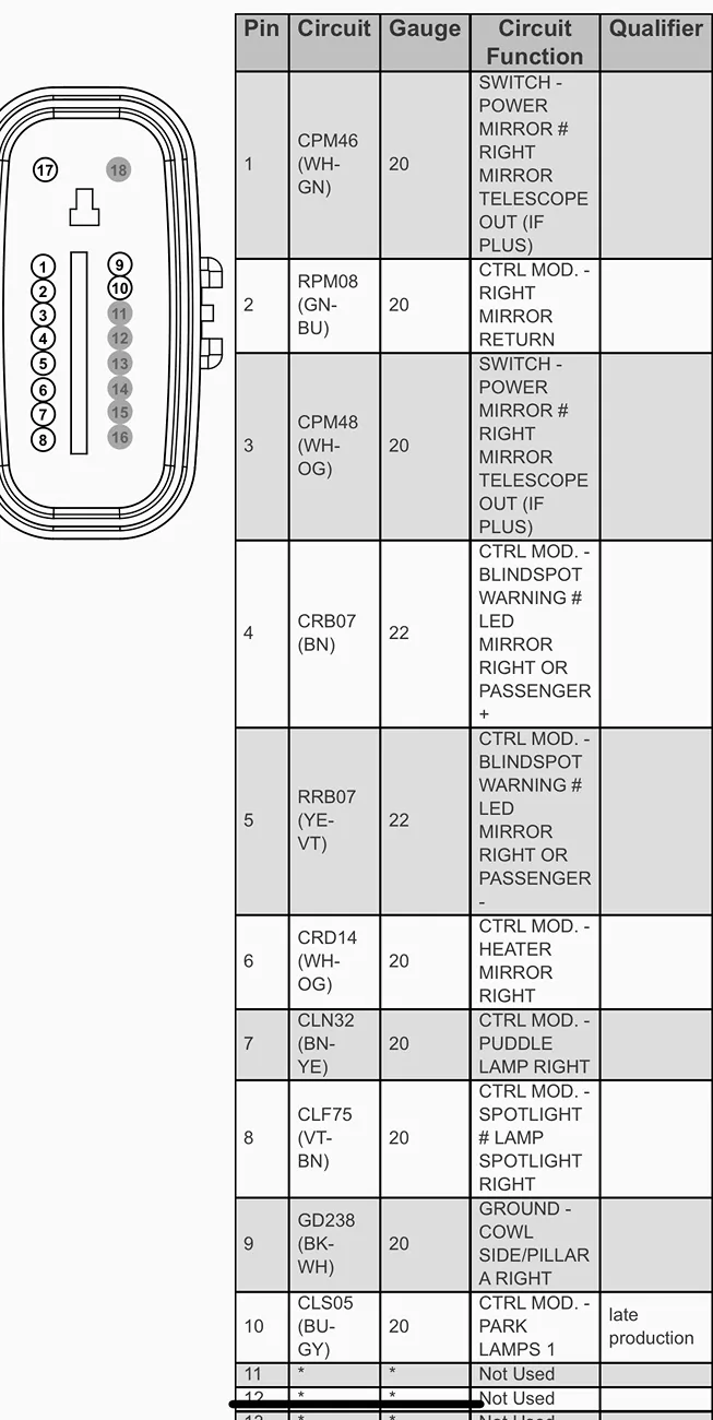

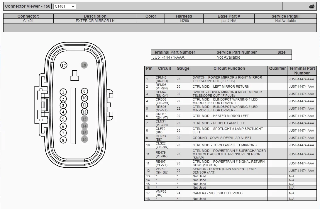

I don‘t think the puddle lamps will just work. if your Bronco did not come with the option, then you are probably missing the wires to connect them, and you would have to enable the feature in the software using FORScan. Otherwise, you would need to run new wires like from an Aux switch.
The C1400/1401 wire connectors for each mirror are located in the engine bay near the hood hinges. You can check the mirror side of those connectors to see if the needed pins/wires are populated:
Left:

Right:
Ford Bronco 2025 Big Bend Side Mirrors with Lights and Puddle Lights Replacements 1777926139947-bu
