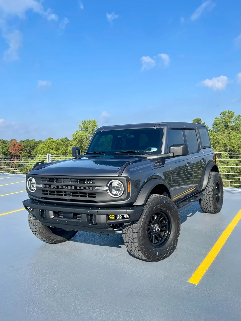

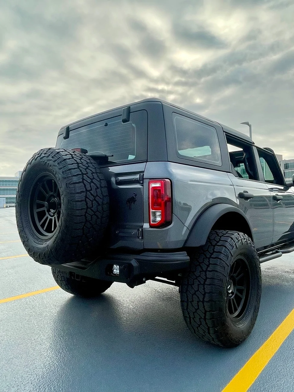

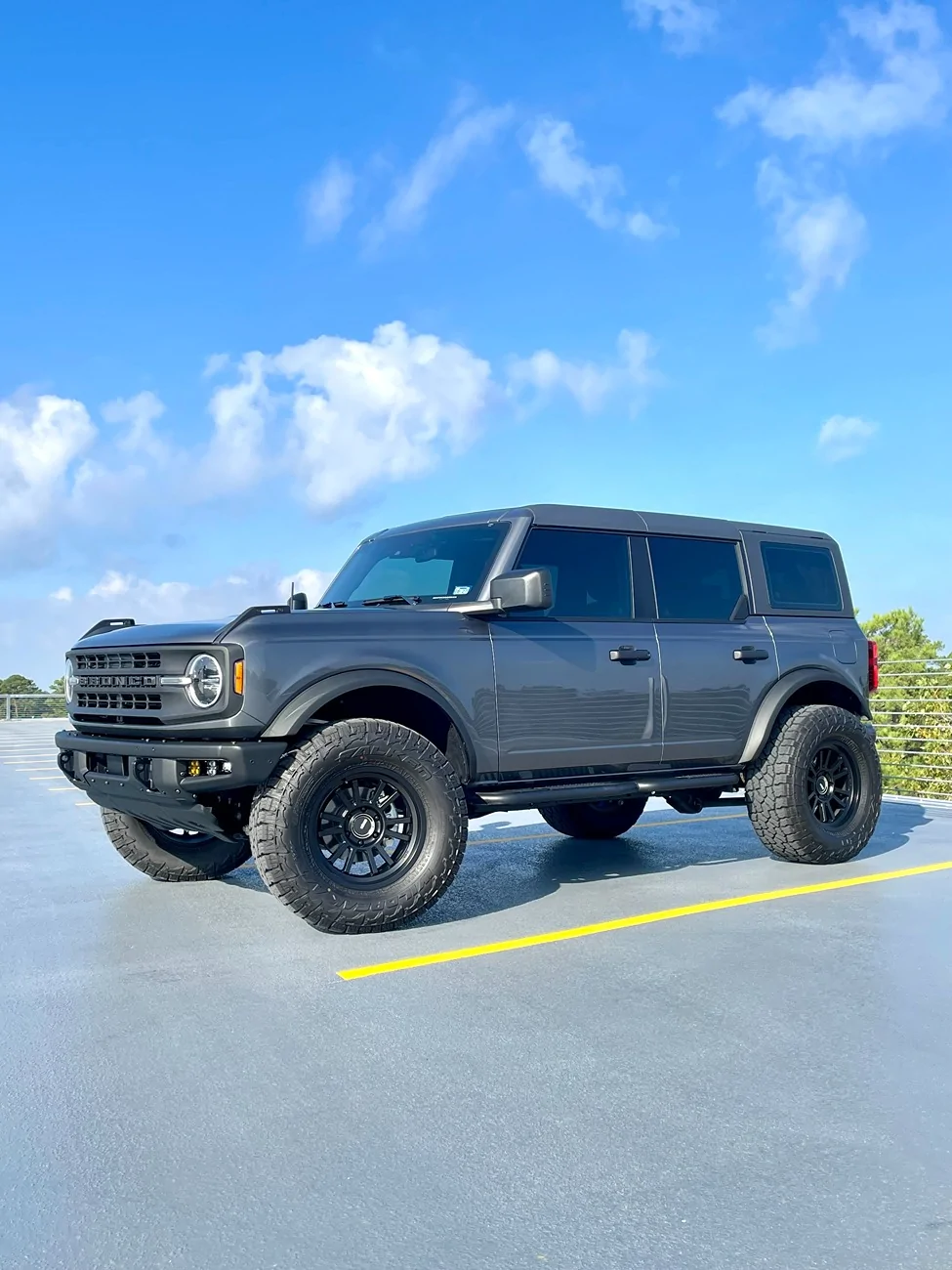

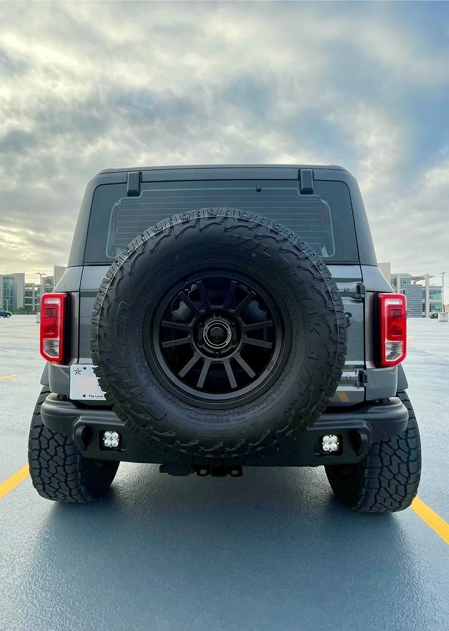

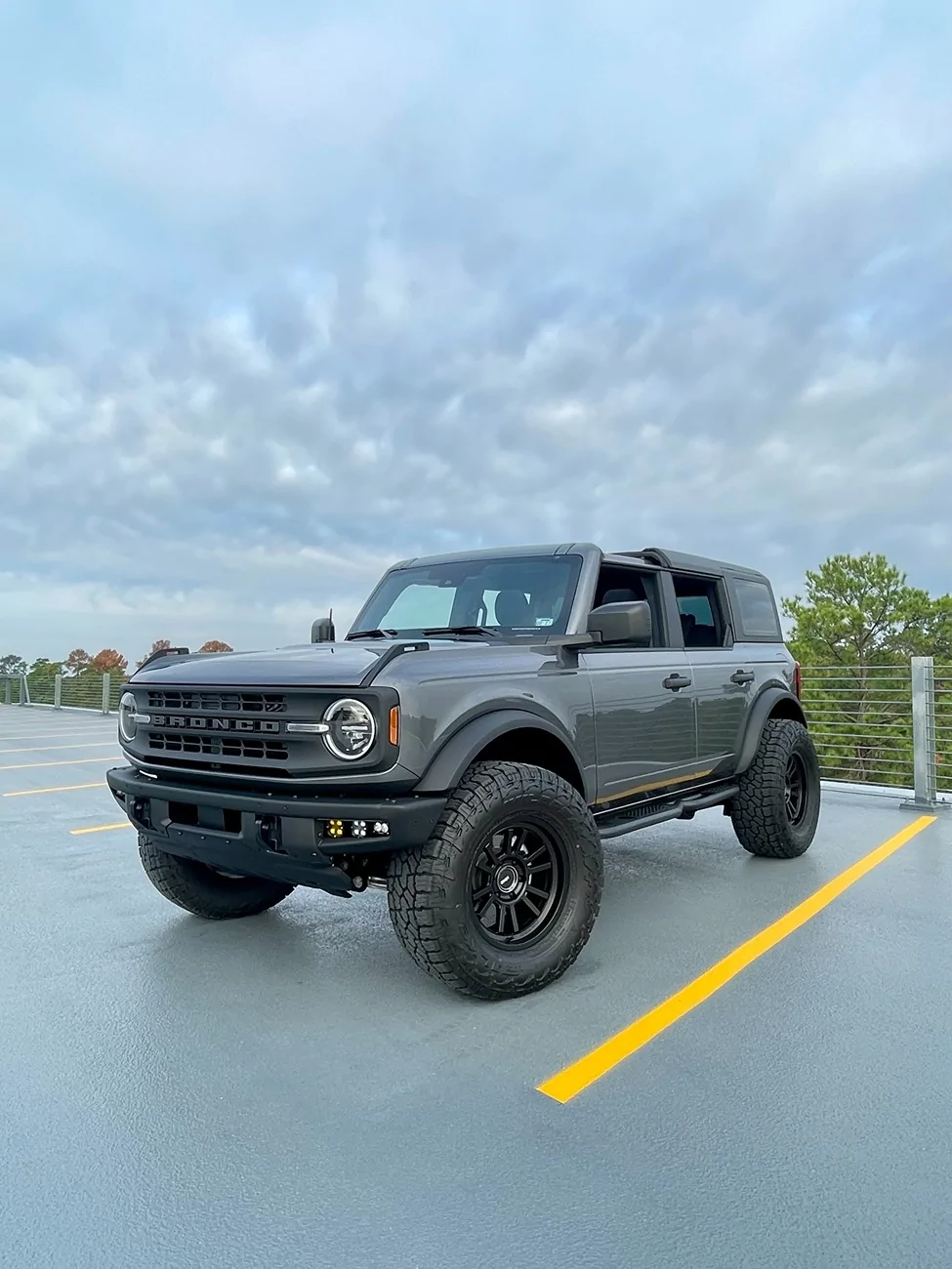

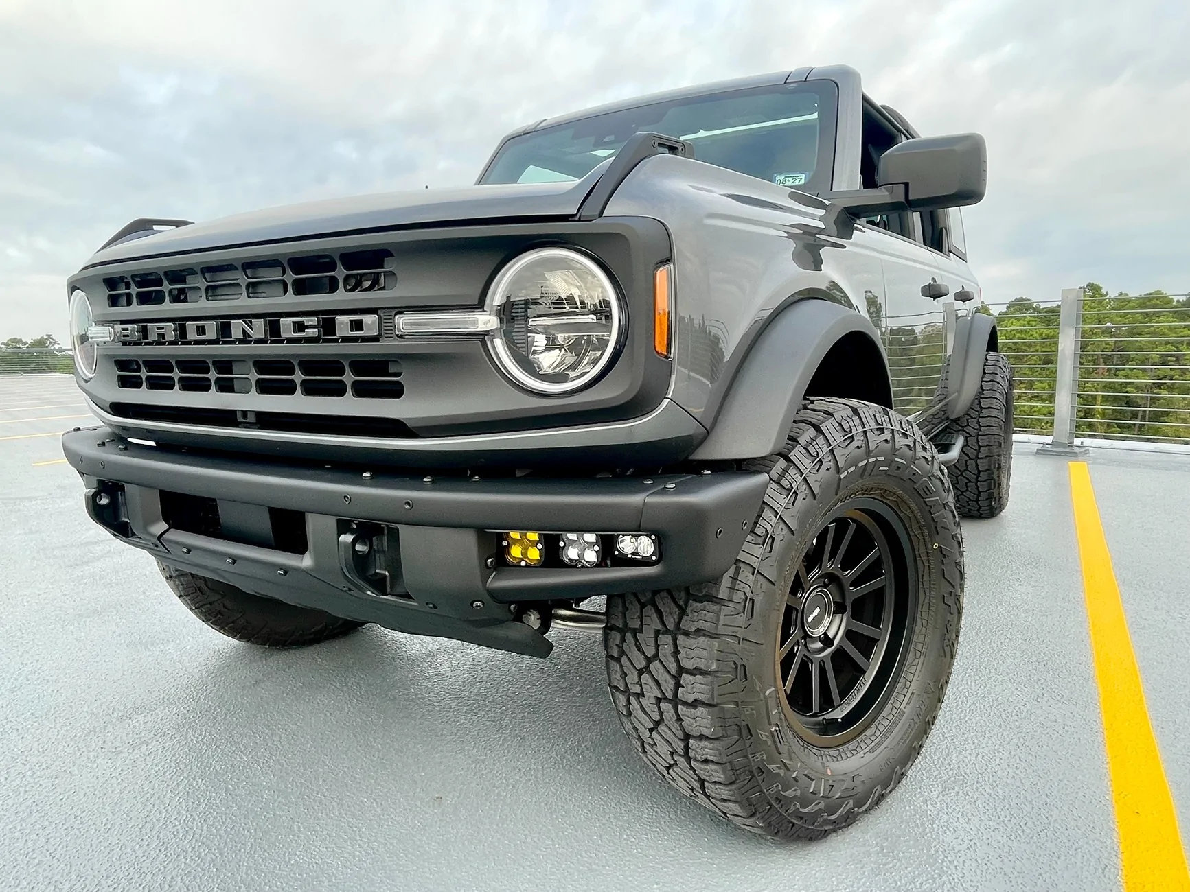

Thanks for all the help from the forum to get the Bronco where I wanted it. . . sharing the build and photos for reference.
2025 Base 4dr 2.3L Auto, Carbonized Gray
Ford Bronco 2025 Base 4dr 2.3L Build Carbonized Gray IMG_2532
Ford Bronco 2025 Base 4dr 2.3L Build Carbonized Gray IMG_2525
Ford Bronco 2025 Base 4dr 2.3L Build Carbonized Gray IMG_2515
Ford Bronco 2025 Base 4dr 2.3L Build Carbonized Gray IMG_2520
Ford Bronco 2025 Base 4dr 2.3L Build Carbonized Gray IMG_2516
Ford Bronco 2025 Base 4dr 2.3L Build Carbonized Gray IMG_2517
Ford Bronco 2025 Base 4dr 2.3L Build Carbonized Gray image1
Suspension / Wheels / Tires
  • Bilstein 5100, stock UCAs
    • Front Setting #3 - 2” spec, 2-2.25” actual lift
    • Rear setting #2 - 1.4” spec, 1.4-1.5” actual lift
    • Factory Rake with steel bumpers and 35” spare ~1” : Rake after lift ~0.3- 0.5”
  • Konig Hypertrail HT1 : 18 x 9 : 0 offset
  • Falken Wildpeak AT4 : 325/65R18 D Rating
Bumpers
  • Ford OEM Modular Front
  • 4WP Factory Rear (also see Smittybilt XRC) (~80lb)
  • Turn Offroad Licence Plate Relocation Bracket
  • Ford OEM Towing Package : Hitch, harness, module (have not flashed)
Lights

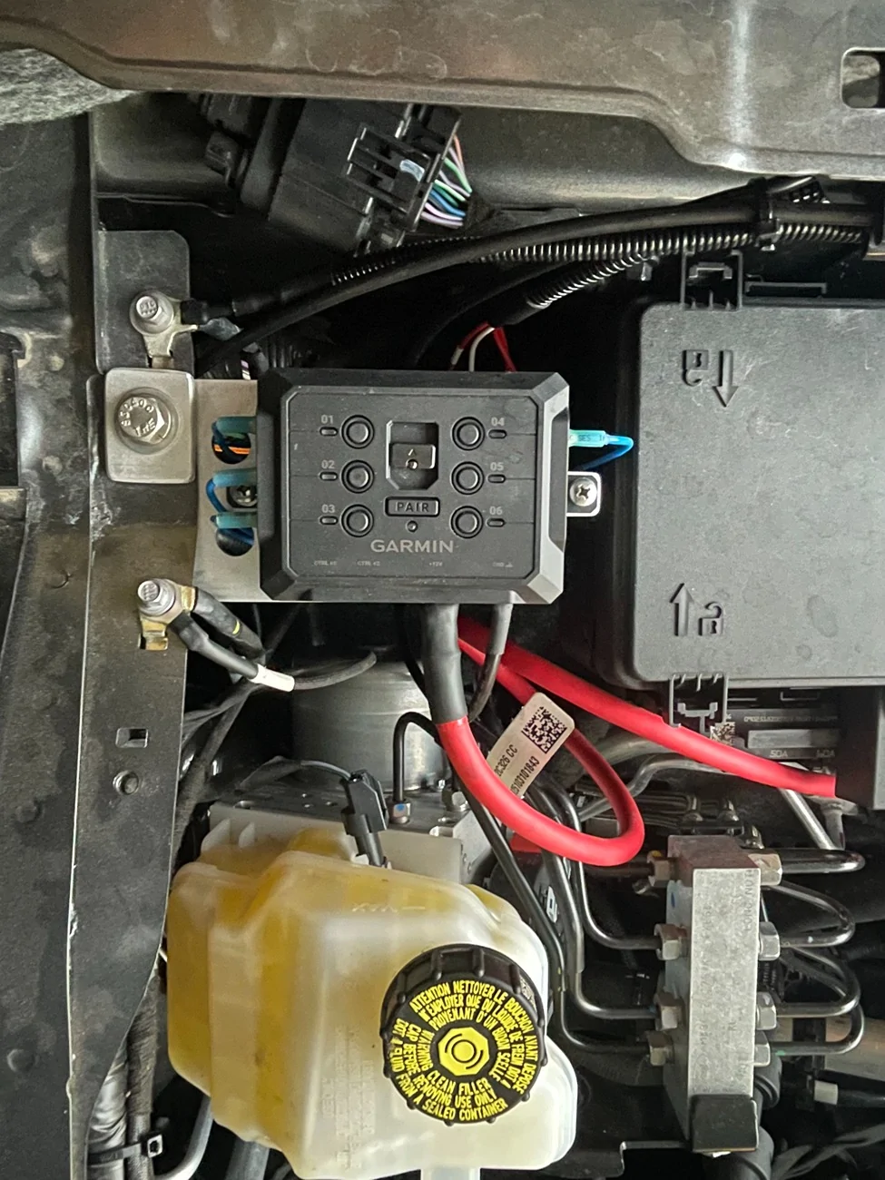

  • Baja Designs 3-light Fog (Specialty Performance Parts kit)
    • Squadron Sport Amber SAE
    • Squadron Sport Clear SAE
    • S2 Driving Combo
    • SPV Parts Bracket and harness
  • Baja Designs Reverse Lights
    • Wide Cornering Squadron Sport
    • SPV harnesses including taillight/reverse light adapter
  • Garmin Powerswitch
    • CarPlay switch control
    • DIY aluminum mounting bracket
Step Bars
  • DV8 OE Plus with pinch weld cover
Tint (zero factory tint on base)
  • Xpel Ultimate : 30% front, 20% rear, 70% Windshield
Other
  • Carbonized Gray grille lettering
  • Factory Headliner
  • Stubby antenna
  • Ceramic coated wheels
  • Paint correction, spray ceramic
  • Mabett cargo and rear seat covers
Valhalla
