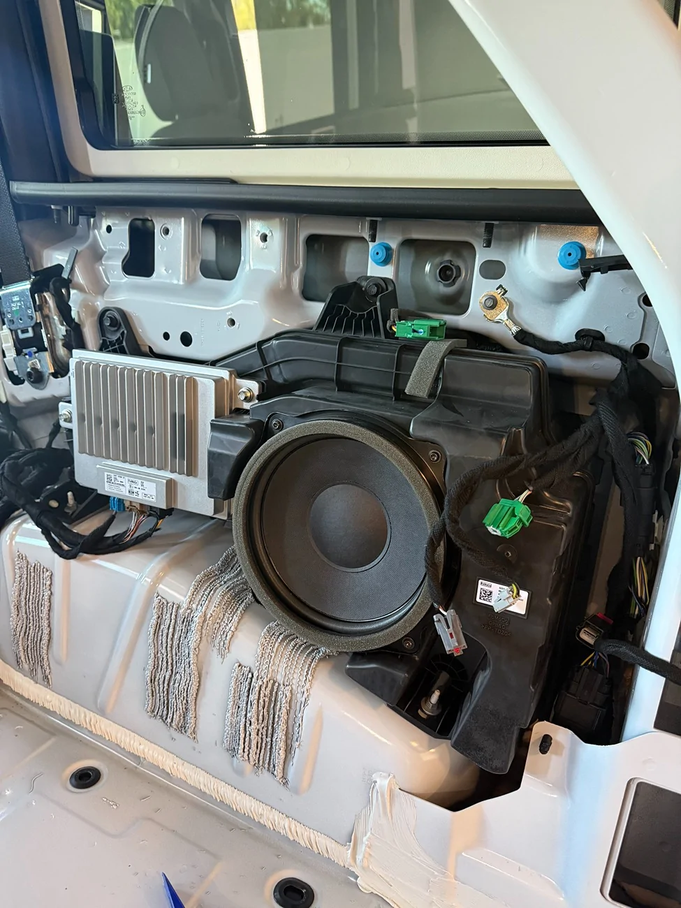

Searched but I did not find my answer. In my previous Bronco's (2022-2024) I used the plugnplaykits harness at the B&O amp to acquire the high level signals for my aftermarket amp. That said the Amp has changed for the 2025 B&O and it now controls all of the speakers.
Will the @plugnplaykits harness still work with the 2025 B&O? I emailed Joe but have not received a response yet so wanted to check with the forum. Below is a pic of the new amp as well.
Ford Bronco 2025 B&O and Plugnplaykits Harness? IMG_4691
Ford Bronco 2025 B&O and Plugnplaykits Harness? IMG_4692

It will not, different connector and wiring is different. I would assume he is working on a new harness though.
Option B, if you didn't want to wait... Motorcraft WPT-1654 is the pigtail part number. You can make your own wiring harness with it. (I would also check with your dealer for pricing, the Amazon price is higher than what my dealer can get it for.)
Option C is remove the factory amp and use a B&O interface for preamp outputs, like this one from NAV-TV. Apparently NAV-TV is in some way associated with @mObridge, which in my opinion sold the best kit for 2021-2024 B&O Bronco.

I believe mobridge is also working on a solution.

Got it. Right now I am using option D lol. I bought the green subwoofer pigtail from Amazon and used that as my high level input with a LC2i to fix the bass rolloff. I just wanted to change it up at some point. I will say the 2025 B&O system is light years better than the previous version. I just wanted a slight bit more bass but that’s just personal preference.
OEM Subwoofer pigtail: https://a.co/d/25uXSrU
