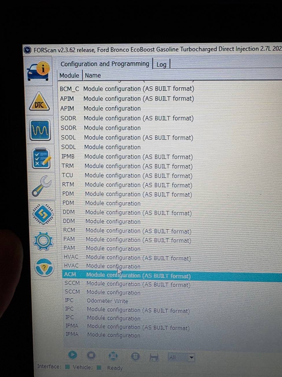

In the version I’m using - and the current beta - there is no plain English ACM, just the As-Built/hex. I’ve done a ton of Forscan on my 2023 Wildtrak but never was “missing” part of a module. What version Forscan are you using, maybe they dropped an option from the newer ones?
