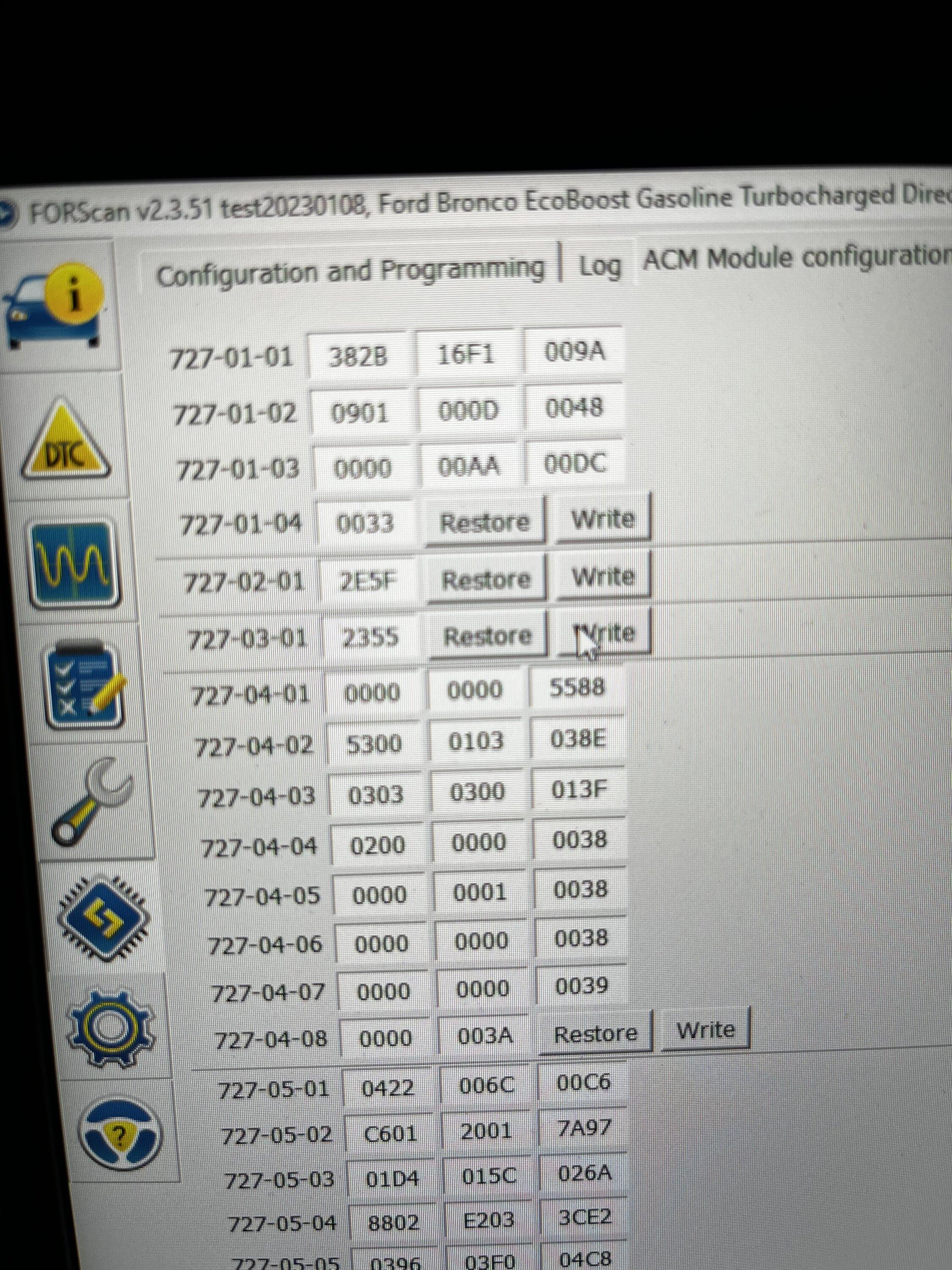

If someone can find the forscan setting to enable the harness in the sub-delete vehicles it may save some work for others. There are numerous forums online that discuss this in the F-150. I don't know if the same FORSCAN line item and code settings will apply to the Bronco.
Maybe the Ford engineers changed the parameters for the audio system when they found out the sub would get deleted and disabled the actual audio signal to the harness even though it has 12V power and 5V (signal) power as discovered by another member.
I've decided to use a line converter (PAC LPA-1.2 LocPro) since I need to run a power wire for the monoblock amp anyway to use for my sub conversion. I'm actually happy I have an OEM box to work with and I got a credit.
I will run RCA to the back from the converter and skip the harness completely. The magnet-less sub left in the OEM sub enclosure looked like it would have provided minimal base anyway. It has two sets of terminals probably for a dual voice coil which I found interesting in a small sub with a crappy cone and likely minimal power.
Here's a thread that has all the FORSCAN codes. I'm pretty sure you can enable the harness back there. You're right though, that sub didn't provide much.

New to this but I just got mine and thought I could just replace the fake amp and subwoofer with new using the existing wiring. No one has done this and it looks like if they did the factory head unit is not sending power back through the wiring so forscan is needed to accomplish this?
I hooked up forscan and got my default register since I had the sub. You can definitely enable the sub back there but still doesn’t help the fact that you don’t have the sub and amp. If someone gives you theirs, it may be worth it. But I wouldn’t pay for it.
I was installing new amp and subwoofer but didn’t want to run new wiring if I didn’t have to

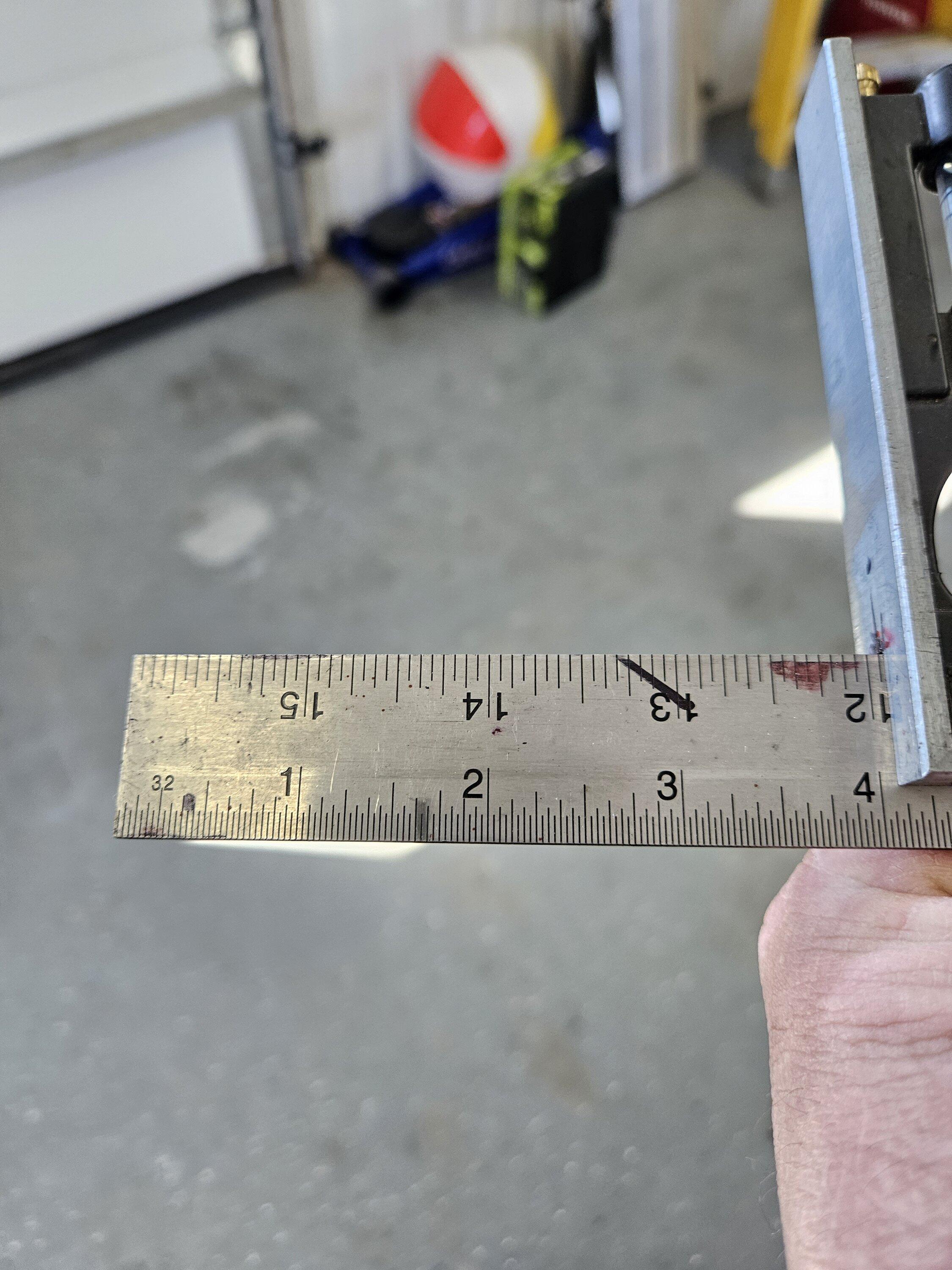

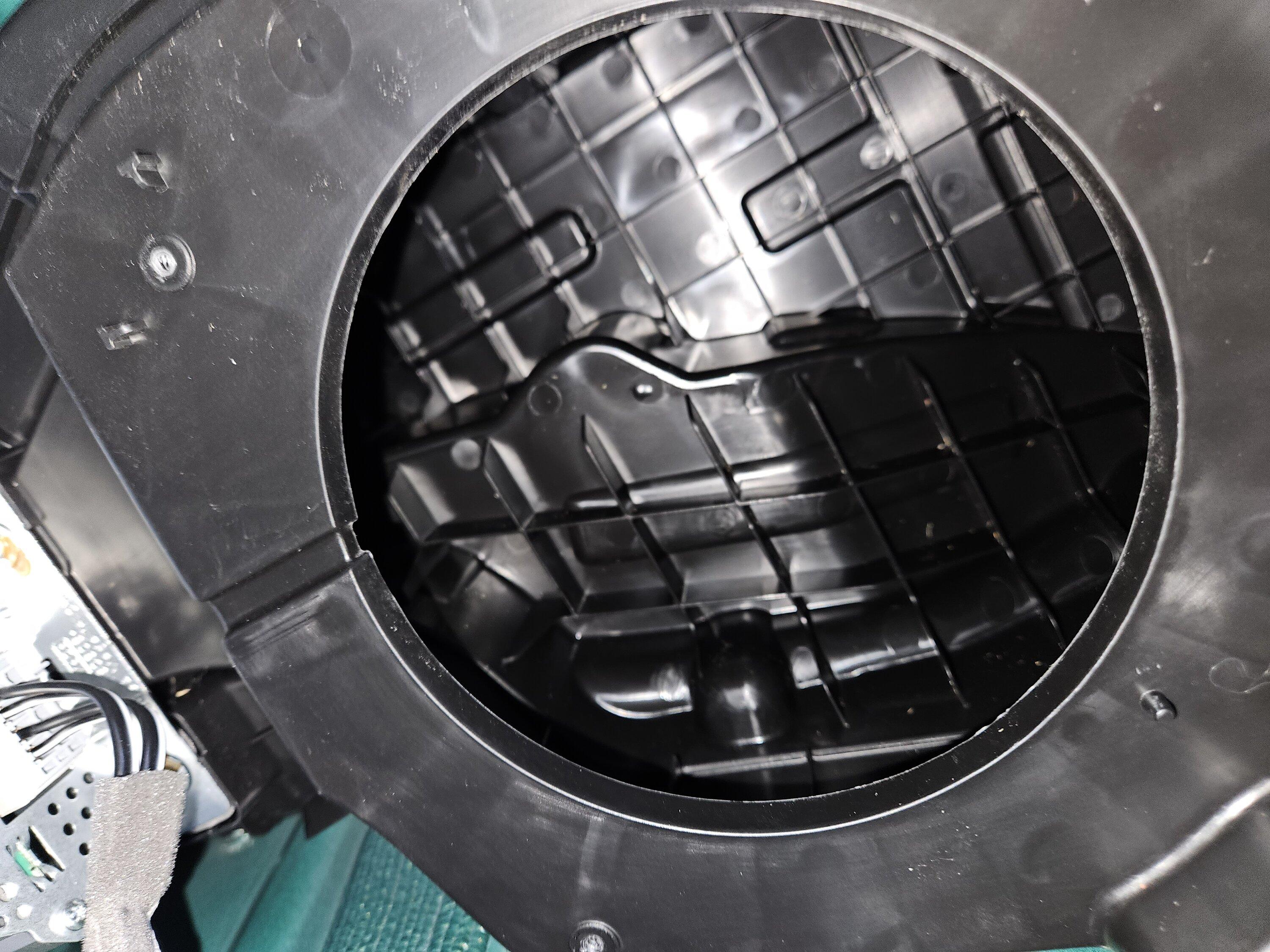

If you happen to mesure it or if anyone else does I' appreciate it to.. Wondering if I could squeeze a JL 8w1v3 in instead of the kicker. It has a mounting depth of 3.86 which is not quite an inch bigger then the Kicker Comp RT

Not a big big rush, I’d really appreciate it. Looking at different sub options while I wait for the JL stealth to release. I’ve thought about wrapping the stock box in sound deadener to give it some mass and prevent buzzing/rattling.
I measured it today when I was doing some stuff. I measured to the shallowest part so that it would clear any size coil. I came up with 4 1/8. You could get about a 1/2 more trimming some fins inside but you give up some rigidty and I wouldn't want to do that with this box.
Ford Bronco 2023 7 speaker subwoofer upgrade 20230326_153012
Ford Bronco 2023 7 speaker subwoofer upgrade 20230326_153018
