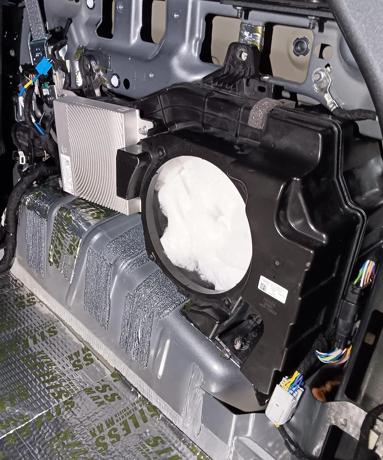

I used the Stinger Bronco amp wiring kit 8 gauge on my 2 Dr and had plenty to mount my Kicker Key 500 on top of the new Gearshade 2Dr box with the square L7T subwoofer - https://a.co/d/8I9gwlQ. It comes with the nice fender mount to mount the fuse and all the ends have quality ferrules. Well worth it. Here is a link to my post so you can see the new box that allows the mounting of the B&O amp and also the Kicker on the top. Install was straightforward. https://www.bronco6g.com/forum/thre...r-enclosure-2-door-version.82851/post-2218825

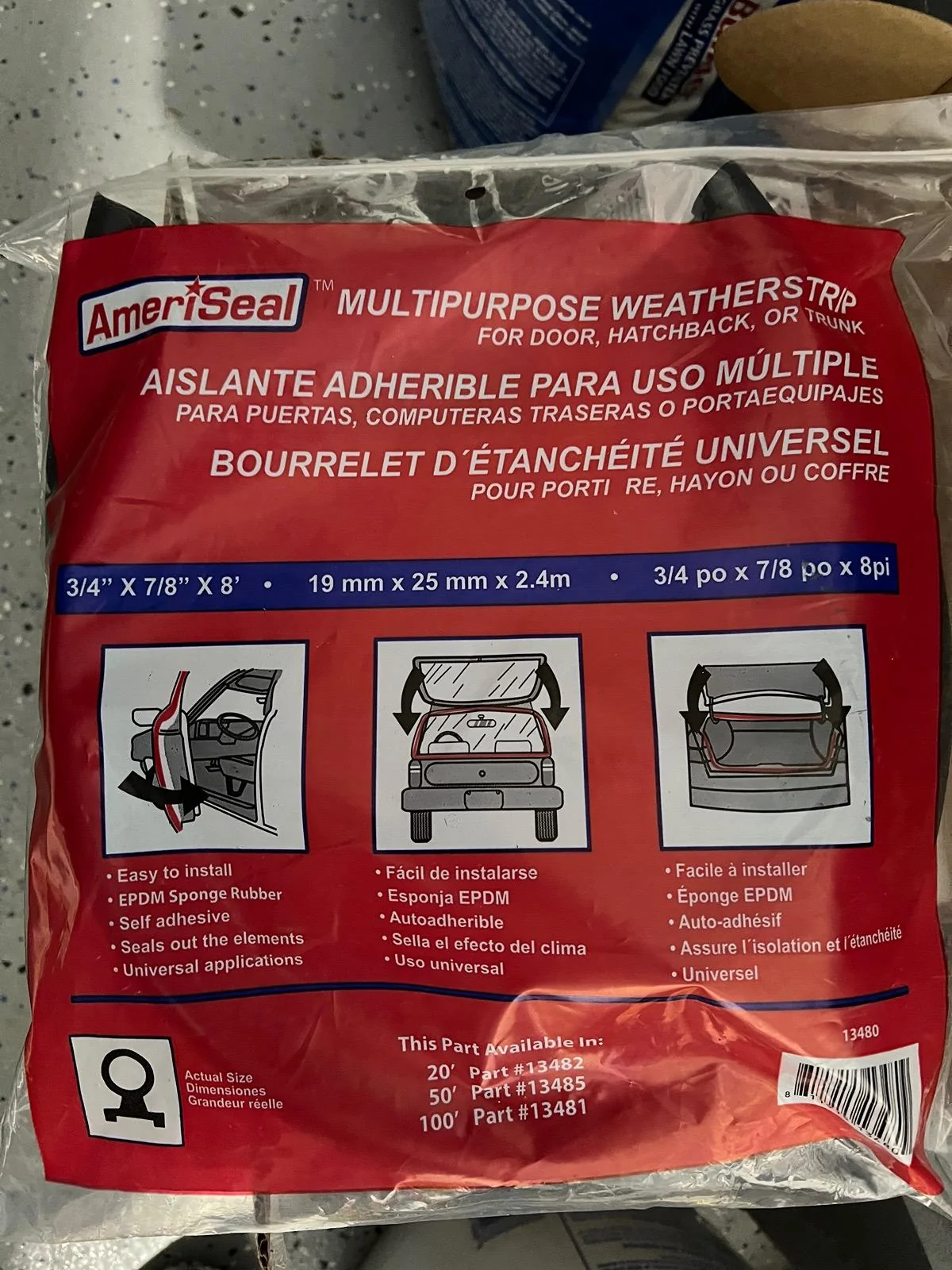

Ended up putting some rubber weatherstripping all around the ring of the square sub to make sure it wasn’t rubbing the inside of the factory panel. I used a dremmel cutter to remove the small plastic ring on the inside of the back panel that was meant to touch the foam on the factory B&O subwoofer. Here is the westherstripping picture - picked it up at my local AutoZone

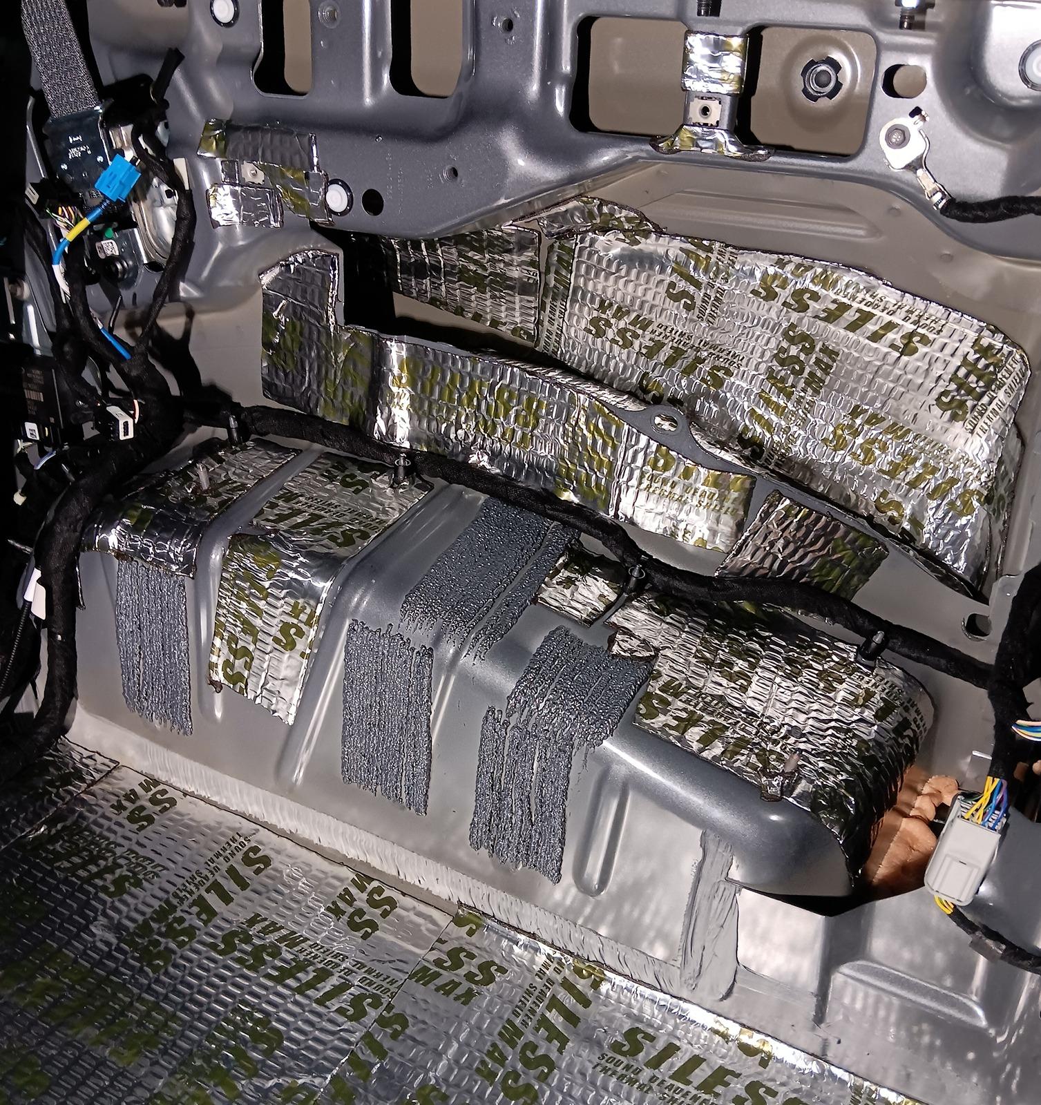

Perfect. Thanks. Can't wait to get to ordering a d installing every. Right now our current stock setup vibrates and rattles like no other. Gonna be trying to go through everything with kilmat and cloth tape and such.

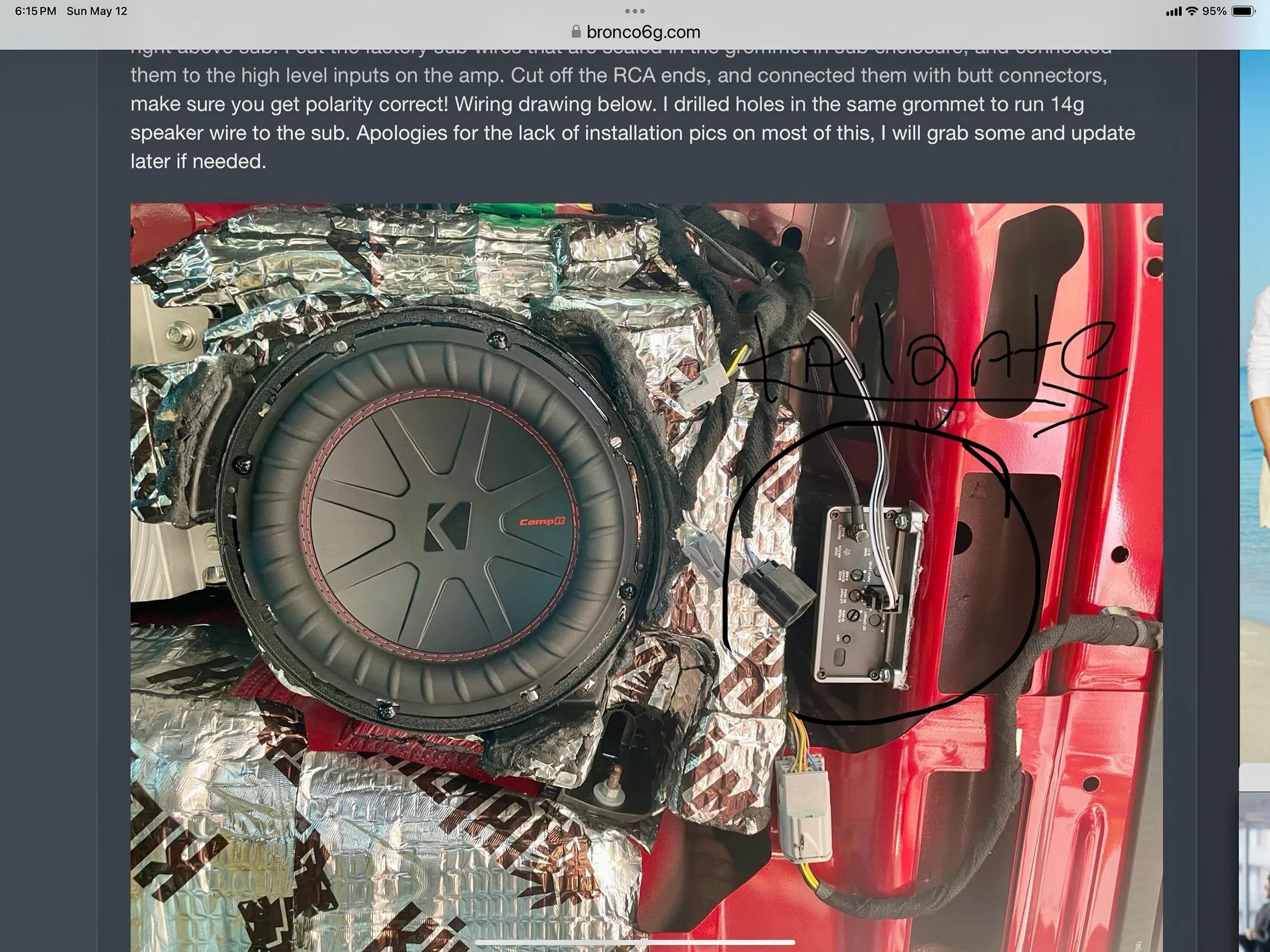

I looked and plugnplaykits.com. Click on the red bronco and it’s kit 2. That’s all you need other than you will need to order a power wire for the amp. If you already have the sub and amp, I think he sells the harness only. I will send you a pic of where I mounted the amp.

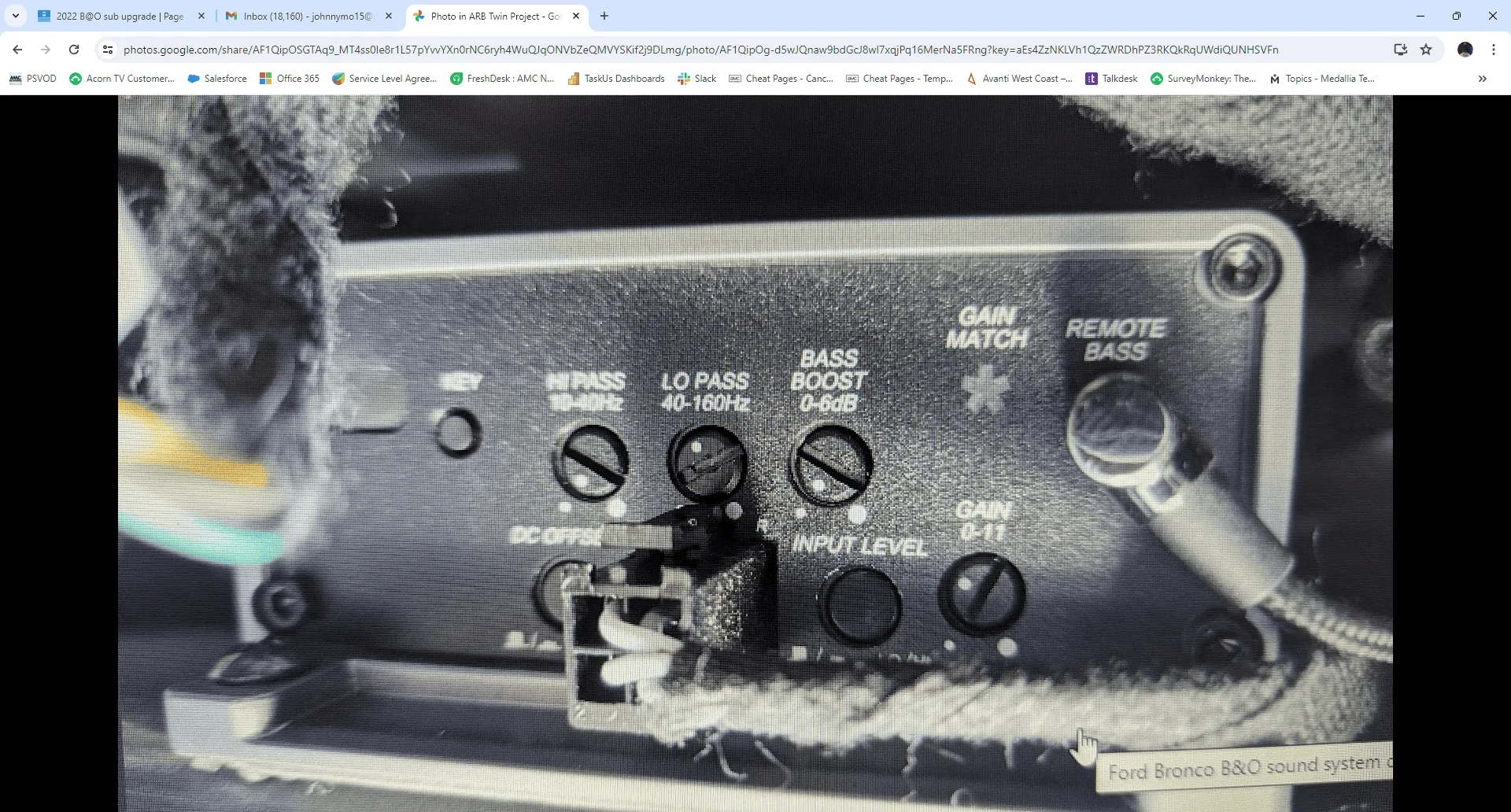

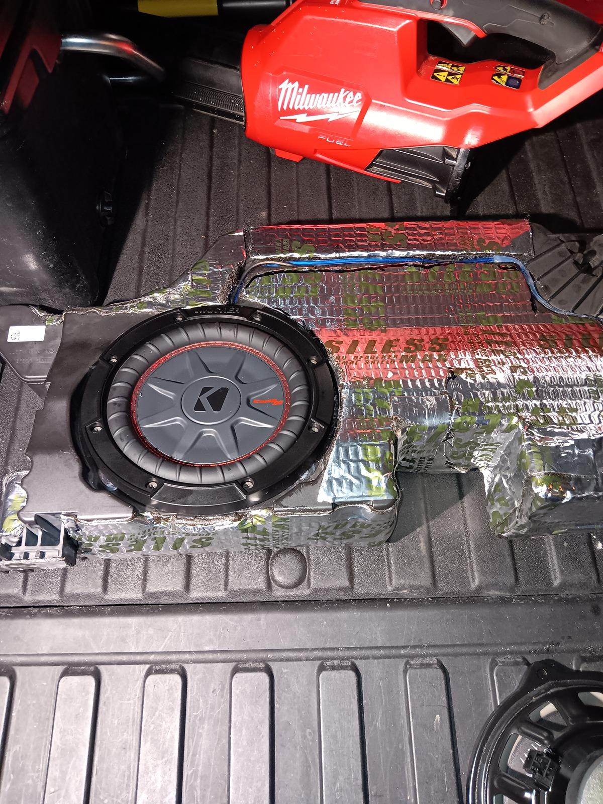

Well, got everything thrown together and night and day difference between the stock b and o vs the kicker. Damz!! Anyone have a pic of how they have their amp settings set? Before I put all the trim and such back to normal. Thanks everyone!! So worth it. Now on to my powerstroke setup. Gonna be doing the same to it here soon. Can't wait!!

Ford Bronco 2022 B@O sub upgrade 1000003223
Ford Bronco 2022 B@O sub upgrade 1000003225
Ford Bronco 2022 B@O sub upgrade 1000003224

I used same setting as another member here for the most part (sorry lack of photo credit) - only thing I adjusted was the Lo pass - I set that closer to 100Hz (so like 12:00 on the dial)

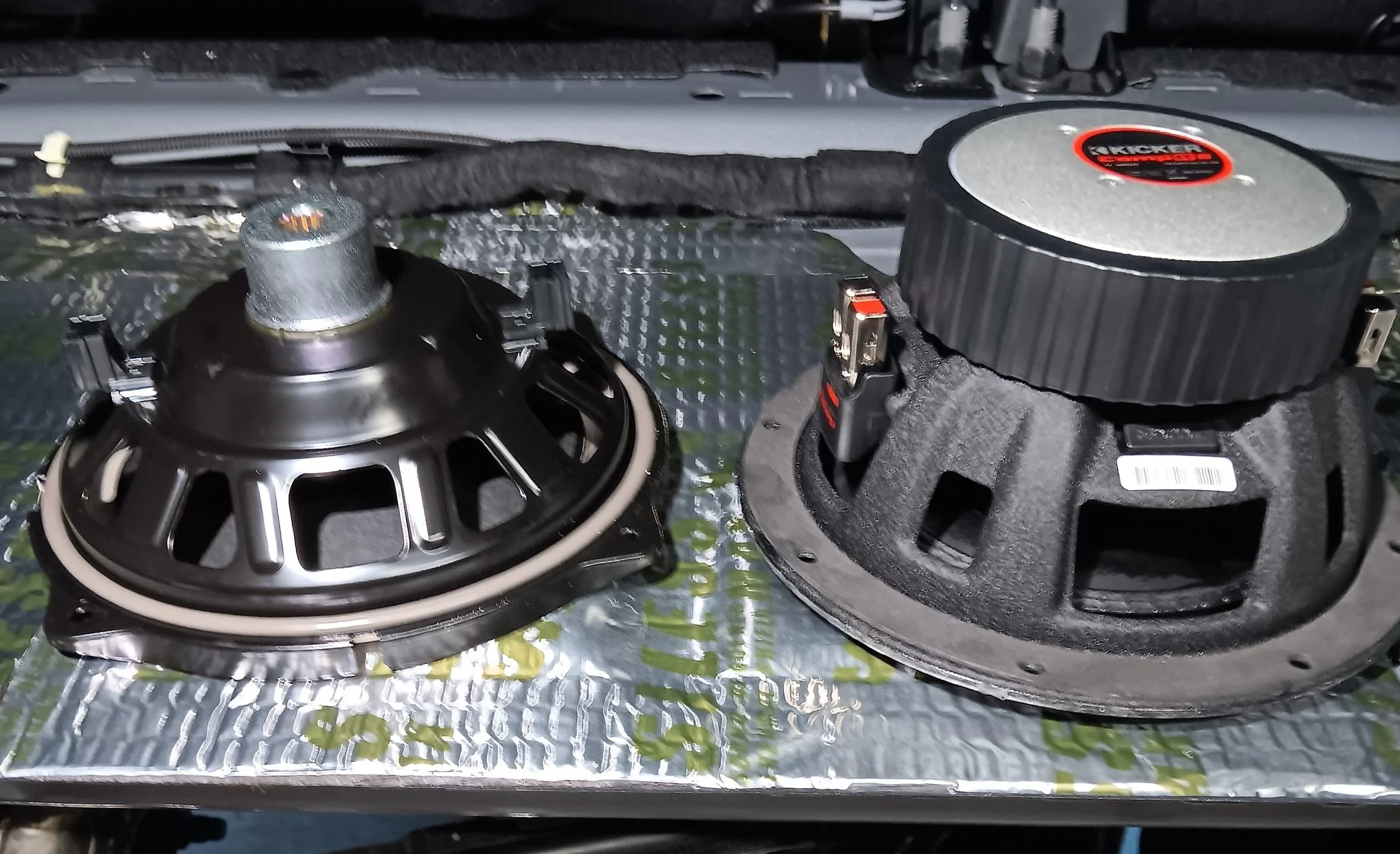

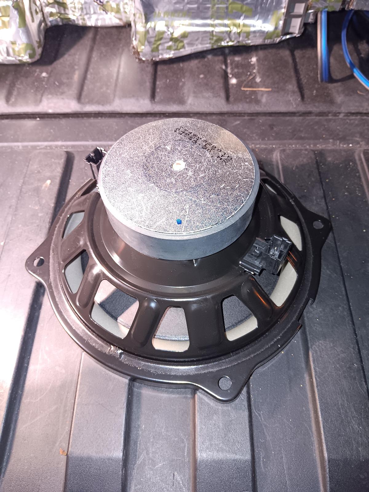

Just for comparison. The 21 f450 b and o sub looked identical but the magnet was much larger. And the enclosure was smaller. Can't wait to gether all installed in the truck next.
Ford Bronco 2022 B@O sub upgrade 1000003277
Ford Bronco 2022 B@O sub upgrade 1000003278
Ford Bronco 2022 B@O sub upgrade 1000003279
