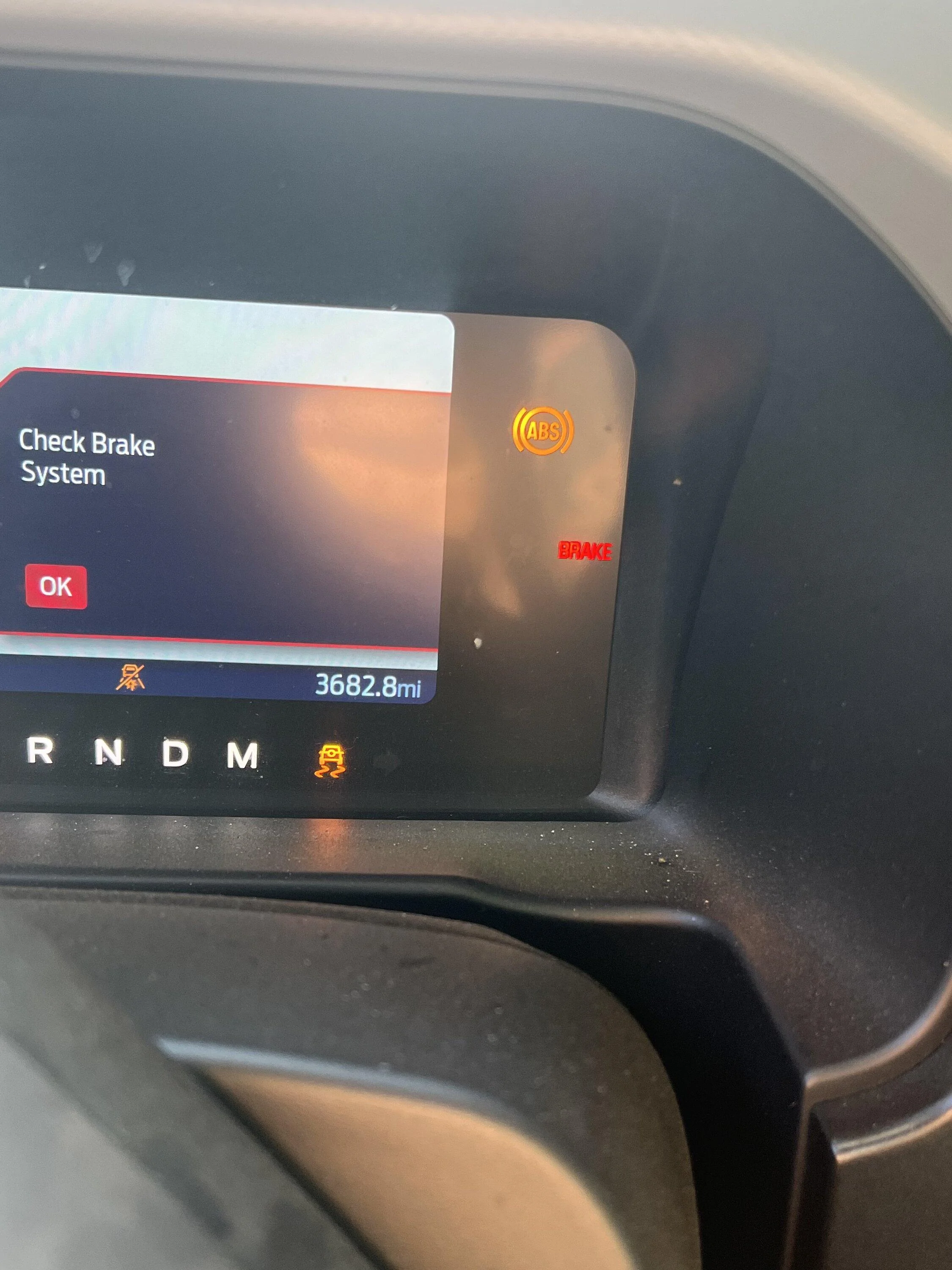

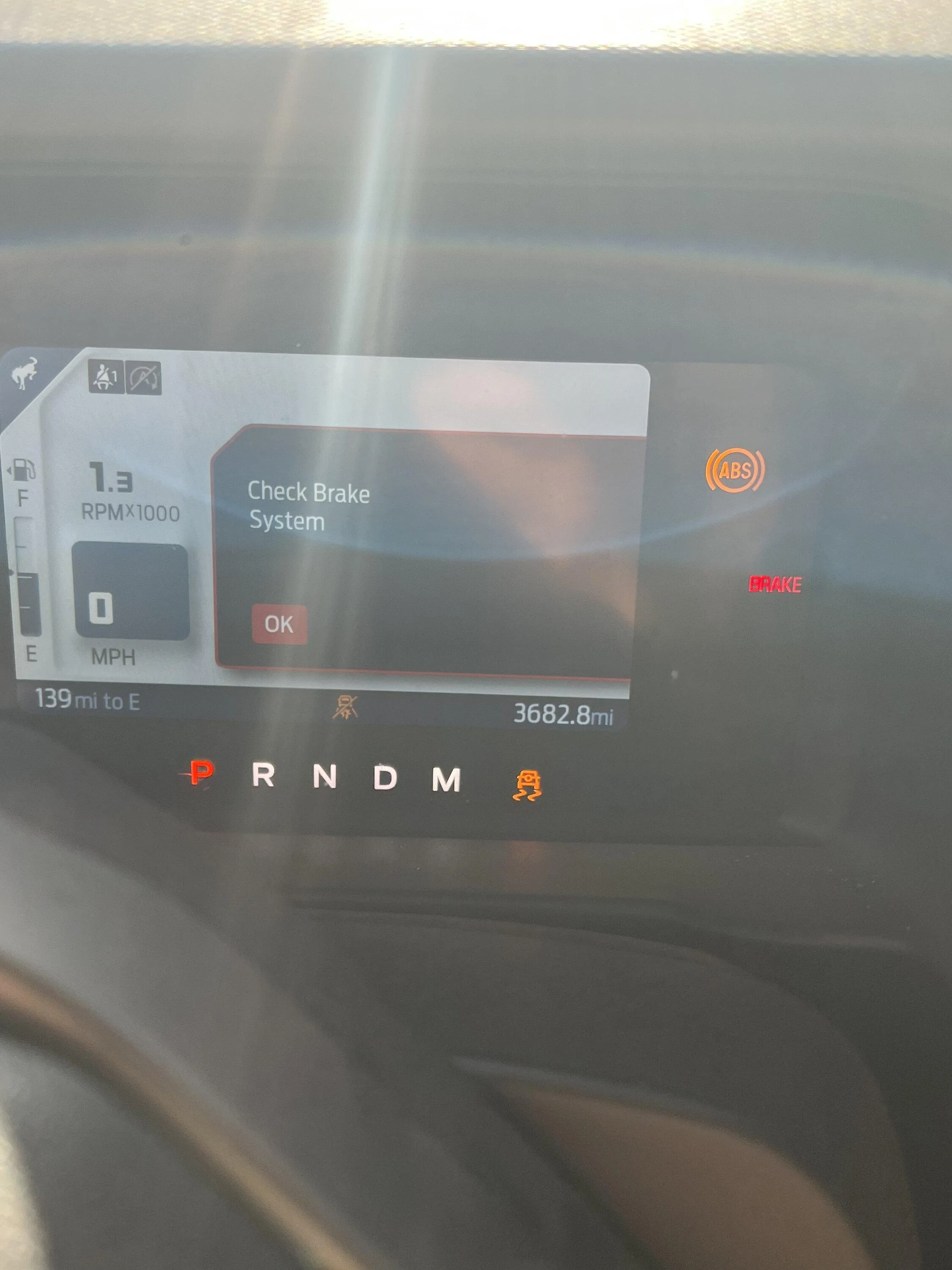

Wow sorry to hear about your misfortune and glad no one was injured. I had my first random pre-collision warning while driving down a county road at ~50 MPH with nothing around me. I was like WTF? and it stayed on for about 10 seconds and then poof it was gone. I will definitely keep an eye on this issue.I have a 2021 2-Door Wildtrak 2.7L that I took delivery of in November. I’ve got 4500 miles on it so far. I’ve had the random pre-collision alert warning here and there when there was no reason for it. Then 3 weeks ago I was pulling into a driveway and the pre-collision alert went off as soon as my front wheels went up the driveway and then I had no brakes. I proceeded to roll 30+ feet into the back of a parked car in the driveway. I was mashing the brake pedal as hard as I could and it didn’t even slow down a bit. Super scary as I had family standing just to the right of the parked car I hit. Immediately had the Bronco towed to the dealership and they’ve been investigating for the past 3 weeks. All I’ve heard is that certain modules aren’t communicating with each other and they’ve had another Bronco with issues with Hill Start assist module.
