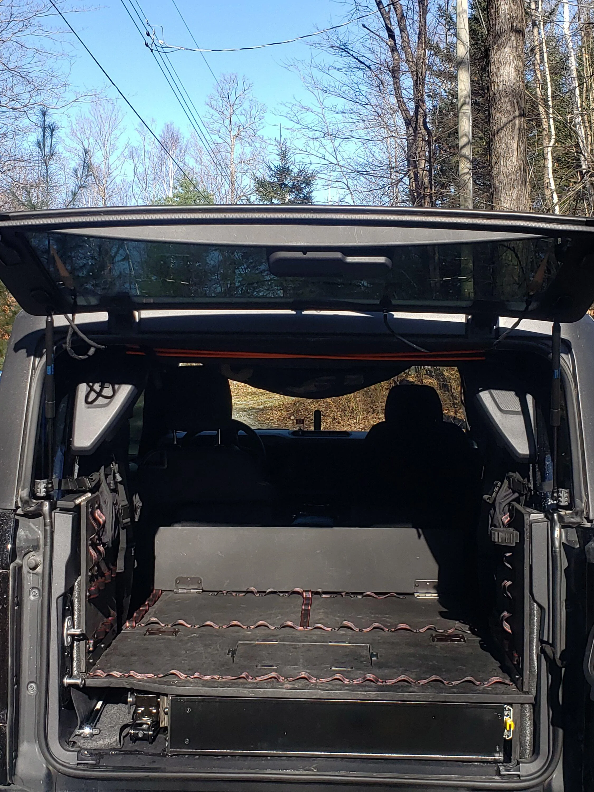

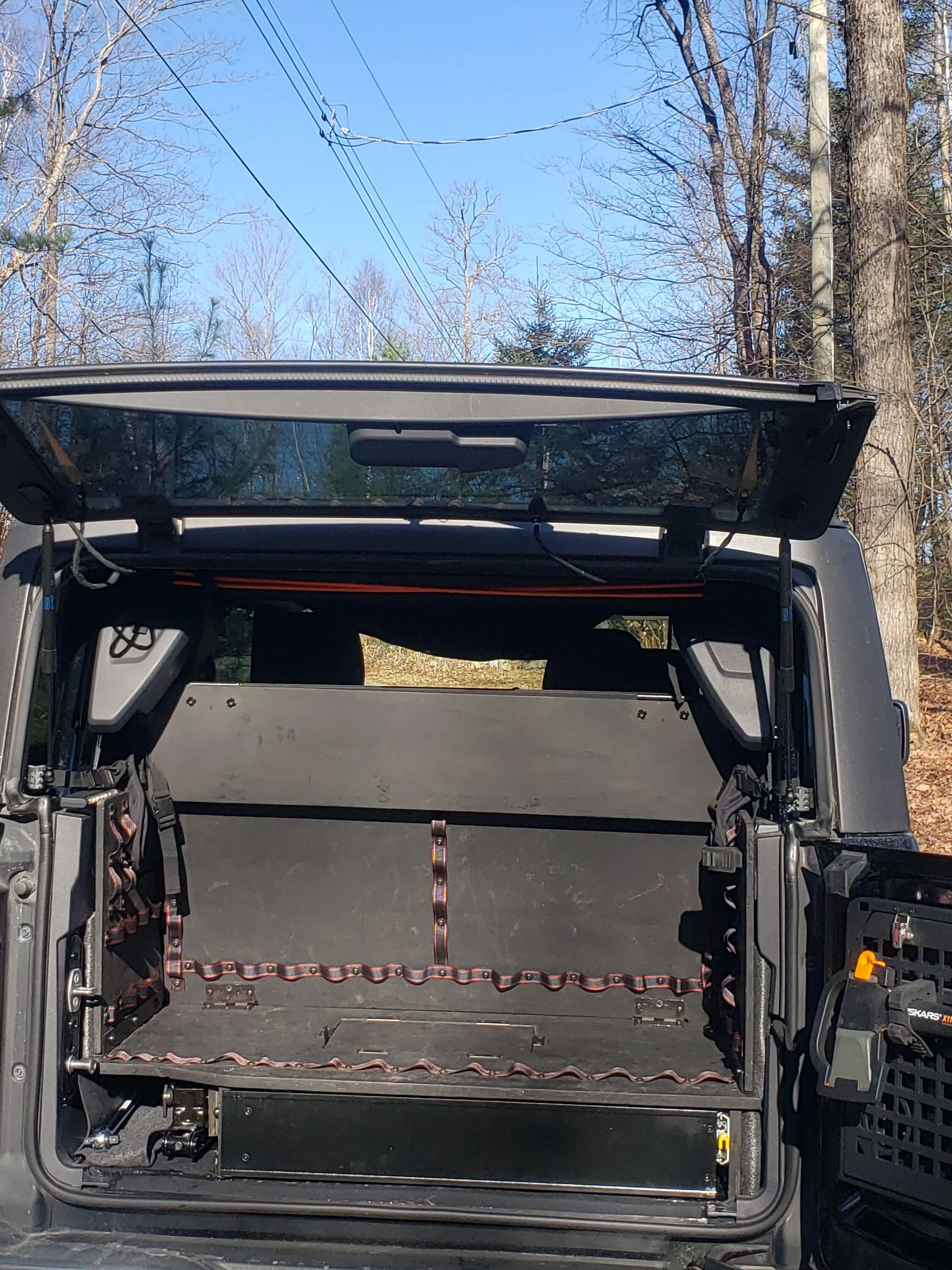

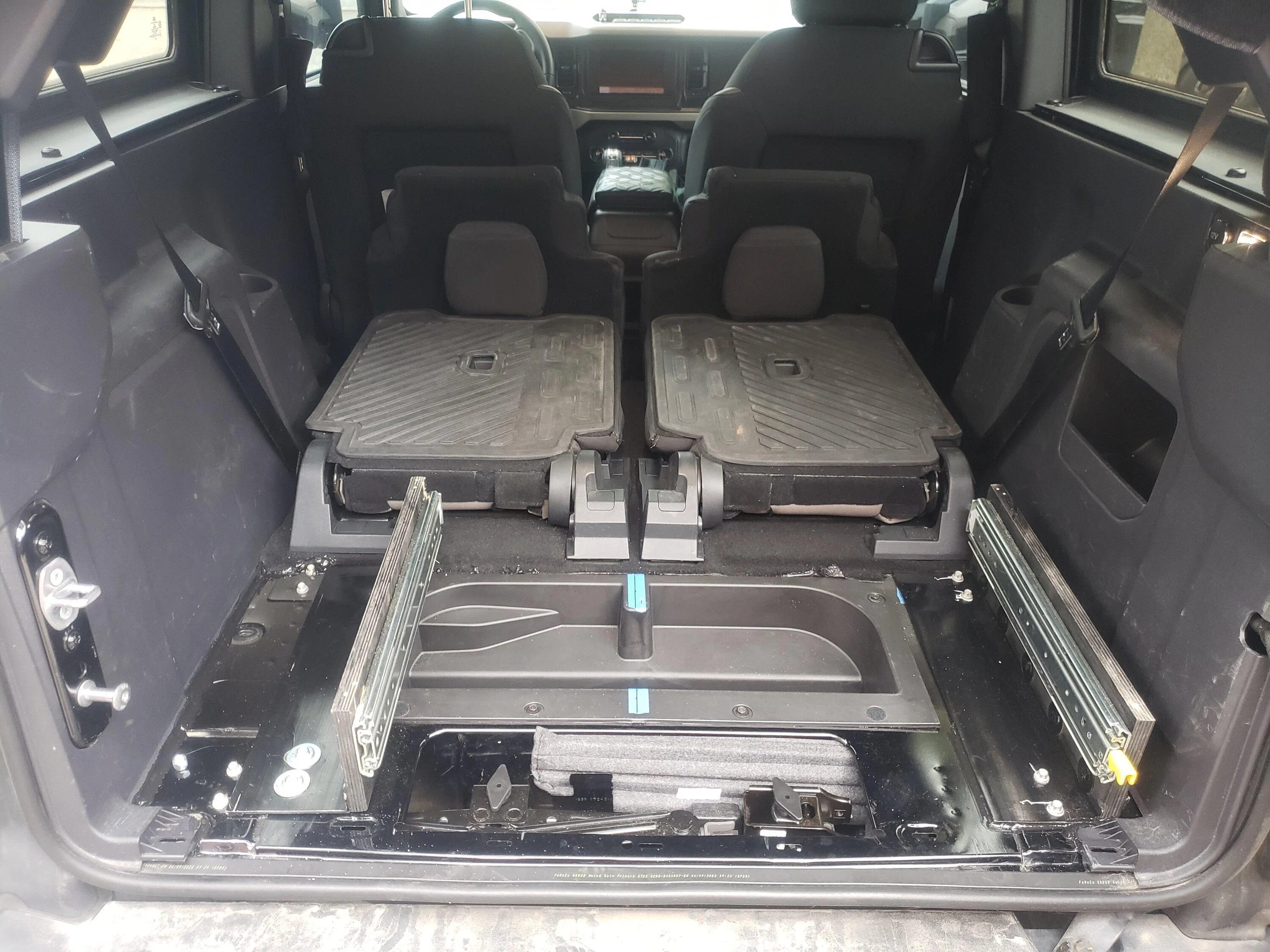

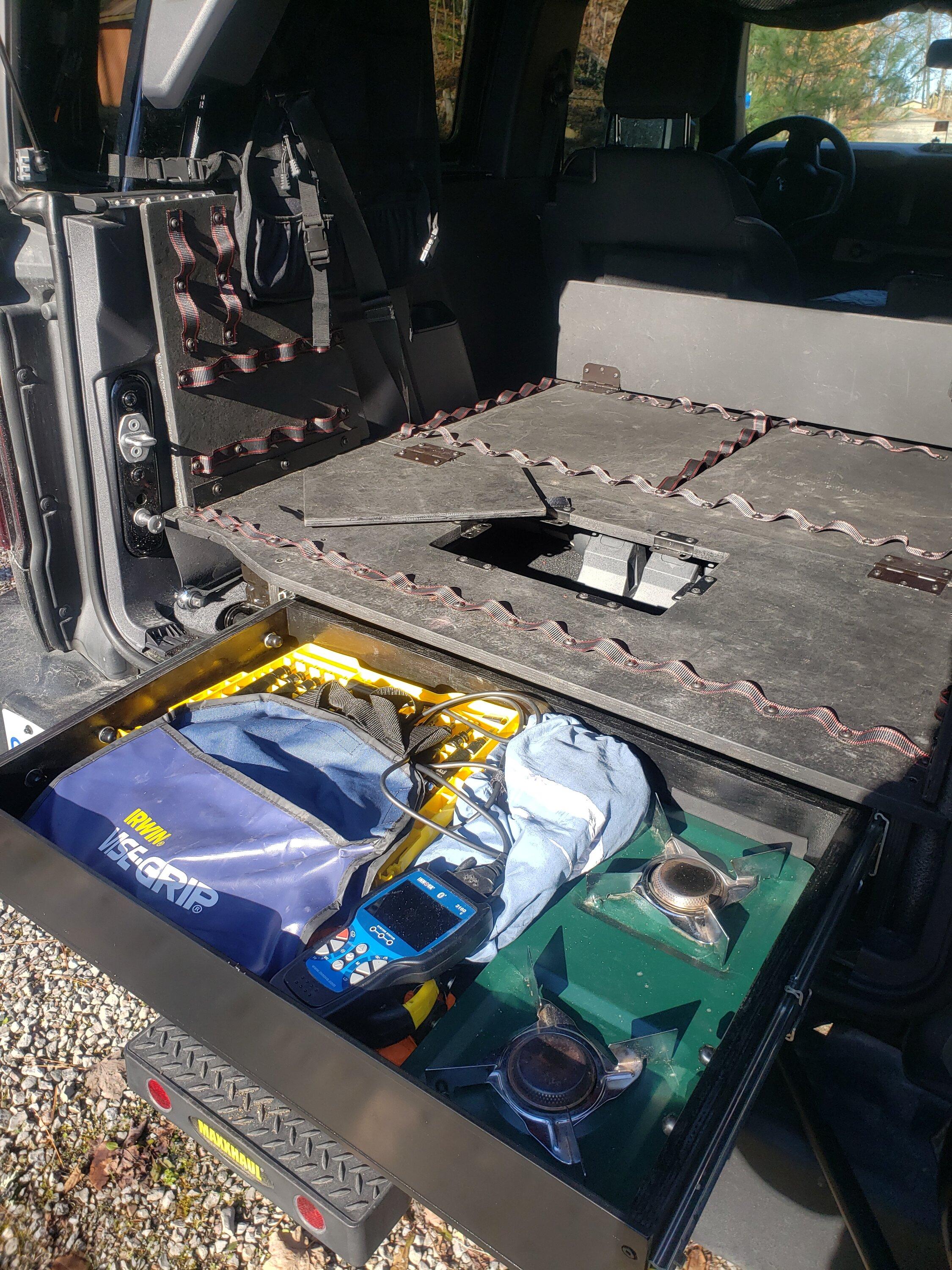

Made and installed a 27 x 17 x 5 inch drawer and relocated jack. Added a fold down section to cover seats. Also added side panels to protect the rear plastic and secure small items. Made a pass through to gain access to the floor bin. The rear drawer supports are bolted into the right hold downs . Left side is bolted through the floor over the old jack location and using one bolt from the bin . The left opening is large enough to mount a compressor in the future
Parts inventory:
3/4 ply for drawer and supports and rear top.
1/2 ply for side panels, seats and pass through
drawer front , bottom supports are aluminum that I had .
webbing is cut from straps bolted into T nuts

So with the panel folded up you can still put the rear seats up?
