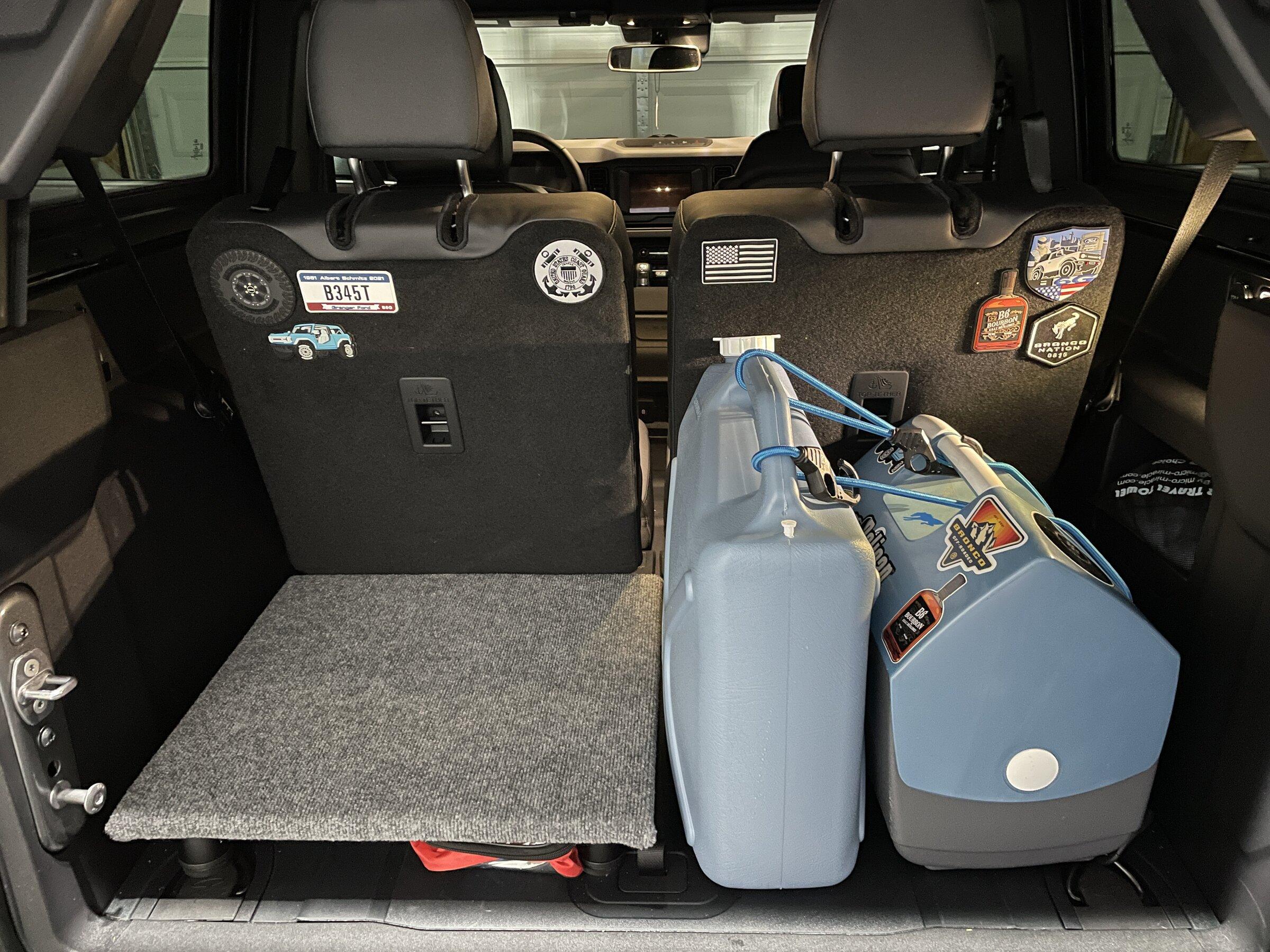

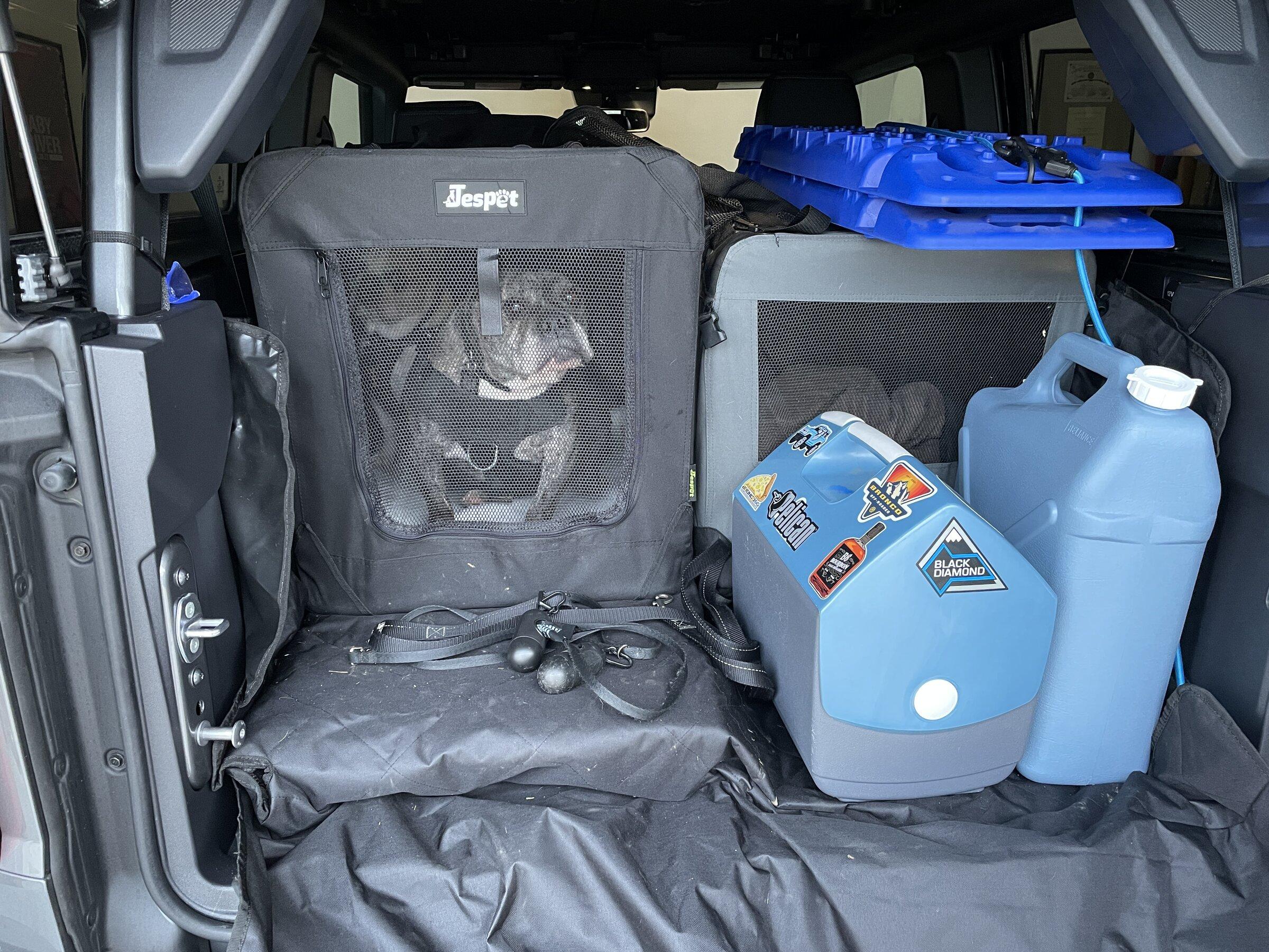

It’s holding up great and allowed me to sleep in the back of my 2 door! (Head to tailgate and feet propped up on the center console between the front seats). I haven’t made the other side yet since I haven’t needed to and really like how my coolers and such stack in that recessed space. Honestly I wouldn’t change a thing about my prototype. Good luck to you!

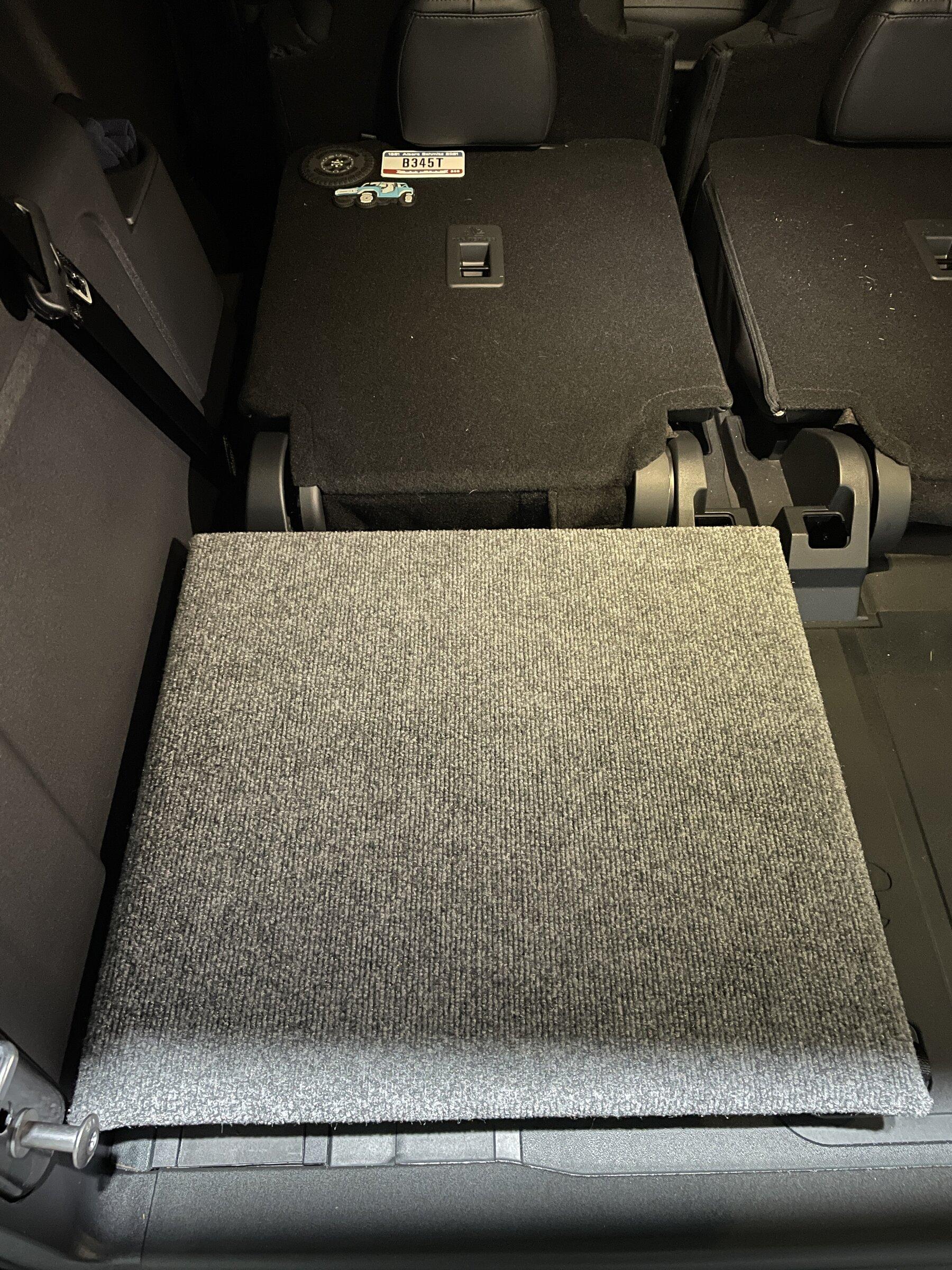

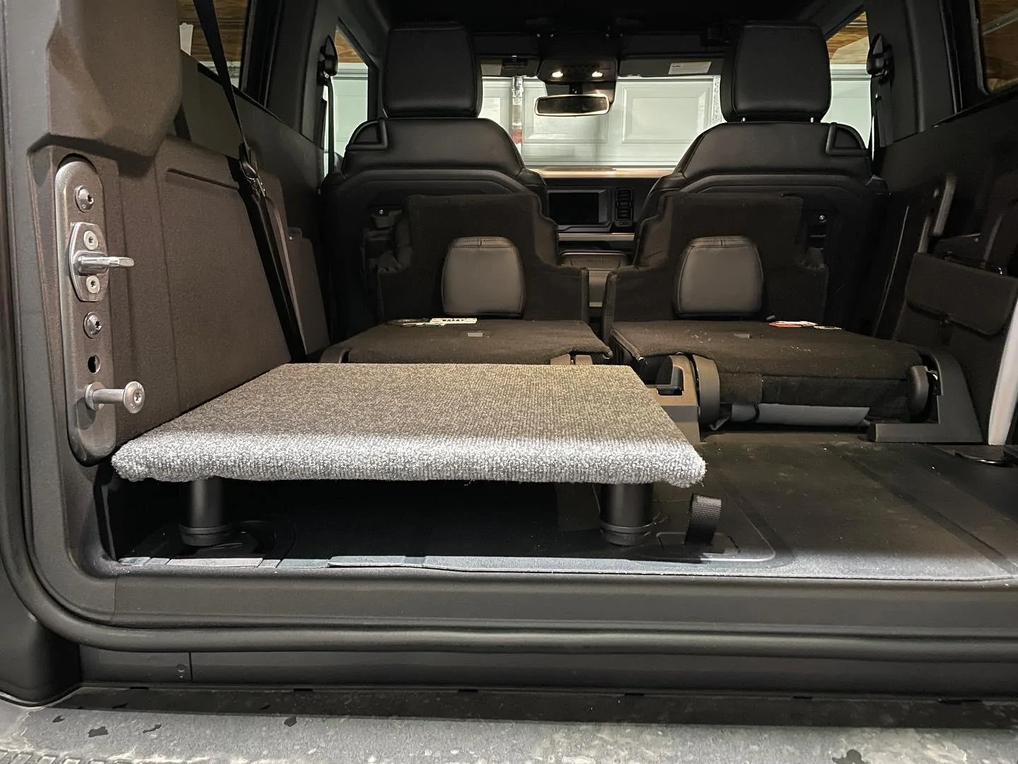

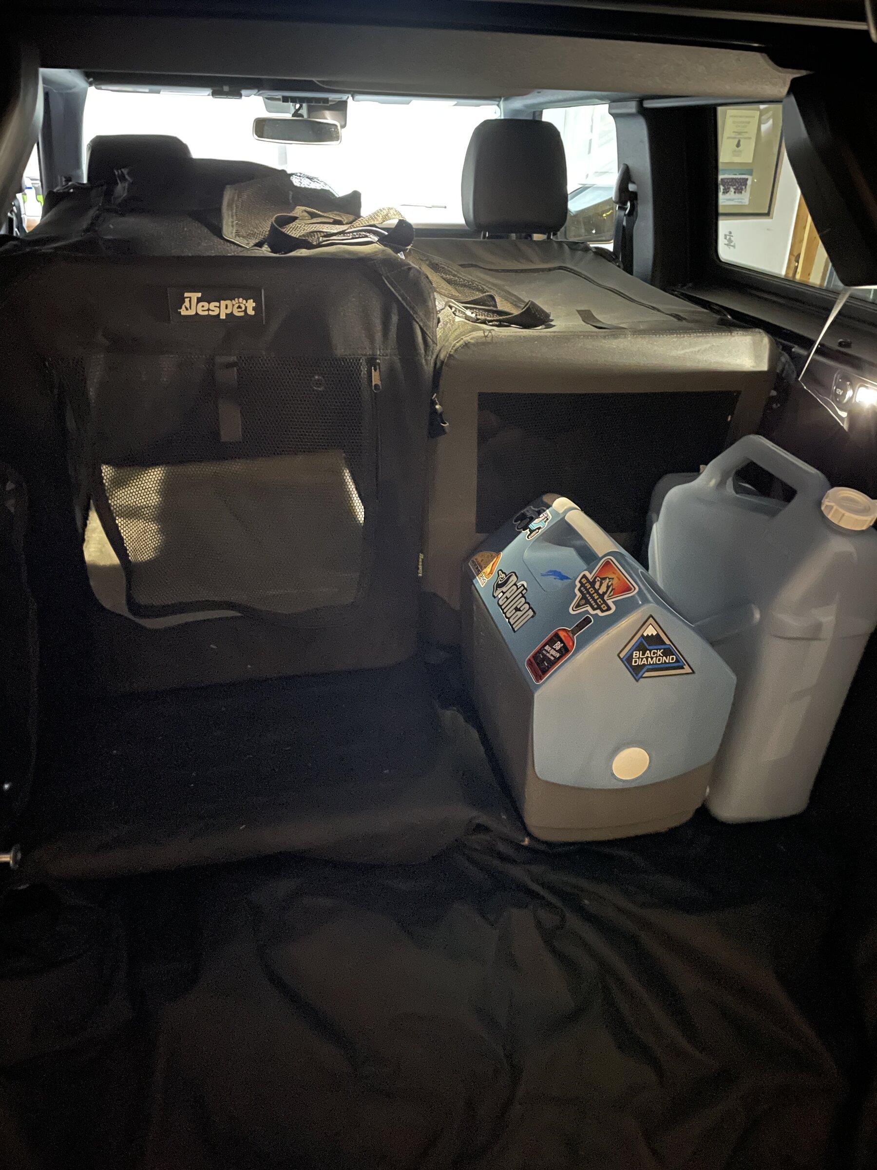

I was very interested in the Goose Gear half rear seat delete for my 2dr, but ultimately I didn’t want to commit to removing something I couldn’t put back easily. I’ve also enjoyed the plywood platforms I’ve seen a lot of people come up with, but as awesome as they are, they seemed too large and cumbersome for what I needed.
Needs:

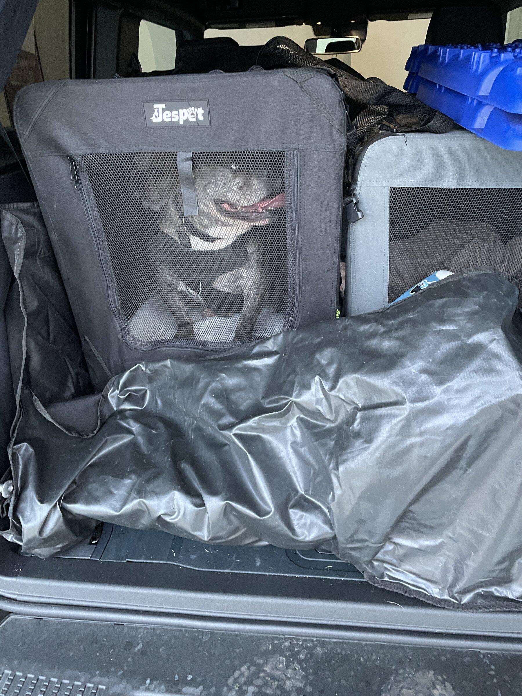

1: A platform to level the load floor on the side with my larger dog crate to prevent it from wobbling/falling when my dog moves around.
2: Ability to quickly and easily move it in and out of the Bronco.
Solution:

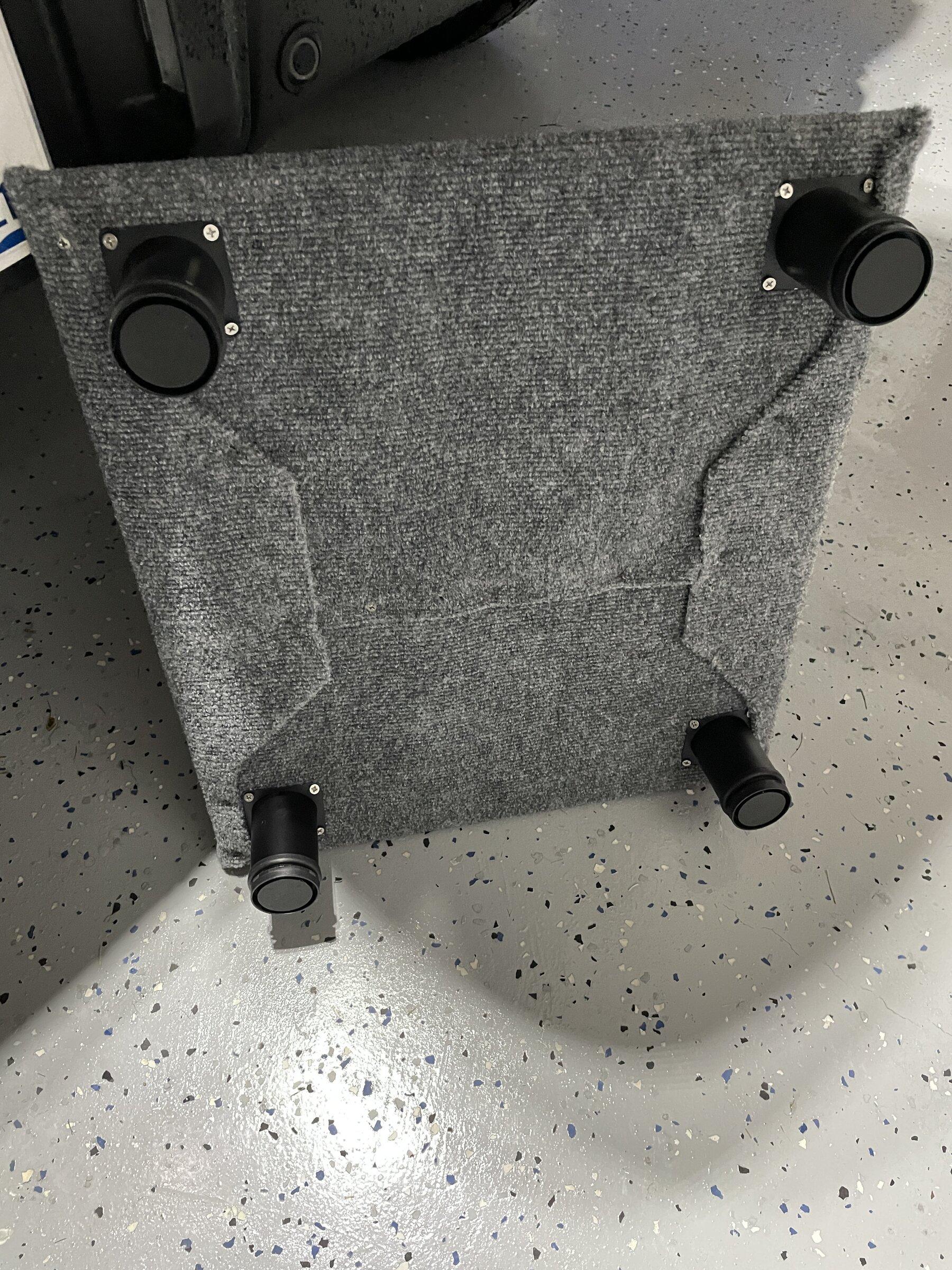

Plywood dimensions: 3/4” board cut to 20”x18” (they’ll do it for you at many hardware stores)
Marine grade carpet $12
These legs purchased from Amazon: https://amzn.to/3mN7gQY
I used small screws to attach the carpet and keep it tight with no air bubbles. I didn’t use the screws that came with those legs as they would have probably gone through the board.
Took my pups out for some light off roading yesterday and the system worked perfectly! The whole thing cost less than $50. I might make another one for the other side to have a modular set up available.
Happy New Year!
