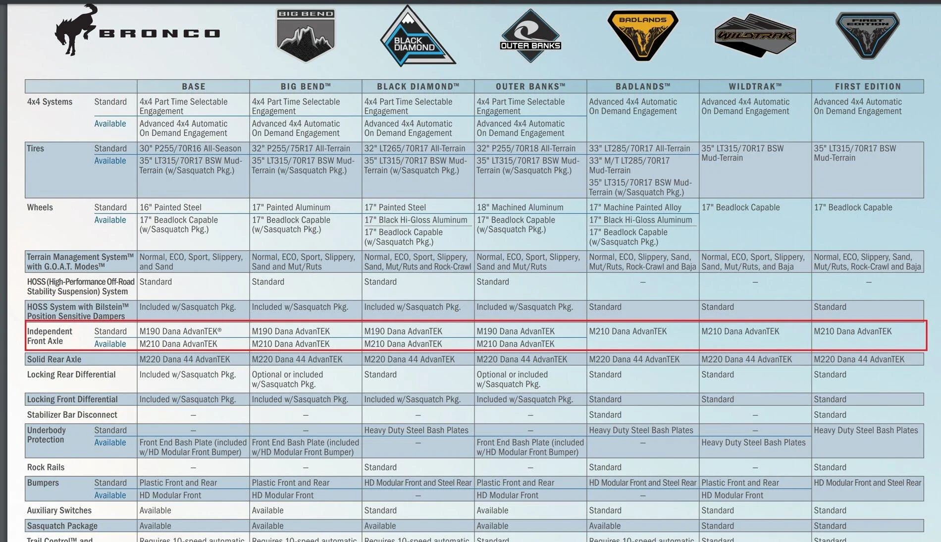

Just wondering if you guys think if say, you get a base model Bronco, will you get the bigger HD front diff if you get the 2.7L?
Seems reasonable no?

shows available in any model where it isn't standard
Ford Bronco 2.7L Option get bigger front Diff 210
Spooled
Mar 3, 2020
1,973
6,847
Republic of Texas
Raptor, Model 3
M190 = Aluminum housing open diff
M210 = Cast iron housing locking diff

But, I'm thinking Available means Available with the Sasquatch package, we will see...
