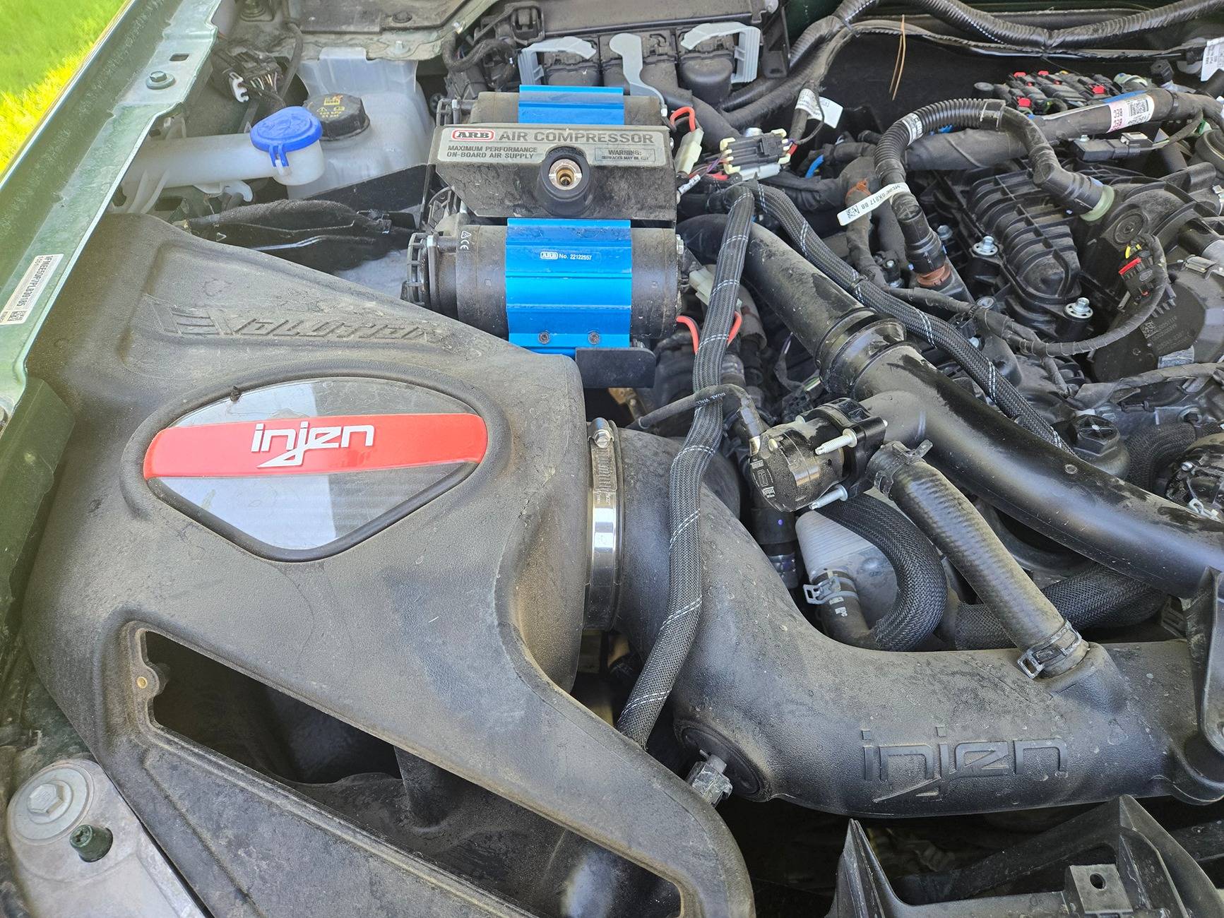

I usually go K&N but not this time, I went with the Injen Evolution with a dry filter and I love it. In my opinion it is the best design from the box all the way to the turbos. Dry filter because a lot of my local off roading areas have a lot of fine dust and dirt (moon dust). The Roush box and filter is bigger than stock and that is it, I expected better, but they are selling the name. K&N calls their design enclosed but the top of the box is mesh and I have covered my stock filter box in water and mud before while having fun so I don't like the mesh top. The injen is snorkel ready if you have or ever want to add one, filter and box are massive and it replaces the piping from the filter to the turbos with a larger diameter, so your air doesn't get choked back down to stock diamtet piping going to the turbos after the filter box. I picked up 2 mpgs, more power and the the sound is very mean and aggressive when the turbos spin up. I would recommend the Injen and would buy it again. The install is a little trickier than most because you are also upgrading the pipes to the turbos but not too bad. I managed with hand tools and a YouTube video and have no issues, just more fun.

Ford Bronco 2.7l cold air intake question and help 20240915_085721
