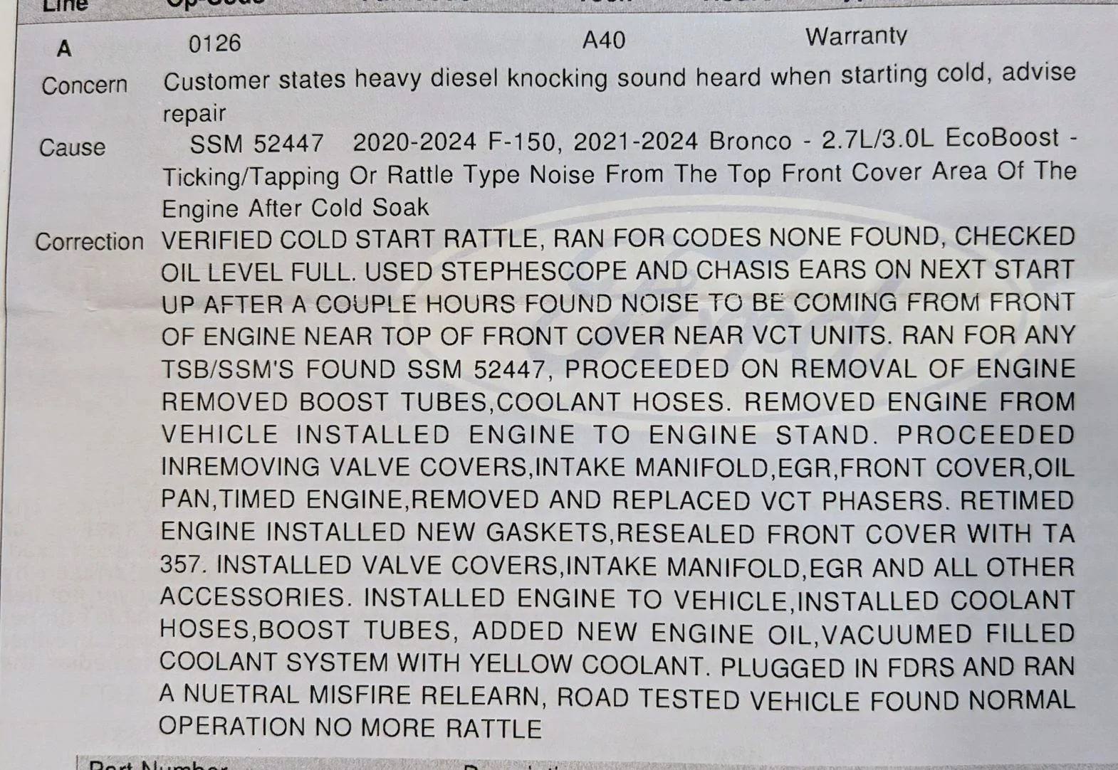

Picked my steed up today after one week at the local Ford service shop. Thought I'd share a pic of the details spelled-out on the receipt. At least it was all Warranty no-charge including an oil & filter change.

Well got it back today so they had it for 3 weeks hopefully there’s no hiccups 🤞only drove about 15 miles in to work, it look liked they put about 50 miles on it assuming from a test run after they were finished

My 2022 Badlands (2.7l V6) is experiencing this. Just talked to the dealer and the cam phasers need to be replaced at 22,500 miles.
The issue started immediately after a dealership oil change. The engine starts really rough for the first few seconds. If I prime the engine before starting it won’t make the growl/metal scraping noise.
Dealership says it could take a week to get the parts, and another 7 days to install.
Ugh. At least it’s covered under warranty.
