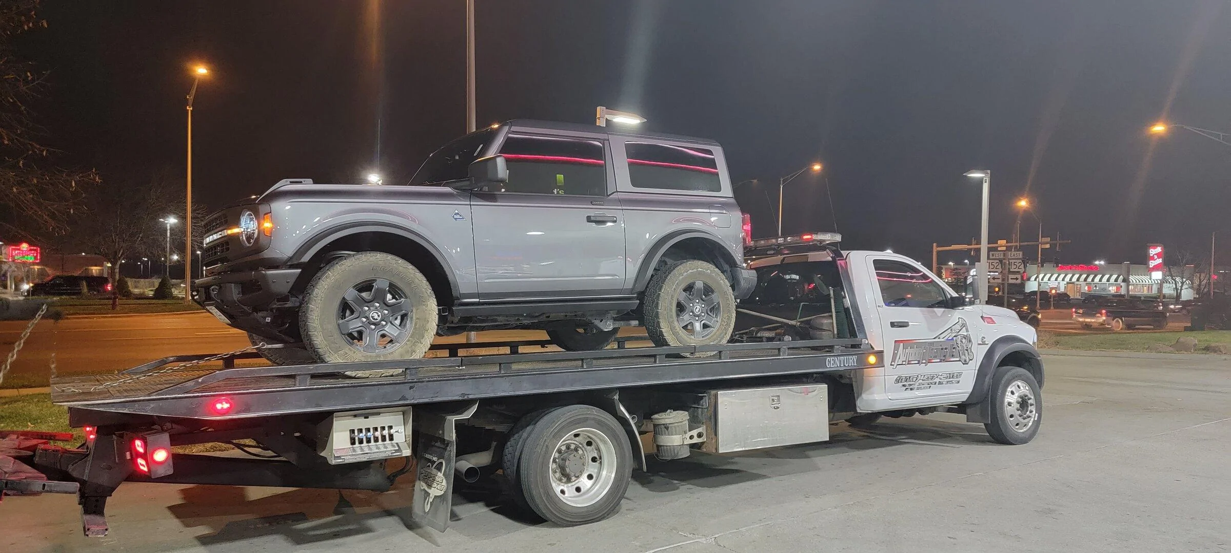

One week ago today my 2.7 failed and left me stranded in the road. No warnings, it just stopped running and will not restart. Dealership says that it needs a new engine.
When did you take delivery? How many miles?
It was a very early build. Then held for hardtop replacement. Finally took delivery in October. 6 weeks later and less than 3000 miles the engine needs replacement.
No reason why it needs a new engine (eco, normal, sport, baja)? What mode and octane fuel were you using?
