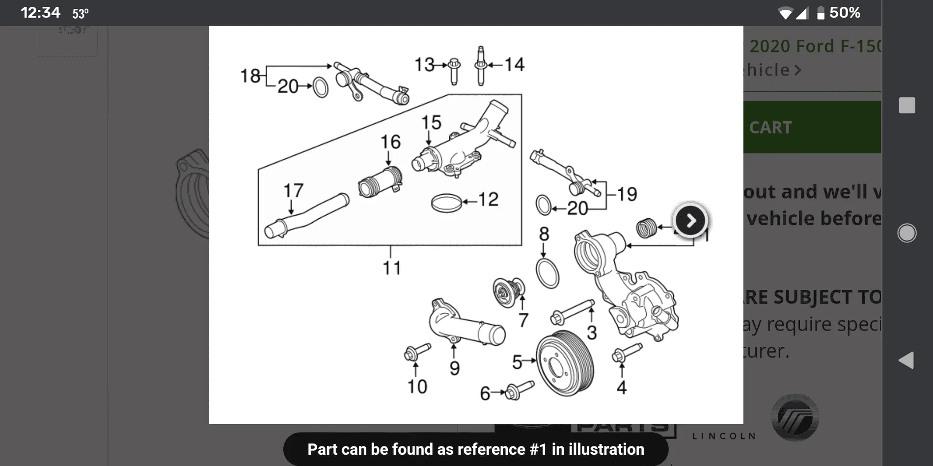

The explorer (pre-'20) were transverse applications and did have the pump behind the timing cover. Just looked up a 2020 F150 parts diagram for the water pump and looks external to me. I would think the bronco would be the same and not like the transverse package.
The pre-'20 Explorer never had the 2.7 V6. The 2.7 and 3.5 EcoBoost engines are completely and totally unrelated outside of the bellhousing pattern.
The 2.7 has an external water pump in both transverse and longitudinal applications.
