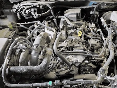

Side note: Following the vac boost line back from the booster it looks like it can get vacuum both from the manifold and the air intake ahead of the turbo with various check valves and electric sensors/valves
Ford Bronco 2.3 vacuum brake boost failure 1660668687196
Vacuum line shown along right side, over radiator and along left to intake. Ine spilts to manifold halfway along right side.

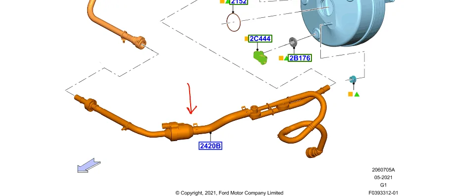

Should be this hose assembly with sensor.
Oh, fantastic, so it should be fixed either way once the part comes in whether it’s the sensor or the tube. Flip, many thanks once again 🙏
