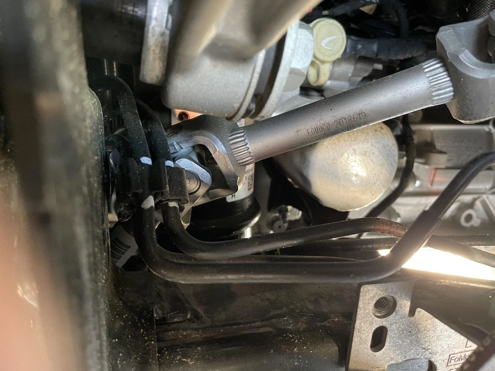

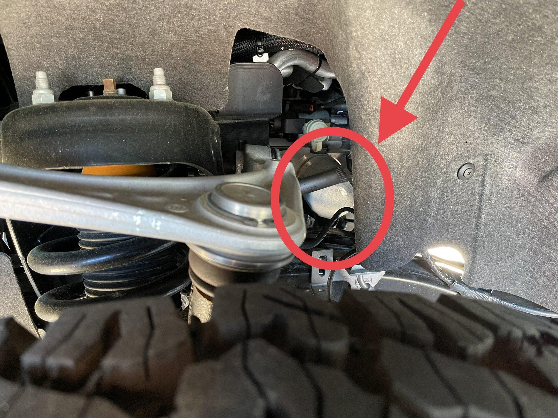

Checked this on a 2.3 BL 7MT at our dealer viewing last week. I wish Ford had a better solution considering this is a small inline 4 under a big hood, but there are worse out there (like the PITA skid plate blocking the cartridge filter on Tundras).
General config is the same as the Ranger. The good news is you shouldn’t need to pull any skid plates and maybe not even the snap-in wheel well panel. The bad news is that it’s a long ass reach to get your arm or a wrench to the filter, and in the Bronco the brake lines and beefy steering linkage look more in the way than with the Ranger. I think it’ll be tough to get leverage on it. Reminds me of squeezing between the manifold, shock tower, and a shitload of hoses to get to the side mounted filter on my dear departed 2JZ Lexus IS. Turning the wheel to the right should improve access and the Bronco has oil drainage channels to help keep the front axle/steering box clean. But tough to say how easy it will be to fish out that filter without upending it and spilling somewhere you don’t want to:
