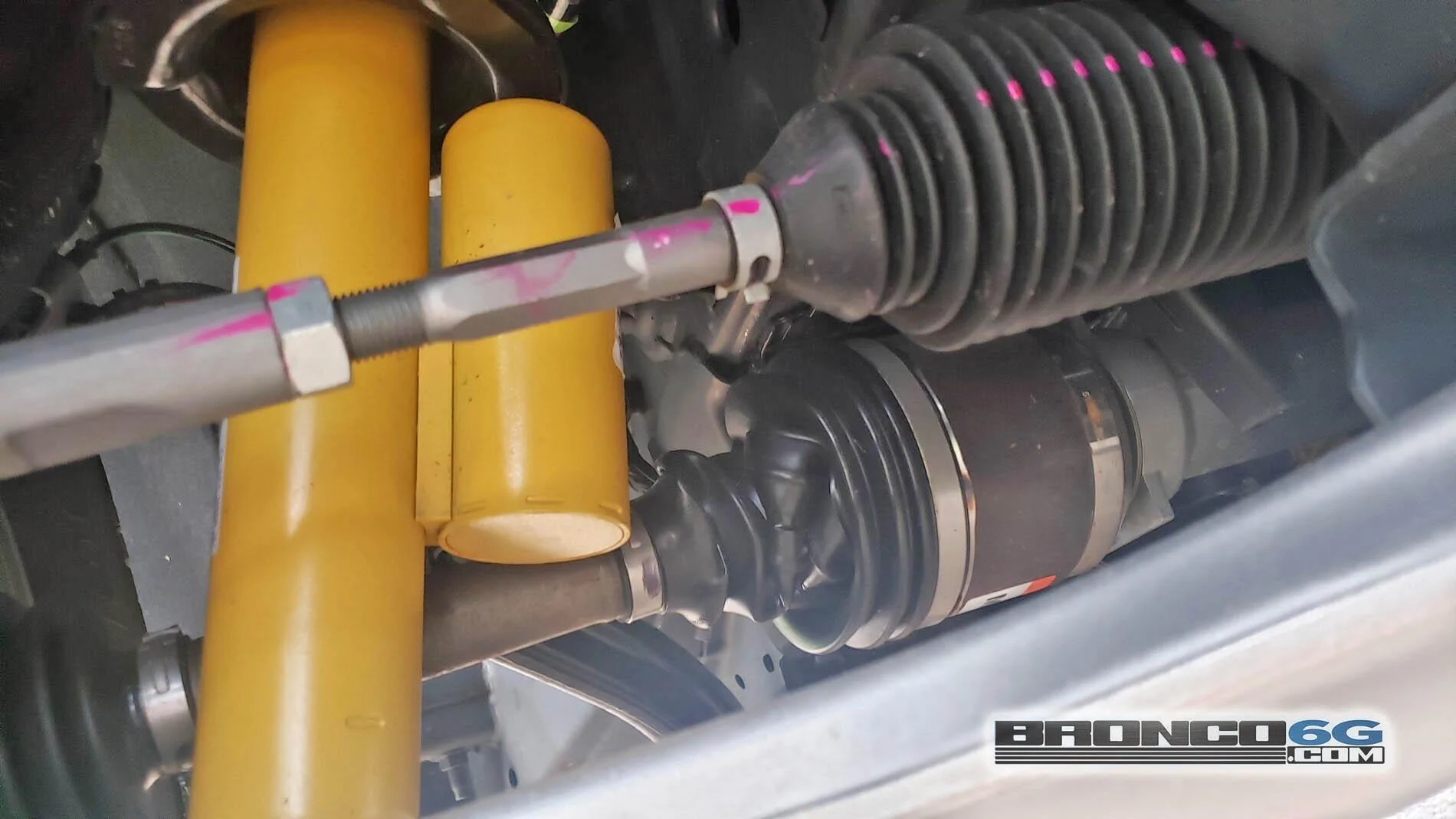

Issue: Broken front passenger axle at CV joint. Repair was Ford replacement of both front axles. Will take 5 to 10 days to get the parts.
Update: I was in 4L and lockers were not engaged.

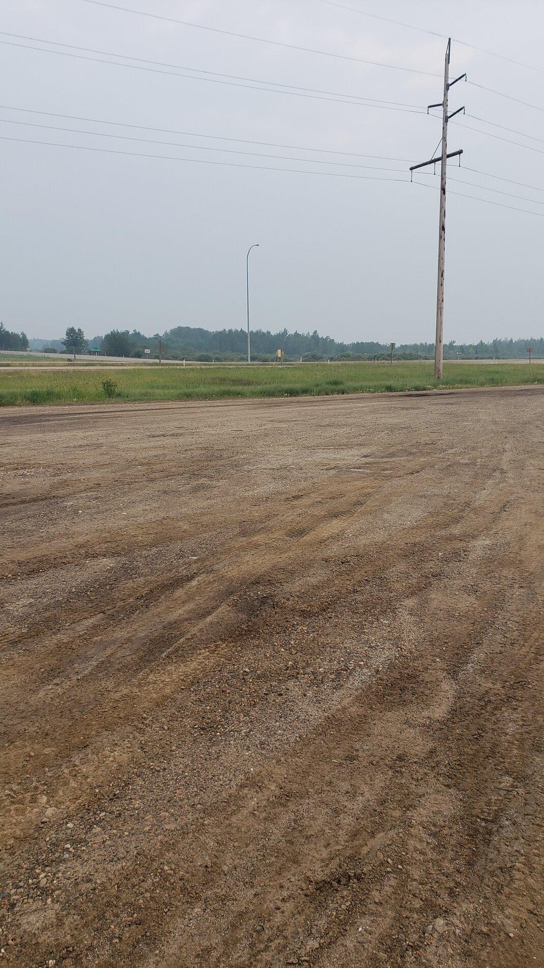

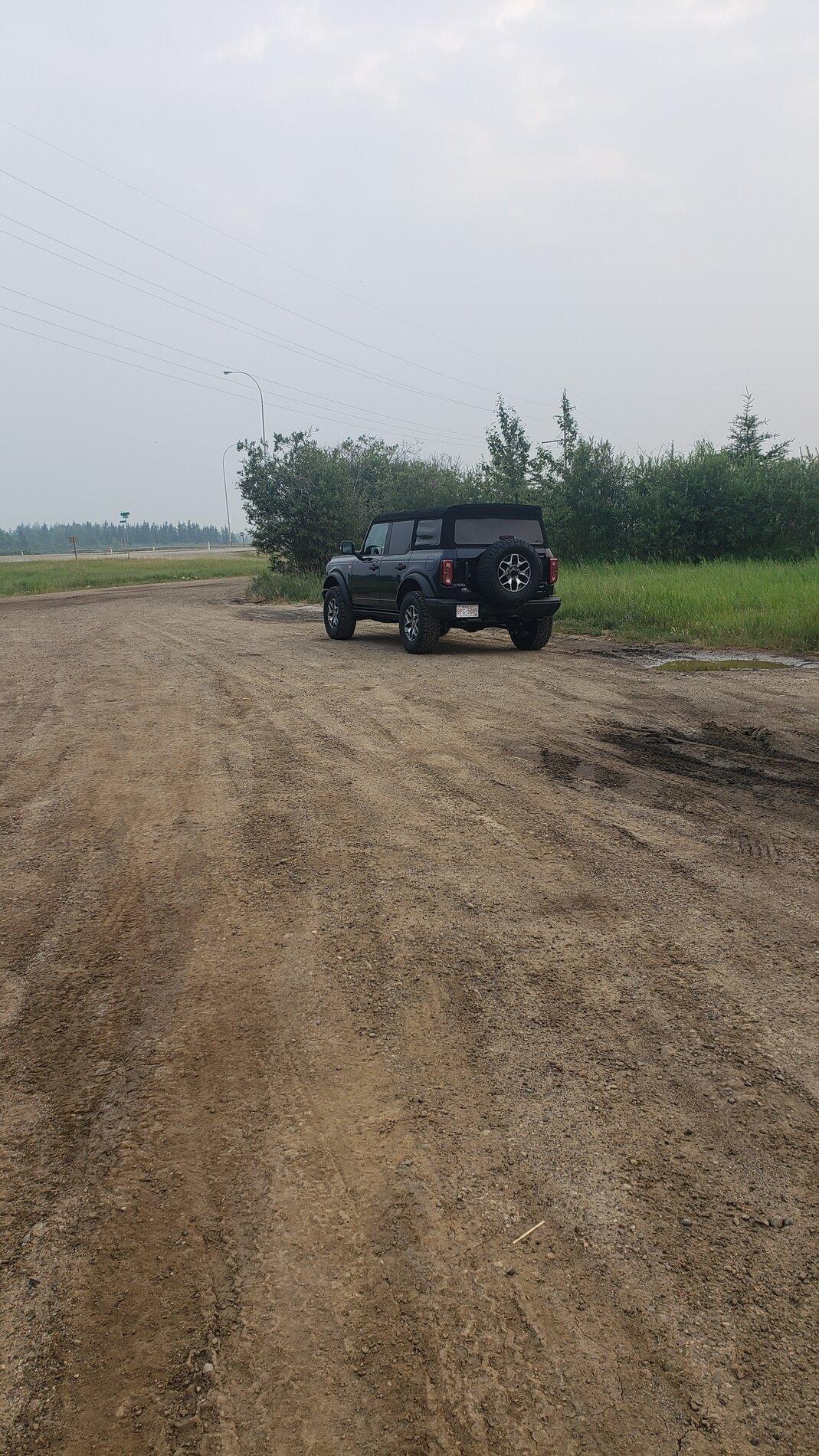

350KM after picking up my dream machine that took a year to arrive, it was on the back end of a tow truck with a broken front right axle heading back to the dealer for repair. The axle broke on a flat loose gravel parking lot at less than 5 km/hr with no load on it , while I was testing out (showing off) the 4 wheel cameras to my better half.
I have been a 4x4 enthusiasts for over 30 years and broken many axle as such I have learned not to full lock. The intent of the post was to see if this was an issue others have had. I am glad to hear it isnt.
Photos of break down and gravel parking lot that it happened and got towed from:
Ford Bronco Broken front axle at CV joint on my Bronco Badlands 4-Door 2.7L 2021-bronco-broken-front-axle-cv-joint-jpg
Ford Bronco Broken front axle at CV joint on my Bronco Badlands 4-Door 2.7L 20210719_205410-
Ford Bronco Broken front axle at CV joint on my Bronco Badlands 4-Door 2.7L 20210719_205414-

I'm gonna need some pics. Curious what actually broke.

Auto or manual trans? Do you know what gear it was in (assuming low given the speed)? Was it the axle shaft that broke, or u-joint/CV (can't recall at the moment what Ford uses)?

I'm thinking not as loose of gravel as assumed......I have seen inferior parts on Fords but never a broken axle on something that wasn't abused......
