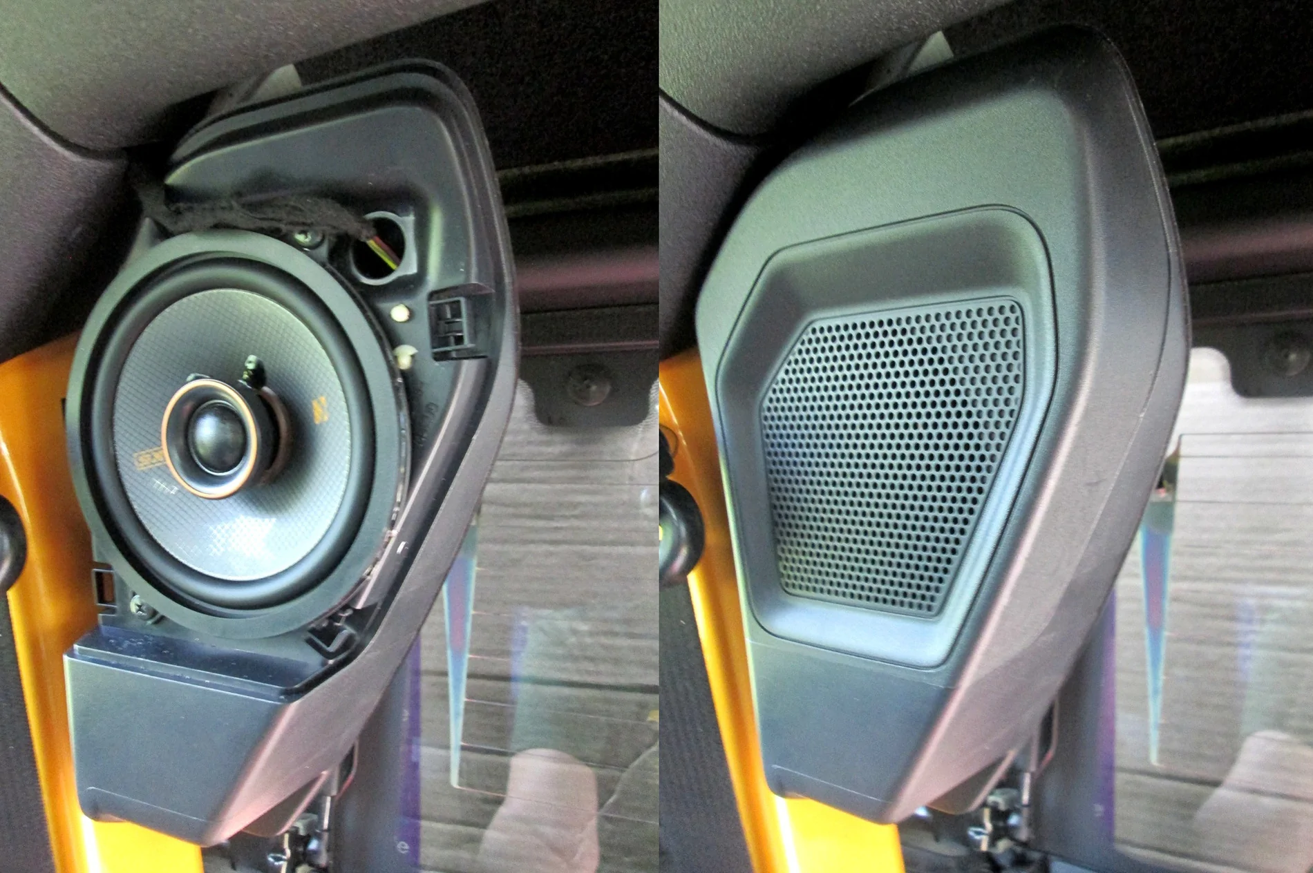

Kicker KSC 5.25" speakers are a perfect fit. It took me an afternoon to do the swap. Enlarge the holes in the pods, install the Kickers and snap on the grilles; it's a total stealth upgrade.

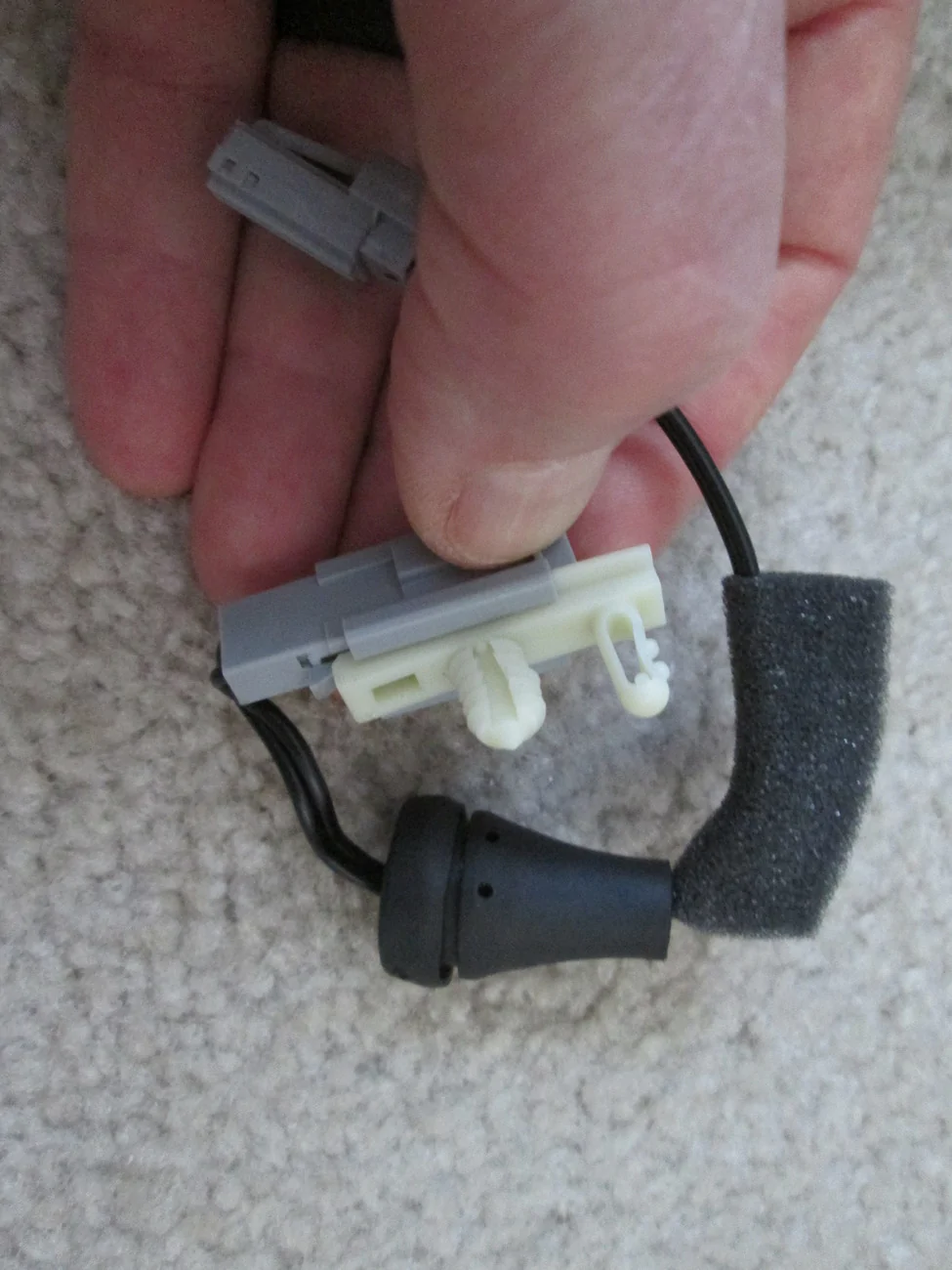

Disconnect the Pod from the roll bar and remove the Factory Speaker. Pry the Factory Harness Connector from the holes in the top of the Pod with a screwdriver. Push the Factory Harness Grommet out of the Pod Grommet Hole from the INSIDE. Unclip the White Press Pin Retainer from the Factory Harness Connector and slide onto the Metra Harness Connector.

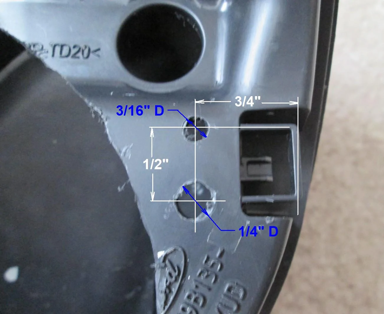

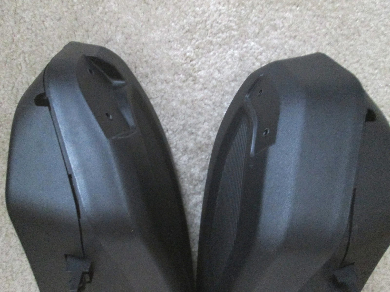

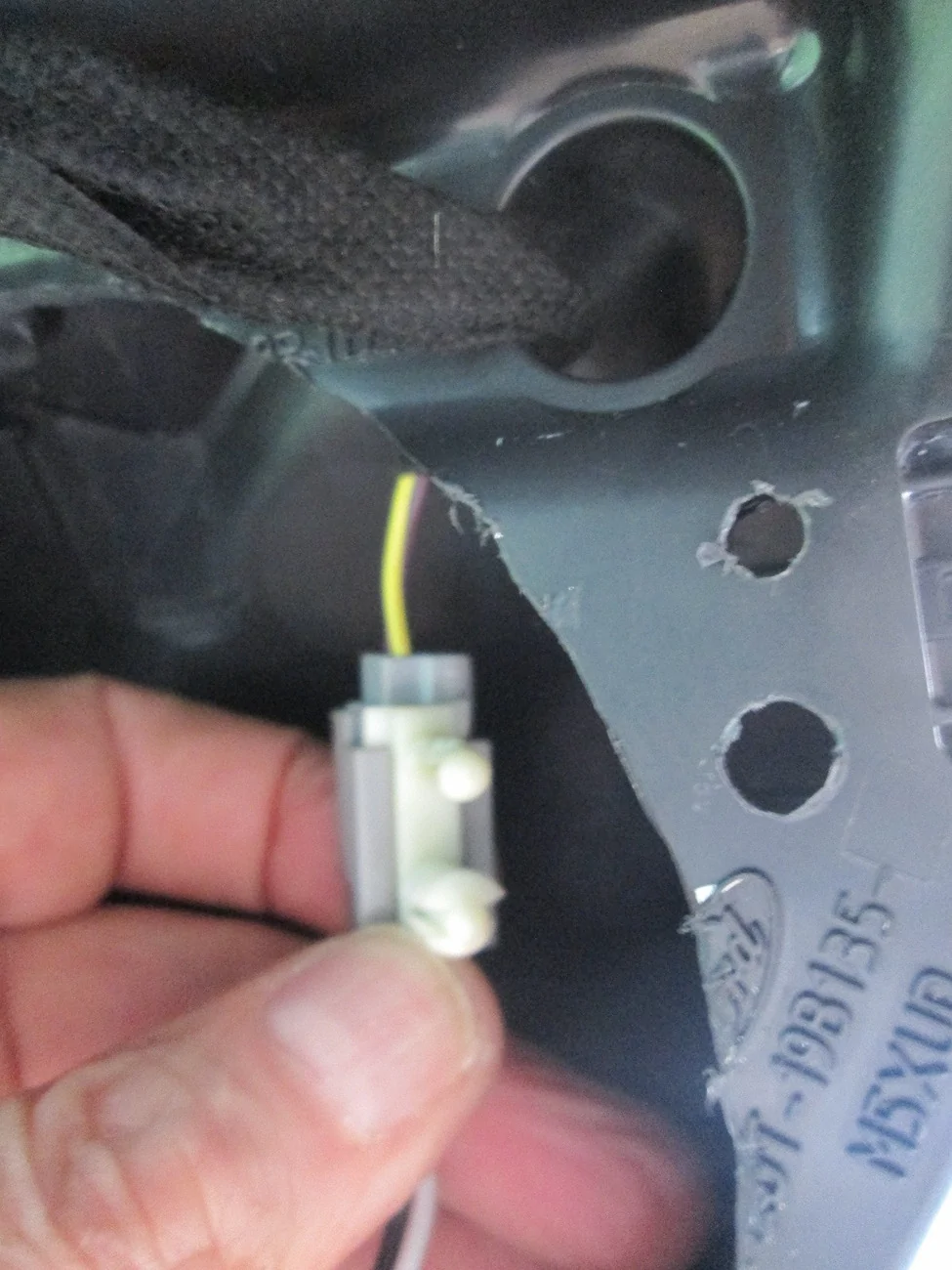

Use this sketch to drill the New Push Pin Holes for the Metra Harness Connector.
Ford Bronco How to Install 5.25" Kicker KSC Speakers in the Factory Pods IMG_0002print

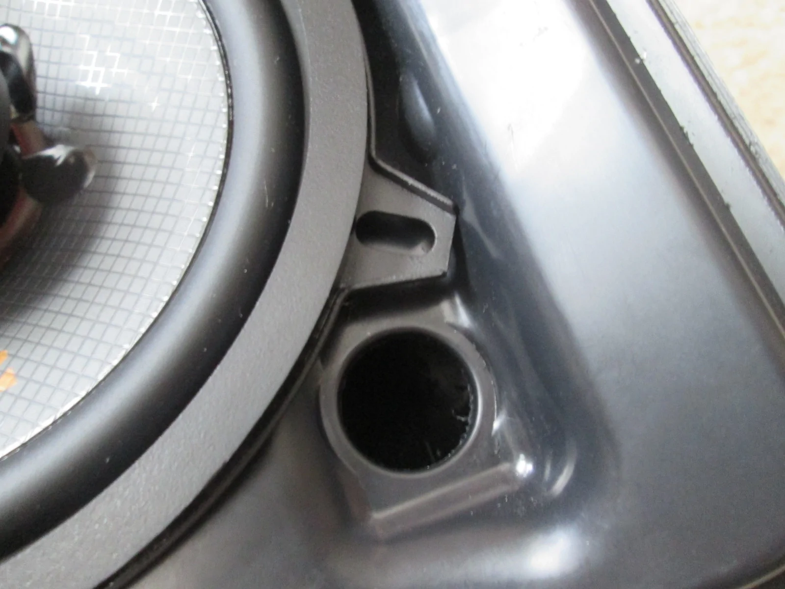

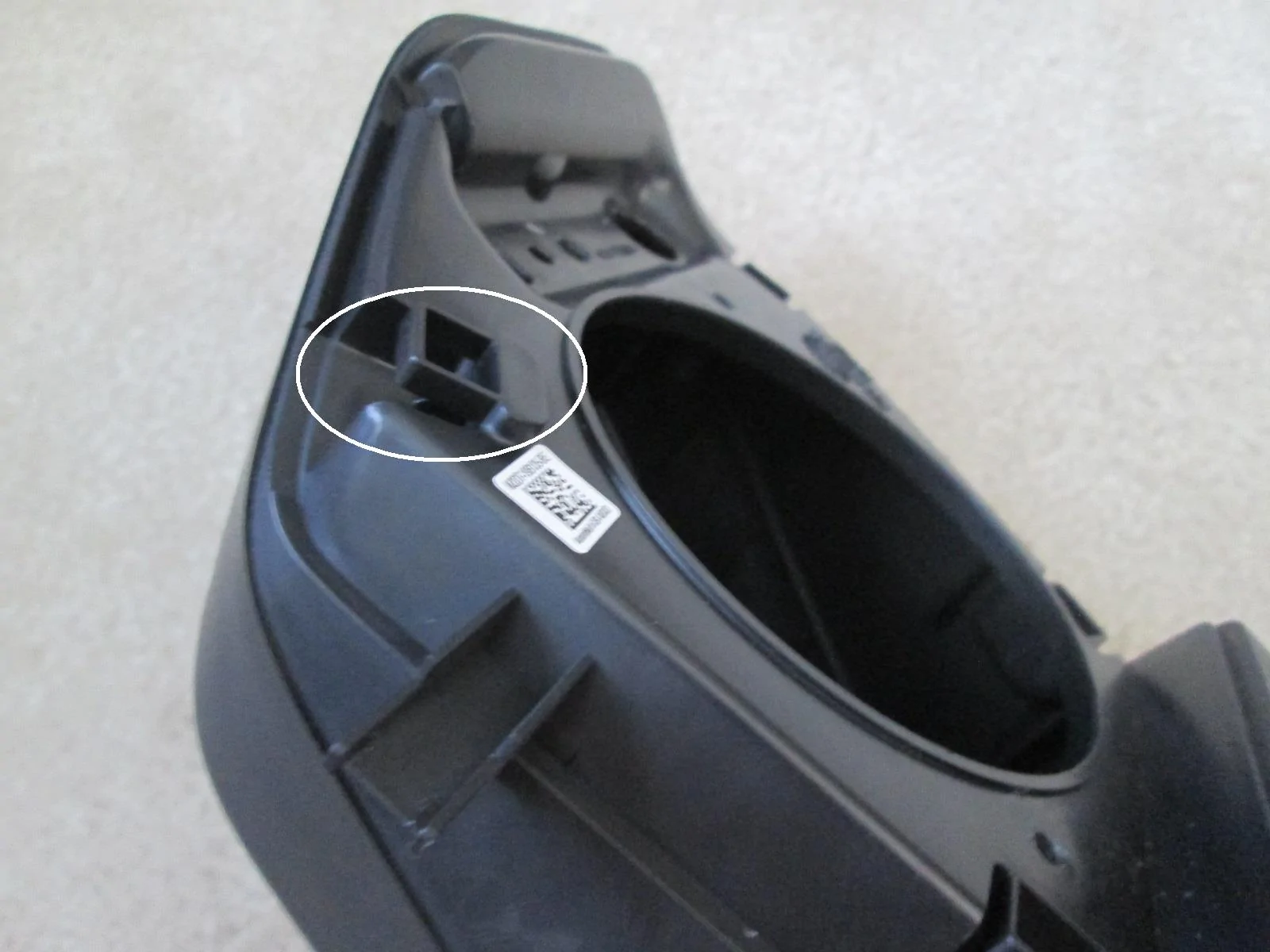

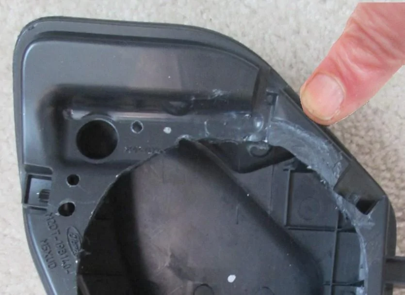

Grind the Upper Outer Grille Mounting Boss even with the face of the Pod with a Dremel/rotary tool.
Ford Bronco How to Install 5.25" Kicker KSC Speakers in the Factory Pods IMG_0003a
Ford Bronco How to Install 5.25" Kicker KSC Speakers in the Factory Pods IMG_0003bALT

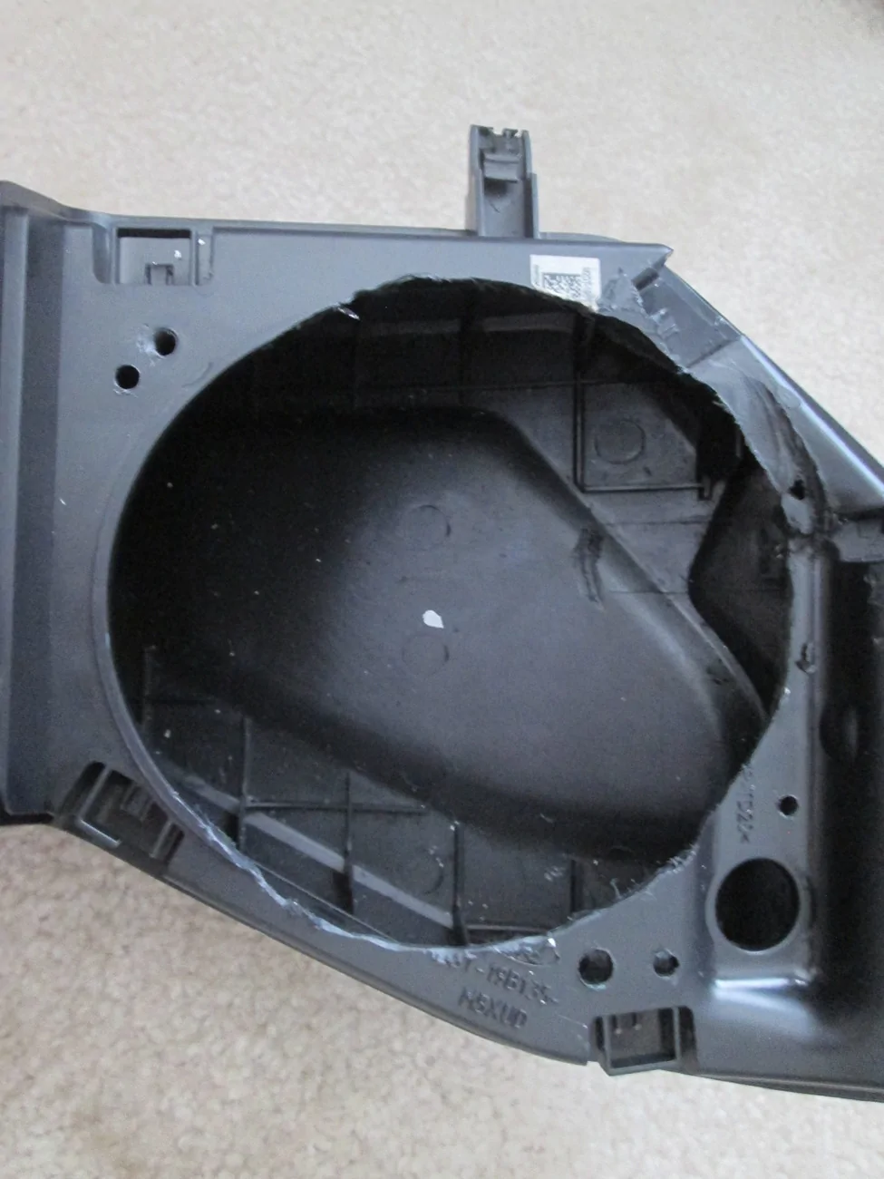

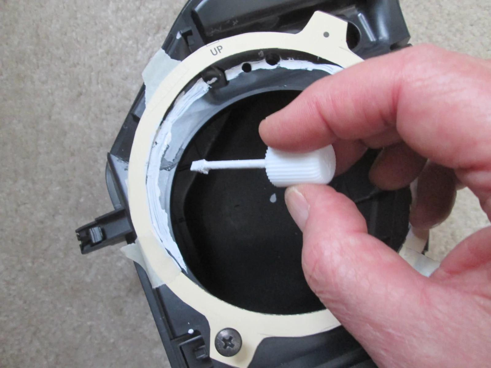

Use this Template to mark the hole for the Speaker. Here is a link to the pdf so it prints the right size: https://template-8d9c34.tiiny.site/ . Use cardstock if you have it, cut out Template, and punch the Bottom Hole with a pencil.
Ford Bronco How to Install 5.25" Kicker KSC Speakers in the Factory Pods Templat

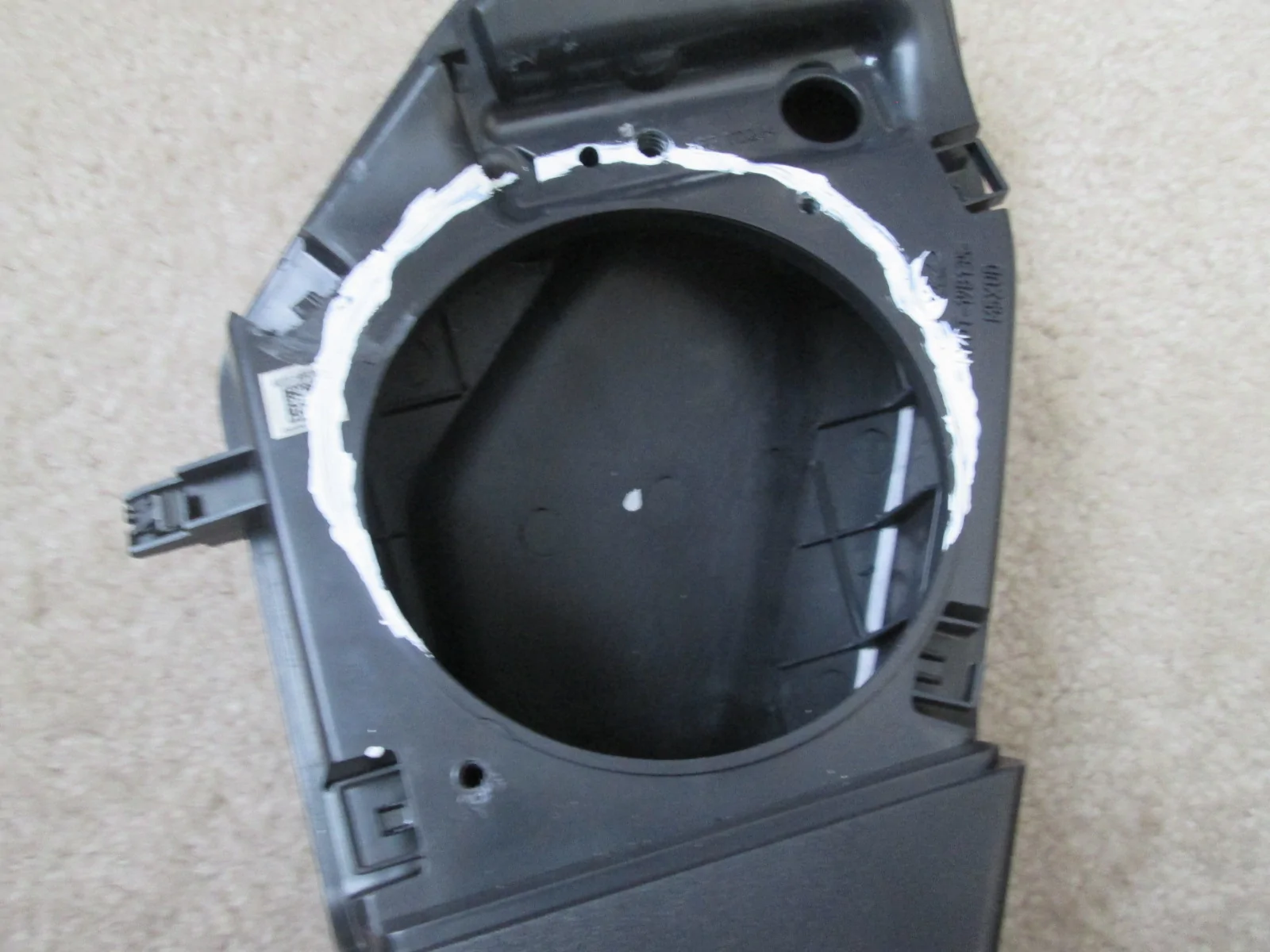

Attach the Bottom Hole of the Template to the Pod's Original Lower Speaker Mounting Hole with one of the Original Speaker Mounting Screws and center the Template between the outer edges of the Pod. Brush the inner perimeter of the Template with White Out. Enlarge the Pod Opening to the size indicated by the Template with a Dremel/rotary tool. This is the hardest part of the job.
Ford Bronco How to Install 5.25" Kicker KSC Speakers in the Factory Pods IMG_0004
Ford Bronco How to Install 5.25" Kicker KSC Speakers in the Factory Pods IMG_0004a

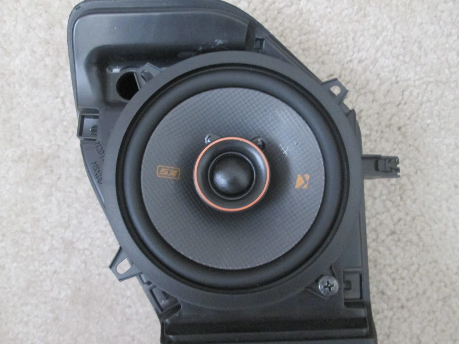

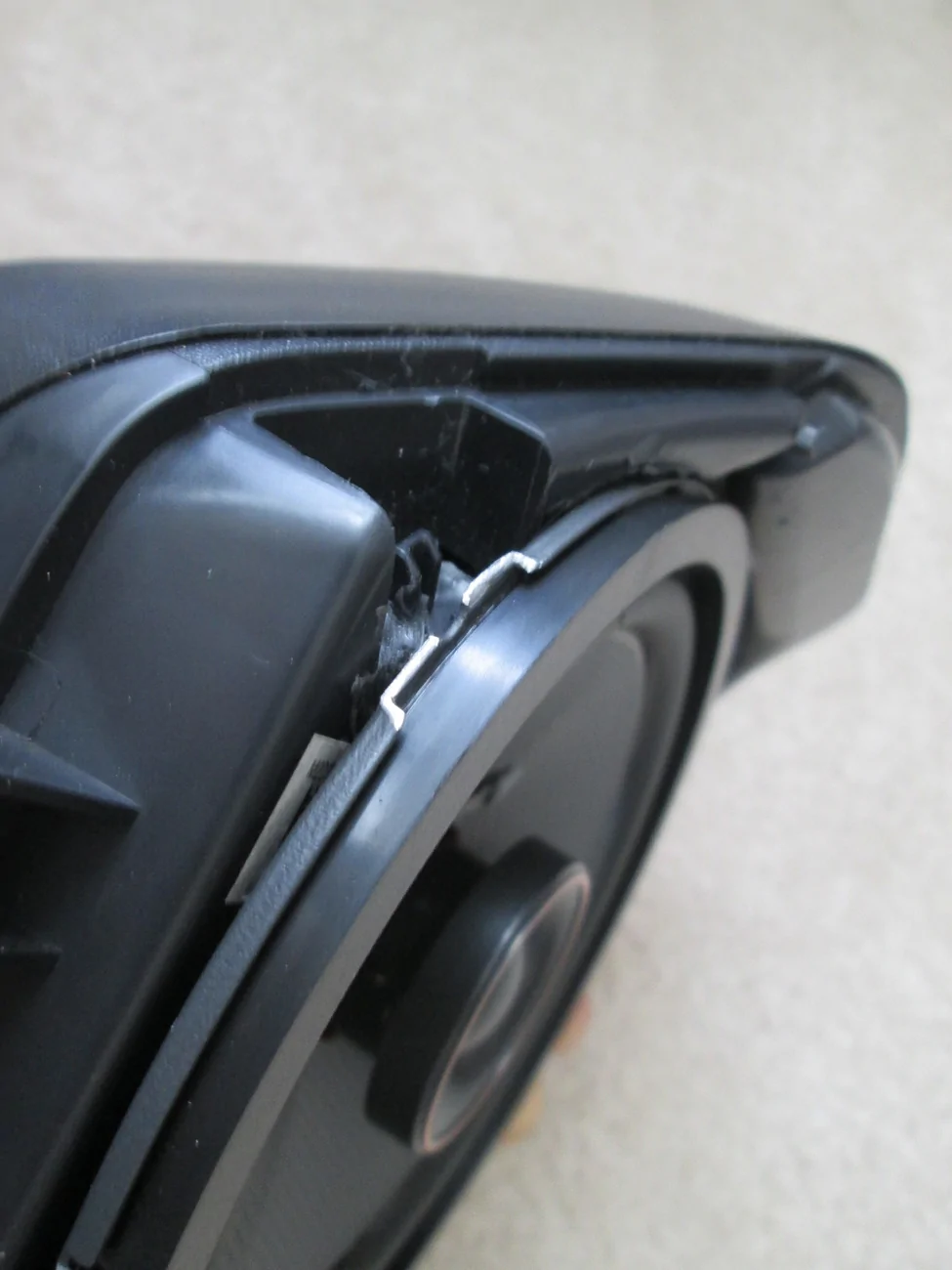

Insert the Speaker into the Pod with the Wiring Terminals at the TOP. It may be necessary to tweak the opening slightly so the Speaker is centered between the outer edges of the Pod. Secure the Speaker's Lower Mounting Tab with one of the Original Speaker Mounting Screws.
Ford Bronco How to Install 5.25" Kicker KSC Speakers in the Factory Pods IMG_0007

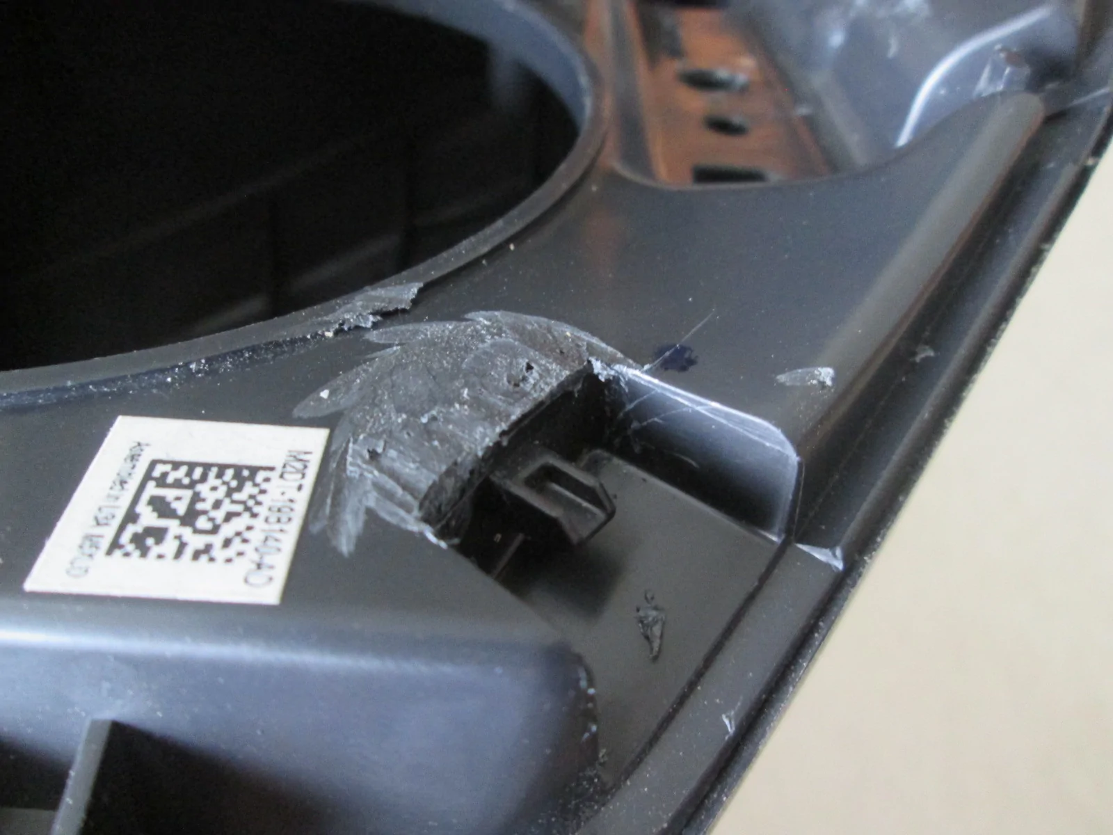

Mark the two, Speaker Mounting Tabs that protrude beyond the sides of the Pod with a dab of White Out. Use a Scribe/Nail to mark the raised portion of the top outer corner of the Pod that is preventing the Speaker from sitting flat.
Ford Bronco How to Install 5.25" Kicker KSC Speakers in the Factory Pods IMG_0008
Remove the Speaker. Grind the raised portion with a Dremel/rotary tool so the Speaker sits flat.
Ford Bronco How to Install 5.25" Kicker KSC Speakers in the Factory Pods IMG_0008aALT1

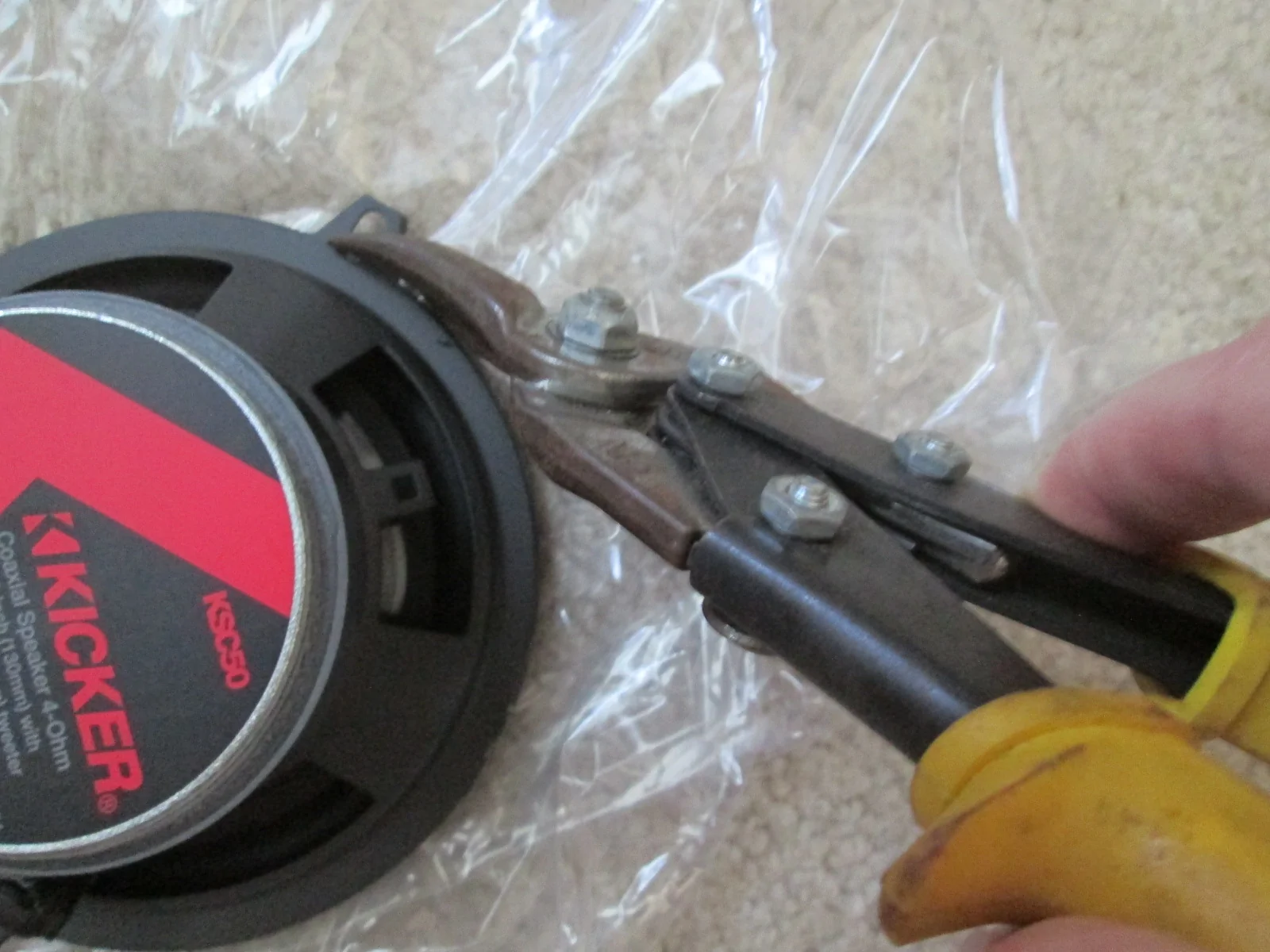

Use Tin Snips to cut off the two Speaker Mounting Tabs marked with White Out.
Ford Bronco How to Install 5.25" Kicker KSC Speakers in the Factory Pods IMG_0009

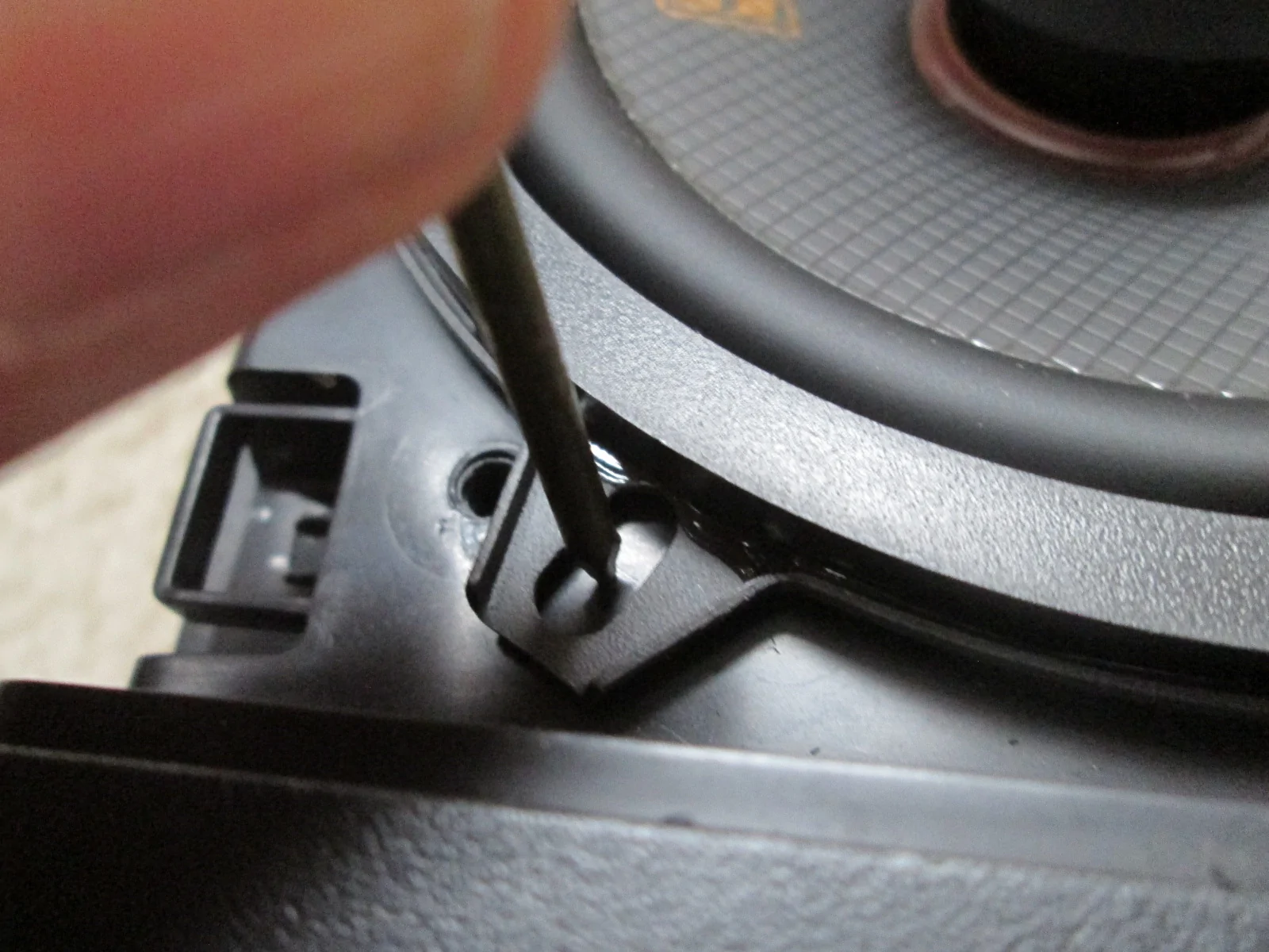

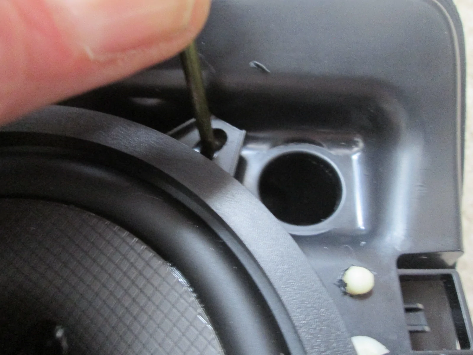

Insert the Speaker into the Pod with the Wiring Terminals at the TOP. Rotate the Speaker slightly so the Upper Mounting Tab just touches the raised portion of the Pod. Mark the CENTER of the oval holes in the Speaker Mounting Tabs with a Scribe/Nail to indicate the location of the New Mounting Holes.
Ford Bronco How to Install 5.25" Kicker KSC Speakers in the Factory Pods IMG_0011
Ford Bronco How to Install 5.25" Kicker KSC Speakers in the Factory Pods IMG_0011a

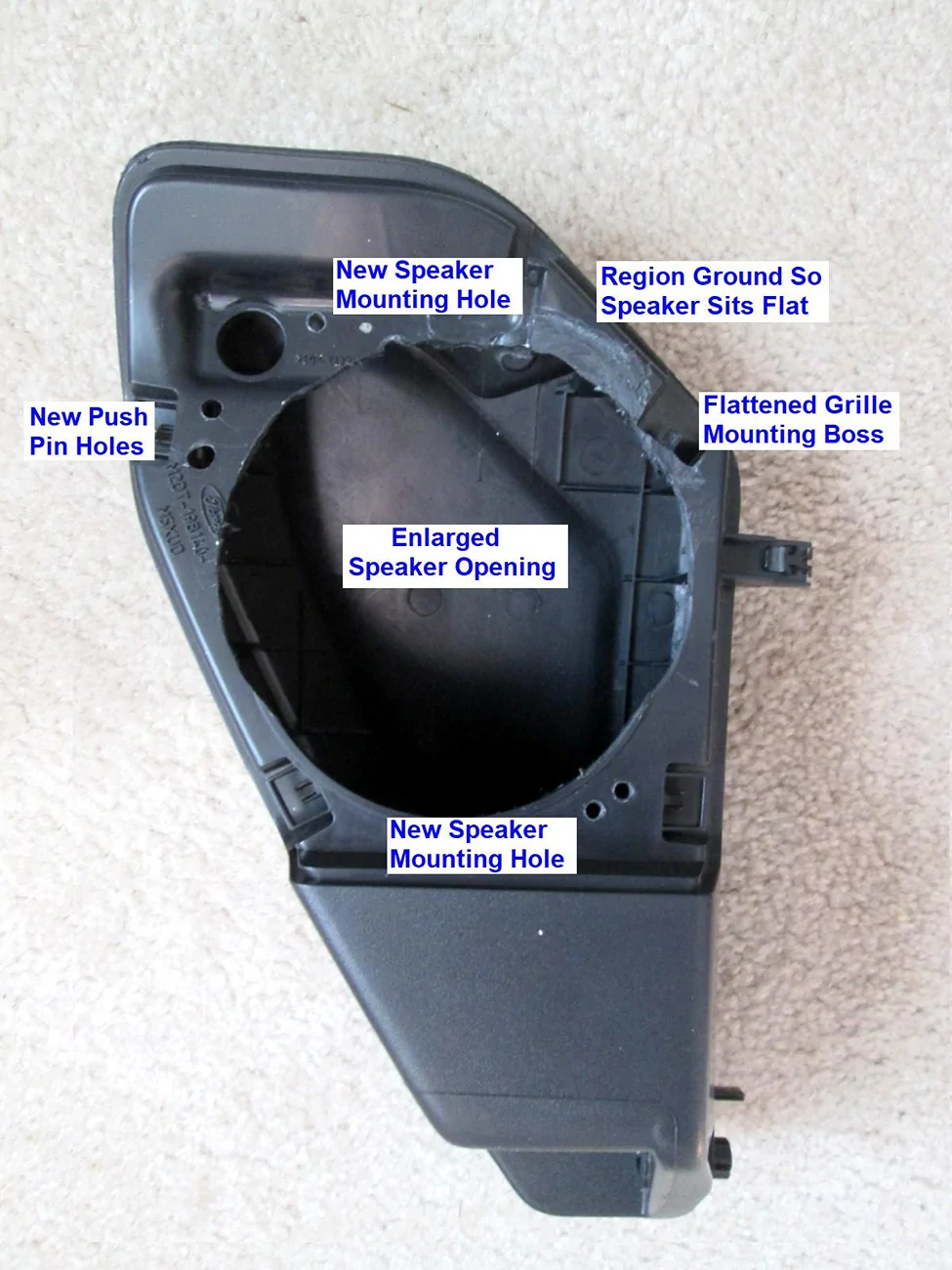

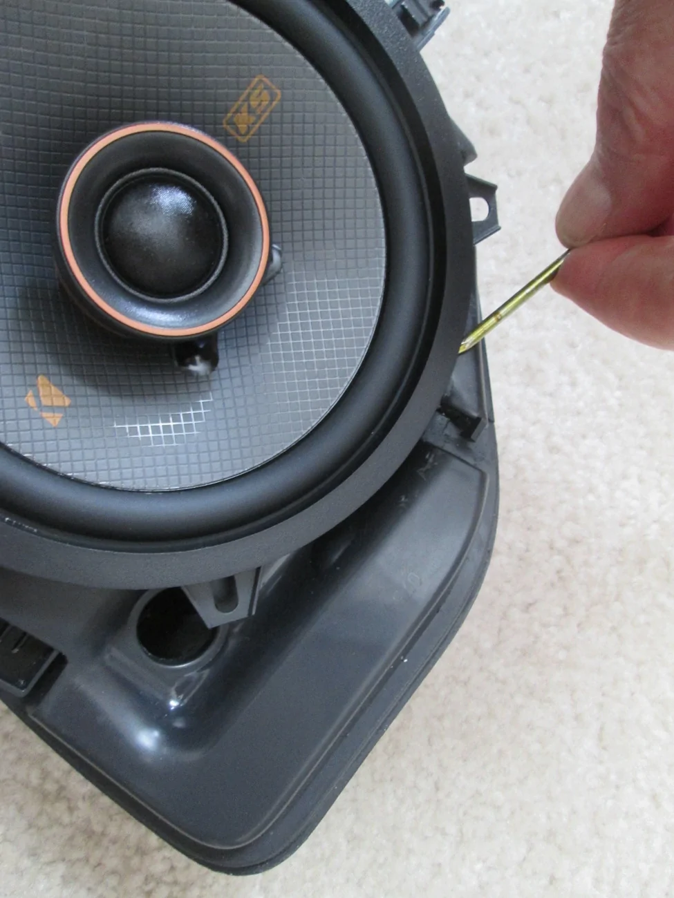

Remove the Speaker. Drill the New Mounting Holes with a 5/32" bit. Run the Original Mounting Screws into the Holes to form threads in the plastic.
Ford Bronco How to Install 5.25" Kicker KSC Speakers in the Factory Pods IMG_0011c

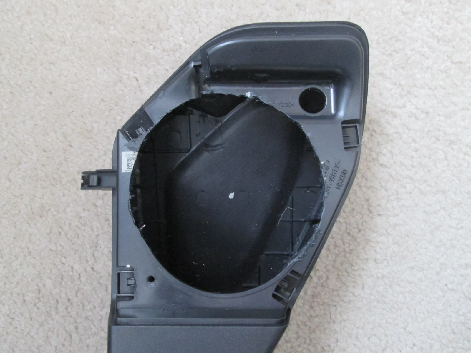

Here is a picture of the fully modified Pod (New Push Pin Holes, Flattened Grill Mounting Boss, Enlarged Speaker Opening, Eyebrow ground in raised portion of top outer corner so Speaker sits flat, and New Mounting Holes).
Ford Bronco How to Install 5.25" Kicker KSC Speakers in the Factory Pods IMG_0011dLabeled

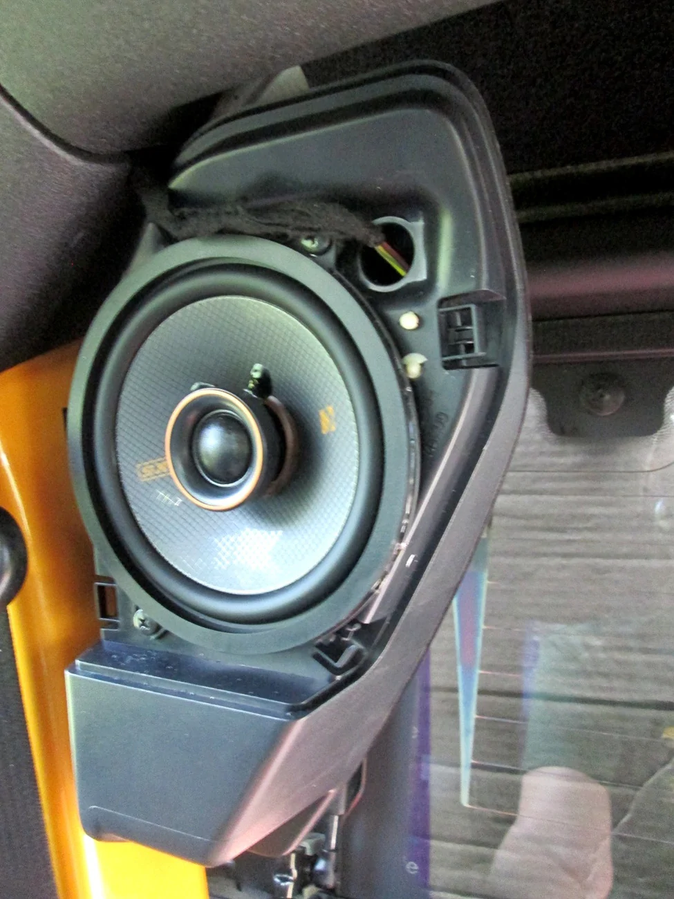

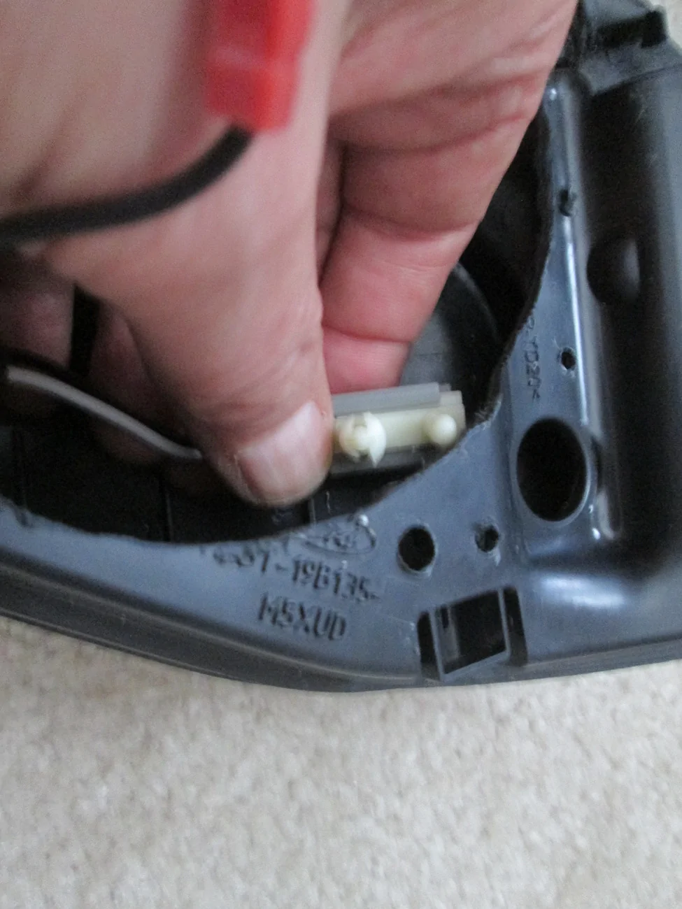

Loosely install the Pod on the roll bar. Route the Chassis Harness though the Pod Grommet Hole and plug into the Metra Harness Connector.
Ford Bronco How to Install 5.25" Kicker KSC Speakers in the Factory Pods IMG_0021
Insert the Metra Harness Connector into the Speaker Hole, and press the Push Pins into the New Push Pin Holes from INSIDE the Pod.
Ford Bronco How to Install 5.25" Kicker KSC Speakers in the Factory Pods IMG_0019
Connect the Metra Harness to the Speaker Terminals. Fit the Speaker into the Pod and secure with the Original Attaching Screws (Position a 1/4" nut between the Upper Speaker Mounting Tab and the Pod as a Spacer).
Ford Bronco How to Install 5.25" Kicker KSC Speakers in the Factory Pods IMG_0024

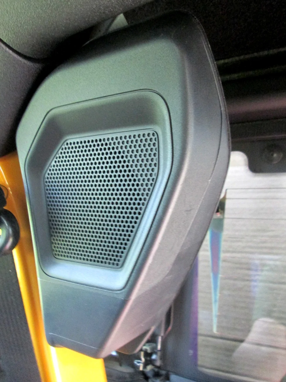

Install the Speaker Cover and secure the Pod to the Roll Bar.
Ford Bronco How to Install 5.25" Kicker KSC Speakers in the Factory Pods IMG_0024a

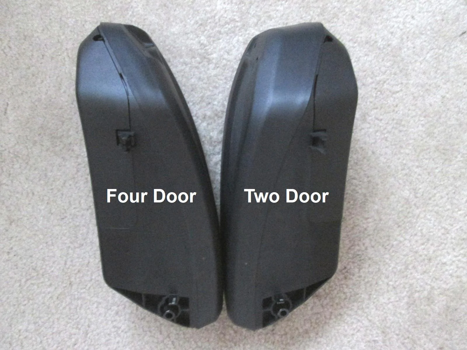

Lesson Learned:
Four-doors Pods are different than two-doors (Grilles are the same). I was able to make the ones Fordsoldier gave me work, but had to fabricate a set of sheet metal brackets to mount them to the roll bar in my two-door. That took longer than modifying the Pods for the 5.25" Kickers.
