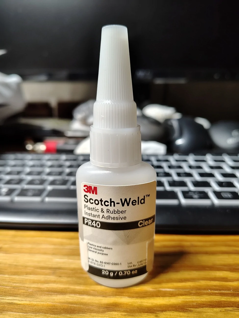

On a related topic. Has anyone found a method for dealing with broken tabs used to fasten black plastic trim? ... short of hot glue or some other "adhesive" likely to make it difficult to remove for access later? Using proper plastic tools and being extra careful (I thought) I managed to break 2 tabs on the longer horizontal access panel on the tailgate door, to access and feed wiring. The pieces are now lost in the lower abyss.
Any advice is welcome.
Depending on the type of plastic/rubber, this 3M product can work great. I glued a rubber cut on my spare tire. Some people in a pinch use it to glue sidewall patches on their tires when off-roading. I used the PR40 version pictured but it comes in various viscosities. Apparently it's similar to super glue but stronger and works with a wider range of materials.
