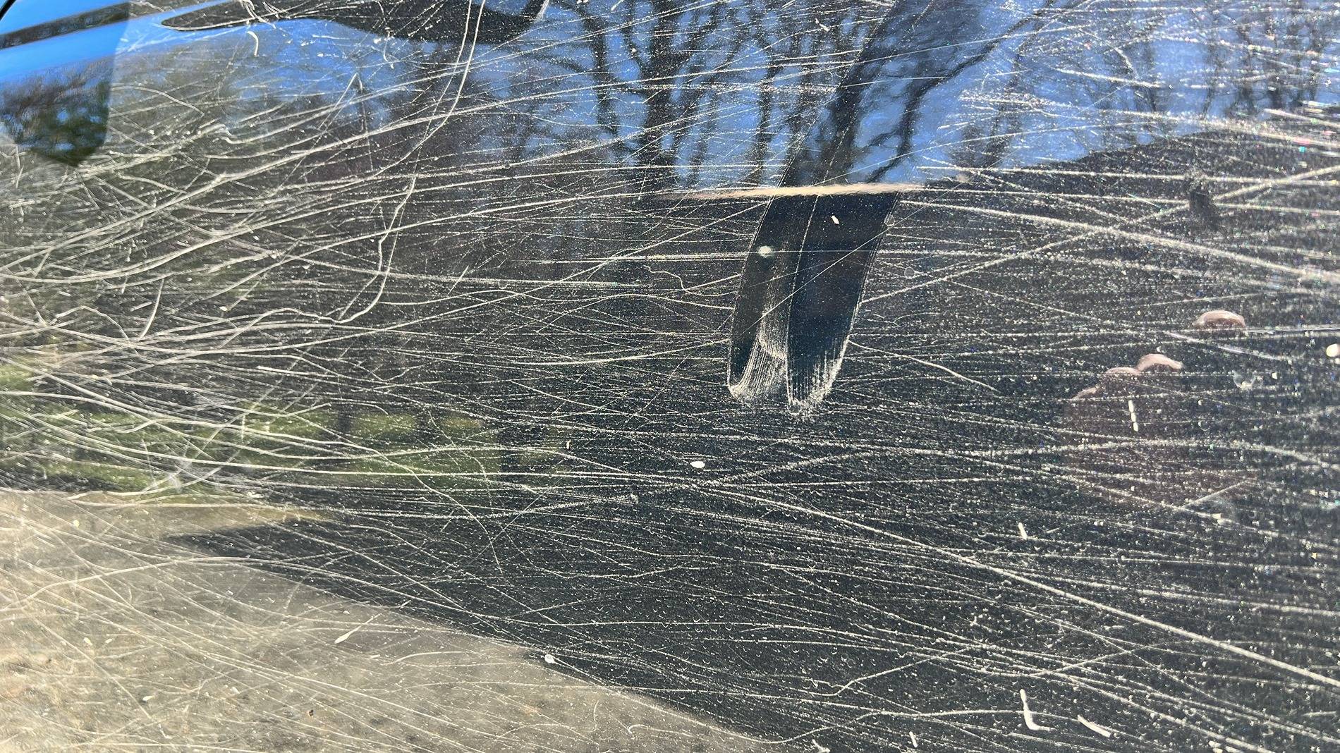

I picked up my brand new, 2024 Two-door Heritage Bronco the end of February. Before it even had its first oil change, I put it thru hell during the STAR Expedition.
Pinstriping... A LOT of pinstriping.
Today, I fix that....

Ford Bronco Pinstriping? Scratches? Paint damage? Let's fix that.... 1000049803
About day 8 of ownership.. only about 5-10% of it made it through the clear coat but no point trying to keep this black paint nice
Yeah this is what mine looks like coming off the mountain. Most of that washes off, but I’ve got a few nice lines that are down in the paint.
Doesn’t mean I don’t care how it looks, so glad for the video - I’ve been meaning to figure this out and see if something more than just the scratch remover paste and a rag does better
Yeah I didn't mean to imply i just totally don't care.. more like I'll do it once a year or so. I've had ok luck with a few correction compounds and a polishing bit for my drill but I wear the deep ones with pride still haha
Yeah, the off the shelf paste is a waste of money. It works at trying to fill the scratches more so than remove them. More like a glaze product.
You can find good, enthusiast products online and learn lots from the detailing forums as well šŸ¤˜šŸ»
