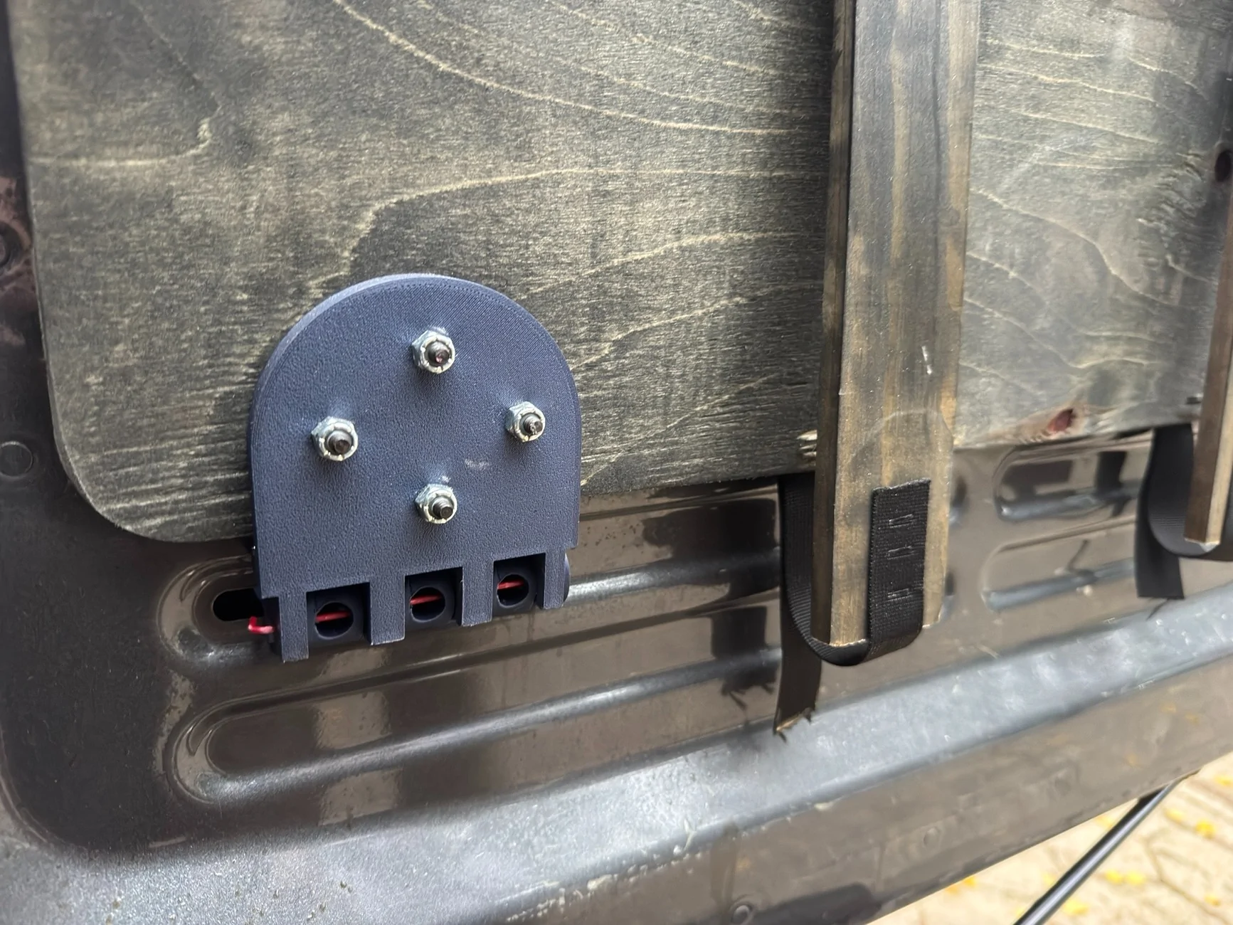

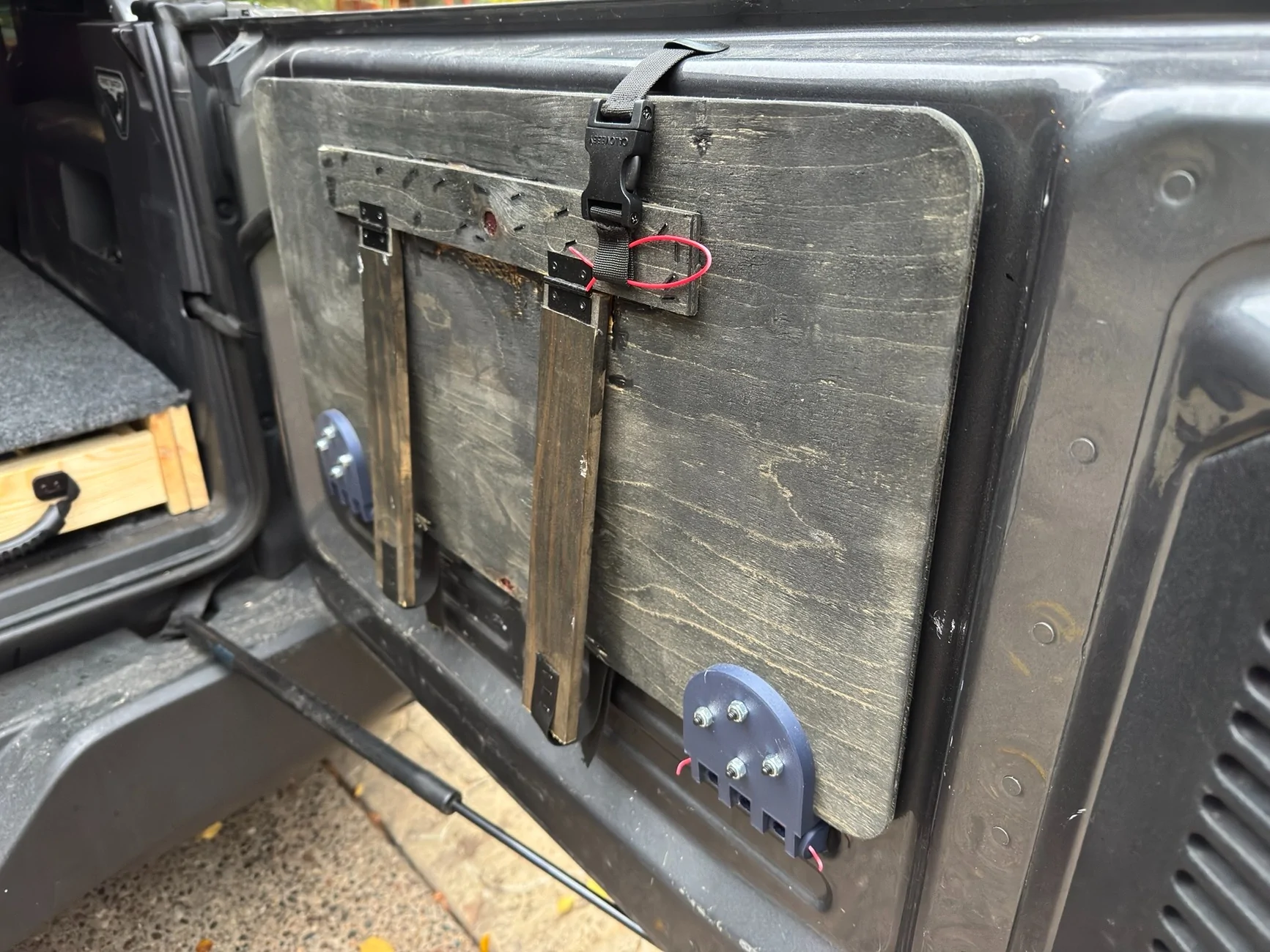

add a couple close ups of your hinge set up on the tailgate door please
3D printed the hinges. Simple leg set up... gravity just pulls them into place and the straps hold them at the right height. Tailgate table is pretty strong! Used 3d printer filament as the hinge pin.
Put a strap and buckle into that grommet on top of the tailgate to hold it in the up position.
