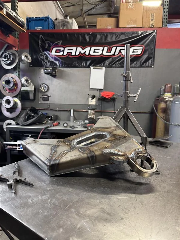

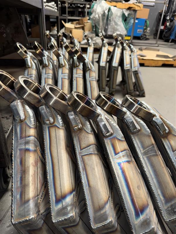

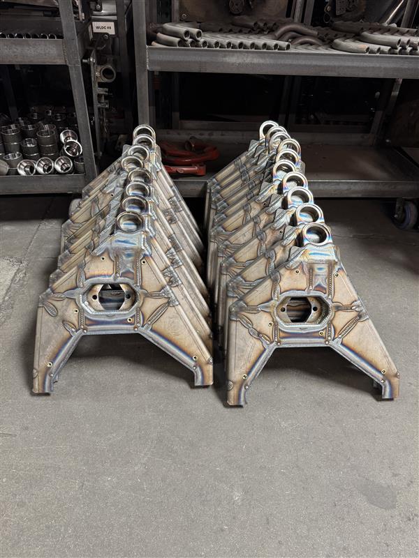

We are welding up more long-travel lower arms for your broncos! This kit widens your track width 2" per side, as well as added wheel travel and strength. The ultimate upgrade whether you are exploring MOAB or wide open in Baja.

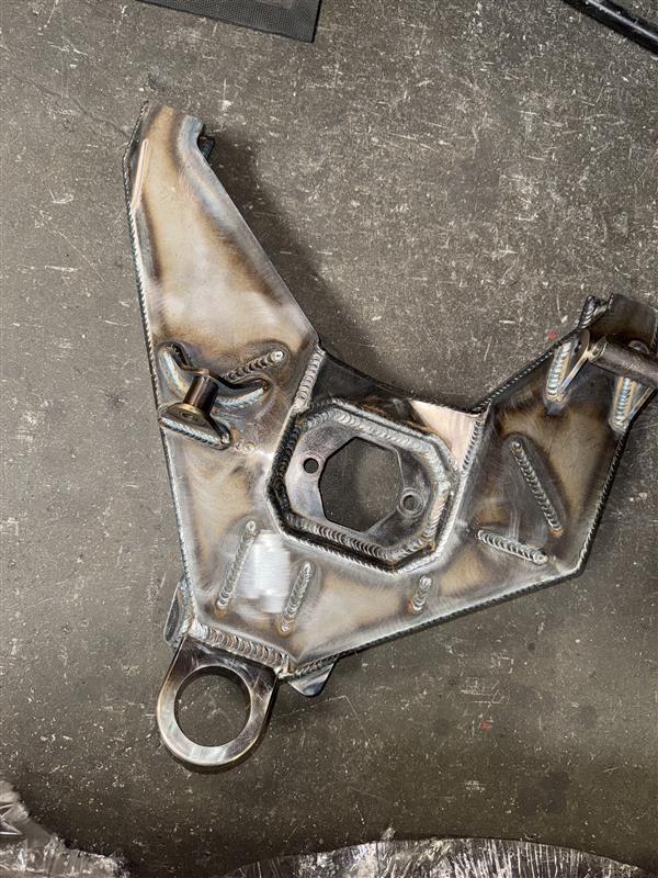

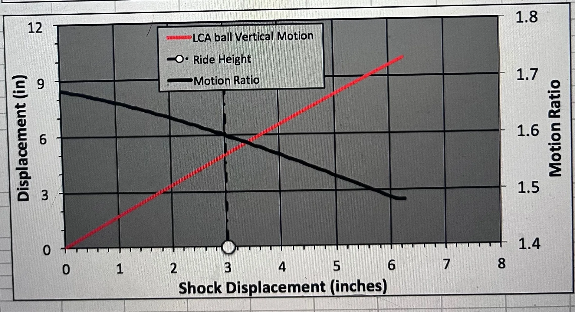

These seem to bolt into the oem hard points for both LCA and UCA. Also it seems they have not altered the shock mounting location on LCA.
in order to reuse oem knuckle and maintain oem kingpin axis, then both the UCA and LCA lengths increase by 2 inches. Assuming this was done to provide an easy bolt on solution with typical aftermarket coilovers.

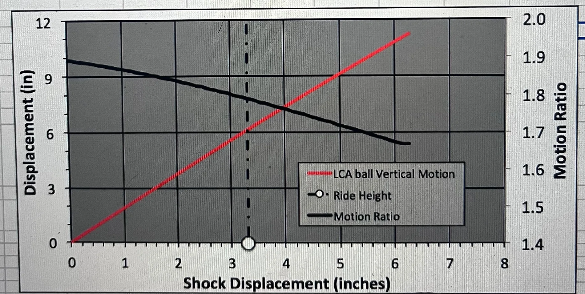

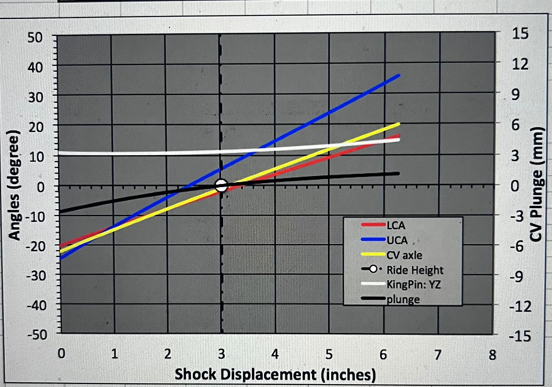

then the CV angles will be identical to stock. Since LCA and UCA angles won’t change. The only difference will be increased wheel travel due to motion ratio increase. Stock average MR is about 1.6 with just under 10” of wheel travel. This setup will be about 1.8 average MR with almost 12” of wheel travel.
Actual variations are shown in plots. First plot is for both oem and camburg long arm. All angles remain the same. Second plot shows oem MR and third plot shows Camburg 2” long arm MR. plots were determined using oem SAS bilstein coilovers and will vary with different coilovers.
Things that change compared to OEM.
1) wheel travel increases by about (1.8/1.6)=1.125
2) shock forces increase by about (1.8/1.6)=1.125
3) wheel spring rate decreases by about (1.6/1.8)^2=0.79
4) fundamental frequency decreases by about (1.6/1.8)=0.889
Probably want to get coilovers with an increased spring rate of near 12% to maintain stock shock motions under equivalent loading.
Hopefully camburg can provide more details on their setup. Seems like a very nice plug and play solution with minimal IFS geometry concerns.

I admit these pics of these things being built by hand make me want to go get them
And then someone like @87-Z28 has to go at it all Science class - and that makes it all the better
