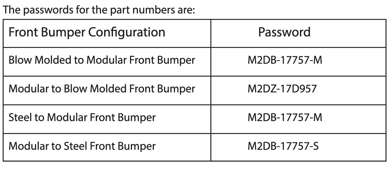

It's more than just the material because FDRS seems to have different codes for both the steel capable and the steel modular. I get what it's for but I'm wondering exactly what the different settings in FDRS do. Like is it calibrating the front sensors to be more or less sensitive? It's not changing deployment distance of the airbag because that's based on seat position sensors.
Yeah it's not just the fact the bumper contains steel. (The molded plastic also has steel in it technically.) It's the design of the bumpers themselves. Since the steel bumper and the modular bumper are different designs, they have different RCM configurations. When you add a winch on the front, it also has a different configuration.
I don't know if the programming changes the sensor configuration—obviously brand new so haven't looked at it. My hunch is the answer is "No", as the instructions for the modular bumper without the sensors asks you to apply the exact same configuration change as what you pasted above.
Agree.
Actually meant the front airbag impact sensors.
I see tons of people with winches on aftermarket bumpers and with the "availability" of FDRS, I would wager almost no one reprograms this.
