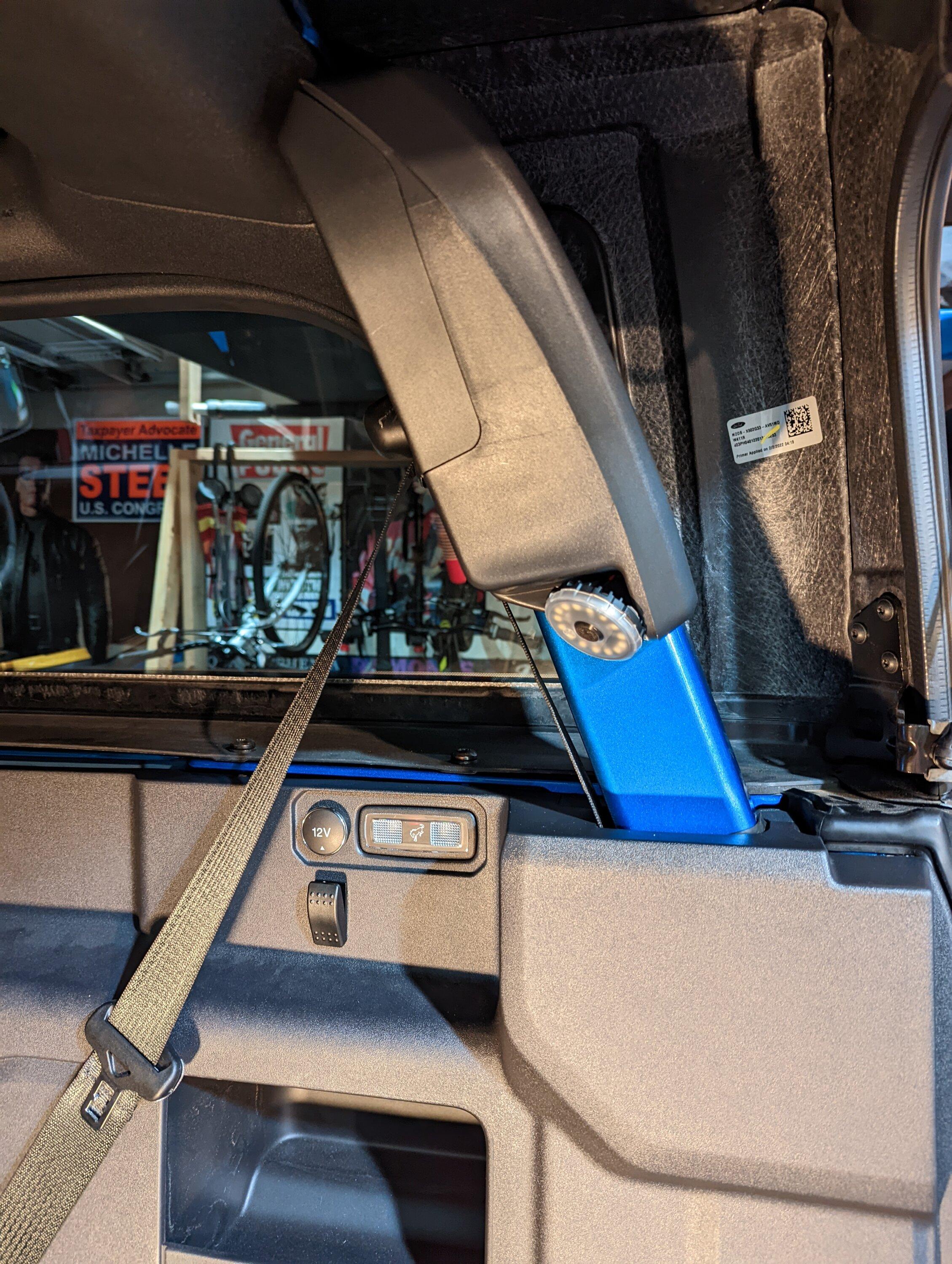

The rear 12 volt power in the cargo area seems to be off when the ignition is off but remains on for a while after the ignition is turned off.
Does anyone know how long it stays energized for after the ignition is turned off?

Thanks! Managing a fridge. An hour is good!

I believe there is a tweak you can do in Forscan that will keep it on.
This is one of my concerns as well, because in my Wrangler the rear cargo is hot all the time so unless I'm spending it overnight, I just plug my fridge directly into the vehicle.

I’m running a 700 wh power supply between the vehicle battery and fridge. I’m OK with the 12 volt port turning off. Also using 200 watts of solar panels for when the vehicle is off. Will probably get an MPPT(?) solar charge controller for backup charging of the main vehicle battery.

Forscan allows you to extend the time beyond the ~hour you get.
