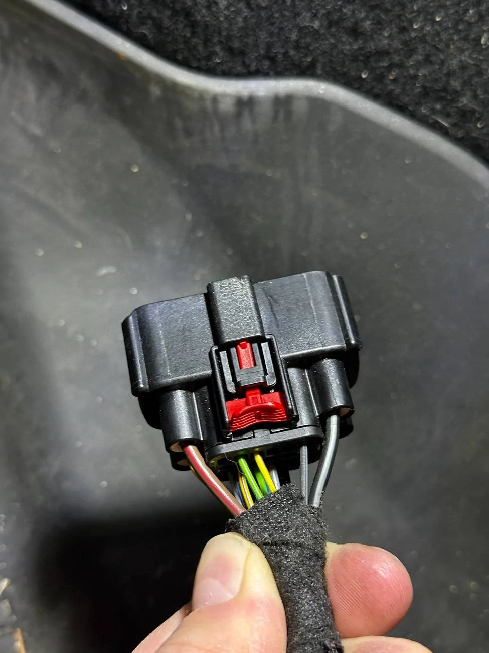

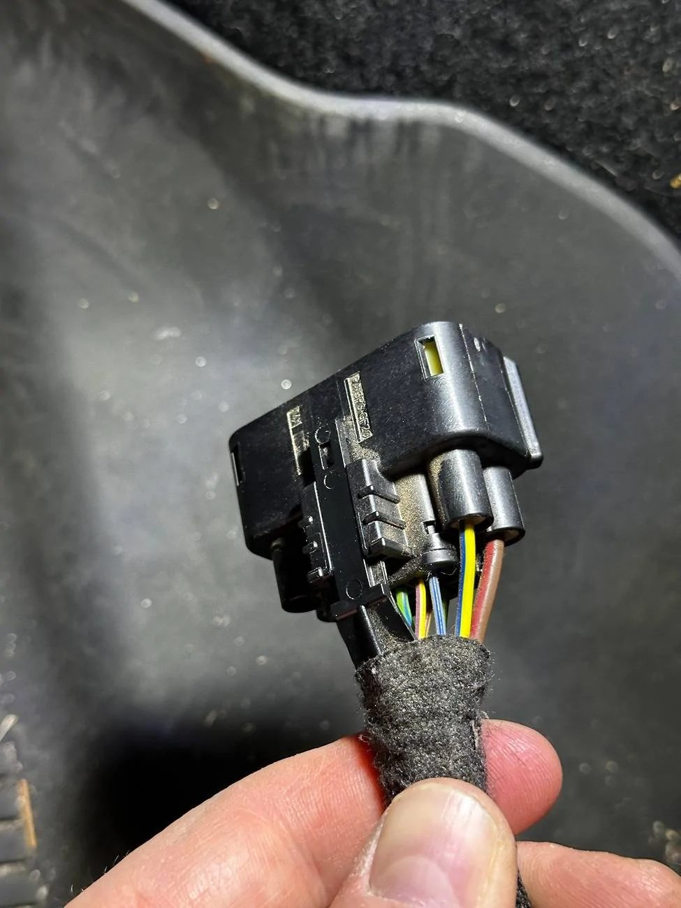

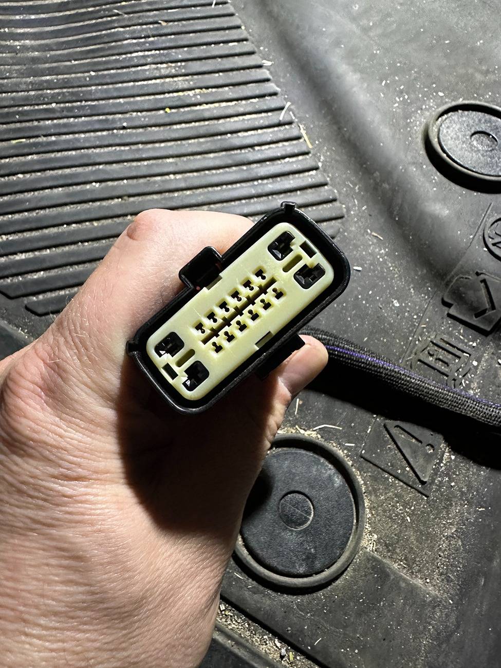

Hey all,
I've successfully installed an OBX 10-way powered leather seat in my 2022 4dr Big Bend w/mid package. Big thanks to @Ducati1098 for help with the wiring diagrams. Truth be told, it's completely plug and play. No modification needed in order to make this work. The wiring harness has all the necessary connections to make the swap. If you're looking to do the same on your Bronco, just make sure all of the wires you see below are present and it should work.
Wiring harness/connector to the driver's side seat.

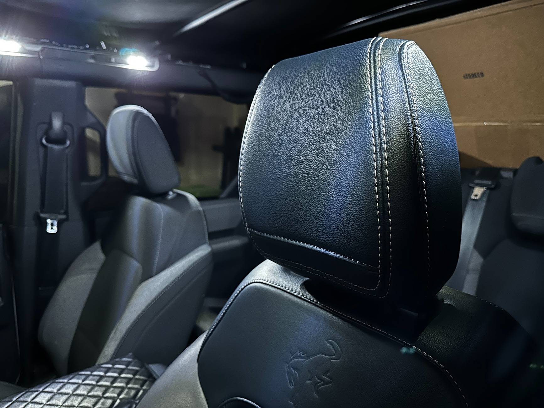

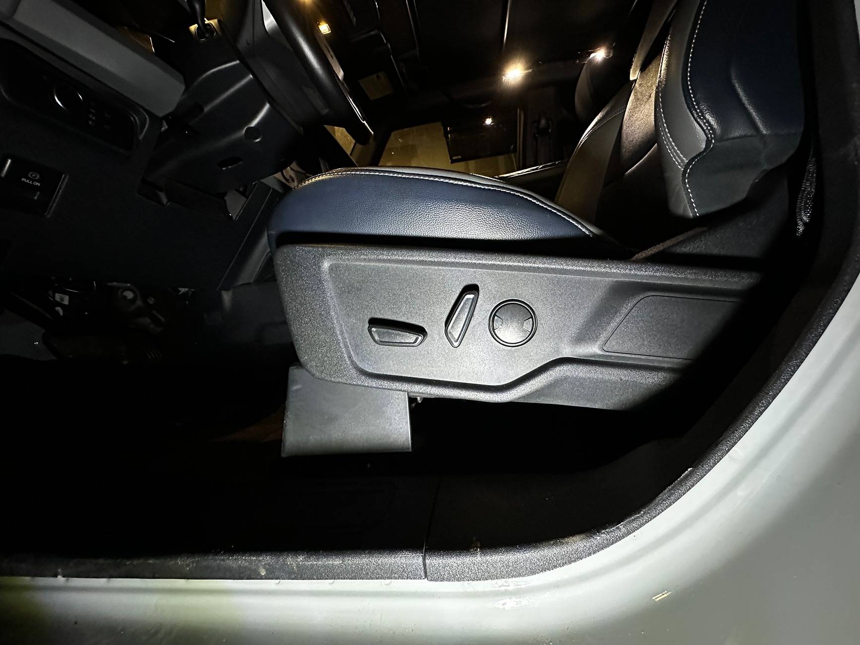

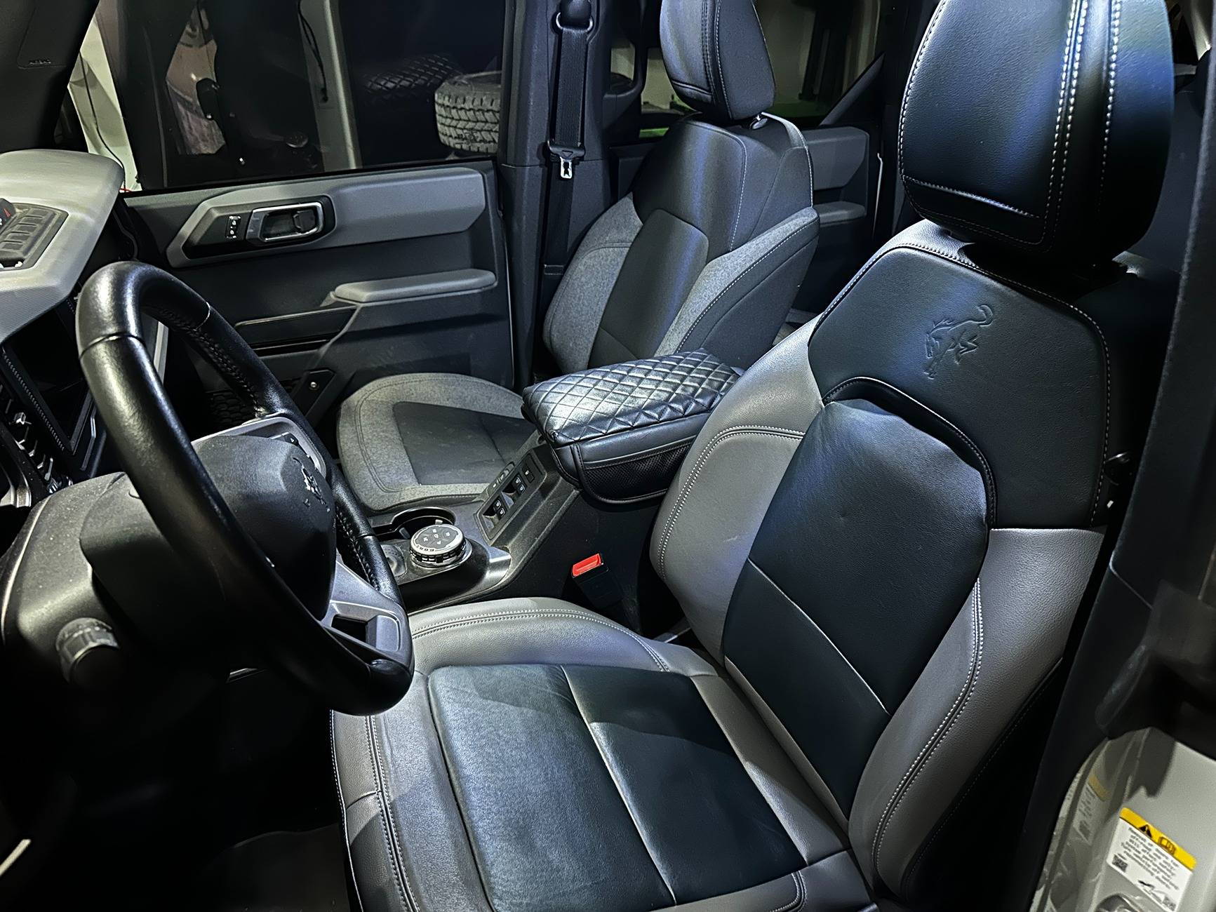

Now for some seat covers :)

The harness and connector are directly under your seat. You'll see it poking out from the carpet.
