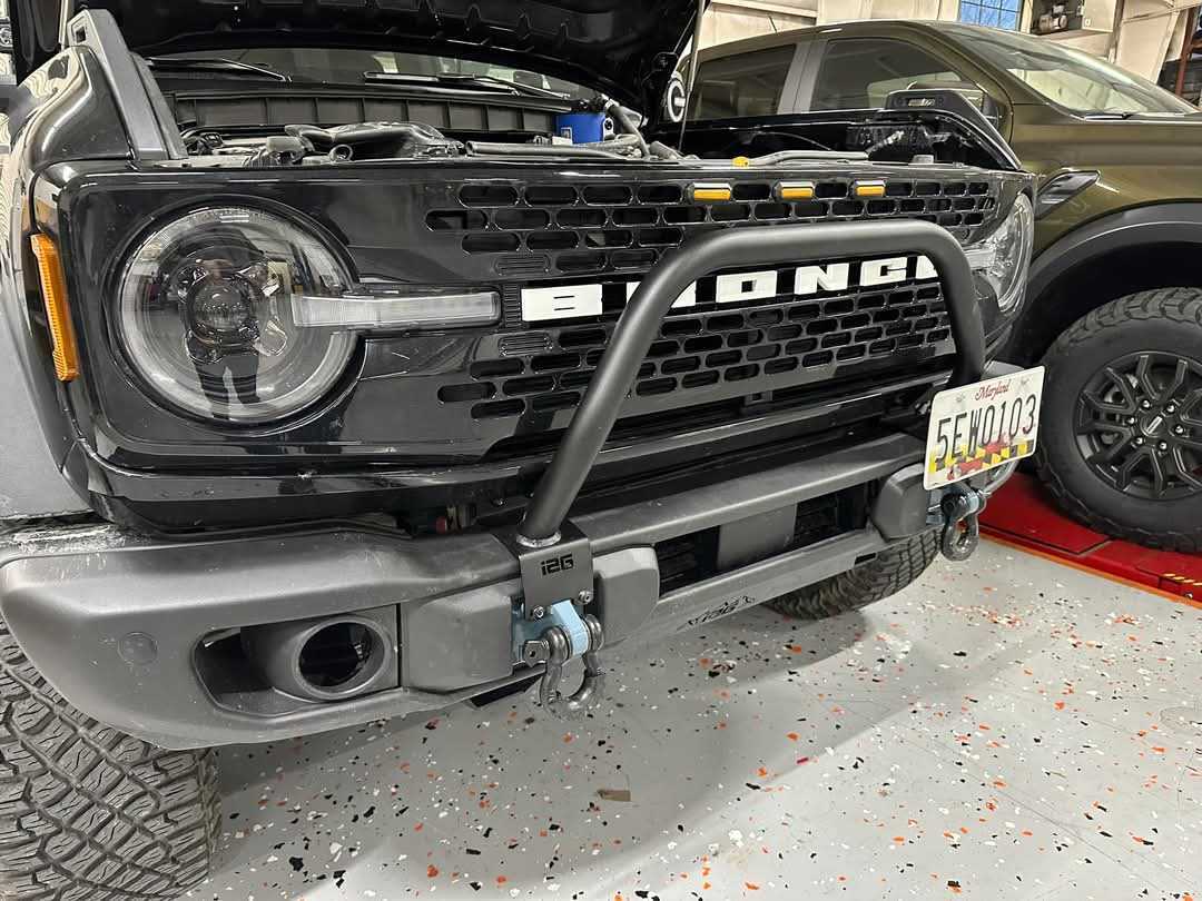

Here is what you've been asking for, the no-drill Capable OE look bull bar! We have ditched the police cruiser bash bar design you will see elsewhere. Simple to install brackets, replace the D-rings with some proper shackle mounts and you're off! No modifying OE parts for fitment either! No interference with cameras or sensors. Shackle mounts shown here in a secret color, Area 51.
There will also be other accessories for sale, as this will be a 'modular' system. This is actually more robust than what you will find on a Ford modular bumper because of the triangulated mounting design. We will be looking for testers in the near future and plan to sell by the end of the first quarter 2025!

Hey I got a question, are those the Rough Country headlights? My kid has been looking at them, wonder how good they work?
No, they are a new product we will be releasing soon.

Hmm ... interesting. I have the DV8 bar and I like that you better secured the front but not sure I like how you did it with the waterfall over to a new shackle. I know those in the past that have added that shackle have had to trim the cover some so is IAG providing a new design?
Also will you be doing a mini bar? I'll throw my name out there if you're needing testers!

Yes, we have designed a new shackle mount. Ours will actually be compatible for a mod bumper without trimming as well. We don't like making the customer damage their OE equipment. We try to stick with totally reversible modifications.

Thanks, looking forward to seeing the new shackle, that should be a good seller if you don't have to trim the panel.
I agree wholeheartedly. Love the idea and the look besides this part. Would prefer something more factory looking rather than something that is obviously tacked on. Is it possible to run this part behind the plastic cover and have the cover snap on over it, even it requires minor trimming?

I like the D-rings of the Capable bumper. It's one of several design elements which make the configuration look quite good.
No room in that area. This was how we chose to move forward because the bull bar is much stiffer in this configuration than one mounted on the modular bumper even. The modular bumper isn't as strong as many people think, it lacks torsional rigidity.
