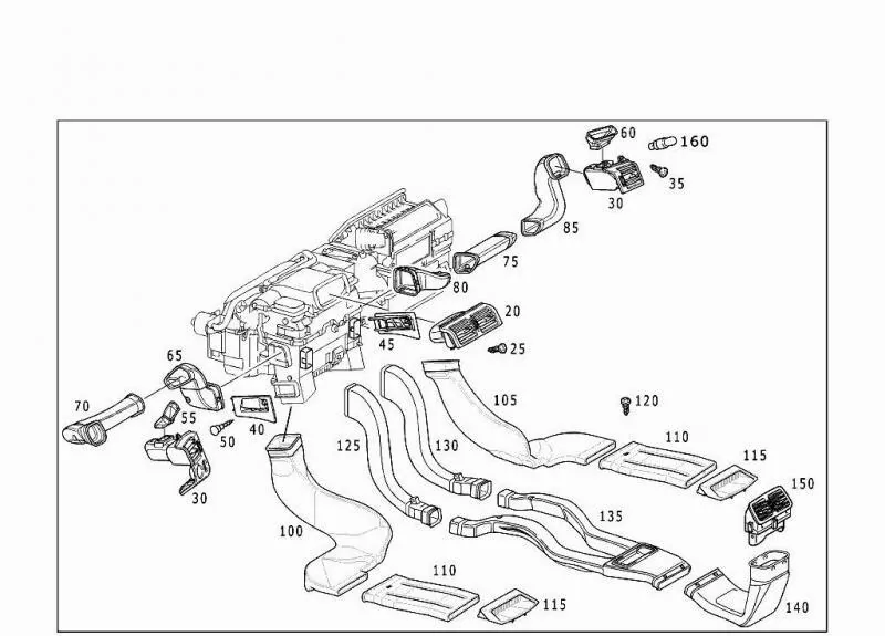

I disagree with point 4 on the rear ac vents, Before people throw chairs hear me out.
If you look at a typical AC diagram in a car, the placement of the vents is in the back of the arm rest. If the vents are higher like this I would be very worried about water getting in the vents and sitting in the ac ducts. By keeping the vents as low as possible and protecting them with the seats there is less chance for an issue. Most likely once the ducts get under the center console the elevated the duct to prevent water from going further into the system and doesn't allow water to sit anywhere in the ducts.
As long as the fans are strong enough to move air in the back, which it should be, I think this was a good engineering decision for ford.
The Bronco is missing part numbers 125, 130, 135, 140 and 150. Those would solve the rear A/C problem. If part 150 is closed before going on a hose-down frenzy, there won't be an issue. Any tiny amount of water introduced could be quickly evaporated by the de-humidified air that comes from the A/C.

Also, many people mistakenly think that 100, 105, 110, 115 are A/C ducts. These are heating ducts. Water is more likely to enter 115 than 150.
