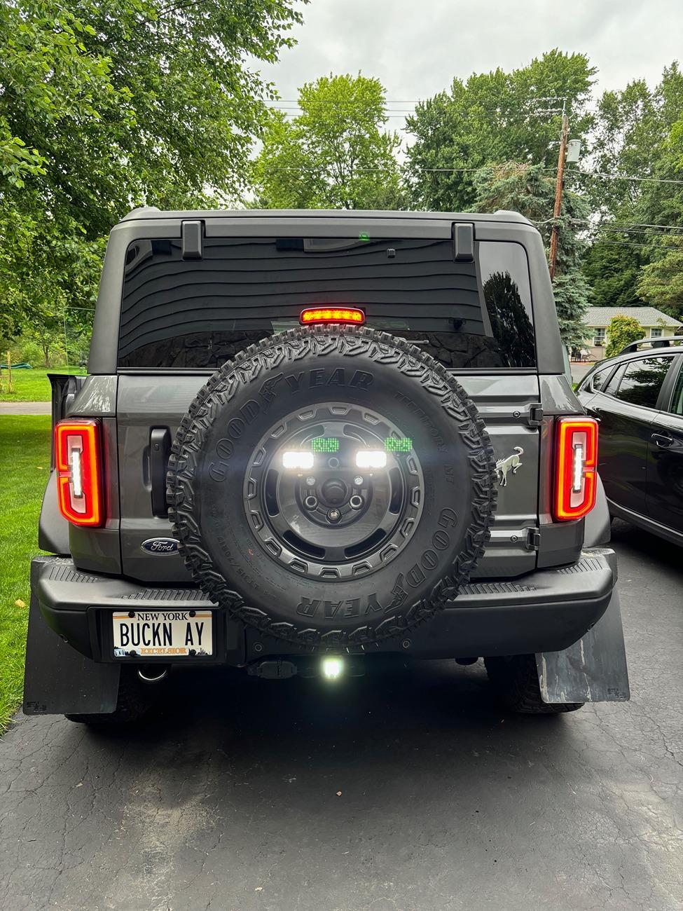

Installed the @Diode Dynamics Stage Series Reverse Light Kit today. A few things:
1) Had to remove the pull out tray to pop some trim, but also wanted to route over the trays supports, so a second set of hands to hold it was good.
2) Slots in the EG rims are to narrow for the DT connector, had to nip the protective side tabs(think prevent accidentally pressing the release tab.
3) Slots made it impossible to fish the wires through after the fact. Routed through with tire on ground and with a second set of hand mounted tire. Left excess wires in the door unsecured so I can pull the spare in the future and remount.
4) Used the longer mounts that replace the lug nuts to lessen the strain on the DT plugs.
