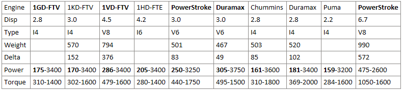

Engine Candidates i've documented:
6.7 included to humble the other options, and Cummins nick named Chummins because its made in China with a reputation to match.
3.0 Duramax is the best match on paper, but electronics may be insurmountable.
3.0 Powerstroke may be the easiest to integrate electronically, but is not really an excellent engine.
1GD and 1VD are modern Toyota diesels with great reputations. I assume harder to integrate than the Powerstroke, but easier than the GM?
