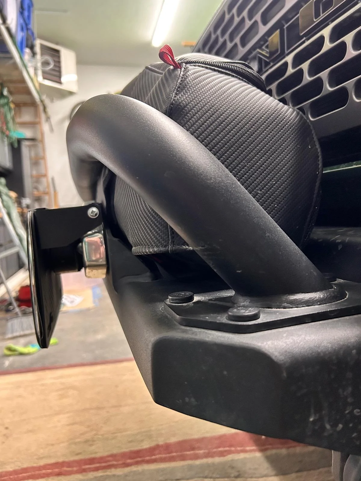

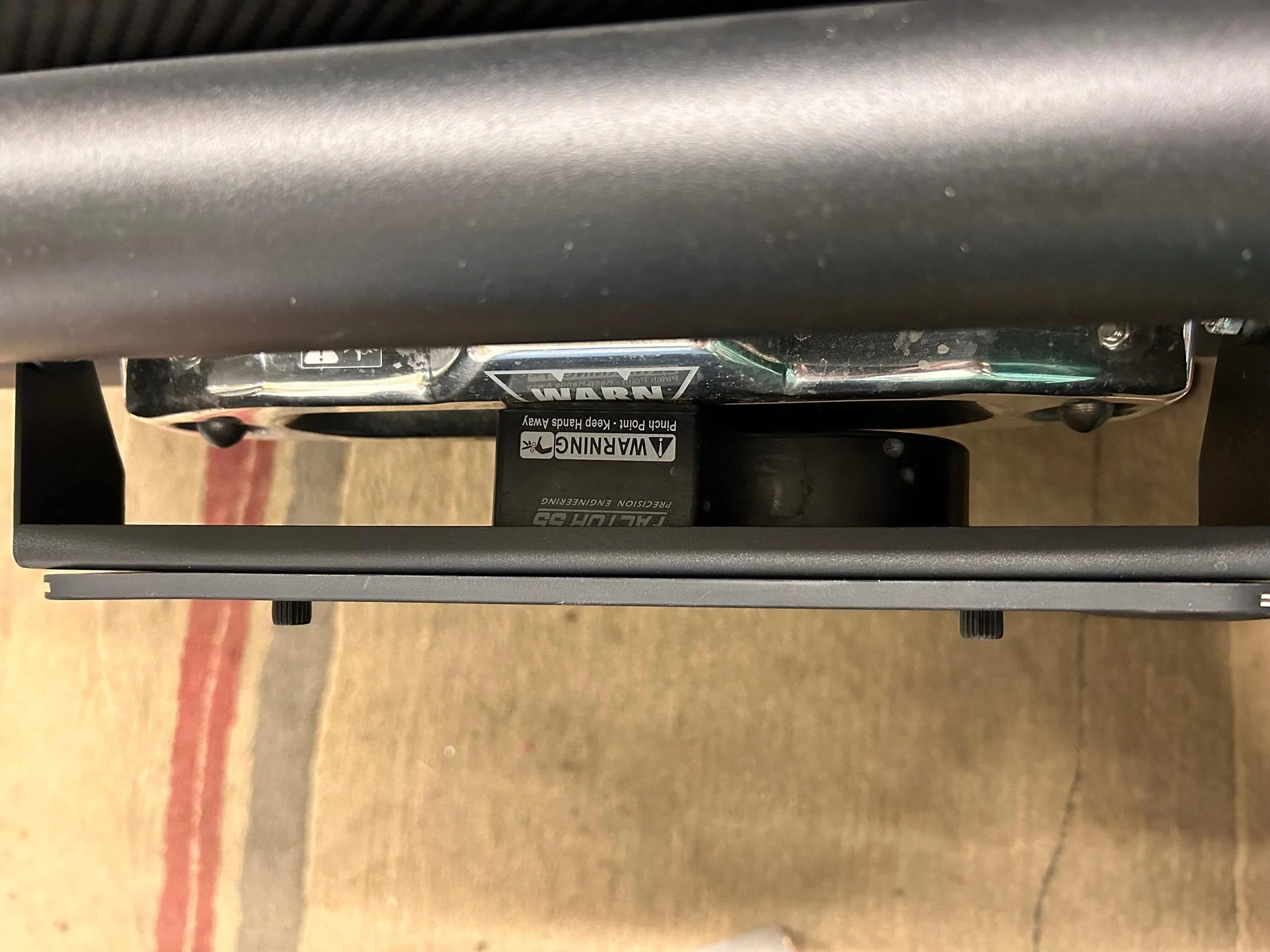

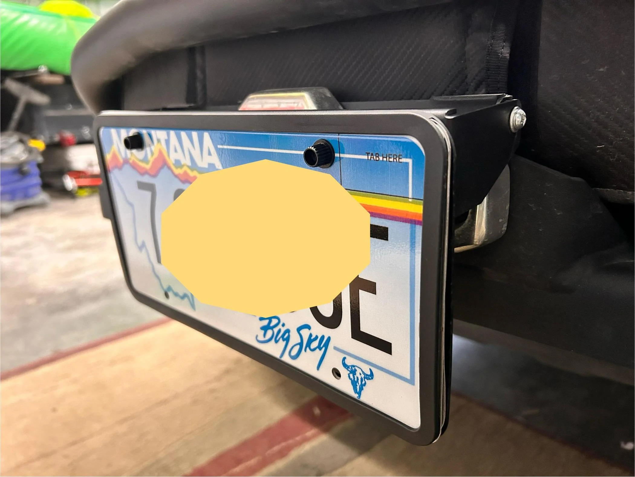

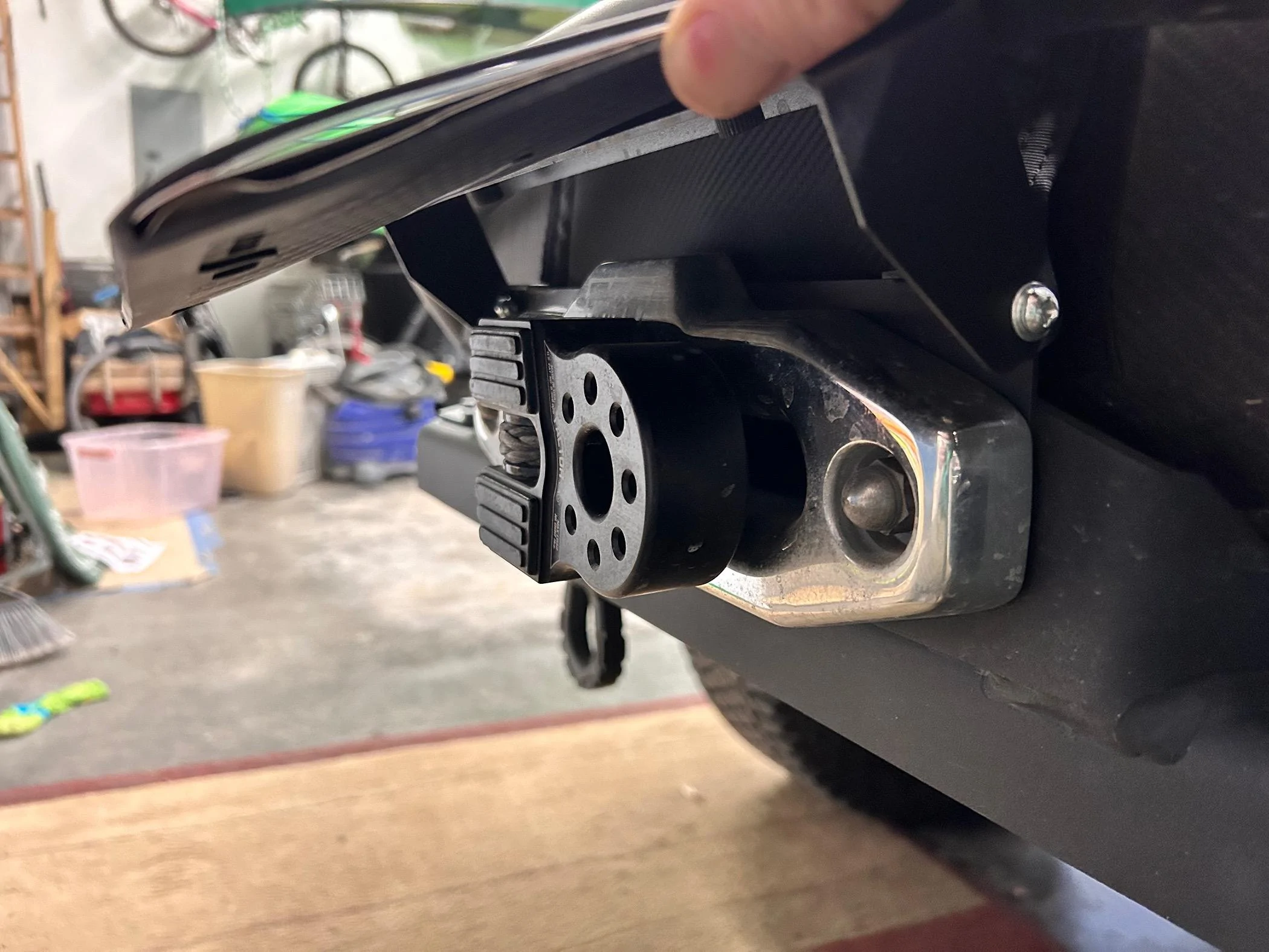

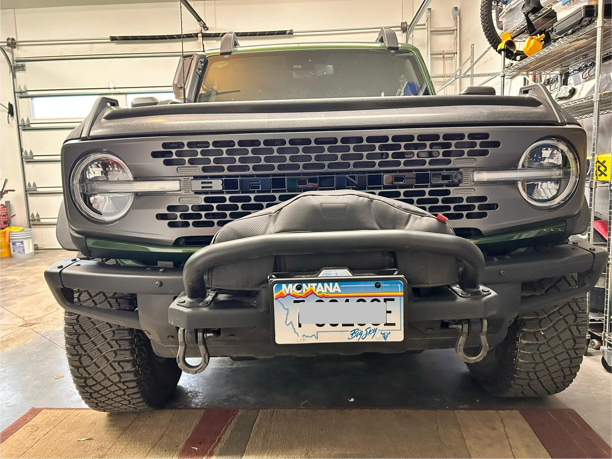

Here is my winch cover/plate solution. Keeps the road grime off the winch line etc.:
-Warn winch cover
-Factor 55 flatlink winch shackle
-AMOPA AMOPACORP flip up plate bracket
-Aujen Silicone Plate holder
-Nylon license plate holders (for easy plate removal)
The fit is good, the flip up doesn’t go quite far enough but even if it did flip up a full 90 it would probably still interfere with winching. It flips down tight, no flopping around. The nylon screws twist off easily. Can’t remember anyone trying to take my plate. Cross that bridge when it happens.
