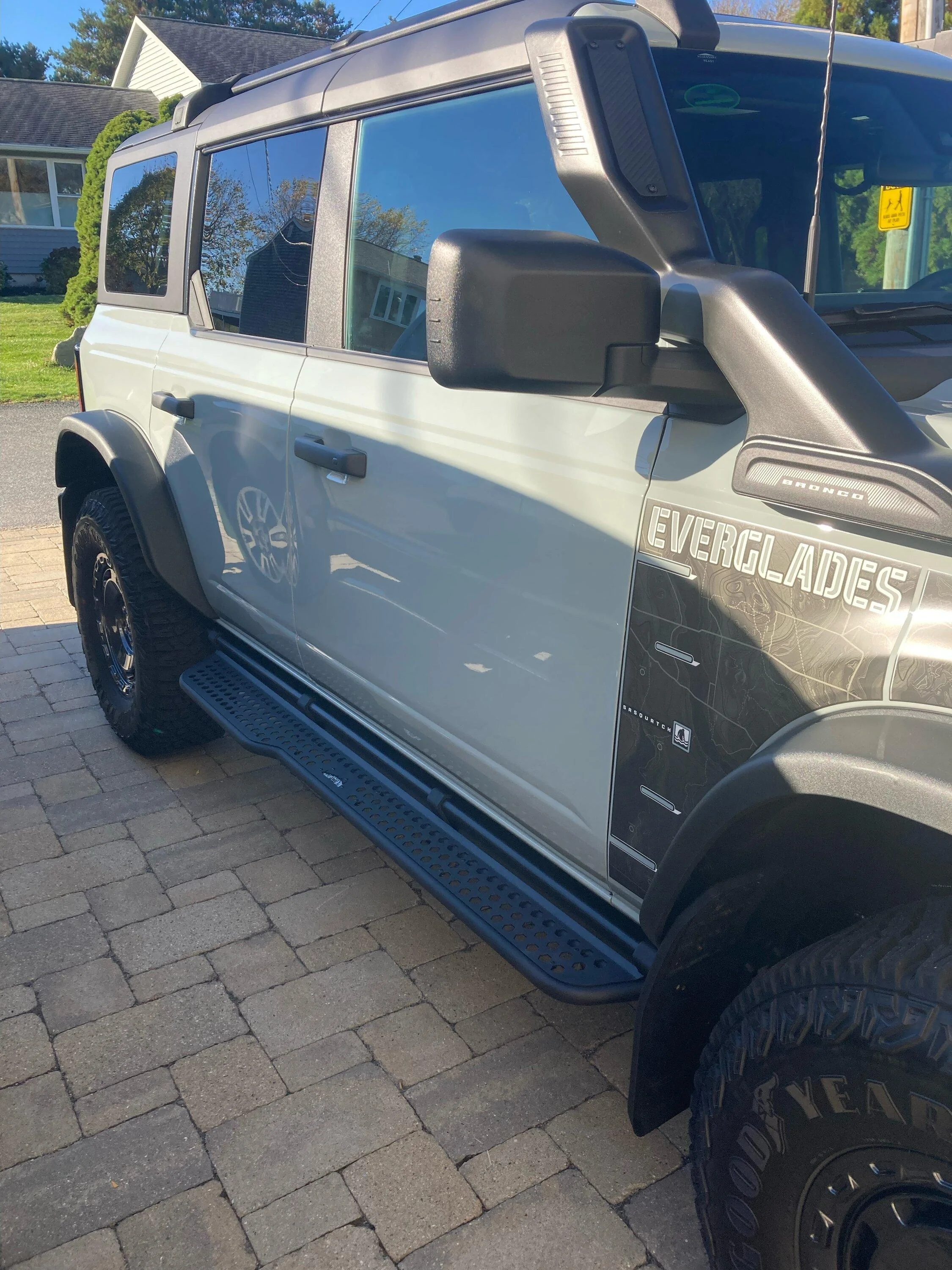

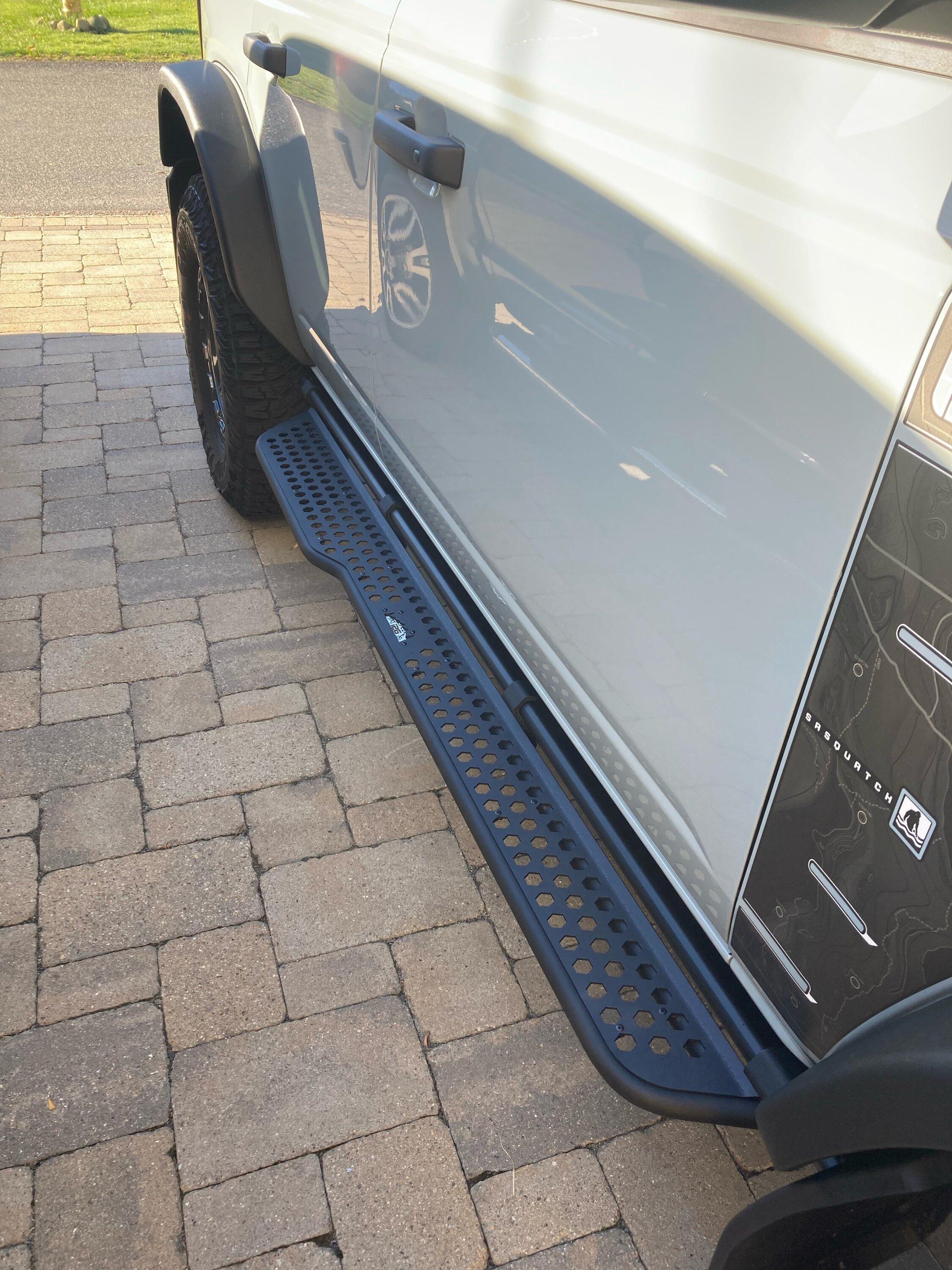

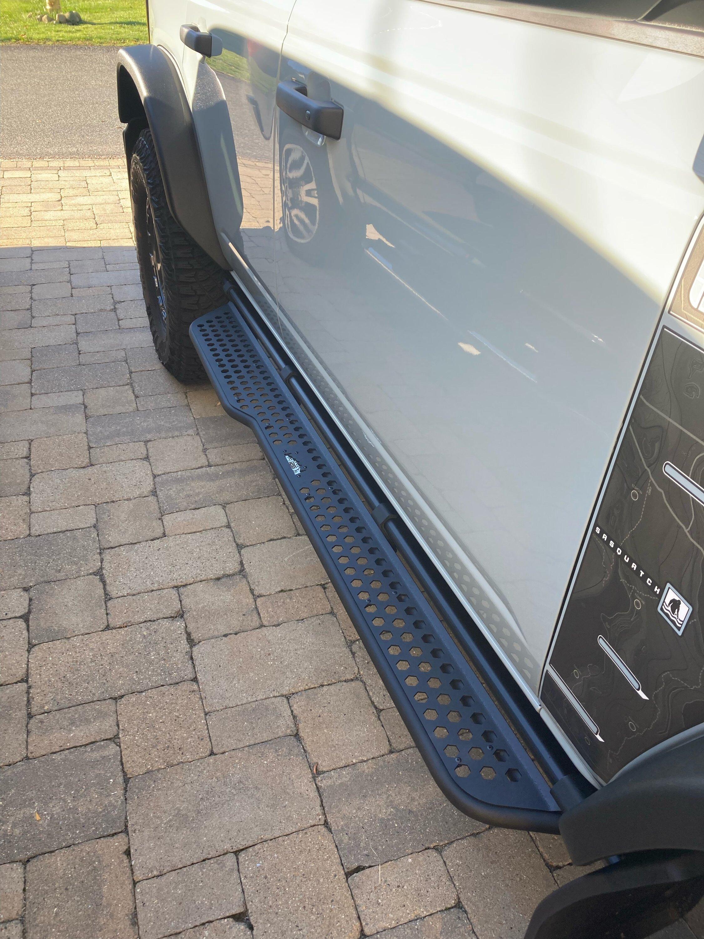

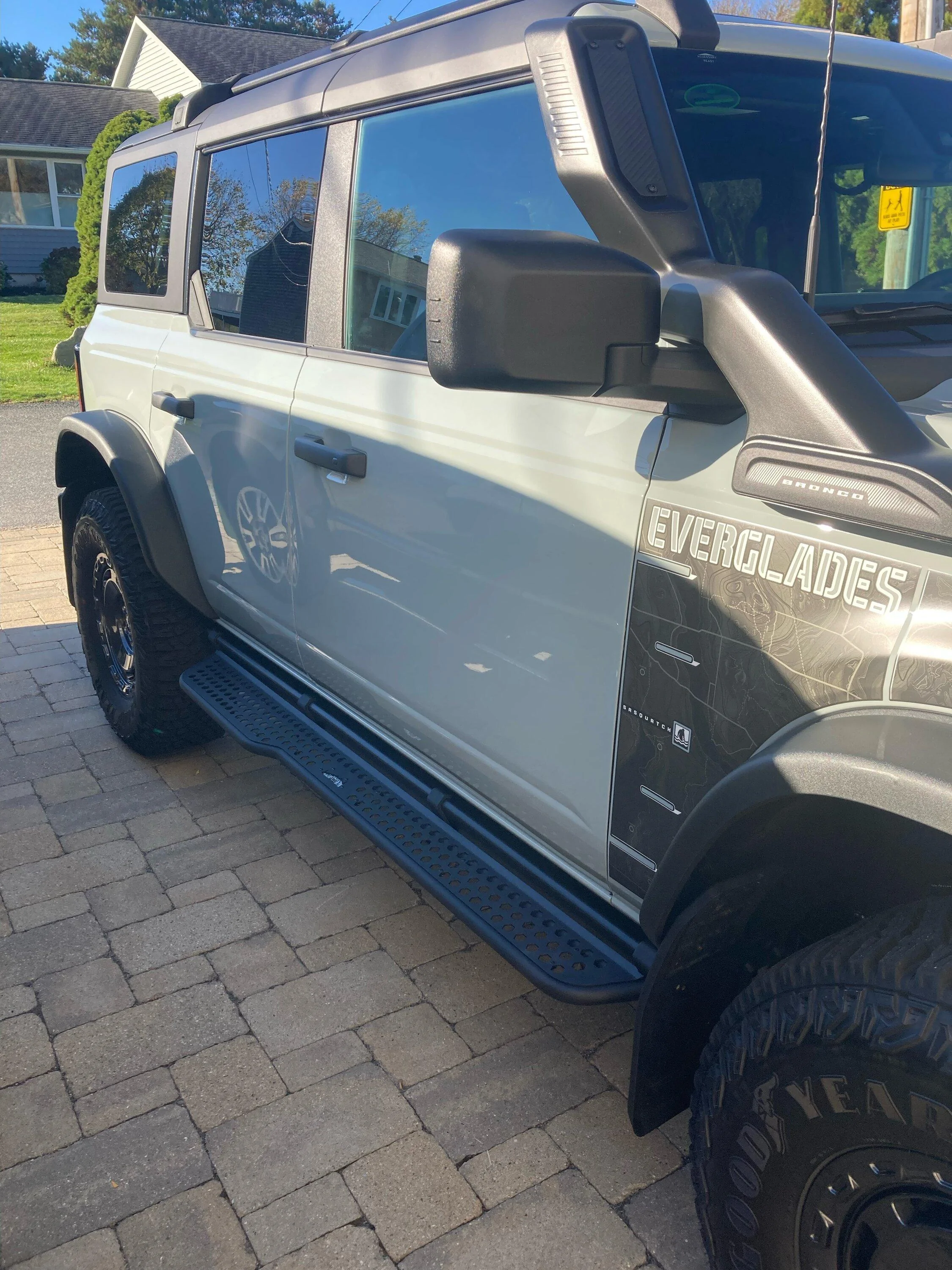

Hey Guys, Update, I received my IAG steps and attached a few pics of them mounted. Couldn't be happier! They are well made, look great, and only took ten minutes to mount on oem rock rails. They also come off super easy if you need to take them off for rock crawling.
