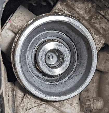

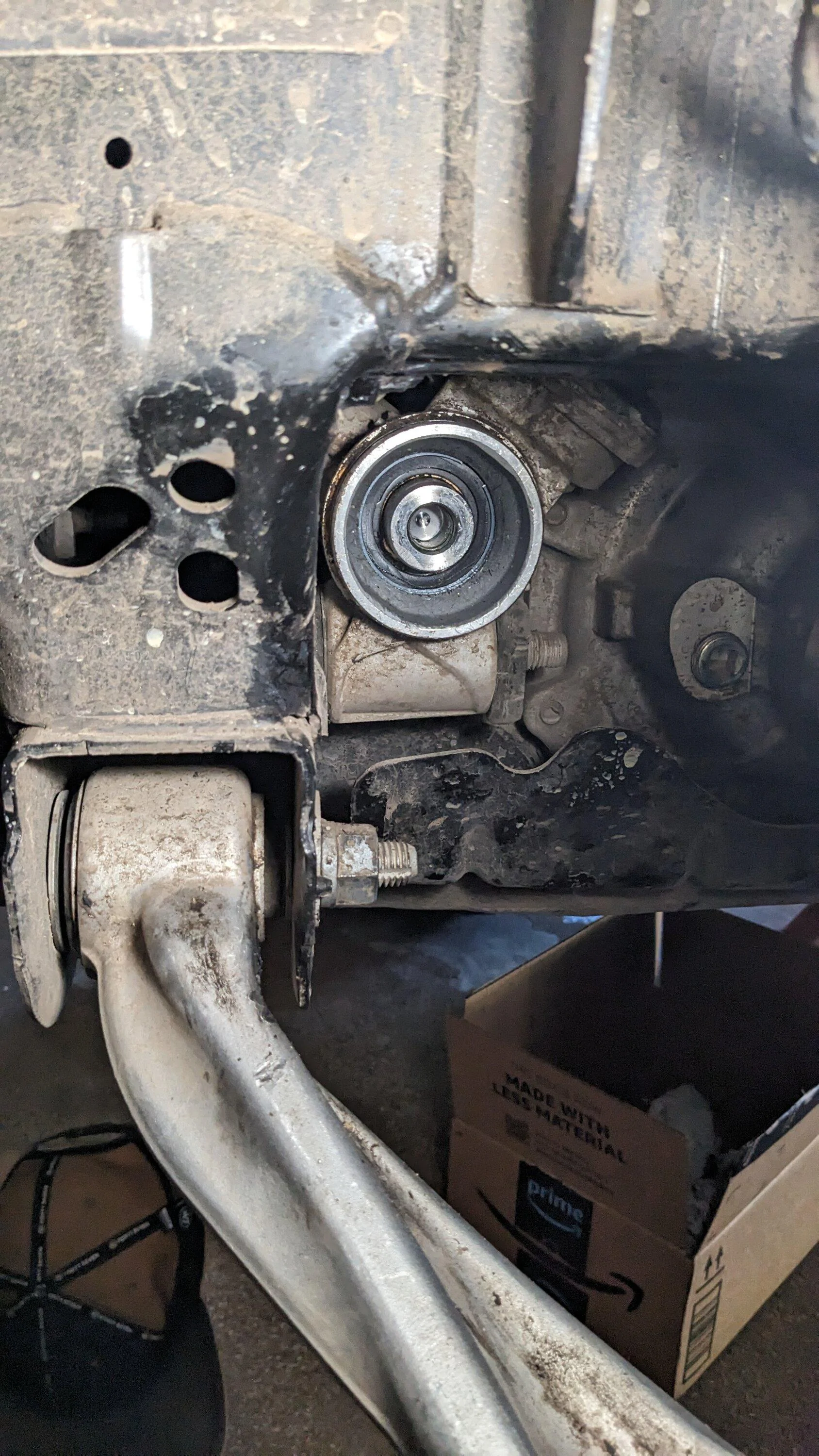

Since I am big on sharing my own problems I need to come clean. I have some excess play in the steering from wheeling this weekend. Initially it sounded like a loose strut/metal on metal when turning the steering wheel and driving. This went on for a hour? Had noticeable visual play on the drives side. This was mid trail and decided to keep going! I mean it was same distance back as forward so why not?
At lunch I pulled the boot off to inspect and saw some bushing material on the steering(drivers side) cleaned it up and it was driving perfectly fine. Driving home it started to loosen up again on the curvy roads so I decided to pull it apart.
So Sunday I pull it apart, inspected everything found a loose lower control arm bolt. Thought I was golden, drove around the block no issues. I checked the steering rack bushing and tie rod. Put a pry bar on everything to see if I could get some play and I was satisfied.
Today it's back, feels like a bad tie rod/missing drivers side steering bushing. Going to swap out my ford performance hoss 3.0 tie rod next. I am thinking I killed the inner bushing, the steering is acting very similar to the last inner bushing failure I experienced. Very hard to troubleshoot as the steering feels tight in the driveway and no noticeable disconnect in steering input to wheel movement.
Not really in depth pictures as this was mostly me poking around looking for issues.

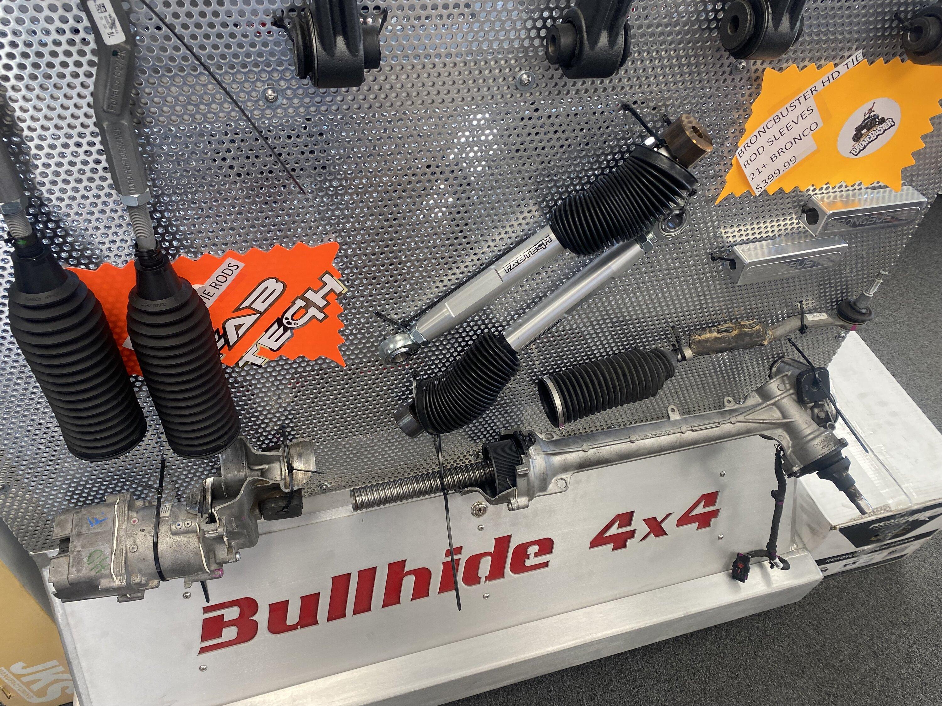

Bummer. Here is a pic of some destroyed racks. My local 4x4 also mentioned one guy destroyed the internals of his 3.0 rack wheeling. No case splitting occurred like what’s in the picture.
Surprised how much plastic is inside the steering rack. Not sure a 74 weld rack do any good? When the internals are subpar materials.
74Weld stage 2 rack with icon tie rods did just fine in the bronco ahead of me. I am just surprised that I am working on my steering again after 5k miles.

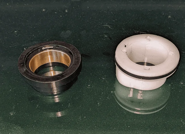

What about the bushing do you think is failing?
74 weld advertises that they use a softer plastic than the competition. Do you think that's playing a role here?
I was planning to go with their stage 1 kit for my 2.0 rack (which is currently out of stock), but may end up getting the BB passenger side housing if it looks like the 74 weld setup is the issue. Rocking the BB bushing and icon tie rods with 2" of lift and 37s. Trying to be patient until more solutions hit the market. Hoping to avoid a rack failure until then.

I think this may be more of a HOSS 3.0 tie rod limit, I am just being clear about the symptoms. I will straight up say it feels like I damaged the steering rack. This bothers me to say as I feel like people think the rack is damaged but I am 100% positive this is going to be fixed by a new bushing or tie rod. The steering has zero play in the system is like something is deforming so the engagement is still fine.
@cgv I don't think the bushing is dead, everything looks perfect from the outside. I pulled up some older pictures while looking at the bushing, the bronze looks to be the same distance from the snap ring. No cracks or chips as bronze is a softer metal.
