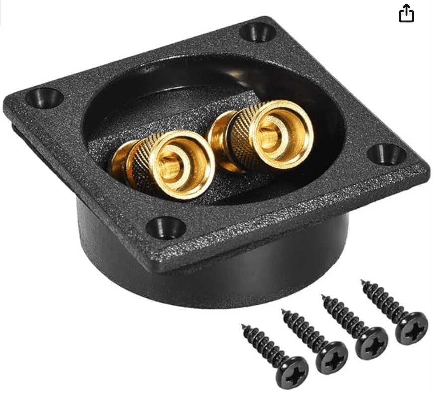

Rather than run the wire underneath the sub mounting ring, since i was trying to seal it, I bought a terminal post kit. I drilled a hole where the OEM amp mounted and installed this and sealed it up. That way all the internal wiring stays internal, and all the external wiring can connect up easily.
https://www.amazon.com/dp/B08265LWCQ?psc=1&ref=ppx_yo2ov_dt_b_product_details
