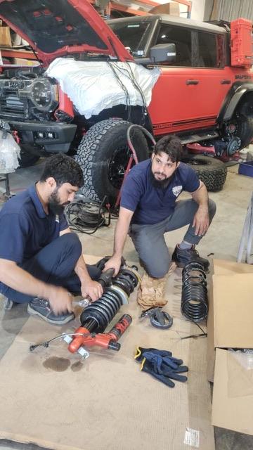

I went with springs since my load is high. More metal equals more strength in my opinion. Photo just came in with stock on the side and hyperco going on. Significantly thicker

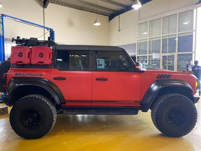

Sitting a little high. Haven't driven it yet. But got a 7 hour desert drive tomorrow with a full load. Still need to add fuel, rotopax and the delta max 2 to the load so might level out. Just to add this is rear only. Front is stock.

Apologies for the delay. Road manners unchanged if anything smoother especially over speed bumps. Offroad I'm getting no bottoming out now. Is taking a fulload no problem. Still sitting a little higher in the back but I like it. 110km/h dune track run over bumps and a few small whoops and jumps was great. I apparently took big air at one point and landed like a cat I was told on all 4. We are all old men so don't do insta360s and things so I suppose if there is no photo it didn't happen. On the technical dunes, cross axle stuff I don't notice a difference just seems to be on the bowls and tracks. I think I will do the front as well. Just so it's the same springs all round won't do Heavy duty though as I'm not doing a winch.
